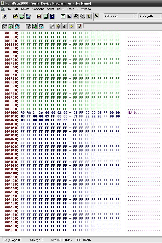

    Would anyone be kind enough to post one screenshot of a working MJOY16's EEEPROM?
    Like this:
    In PonyProg2000, READ DEVICE, scroll to the end of the buffer, where the letters are BLUE...
    I want it to check the Vendor ID and Product ID
    Thank you!

    :yippiee: SUCCESS!!! :yippiee:
    I am going to work and i will be right back to post details!!
    I bought everything again, even a breadboard and tried it, IT WORKED!!
    THANK YOU GUYS!! :cheers:

  5. Sokol1
    Sokol1 Member
    Jul 6, 2009
    126
    14Coins
    +1 / 1 / -1
    NuMcA,
    Good news. :thbup:
    Probably reason for previous failures is: breadboard.
    When you use PCB, will be everything easier.
    Sokol1
  6. NuMcA_[.gr]
    NuMcA_[.gr] New Member
    Jul 12, 2009
    66
    3Coins
    Guys, I am embarrassed to tell you this :blush:, but i was not able to find what was wrong! It DOES WORK now, but i don't know what my problem was. As Sokol has said, i am starting to believe it was breadboard problems, or a problem with the Zener Diodes. I replaced E-V-E-R-Y-T-H-I-N-G, (even the USB cable and breadboard) with brand new parts and it worked! Thank you for your help!
  7. Frakk
    Frakk Active Member
    Apr 15, 2009
    1,144
    328Coins
    If you have a voltmeter you can check your zeners. Just connect them in series with a 1k resistor, connect 5V to the marked side (cathode or negative) and GND to the other. Measure the V across the zener and you should get 3.3V.
    The breadboard could have been the problem, but you said you soldered the circuit together too right? When you do projects on a breadboard look out for component leads touching eachother. It happens to me all the time..
  8. NuMcA_[.gr]
    Jul 12, 2009
    66
    3Coins
    In my PCB i had the 82 Ohms resistors BEFORE the pull-up (2.2k) and pull-down (4.7k) resistor!
    But i found it out early, and gave no more look on the PCB (which after all i could not change to fix). So i concentrated on the breadboard. Now, since i cannot find what was wrong on the breadboard, i will go back to the PCB and see what i can fix (hack 'n' slash method...).
    Thank you once again!!
  9. NuMcA_[.gr]
    Jul 12, 2009
    66
    3Coins
    On PCB i had the ZENERS before the 2.2k and 4.7k resistors! I was able to fix it and now i am rebuilding my console on the MJOY16 with the already made PCB!
