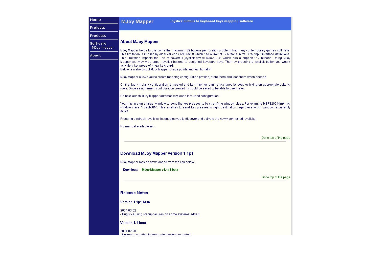

    I've been following this post with great interest and have been wondering why no one has used the Mjoy Mapper included with the original publishing of the Mjoy. This is easy to use and displays 112 buttons.
    Here it is along with some Notes:-

    SVMapper is a improved version of MjoyMapper, whit support to mapped key on press and release, ie toggle switchs, and add repeat and delay...
    See 112 buttons plus HAT, but fail in certain games function, like George say.
    http://translate.google.com.br/translat ... l=ru&tl=en

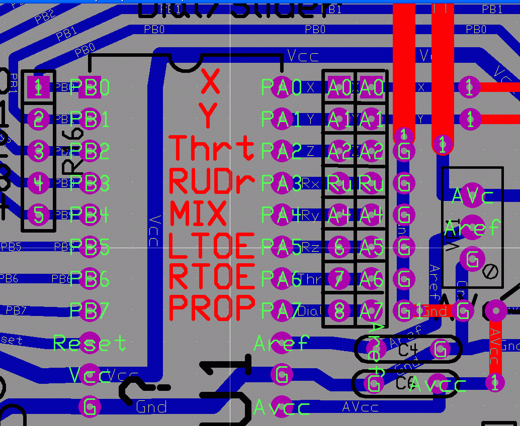

    Some Instability Triggered by Unused axes?
    Hello Chaps, again.
    I have a little problem with my Mjoy16.
    Recently I have noticed that my throttle (Z-axis) is suddenly getting reduced to 50% while playing combat flight sims.
    The first 5 axes on my Mjoy are used and appear to work smoothly when looking at the Game Controller applet in Windows XP, as I have indicated earlier in my letters to you all. However, the three unused axes (Z-Ro, Dial and Slider) have a frequent spike to zero (approximately once each 1 - 5 seconds). I have these inputs shorted to ground and they usually site nice and quietly at the 50% mark. I THINK that this spiking on the three unused axes is new.
    What could be the cause? Could it be that when my computer is working really hard (playing a combat flight sim), it doesn't read the axes properly, or that this spiking to zero is tricking the MJoy 16 into sending out incorrect data? I am going to check that the connection of the unused axes to ground is solid, but it should be ... I am using machined IC sockets piggy backed onto one another.
    Any thoughts? Sokol, Frakk, Tronic?
    Regards,
    George

    That is very strange. Have you noticed this before? If the axis are sitting at 50%, your inputs are not shorted to ground. They should be 0V, which is either 100% or 0% in windows. You said the Z axis is getting reduced to 50%. Is this for the duration of the spike only or is it permanent? Do you have the auto center jumper set?
    If these contacts are properly grounded to the USB and circuit ground, the spikes can come from the USB port, or there is a glitch in the firmware. Do you notice the spikes only when the computer is under heavy load?

    if you have a shorted-contacts to GND, then you should see either 100% or 0%. To stick in the middle you have to have them shorted with something close to 2.5V, which is kind of..difficult!
    I don't know THAT much about MJOY, but could it be a problem with the calibration done through Windows? Could you check using DIView, and using both RAW DATA and CALIBRATED DATA?

    The unused, shorted axes have sat at 50% from the day I plugged them in. I am pretty certain that the connection is to Gnd though but I will check that. There is a 2.5V reference nearby ... from Aref. See attached picture.
    (The jump in the Z-axis is only a spike, but in my game (CFS3) the throttle stays set at 50% until I move the throttle again: so that is a function of the game only, not my controller.)
    My auto-centre jumper is set, and it apears to keep the rudders nicely centred.
    I thought that the computer load might have been a problem, but I suspect NOW that it relates to time: for the first 15 minutes or so the jumps occur, but after an hour or so, there are no jumps - so perhaps an electrolysis process has happened at the shorting jumpers I have placed. Our environment is Hot and Wet and Salty here in Townsville. My money is on this one.
    I shall also check the raw data with DIView, but if I recall correctly, DIView does not recognize my rudder axis at all - I think it gets tricked by the +512/- 512 data it is fed rather than a 0 - 1024 signal. (This is just out of interest because that axis is not the trouble.)
    Thanks for your help. I will get back to you on my findings.

    Thats where your problem might be. Try to use 5V reference. The firmware didn't react to changing the reference voltage for me and it is strange to see working with yours. Anyways, set that to 5V, and maybe take the pot out all together.

    Frakk, another reason why the unused axes might have gone to 50% is that the internal voltage reference is 2.56V, so given that is very close to 2.5V, the 50% might just be a coincidence. I agree that the Aref is likely being ignored by the firmware. If I were going to change Aref, I would use the diagram from Mjoy16 and Mjoy(8) and just join the Aref pin to ground via a capacitor. Mindaugas seems to have put a huge amount of effort and care into this wonderful software for us gamers.

    Happy to hear George! The internal voltage reference is set at Vcc 5V. If the reference would be 2.56V, you would max out the axis in the middle of the pot turn, meaning: at roughly 50% input you would have 100% output from the controller. Vref signifies tha maximum voltage, the reference for the ADC calculations. An other thing to note that the ADC doesn't calculate negative voltages. The raw data is a number between 0 and 1023 for 10bit resolution, 255 and 511 for 8 and 9bits. What you see in windows is a number already processed and shifted 50% down to give you negative values.
