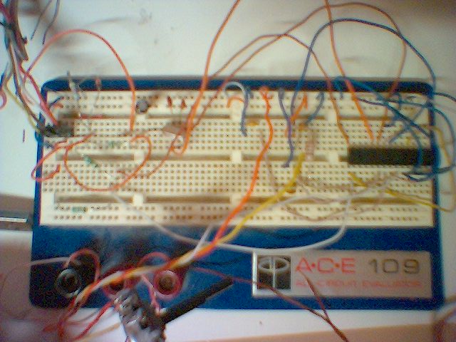

    Hallo,
    I change the parts : ZENER diods and capacitors and the PC wrtite, that device is unknow....
    I dont now :no: where is problem i change every parts and the problem device unknow always exists....
    I make photos with bad camera, so I must look for another camera and send better photo. Now i send the bad photo in attach
    Have a nice night,
    pitr

  16. pnekdo
    pnekdo New Member
    Mar 2, 2009
    10
    0Coins
    Hallo,
    so I clear the test board again, because it was not functioned and there must be some errors.
    --- I build circuit again from begin - in the circuit from photos of testboard was error.....
    and
    It functioned..... :) but please help me...
    It functioned for 30s... in the game device show me MJOY16, but after cca 30s is this disconnect and windows write,
    that : the device stop right functioned and proclaim error...
    In 30 second of right function i can open properties and i show 4 colums and when i move potenciometer, all of this 4 red colums go up and down. It is OK. Then i connect all of emty pins od potenciometers to gnd and then in properties is cursor in the middle position and when i move potenciometer it go only in horizontal position to the right or to the left. Its OK. But after 30 second MJOY is self disconnect. Not only after 30 second...but after 10s or 50 s too. After last trying of this circuit it happen, that MJOY is not disconnect for all the time...he stay ON for all the time.
    Please, do you know, whats going on, here?
    Thank you very much.
    Pitr

  18. tronicgr
    tronicgr
    Most of the interferences can be from the breadboard nature by all these cables running all around. I'd suggest now you got it working, to transfer it to real PCB board, or even on predrilled veroboard.
    Be sure to add all the required capacitors to filter any electrical noise and use a proper USB connector.
    I really can't help you in making the circuit stable on breadboard. Any circuit you make on breadboard should be for proof of working only, not a permanent build.
    Regards, Thanos

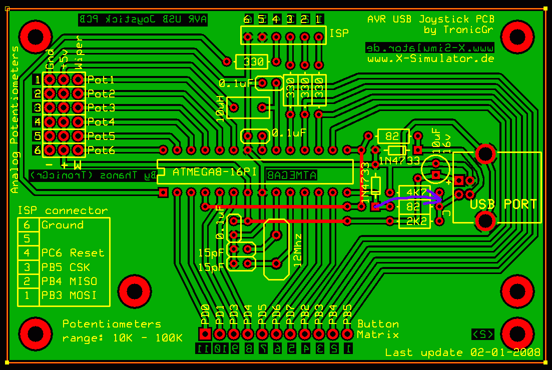

  20. Senetor
    Senetor Member
    Oct 23, 2008
    90
    Australia
    594Coins
    Hi Thanos,
    I have just noticed, that on your PCB diagram, one of the Zener diodes is connected to the wrong end of 82 ohm resistor.
    Regards Senetor.
