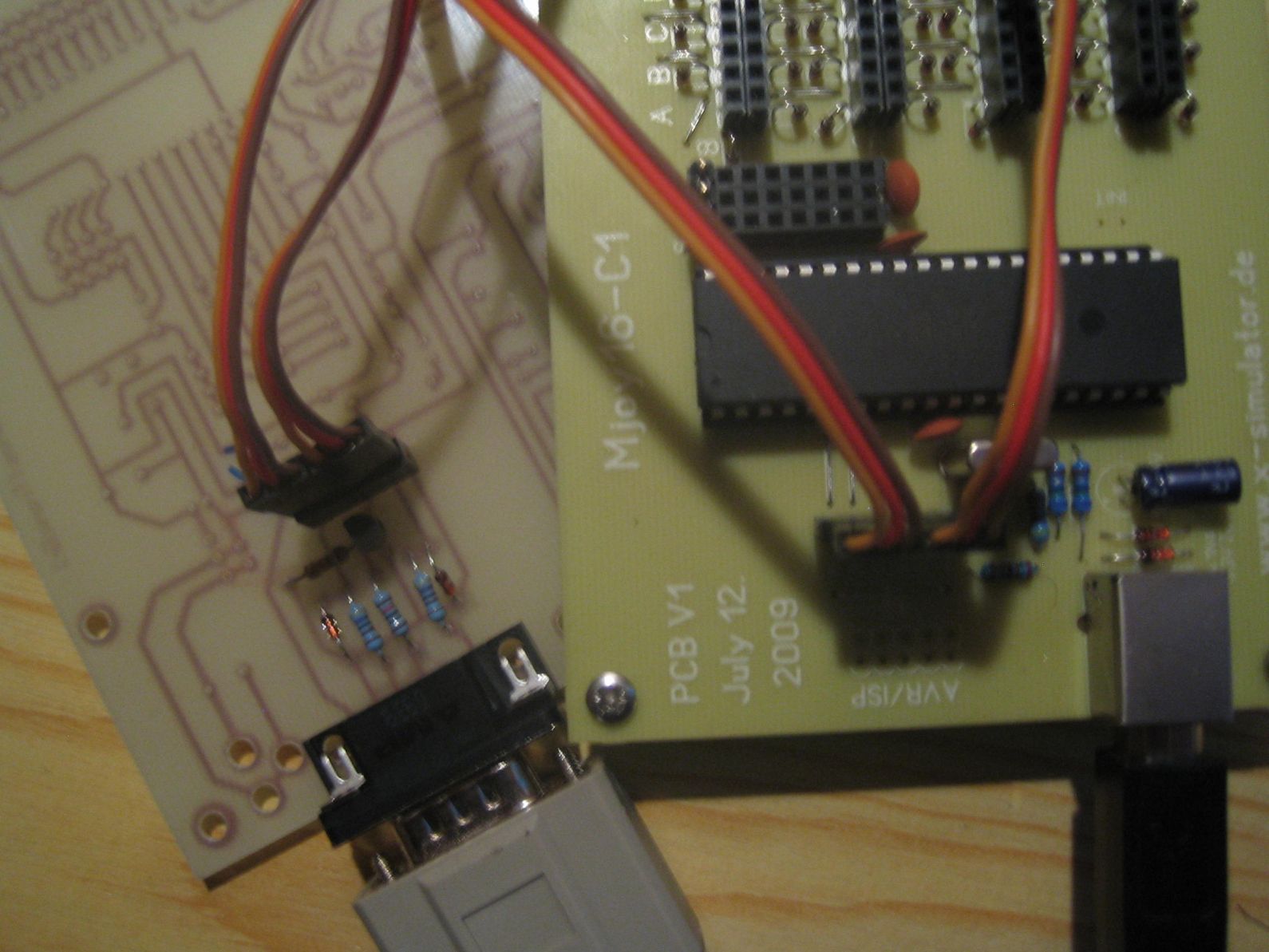

    I have a second amc board and desided to solder just the programming port on it to try to program the mjoy again. Probe says ok, but it is still device missing message.
    So I hope someone could help me because it has to be a small error - the board is pro made. How can i test with my multimeter? Is there any component that can be damaged other than atmega, and is it posible to ruin atmega or locking it with wrong programming? Here is a picture of it: IMG_0051.JPG

    Again, can you verify that the programming circuit is working with an other At8535?
    Are you selecting the right device in PonyProg?
    Make sure you have 5V at the power pins.
    The connections on the Mjoy board are just straight connections to the chip pins, no components in the way.

    I am selecting atmega16 in ponyprog
    Good to know there is no other component in the way, limiting what can be wrong.
    I will try to read on my amc tonight to check that circuit, and also check the voltage. Just thought it was a good idea to solder that prog port only.
    When I tried to program I first tried to read the fusebits, and it seemed to be reading the first time, and I set the fuses posted here. After that I only get this errors. When programming amc the tutorial said first read, then write fusebits, and then program. Now I have tried all kinds of way to get it touch with the chip. I believe the solution is easy, but I just cant find it Update tonight :)

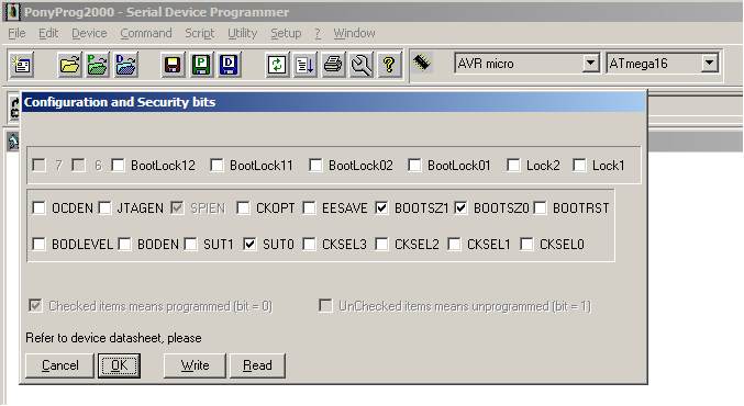

    Ok, you didn't mention that you could successfully read and program the fuses once.
    If you misprogrammed the fuses it would explain everything. Below is how you should program them:
    Note that: Unchecked means Programmed, Checked means Unprogrammed
    From the datasheet: External Crystal/Ceramic Resonator: CKSEL3..0= 1111 - 1010
    As you can see CKSEL fuses have to be all Unchecked to make them 1 = programmed.
    If you programmed the CKSEL fuses all 0000 (checked), then you selected an external clock source. In this case you will need to connect an external clock to the XTAL1 pin (pin13) because the crystal oscillator will not be started. You can try connecting a working At8535 XTAL1 pin to the At16's XTAL1 pin until you can reprogram the fuses as per the above picture. If that doesn't work a stronger clock source ~500kHz - 16MHz will do the job.
    I hope you didn't touch the lock fuses on top. :)

    wow!!! To be honest i do not remember what i have touch or not anymore, but I made myself a note about what fuses to check, and it is like your setup in the picture exept I wrote sut1 instead of sut0, so i guess that is the problem. So what i must do is to place a wire between my at8535 an at16? As a good student I will try for myself to find the right pins. If i need stronger clock source I might need some help to understand it better. So it might not be mechanical after all :D

    The SUT fuses are for Start Up Time, and won't matter too much for operation. If you programmed everything the same then it should work.
    Pin13 is XTAL1, but you should already have the datasheet downloaded. Try clocking it with a working At8535, but first verify that the programming circuit works.
