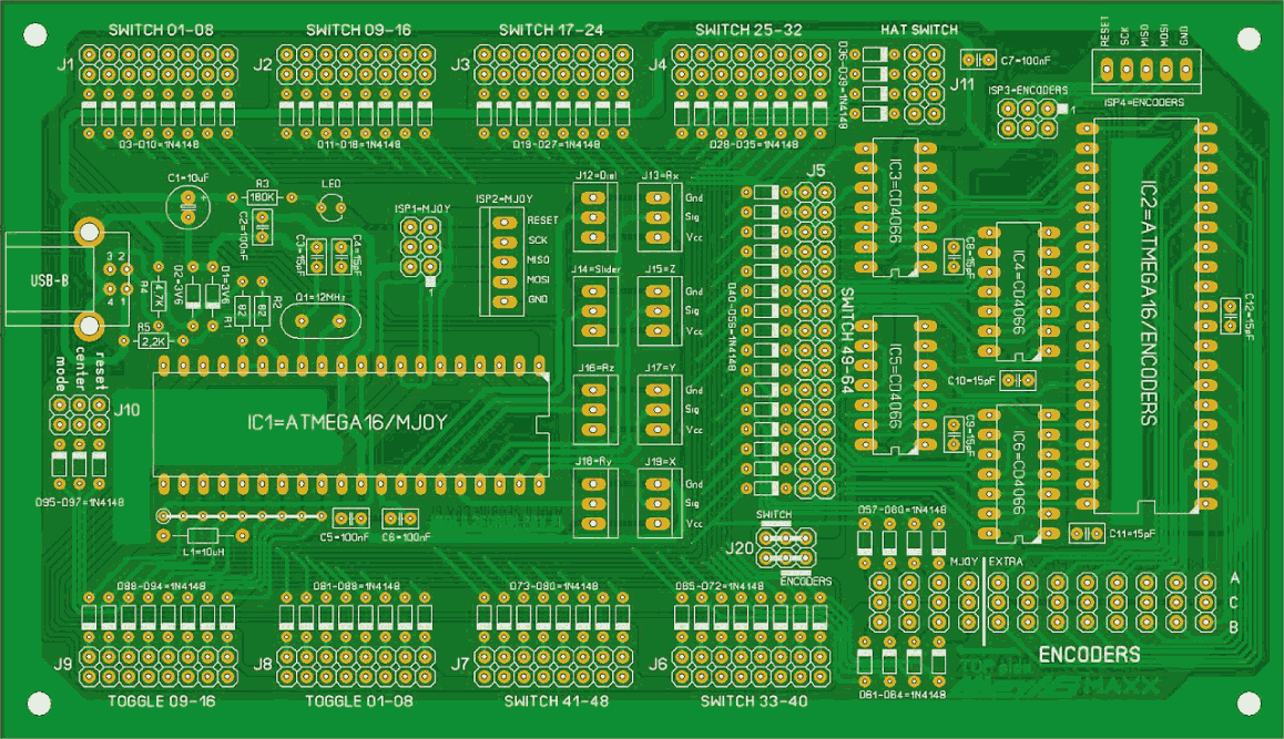

    Can someone help me with this picture and if possibles the files
    Hi Sokol1 you are he light at end of tunnel

    Chandran
    This anti-K.I.S.S PCB is a integrated version of Mjoy16 + Mjoy Encoders - a board that allow add more 8 encoders in Mjoy16. Besides this picture of PCB layout I dont see more files for this version.
    Encoders board for Mjoy16 was developed by Polish guys, they provide files to build Encoders controller in ad-on form, look here:
    http://sites.google.com/site/mjoy16/root/
