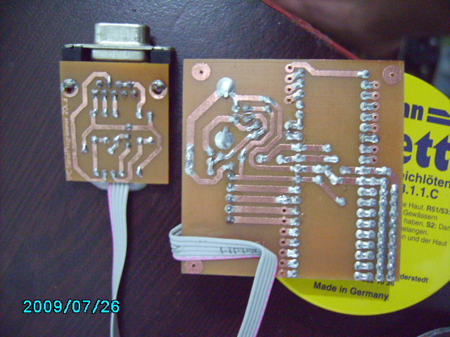

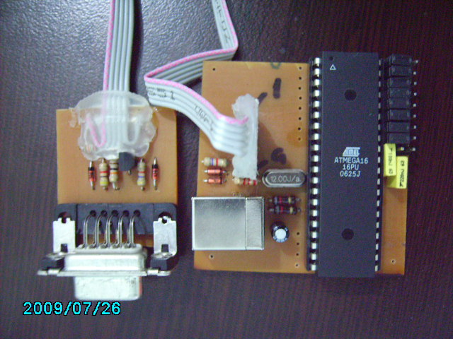

    Sorry for obvious question:
    With AVC programmer, the +5V VCC in PCB is not used, correctly?
    Picture loaned from Erecek. :)
    In this case power for Mjoy is get from USB cable, like with LPT1 cable?
    Imagine that this VCC pin is useful for those that have professional programmers, but don't offer risk for one first time builder, if make mistake in plug cable?
    I think in build these AVC programmer, I have used successfully a LPT1 cable from Mindaugas scheme, but some times I got -24 int error and in 5 Mjoy no one was .HEX transferred in first try... :?
    And suggest the use of this programmer for a local DIY forum.
    http://forum.clubedohardware.com.br/mjoy-atmega8/472888
