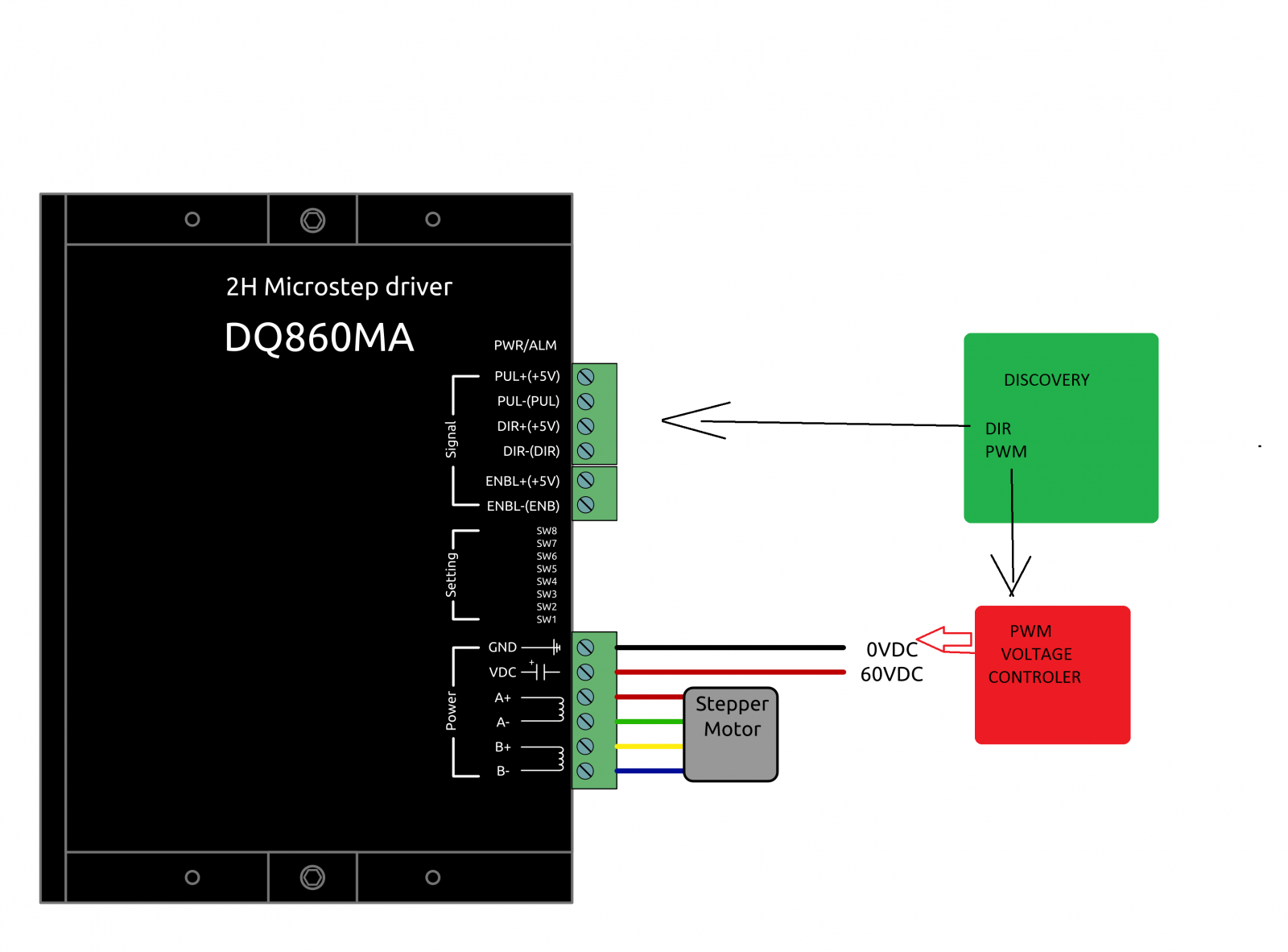

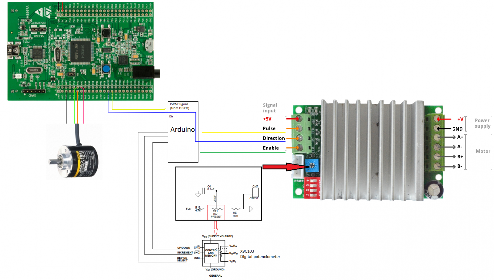

    is this project dead? I`m also thinking about using these Chinese cheap drivers+stepper because the budget is a strong limitation for me LOL.My idea is to buy a NEMA 34 of 8.5NM and driver, which I found for 180 aud on ebay, but I don't have any hardware yet
    I read the whole topic and a possible issue that you guys have found made me think about a different technique to control the torque. One was thinking that the power supply was too weak, and because of this, the motor had no torque. Don't you think this can be the solution?
    what if we use this PWM out of the DISCOVERY to control the voltage supply on the "cheap driver"?
    my idea is to use the PWM direction on the driver to set the correct direction and the PWM signal we could reduce the voltage on the power supply pins of the Driver.This way for a low-intensity effect the voltage would be low, consequently the Direct drive weak, and for a strong effect the voltage would be close to the nominal, and then we would have the maximum torque of the motor. This way all the setting of the interface would keep working normally, and we would be able to set up stronger or weaker effects.
    Does anyone think this idea can work? and have the hardware to test?
    Suggestions?
    Possible side effects?
    so far I believe this can work, my only concern is about the minimum voltage of the Driver, that maybe we would need to respect in order to avoid damage. test.png

    I am not developing on this project any more, and I don't visit this forum very often, so most questions don't get any reply, sorry about that.
    As for your suggestion regarding about regulating the voltage, as far as I remember, the manual for the driver says that voltage only affects the motors speed (RPM), and not the torque.
    The torque is mainly influenced by the current (amperes) that the power supply can deliver.
    I tried hooking the driver up to a variable power supply, and it doesn't seem to make any difference to the torque whether it gets 24 volt or 80 volt.

    You're right, controlling this voltage the torque doesn't change, I would need to control the current of the coil to change the torque.
    I don't know if there is anyone still interested in building something like this, but I will spend some minutes to share what I took hours find out.
    Basic fact - to control the torque we need to control the current(not the voltage as I thought).
    Following this thinking, I made a lot of research and I found that the most of the "Chinese cheap drivers" have current control by chopping the current. The problem then was that the mode of we set this current control is mostly through switches, so we couldn't control it by Arduino.
    Searching a bit more about chopper stepper drivers I found some circuits DIY based on the chip Toshiba tb6600, which can drive steppers using 10 to 42VDC up to 4.5A, and the mode of control of this circuit is via 10K pot, so the plan is to use one of this driver ( I found for 10 aud from China), and replace this pot by a X9C103 Digital potentiometer, so we can control it via Arduino
    PS: As the intention is to build the steering wheel not the driver I'll jump this part and buy one of this,(if someone is interested just let me know that I can share the project of this driver and some more information that I found about Chinese drivers, because I am convicted that we can use this "mod" in any driver)
    Cheap Driver Alternative.png I will copy the main idea of this post, use an Arduino to convert the PWM coming drom the DISCOVERY board into a percentage of torque( or percentage of Amps applied to the coils), controling this way the toque
    the direction signal I will use to set direction and a constant speed, sending pulses to the driver ( I'm not sure about using a constant speed, but it looks like this is the way the commercial FFB wheels work, constant speed and variable torque depending on the effect)
    I would like to listen to a second opinion about this crazy plan. Do you guys think this would work? any suggestion about the circuit or the mode of control?

    Hey mate. I'm still waiting for some stuff from China. I got my discovery board and made it work with my arduino. I'm using a Chinese clone of mega2560 and I made a program to read the pwm from the DISCO and depending on the duty circle control the digital potentiometer and send pulses to the driver to rotate the stepper.
    To proceed I need my stepper that is coming from China to test the current modulation but I believe it's gonna work

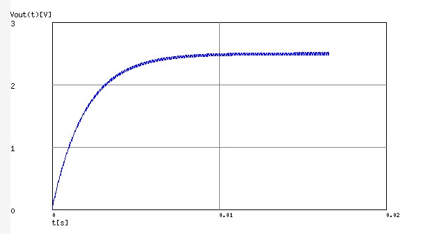

    Mmos have h-bridge mode.
    Two Photocouplers convert the signal to +-signal.
    And simple low pass filter make it +-analog signal.
    Photocoupler must be totem-pole output type.
    I use TLP2366.
    Low pass filter is configurated with two 1000Ω and 1uf.
    0%→90% 4ms
    About 1% min force is need at MMosForceFeedback2014.
    Maybe better two order low pass filter.500Ω×2 and 1uf×2.
    This is work well.but my motor is only 1.3 Nm max3.9 Nm(300%).
    I do not know if it works well with a big motor.

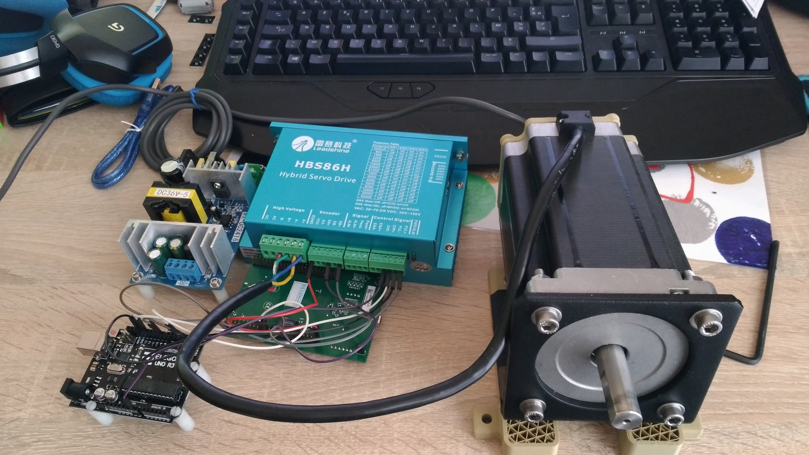

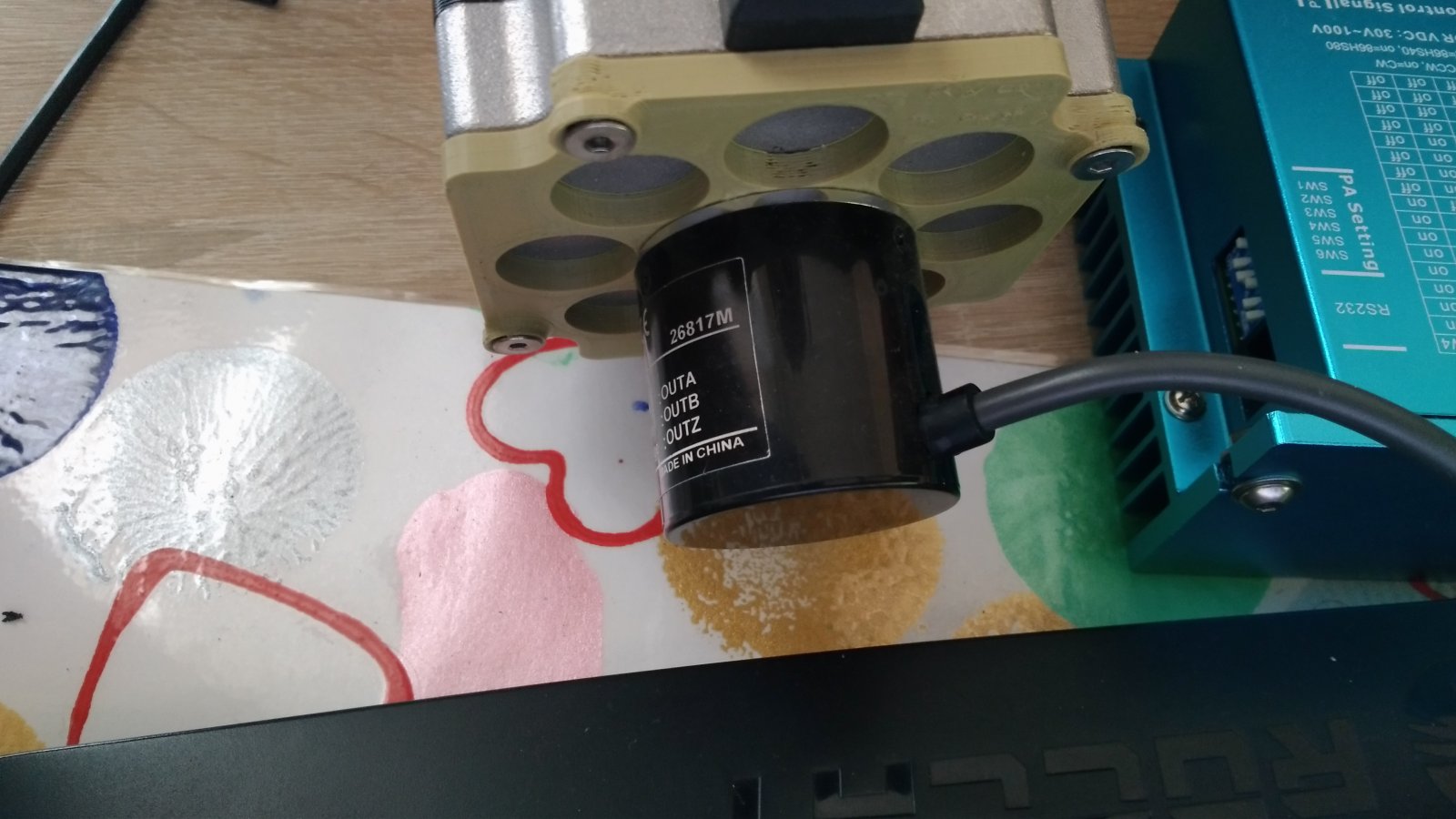

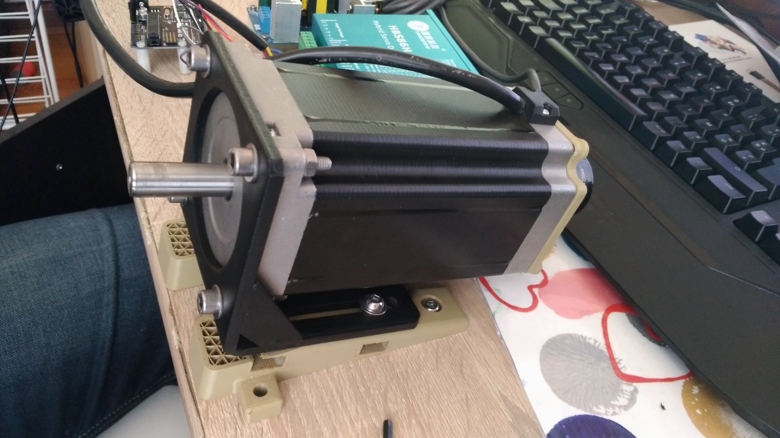

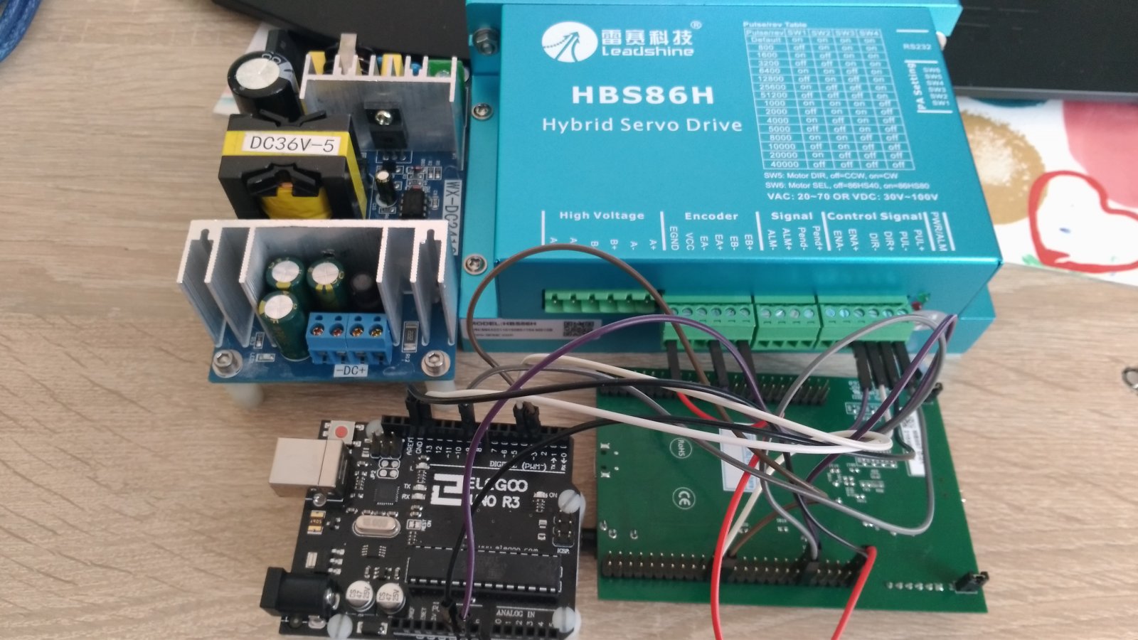

  14. Nonorfs
    Nonorfs New Member
    Feb 29, 2016
    fre
    187Coins
    Hi all
    First of all, what an amazing project ! Great work.
    I start to make one.
    I earn all the most important part ( waiting for the case, fan, dc converter for fan, ... ).
    I have a problem with the encoder.
    I don't know how to plug it on the driver.
    I have some basics on electrical.
    My encoder is the Omron E6C2 CWZ6C
    I think that output A has to be plug with EA+ /// output B with EB+ ( Is that right ? )
    But how i can plug the Z output ??? on the leadshine HBS86H.
    This motor is the Nema 34, fix to my desk with an home made 3d print part.
    The encoder mount is also an home made 3d print part.
    Thx for your help.

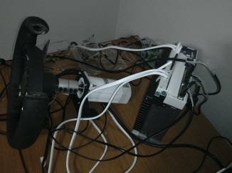

    Here is some news.
    The casing is finish.
    The FFB is recognized by all cars game ( pcars2 , dirt 4 , ... )
    It can turn wheels when ffb is off.
    I have some trouble when ffb is ON.
    I think i found the problem and try to solve it as fast as possible.
    Just for information when the ffb is ON, it will be very hard to turn it by hand ( i think ffb is at max due to bad wiring of my encoder ), maybe at 13Nm ( the max of the stepper motor ).
    I left another feedback asap.

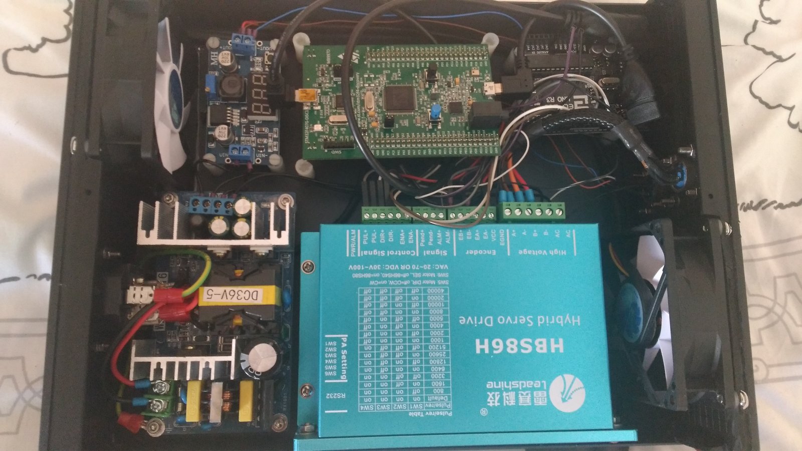

  17. danove_b
    danove_b Active Member
    Nov 11, 2017
    209
    Sweden
    1,782Coins
    +80 / 3 / -0
    Kind of interested of how you guys have succeeded with your projects. Have any of you considered trying to find the PWM signal inside driver (HBS86H) that controlling the current flow/torque? Shouldn't be that that hard to find by follow backwards from the MOSFET drivers using a oscilloscope. Hopefully there is a common PWM for both winding that are gated with other outputs from the CPU. If so, you could replace the signal directly with the PWM signal from the MMOS. (Running the MMOS in PMW/Dir setup)

    I guess this is the way RufusDufus gone in "Son of OpenSimwheel", but it's quite hard and risky...
    An other solution is to try IonI Pro driver that is compatible with Stepper motors. It costs around 350€...
    I am waiting for the RJ45 cable and will try Sikjar solution with my Nema 34 and ACT-motor HBS86h driver.
