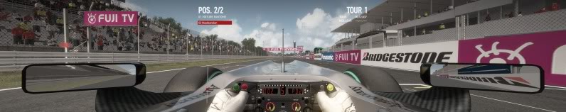

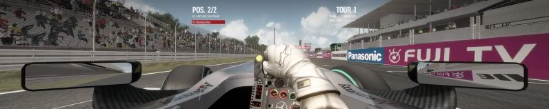

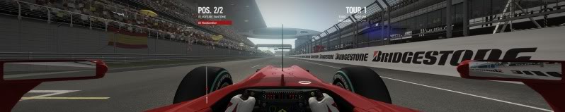

    Hi Bleco,
    I tested your 2 latest camera files and I don't like the Ferrari one because it feels like I'm sitting on top of the air intake....LOL
    The Williams view is great and gives the best feeling of speed and realism of all the views I've used so far. The only things I don't like are the side mirrors are too far back with this FOV and the center point on the car is a little distracting as it feels like it's right up in your face at times but once you get used to it, I think this FOV enhances the experience. I will post a video of this view shortly for comments.
    ...Mike

    Using the first file I shared for Ferrari looks and feel very good on the other cars... Only the FOV value was set to 41.0000
    Will stick with this one I think for now even if it needs a little adjustment on certain cars... I tried all sort of combinaisons and now I want to play this game!! I spend all my time modding it and I dont' play!! Same thing happened with NFS Shift!
    @ Ledfoot : Essentially I play with the FOV value, x-y-z positions and tilt.
    I also can't wait for the Williams F1 in Iracing!!

    Thanks. I reviewed the williams file and saw the changes. I played around with the FOV and seat position y value until I found what I like.
    This file has a FOV of 38 and a slightly lowered seat position than your williams.xml file.
    I'm been modding as well and not playing half as much I want to so I'm also going to stick with this cameral for all cars for the time being and start my F1 career :).
    Thanks for the help.

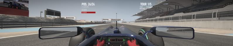

    Great vids Mike ...
    guess what ... I worked on another cam mod until 2:30am yesterday and did not even play!!
    Here is a small preview vid showing my lattest cam mod adjusted for triple screens setups ...
    Cockpit shake effects and accel/braking dynamic FOV... 8)
    Still need to work on it but so far the feeling is great and very immersive and this FOV is by far the best I have created.
    Bleco
