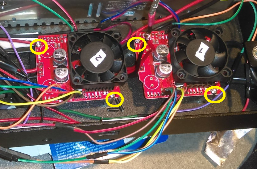

    but
    they are wiper motors are far as i no there from motion dynamics and they do have a wire to the case.. if i dont cut the wire to the case it puts 12v to the frame and the whole sim is live..

  4. Evan Rowlands
    Evan Rowlands EMR Industries
    Jan 22, 2017
    190
    business owner/ EMR industries
    Melbourne Australia
    - 82Coins
    +33 / 0 / -0
    cheers mate like ive said its the the grounding of motor 2 and the shaking thats my issue..but as pit and yourself have said it could be the screws ill grab some plastic washers and try again..ive bought a sabertooth 2x60 im waiting for it to show up.. looks like a simple opion and less wires
  5. Evan Rowlands
    Jan 22, 2017
    190
    Melbourne Australia
    - 82Coins
    +33 / 0 / -0
    that i have no idea on ... i bought them from the local jaycar electronics store..they look like normal screws to me..ill go and get some plastic washers and ill put them under the stand offs and the screws cheers brother .. its the first metal case ive used might be the last to .. thanks mate im waiting on the sabertooth to show up soon
  6. Evan Rowlands
    Jan 22, 2017
    190
    Melbourne Australia
    - 82Coins
    +33 / 0 / -0
    ive been told that the screws might be the issues so im head down that path now

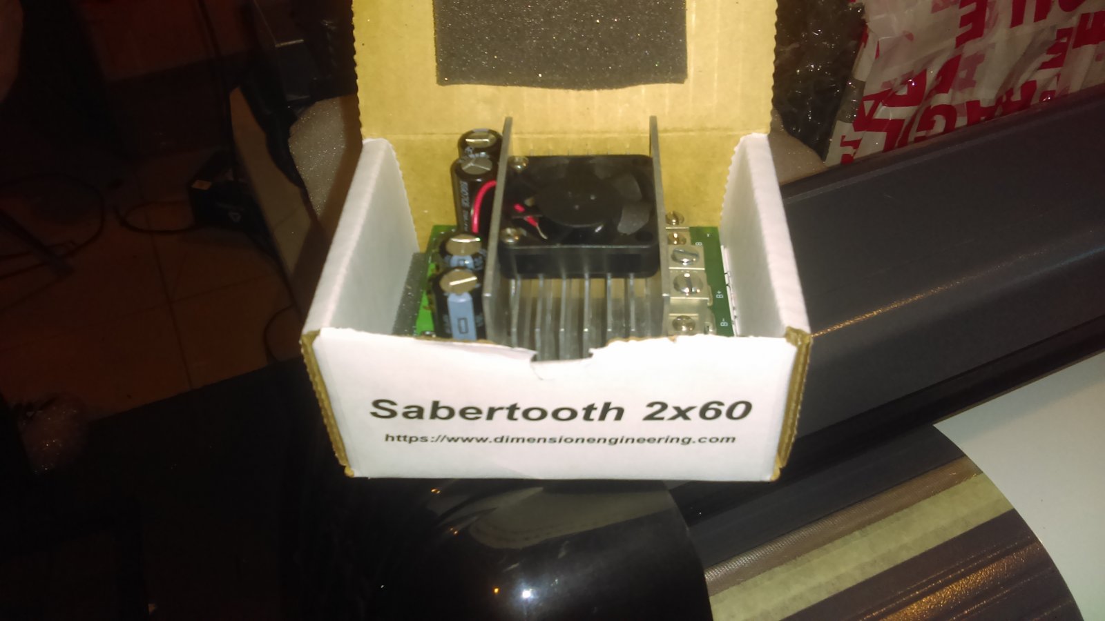

  7. Evan Rowlands
    Jan 22, 2017
    190
    Melbourne Australia
    - 82Coins
    +33 / 0 / -0
    got home to this bad boy

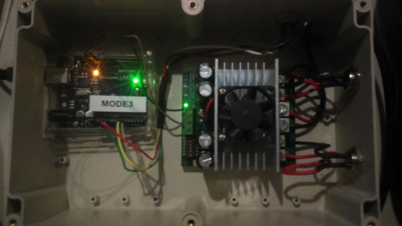

  10. Evan Rowlands
    Jan 22, 2017
    190
    Melbourne Australia
    - 82Coins
    +33 / 0 / -0
    POWERRRRRRRRRRR!!!!!!!!!!!
    Im happy to report that ive got it working no problem in testing with a multi meter.. ive also hooked a motor up with the pot joined to it and the motor goes backwards and forward.. if i turn the pot to meet the green line in smc3 it stops.. so im very happy.. i output tested in simtools with the meter again and i had output.. i went into no limits 2 roller coaster sim and left the meter running.. its outputing great so next step is to fit to my sim and load test it.. very happy so far... much better and easier to use than a mm i think..
