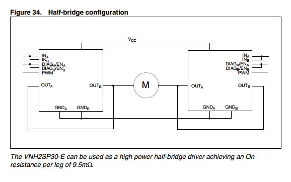

    Obviously you have it working so my previous concerns are unwarranted... I did check the datasheet for the output drivers and they say that they can be used in pairs for more power so you're definitely on the right track. They do however recommend using one driver for each half of the h-bridge rather than putting them in parallel (similar to the schematic posted by BlazinH). Both ways should give the same output power. While the parallel output works it "may" reduce the life of the drivers - but I can't be sure.
    Here is the example from the datasheet, it seems to be just a minor rewire to connect this way.... But you seem to be having more fun and learning more just taking some risks! :grin Keep us updated.
  5. Pit
    3,007
    30,516Coins
    +3,098 / 31 / -0
    @RufusDufus nice to hear that :) The datasheet seems to be just different from what I expected. The sheet shows A and B connected - different from what I did. But the power meter doesn't lie I believe so :) At least it works. I ordered 3 samples from aliexpress, perhaps the Sabertooth 2 x 60 is already history p:

    The wiring you drew is accorded to VNH specs:
    so, finally you rewrite your first post to follow the specifications of VNH instead of your first tests?
    PS: the same can be done with 2 VNH3SP30 to allow 5.5-36VDC power supply!
    Here is a link @9€ from Olimex = 18€
  12. Pit
    3,007
    30,516Coins
    +3,098 / 31 / -0
    Indeed. To avoid any short circuits they are wired as described above.

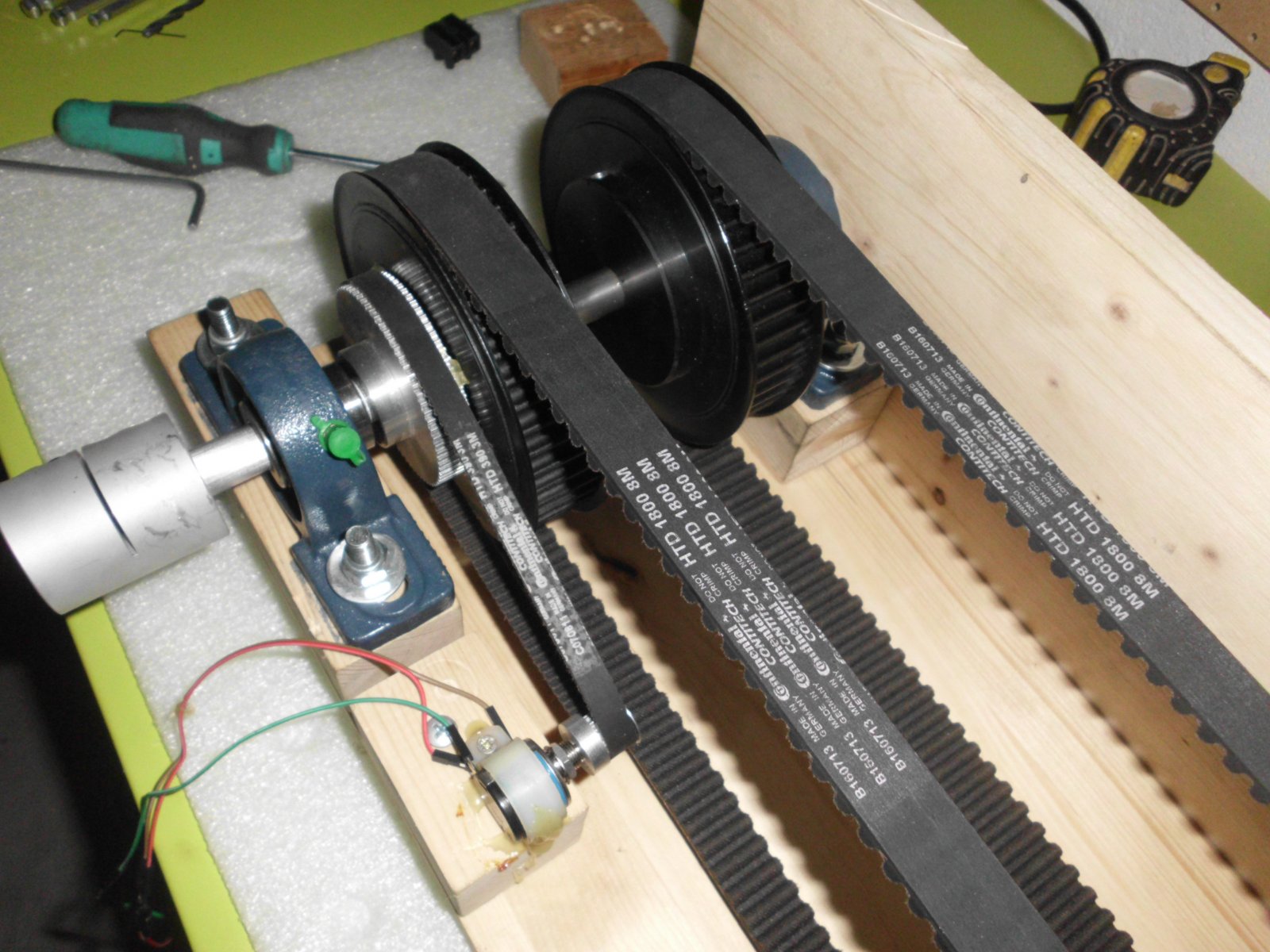

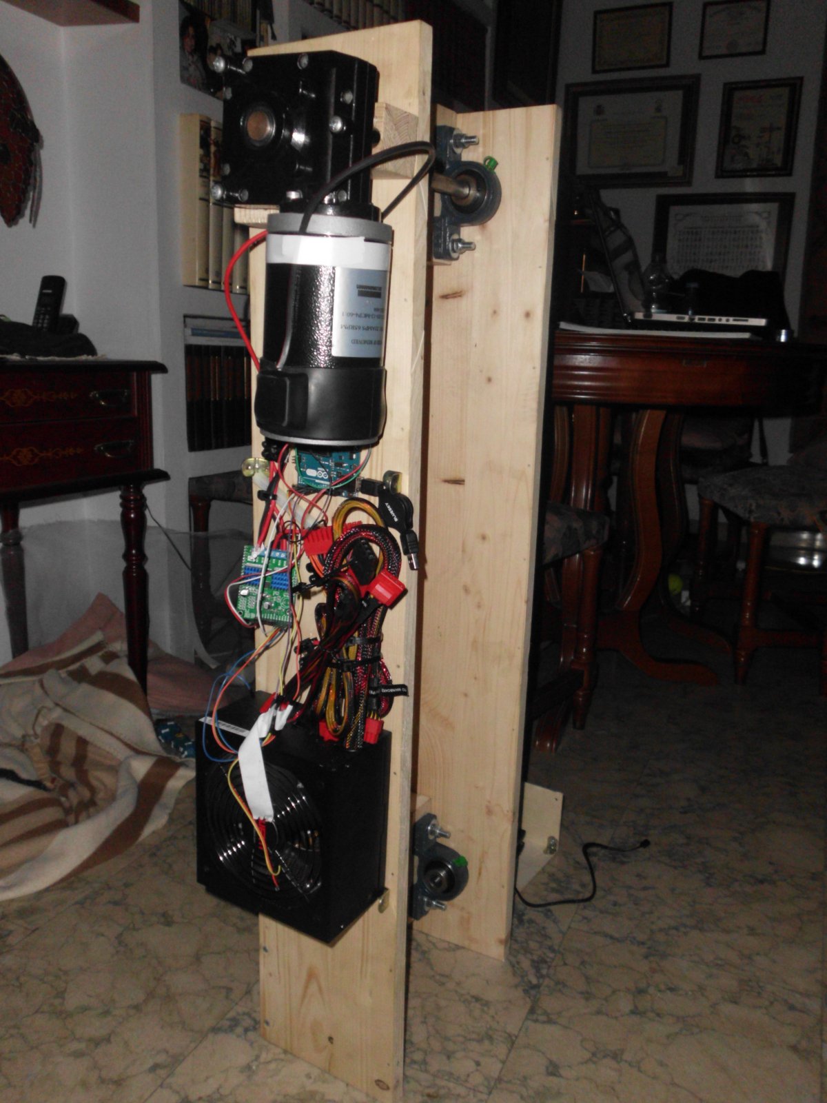

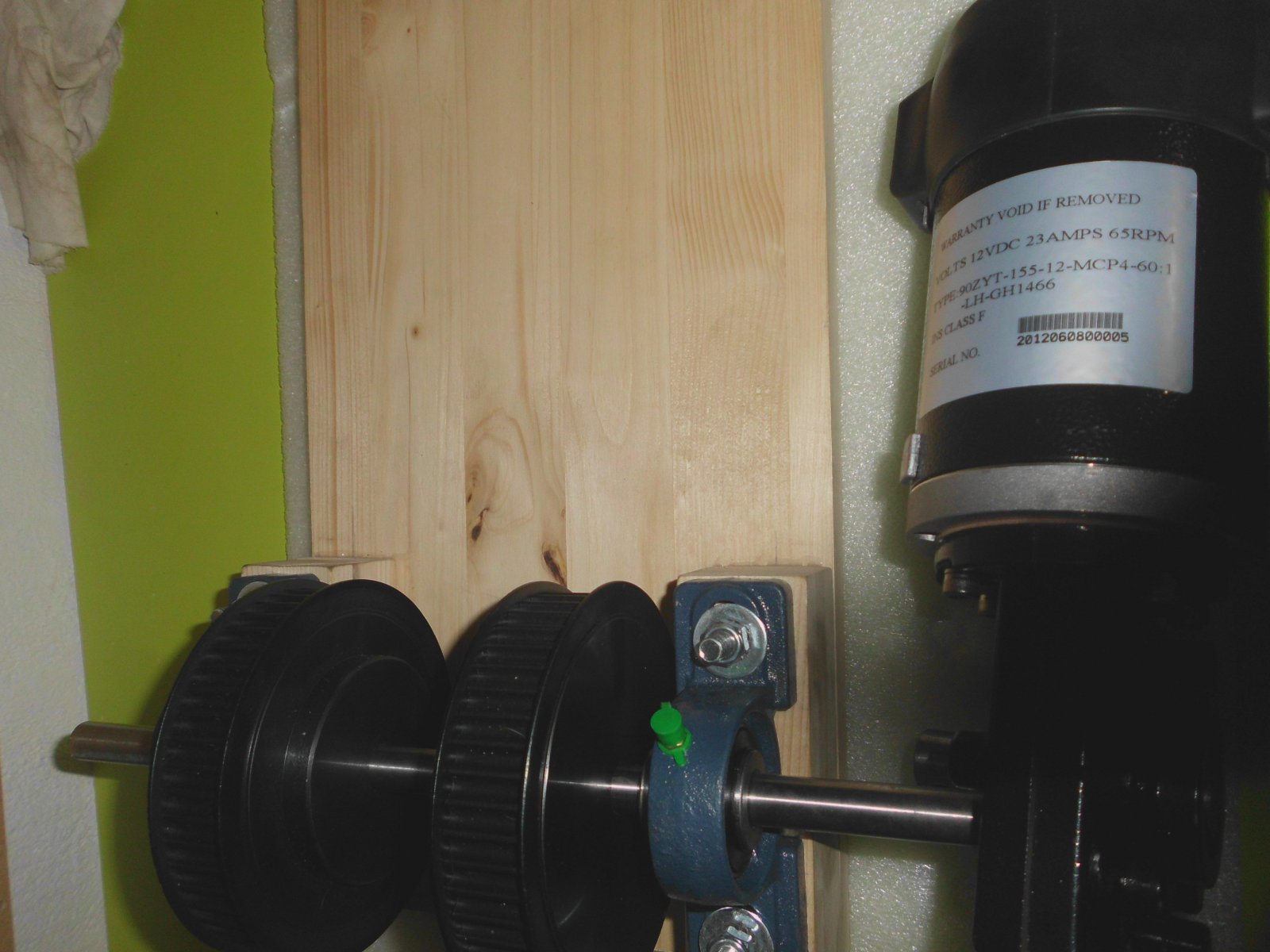

    @RacingMat I love to read specs ^^ spent whole nights on it. Well i'm building a nice lineal actuator
    http://www.xsimulator.net/community/threads/dc-actuator-design.5762/page-2
    I'm using those new MotionControlProducts ZYT-90 motor with the 60:1 wormgear. Check it, it is 23A const 48A peak., huge power, 276W . I've already burned 2x pololu dual VHN5019, 1 my bewbishness 1 because headers * 70Amps arent friends.
    This is why i'm looking for some alternatives at the dual 5019 driver. Sparkfun MM is more expensive than dual 5019 and aliexpress MM looks shitty.
    @Pit Cant see the video, Have those been working for months?.... The video preview seems you have a smaller motor.
    IMG_5204.JPG Motor here
    IMG_5447.JPG Global overview, no Pulleys yet.
    Everything is on my post, when electronics are working i'm updating it, I dont want to post em here ^^
