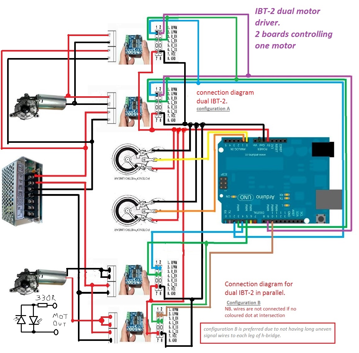

    I am trying to wire two IBT-2 for one motor, but I have a wiring question :
    Do I wire like this :
    IBT-2 (1) :
    IBT-2 (1)= M+ to Motor +
    IBT-2(1)= M- on M- of The second IBT
    IBT-2 (2) :
    IBT-2(2)= M+ to Motor -
    IBT-2(2)= M- on M- of first IBT
    And
    IBT-2 (1) :
    IBT-2 (1) B+ To PSU V+
    IBT-2(1) B- To PSU V-
    IBT-2 (2) :
    IBT-2(2) B+ To PSU V+ ( Same output as IBT (1) )
    IBT-2(2) B- To PSU V - ( Same output as IBT (1) )
    Is this correct ?
    Or do I need to plug the PSU +/- on only one IBT-2 B+/B-, or even something else ?.
    And of course The inputs from arduino together...
    Thanks,
    Rémi.

    No that wiring is wrong...
    First of all why use two IBT-2? one of them can deliver 43A? I use those on my CNC machine. They are limited to 26V I think...
    Just use one... What kind of motor are you using? If you really need to use two you should connect everything in parallel. But even then current sharing is not guaranteed. Even two devices are not the same and one of the drivers will be conducting more current than the other...
    I made a driver for my simulator and I made a H-bridge from scratch. I used IGBT transistors and that thing can carry alot of power. I think I over designd the thing because it can drive about 600V and 50A :)
    So if one IBT-2 is not enough for you, I think you should build a H-bridge. I don't know of any ICs that can carry more juice... Maybe I'm wrong :)

    The IBT-2 driver which uses 2 half bridge bts7960b chips are actually rated at 18v@43A, infineon in their deceptive data sheets have max Vs of 28v but will definitely not put out anything close to 43A at that voltage. In other datasheets for the same series of chips they list 2 values of Vs, they are 8v-18v Vs(nor) and 18v-28v as Vs(ext)
    I wouldn't recommend using dual ibt-2 if your going to exceed 43A@24v due to reasons given by tadythefish in previous post.
    I would use dual ibt-2 if I was below 43A but was having heat issues, using 2 drivers not so much increases amperage but reduces (halves) Ron resistance and therefore shares the heat dissipation between the 2 drivers.

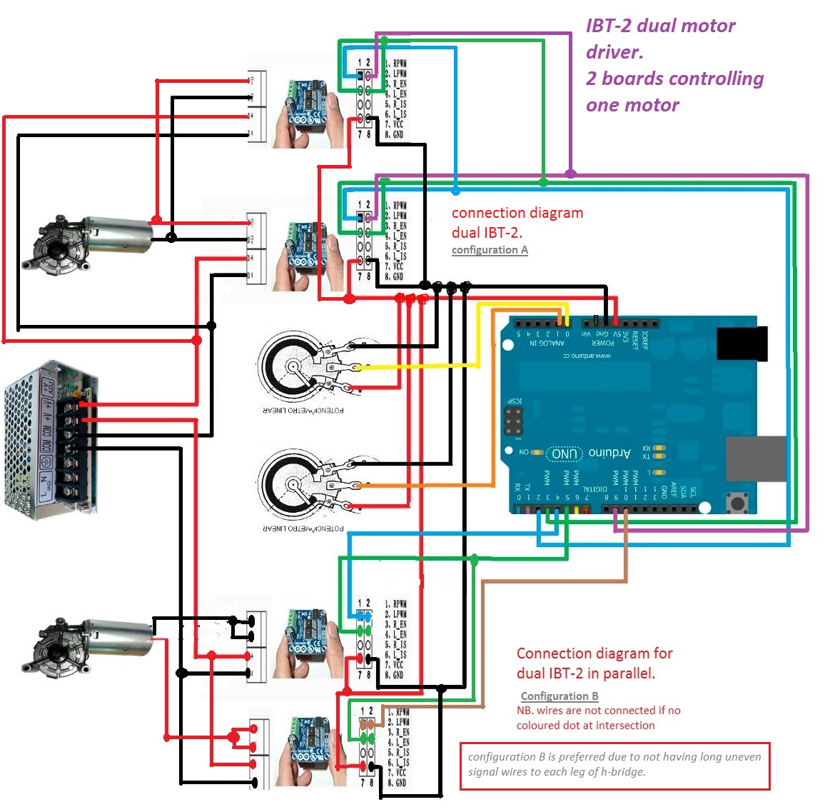

    Anyway I modified a picture from smc connection diagram and have drawn the 2 methods of connecting dual IBT-2.
    Configuration B would be the best method as you don't want to add to the different switching times due to differing lead lengths.
    NB I haven't tried using IBT-2 but be aware that if a leg shutdowns before its paralleled twin switches on it could cause a short to the motor outputs, hence why you still don't want to exceed the ratings.

    Mine work at 24V with no problems.. I don't draw anything near 43A. I think mine work at 20A max and about 10A constant without using fans.... But i wouldn't parallel them.
    Mosfets inside have a positive temperature coeficient (with rising temperature the Rds increases) but that doesn't guarantee proper current sharing!

    Tadythefish : Why two IBT'S ? Because my motors draws alot of amps for the reverse ( they are MY1016 : 24v/15A with a 1000w/24v psu ) I guess it cause when I plugged everything and I increased PWMmax in SMC3 it made a little power shutdown when motors go reverse when above PWMmax=70, and when I did put it even further like a fireman in want of action : PWMmax=130 they got hot and one side of ibt burned
    Congrats for your H-bridge, if the experiments doesn't go well and I burn the other 8 Ibt's I received I will consider doing the same for sure.
    For the Motomonsters Silent-Chill had some issues with those, check his thread about it : CHEAP CHINESE MONSTER MOTO CLONES AND PROBLEMS
    OZHEAT : Thank you so much ! It shouldn't exceed 43A/24V because my power supply is 24V/1000W/42A
    Pit : Do you mean the OZHEAD wiring ? Yes i'm gonna try this, with less powerfull motors and PSU and with thermal paste on the IBT's first, then on the MY1016+1000W PSU.

    I did some tests following OZHEAT wirings :
    A wiring : Works good, I tried first with little motors + 12V PSU, then on T-1000-24 PSU + My1016 motor. Played a bit with SMC3 values, making motors move break and reverse several times, fastly and slowly. Nice, it didn't get hot or anything. Bravo !
    B wiring : Did not work, tried only with same little motors and 12V PSU. Double checked wiring, did it all again, still Nothing, either in SMC3 Mode 1 and Mode 2.
    They didn't burned or got hot.
    However, with the T1000-24V PSU / MY1016 / A wiring Parallel IBT's ( with thermal paste on it ) when above PWMmax=80 my PSU still shuts down briefly when braking or reversing, I guess this PSU is not powerfull enough ( even with only 1 motor + parallel Ibt's wired ). The Ibt's had no problems and didn''t get hot. So my next adventure is to find a PSU that will suit better ;) .
    Thanks,

    I will, as soon as i put the pieces together again, gonna take some pictures of the frame/sit assembly and chain reductor too, it could interest some as it is mainly made from wood and wood turning on the lathe.
    For the Parallel Ibt's wiring on FAQ we have to remove the B wiring and do the A drawing for motor 2 aswell on the picture for it to be clear. Either me or the original author OZHEAT if he prefers.

    As for config B not working, did you connect pins 1-2 & 3-4?
    There is no good reason why it would not work, you can think of each bts7960 chip as a half bridge (the vnh2sp30 is a full bridge per chip) changing the usage configuration makes no difference to the chip as there is no interactions between each half bridge.
    Do note that each chip has its own protections and limitations and will shutdown/disable independently of other half bridges.
    Maybe you can test configuration B just using both left channels ie in standard mode but moving the second half bridge to the second board. If that works you can then start to parallel them, a quick tip leave the motor outputs unconnected and test voltages, better still is 2 leds back to back with a 330R resistor connected to motor outputs.
    Smc3 uses the pwm to switch the left half bridge only and directly switching the right side.
    As for the faq, try config B again as that is the config akin to what pit used on the mms and my preferred method aswell.
    After that you can redraw and post your findings. Please do point out that the IBT-2 is a Driver, not a Controller.
