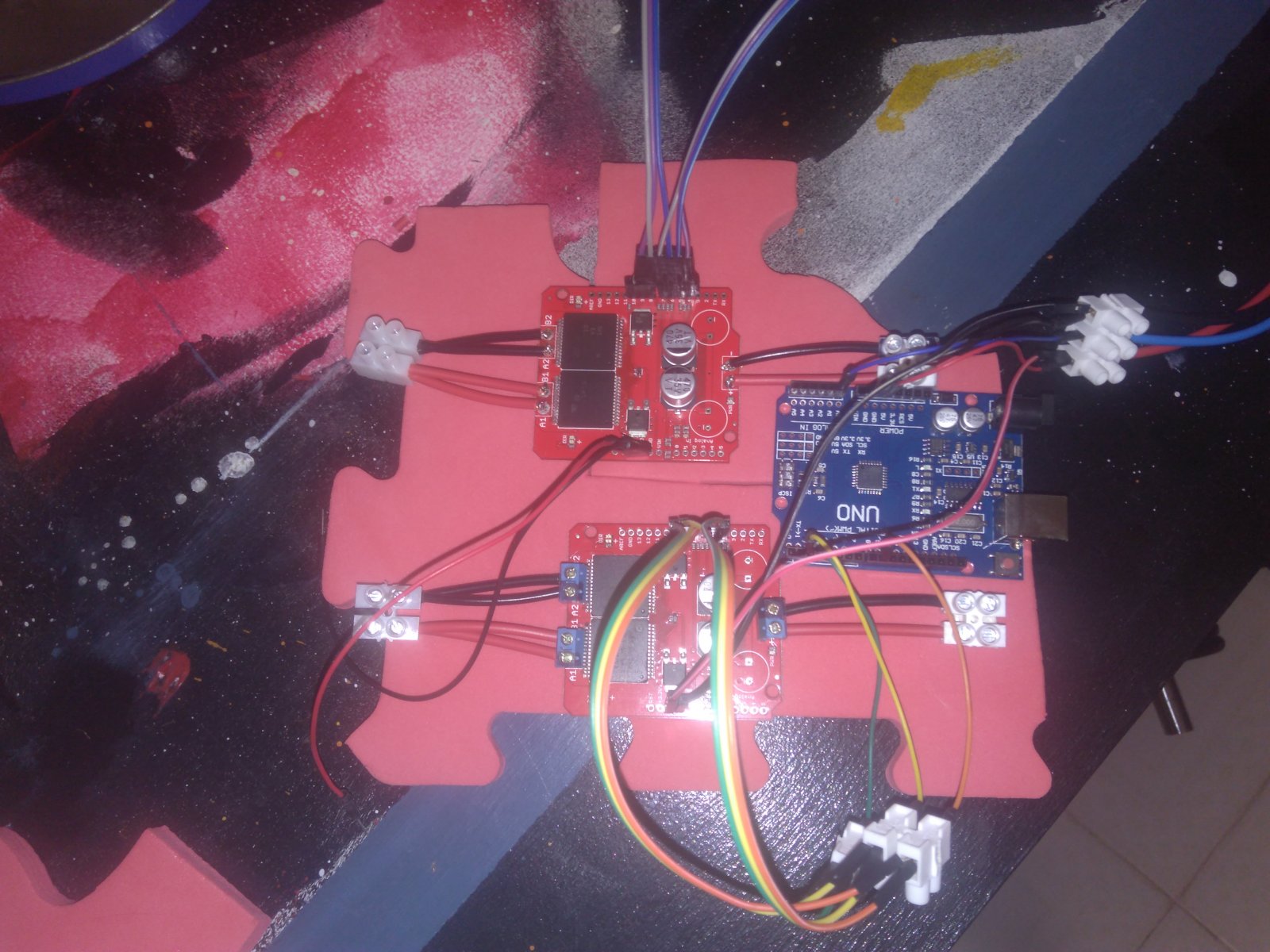

    Here is a picture of my old 2dof controller... I have tried it with arduino and potentiometers on the shafts but I was not happy with the results... This one uses encoders on the motor shafts and a 1:49 gearbox... This one was used in the video I posted earlyer. When I was buidling the controler I wasn't sure if a single arduino was fast enough. The code must run with enough headroom so the microcontroller can capture both encoder pulses (A and B). This is done with interupt rutines, so if you feed too much pulses (two encoders give you twice as much) the microcontroller does not have time to capture and interpret data from the serial port and do the PID calculations.
    And I had two nanos laying around :))

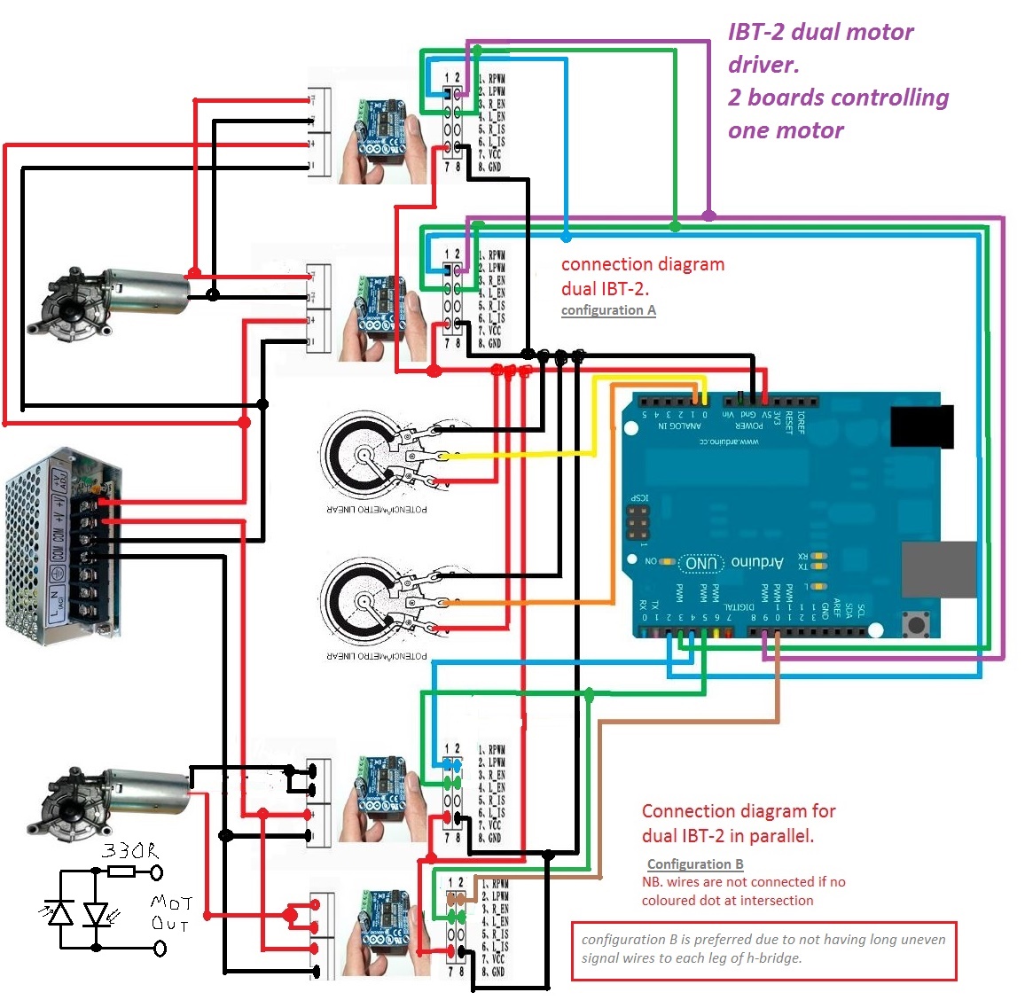

    I am trying mode B again, and it works this time.. But ! For one motor ( as I just pluged one at this time ), when I turn a pot both "sides" motor goes in one direction only, and when I move the other pot in both "sides" the same motor goes in the other direction so I guess there is Something with the L&R wiring, have you got any idea ? Would it work better if I put SMC3 in MODE1 instead of mode 2 ?

    I don't think so the motors I use are reversible as they are printer 12v little motors, they work fine in Configuration A wiring : turning both sides.
    I guess it is Something with the L&R PWM on the IBT as they are on only one PWM on the arduino : Arduino PWM10 to IBT 1/2 L&RPWM.
    in the A wiring the L&R PWM on the IBT's are on two PWM on the arduino : Arduino PWM2 on IBT 1 ( RPWM ) and Arduino PWM 9 on IBT 2 ( LPWM ).
    R_EN and L_EN are the same in the config A and B
    Edit : I have been thinking since yesterday and the wirings of mode B should work as it just moves a half-bridge to another board, I am gonna do some more tests and use left side only as recomended by OZHEAT !
    Edit 2 : Oh Well, I am embarassed because I have to learn to count to 10 again, maybe above if I get good to it, I miswired/checked many times Arduino PWM9&PWM10, was inverted... Funny guy !
    Edit 2.5 : working fine for one motor.
    Edit 3 : Had some trouble making B layout work with two motors now.
    It work when unplugging R_EN on all four Ibt's or at least two of them :
    - One motor (1) works ( both sides ) if I connect R_EN on motor 1 IBT's wired on arduino PWM 3
    - One motor(2) does no work ( only one side working ) if I connect R_EN on motor 2 IBT's wired on arduino PWM 5
    - Two motors does work ( both sides ) If I unplug R_EN on Motor 2 IBT's coming from arduino PWM5
    - Two motors does work ( both sides )if I unplug All the R-EN ( coming from arduino PWM3 and PWM5)
    Then I tried pluging all the R_EN back and disconecting the L_EN the same way, didn't work that much. For now everything works with all R_EN beign disconected.
    Edit 3.5 : To resume,
    Everything works until I plug IBT PIN3 ( R_EN ) On motor 2 / IBT wich goes on motor RED wire.
    If I wire the IBT PIN3 On motor 2 / IBT wich goes on motor BLACK wire everything still works fine
    The Strange thing is that the motor 1 works fine without having to disconect the R_EN on the IBT with goes on Motor 1 "positive" side.
    Any idea of what is going on ?
    Edit 4 : I changed the IBT on motor 2 positive side, now everything works. in config B ( can work with A aswell ).
    I checked the back of the IBT and the solder of the pins have a short beetween Pin 1&3 bad factory solder, gonna un-short them, maybe it can still work..

    Remi, good to see you got it working.
    You should have tested individual ibt-2 before trying to parallel them.

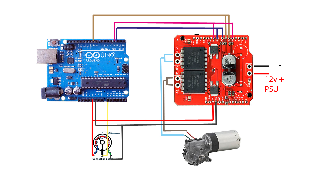

    Hey @Pit I wanted to give this a try since I got two monsters left and some Arduinos.
    I got a doubt: is the scheme right? from MM to motors ==> A1+B1 and A2+B2?
    Shouldn't it be A1+A2 and B1+B2?
    Just to be sure cause I just got two MM and have to order some new ones.

    The other way is also working if the Ard is wired in a different way, BUT this kind of single driver schemata is not supported by the fact sheet ergo please follow the advise you have quoted above.

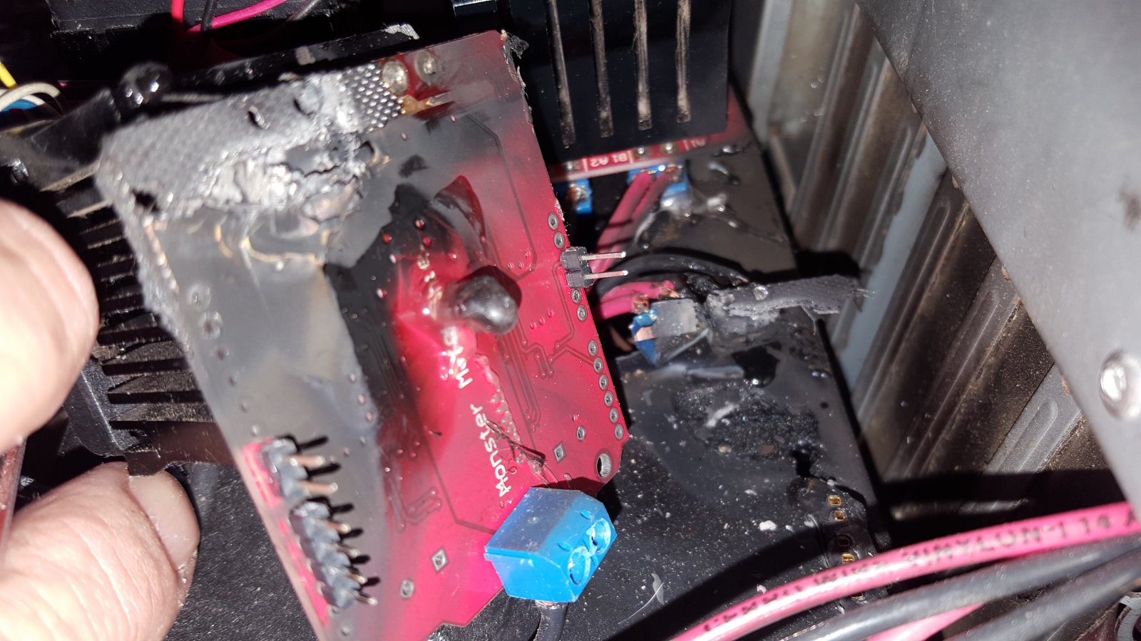

    I wouldnt trust the screw terminals. it stinks a bunch when they cause a fire........lol
