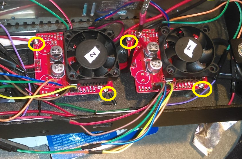

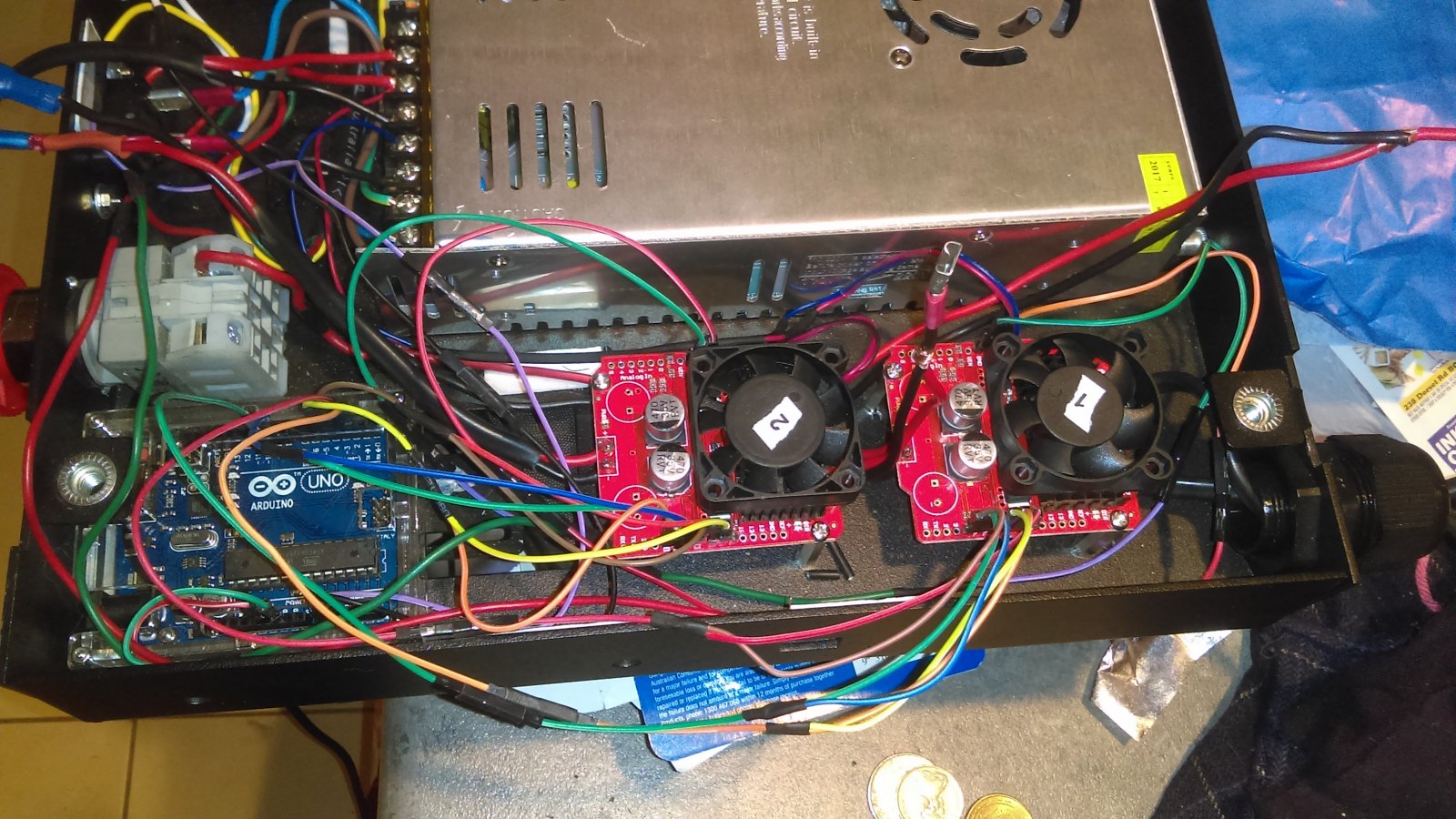

    what ive already done is unbolted the motors and i tested them off the frame motor1 works fine motor 2 doesnt work until i touch that extra wire on the earth on the power supply..same as when its mounted.. ill take afew pics of the box and post them give me a sec brother

    the black wire is the one ive add from cutting the wire that was grounded to the body of the motor .. i use the black and the blue wire for motor 1 and the same for motor 2 But i have to gound the white wire for it to work..ive tested it on all 3 of my sim that are all working fine and i have the same issue everytime so 6 motors in total ive tested it on

    sorry i'm wrong and they are wiper motors, the motor needs ground isolation.
    Are you sure the motor isn't internally grounded? There could be a connection from one of the brushes to case and black wire.
    try connecting high speed blue & black wires directly to a battery, it should run. Now with your multimeter on volts, one probe on +ve , put the other on the case, there should be no volts on the meter. Swap the black & blue wires and test the same.
    If that all works ok then it is probably the MMs. Does act the same in non bridged mode?
    Yes, do put fibre or plastic washers between board, if your screw scratches the solder mask it can cause shorts to gound.
