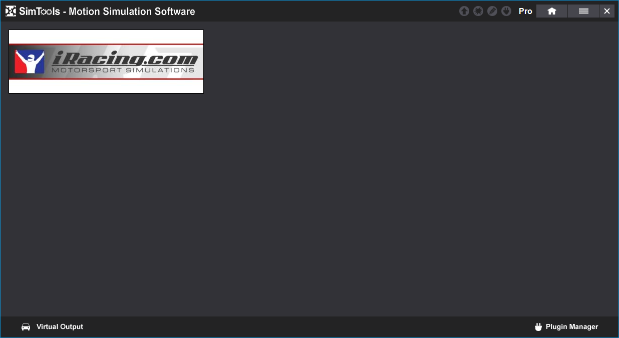

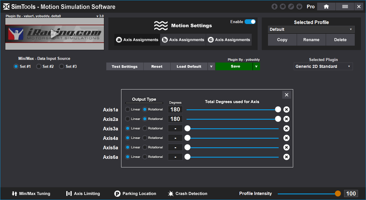

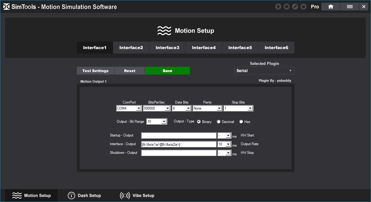

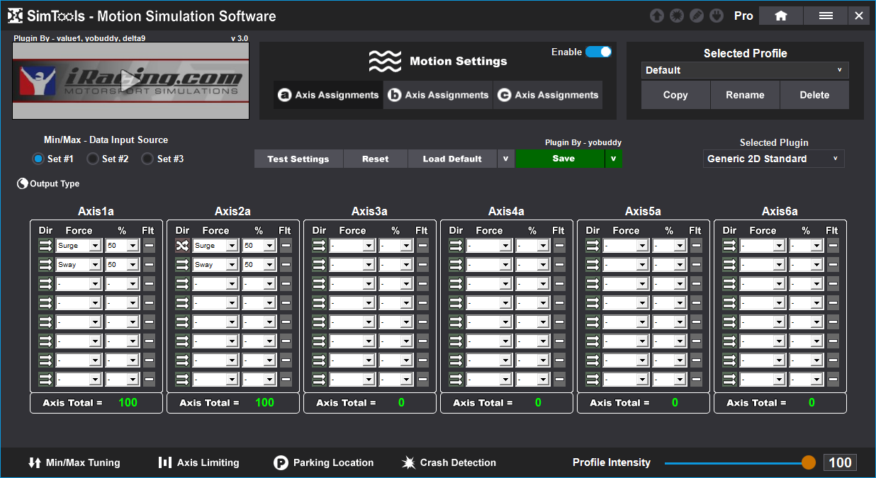

    First ever build and things have gone along pretty smoothly, however I have no motion in game. I am an iRacer and followed Quick Start Guide and instructions found online but hit a snag here with the motion not working in game even when launching game from SimTools. Don't know if it is something simple, I overlooked or what . . . see screencaps for settings.
    I am using SimTools V3 to setup the motion rig. Motion circuit has Arduino Uno 3, 2 IBT's, and 2 DC motors.
    Hopefully a former newbie will know exactly where I went wrong or forgot something. Thank you for your help in advance.

    So I tested the platform in Assetto Corsa and it works just fine, so it seems to be a problem with the iRacing plugin. I uninstalled and reinstalled the plug in numerous times and doesn't work.
