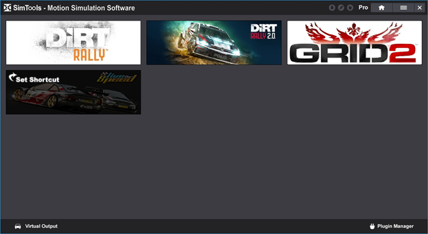

    OK I did that but the game inside simtools tries to start only in steam library and it says i don't have the license because I don't have the game from steam but directly from the developer. So how can I start the game from simtools directly from the developer not steam?
    Thank you !
  5. yobuddy
    51,775Coins
    +5,206 / 19 / -0
    To update a launch path for a game plugin, simply drag and drop the games exe or shortcut on the banner for the given game plugin.
    Take care!

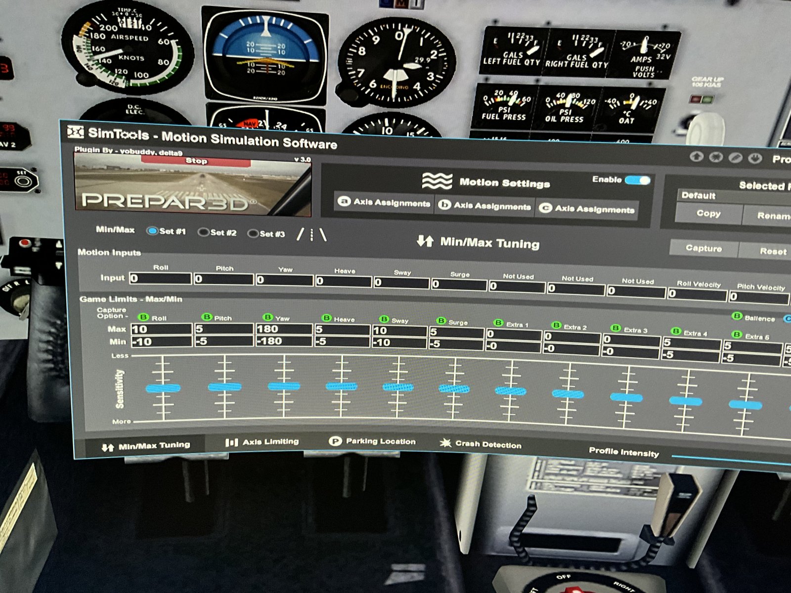

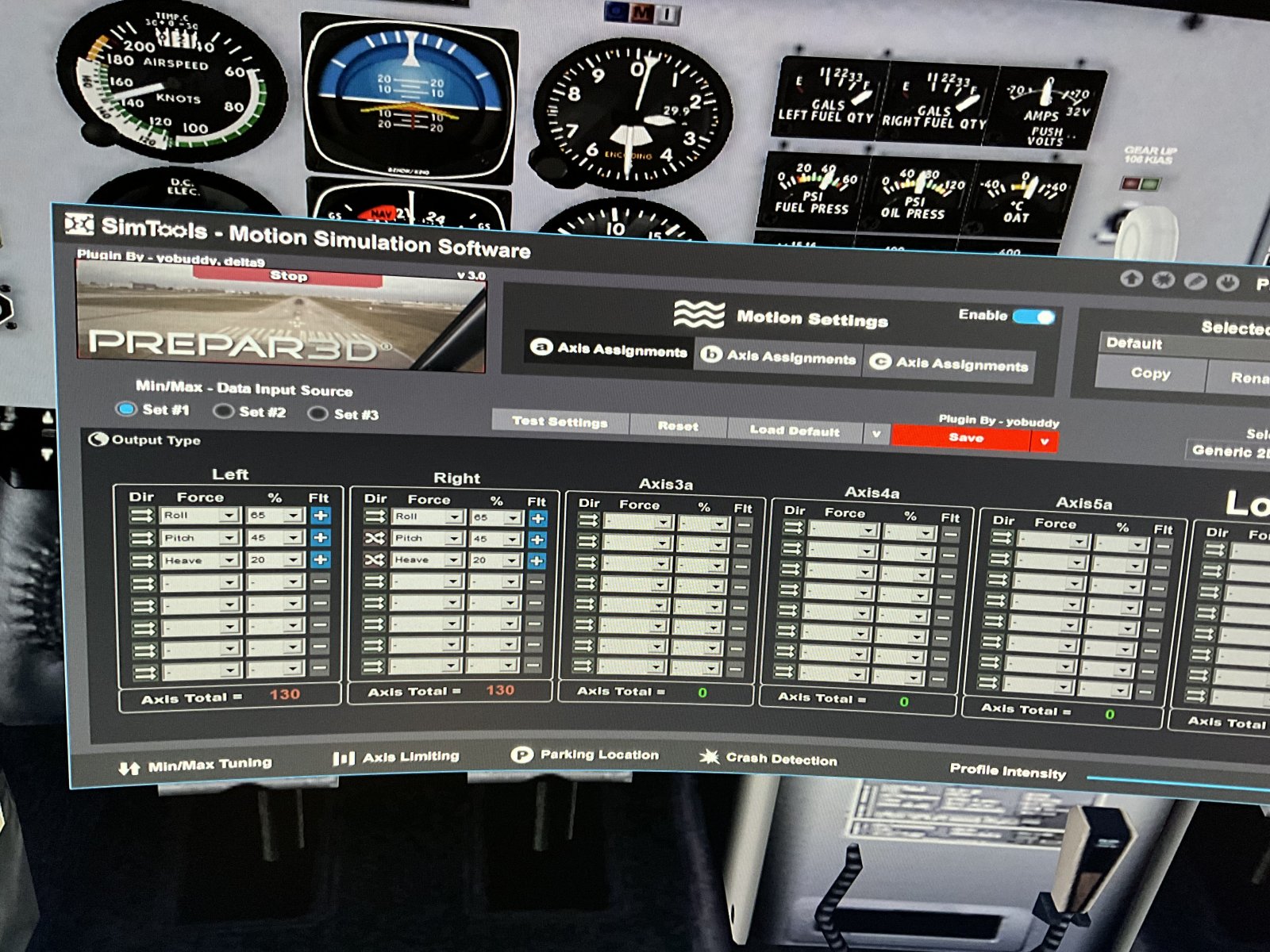

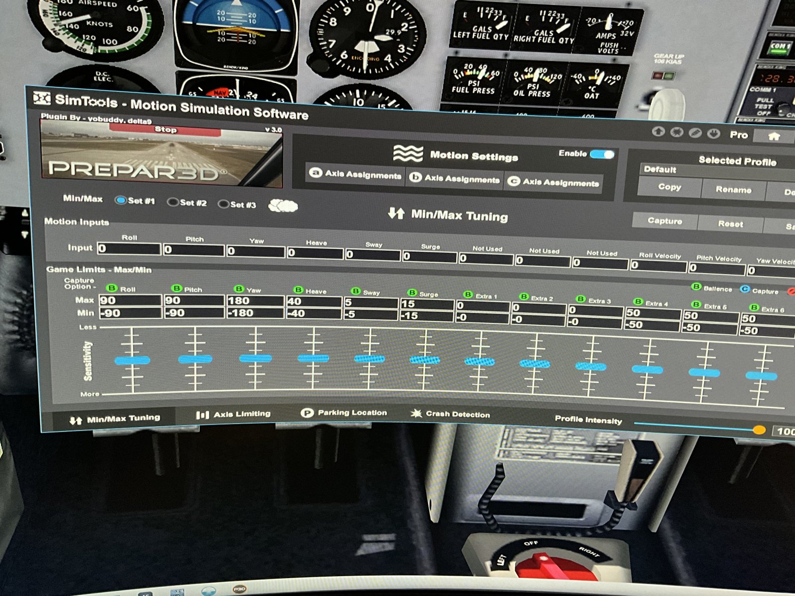

  18. Gerardo Rivera
    Gerardo Rivera Member Gold Contributor
    Jul 1, 2023
    32
    116Coins
    Anybody able to get motion with FSX, tried all still no motion.Installed FSX Steam edition FSX dropped Box FSX and no motion motion on test mod only.
  19. yobuddy
    51,775Coins
    +5,206 / 19 / -0
    I'm confused, as your post is about FSX, but all of your pictures are for Prepar3D?
    I'm guessing you posted the wrong pictures?
    You were able to get motion with fsx according to this post.
    https://www.xsimulator.net/community/threads/fsx.18320/#post-245675
    Be aware that installing two version of fsx on the same machine, at the same time, will probably only cause problems.
    Take care,
