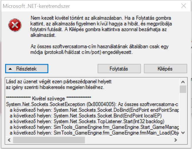

    I've read all docs and followed the installation guide but when the SW was installed it wasn't working as described. Error windows popping up and the interface settings tab isn't loading at all.

    Please post screenshots of error messages.

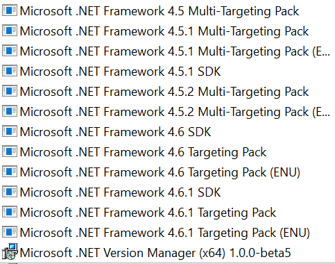

    Just checking the basics, is .NET installed and have you done a clean re-install of SimTools?

    The error msg title is Microsoft dotNET framework and it says:
    An unhandled exceptance has happaned. If you press on continue the application will ignore the error and try to continue to run. With the cancel you can close the app instantly. For all the softwarechannel-addresses usually only one method (protocol, network address, port) is enabled.
    I hope I translated well. After it lists all the exceptions.
    I'm using the newest dotNET (just installed the Visual Studio).
    If I click on continue and try to go on the Interface Settings tab, it's dropping the same error msg than seemingly closing the app, apparently minimize it even before I could read the error msg fully.
    I hope u can help, I have reinstalled 2 times, did,'t helped.
