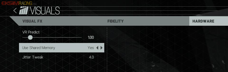

    As it's written, you have to go in the project cars options (open the game and go to options) and enable "use shared memory"
  6. Blame73
    Blame73 Well-Known Member
    Nov 6, 2014
    1,216
    8,315Coins
    +1,139 / 5 / -0
    If this always happens
    the option is not active.
    If you say it is... I don't know how to help you out :oops:

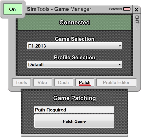

    You don't have to, simtools 2 does it for you
    Have you tried just playing the games? (if you already configured the game engine)
    22,129
    154,400Coins
    +11,181 / 57 / -2
    When you run Pcars does Game Manager turn blue?

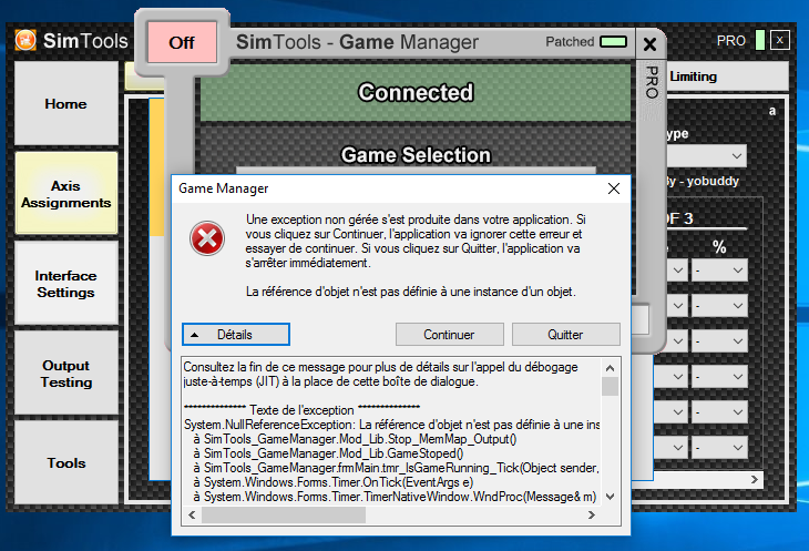

    No, I think I have it for the beginning...
    Maybe this picture can help (if you want the whole message, let me know)
  12. noorbeast
    22,129
    154,400Coins
    +11,181 / 57 / -2
    Can you please post pictures of your Interface Settings and Axis Assignments.
    Unfortunately your language translation is not clear.
