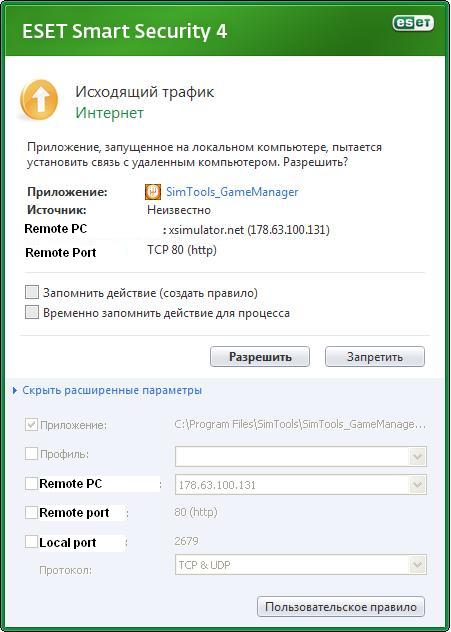

    GameManager does not work without internet connection. Status Not conected. Please do not make SimTools dependent on internet connection. Do not repeat the errors of both X-sim3!!!

    +2,177 / 19 / -1
    Hmm.....mine works without a connection. The "Not Connected" Message means that the Game Manager does not see Game Engine running. Has nothing to do with internet connection.
    Both Game Manager and Game Engine must be loaded to use SimTools.
  6. eaorobbie
    20,506Coins
    +1,687 / 23 / -2
    Correct Historiker, both the game engine and manager need to running in order for the connected to show, this has nothing to do with internet connection at all. Its stating whether the game engine is connected to the game manager and actual has 3 states , all explained in detail in doc like the other software didnt have, we have full docs on site mate.

    If the firewall block the connection. Then GameManager has Status Not conected

    that is connecting to the forum to check the splash screen, this is a site thing for info to be shown to users if not avail or you block it , up to you, no information is checked on it at all, it should continue and load the offline screen, its an info screen nothing else to fear.Sorry for the confusion.

    From picture its connecting to xsimulator.net / 178.63.100.131 tcp 80 (http) the loading of the splash screen.

    Yea i see it now. Had been on the way with my phone and did not zoomed the image.
    Edit: Did a short notice in the download description of SimTools. Maybe should be done in the documentation as well.

  16. bsft
    that looks like antivirus blocking it. try disable antivirus and give it a go. Make sure its allowed through windows firewall as well.

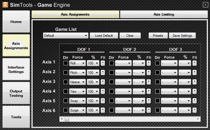

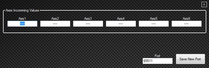

    Take a look at this.

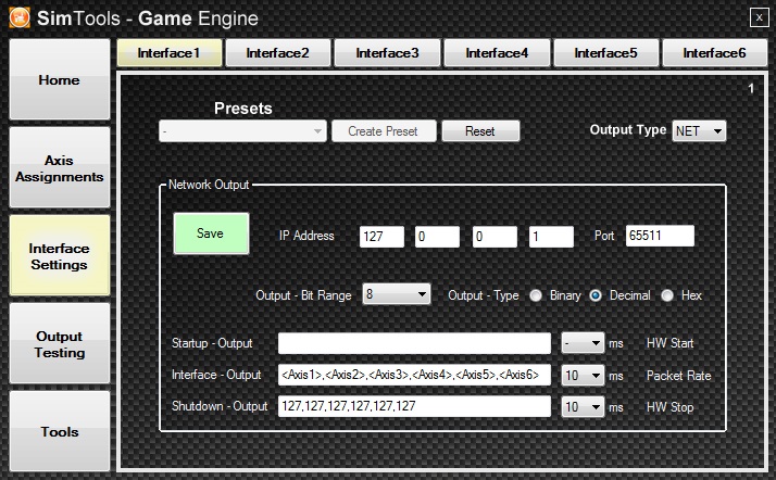

    Setup Game Engine like this.
    1) you can assign output of the axis anyway you want - but here is an example.
    2)Setup Net output to the app
    3)run my attached vb.net example app.
    Then use the output testing in Game Engine and you will see the app come to life.
    So my question is, Since I don't have a K8055, does anyone with one want to take a shot at taking it from here? I'm more that willing to help. I just don't have one to get it working.
