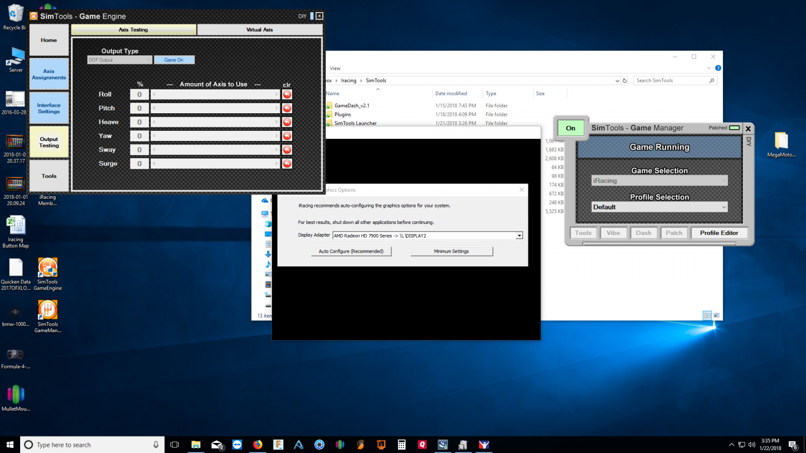

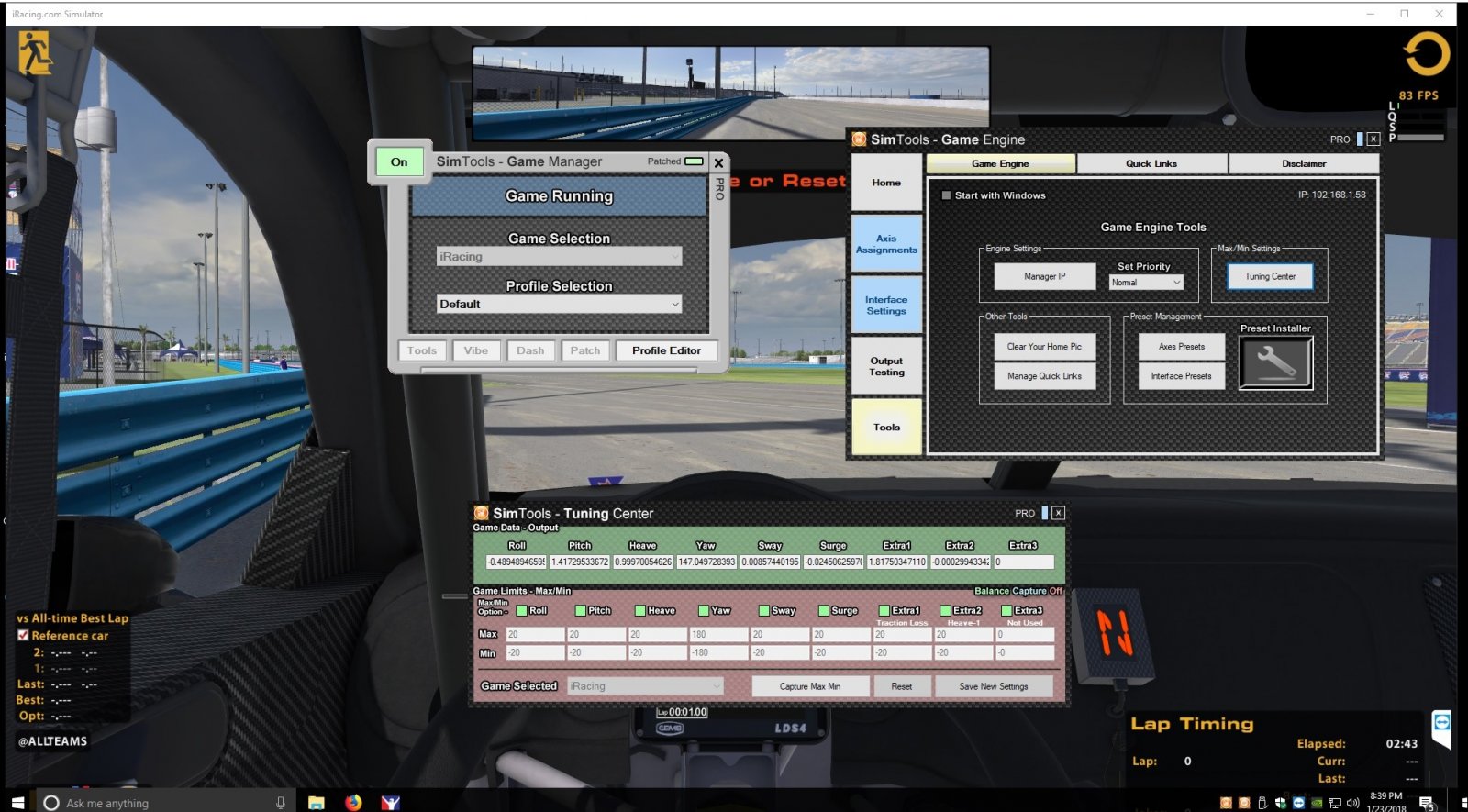

    +/-20 on the forces I’m trying to use. Those were the plugin defaults. But i tuning center there is no data coming through. When I do capture min max Then reset everything stays at zero.

    "127.0.0.1 " that's correct.
    Looking at your pictures, you can see that game engine is not connected or running with game manger?
    Do you hear a Beep-beep when launching the game?

    No, never heard a beep beep. Every time I launch iracing the game engine crashes. Same if I toggle the on off button in game manager.

    something to do with my installation for sure, I just did an iracing simtools install on my windows 10 office computer and everything seems to be running just fine. simtools doesn't crash and I get a Game On notification in output testing.
    my racing rig is running windows 7
    So I will start uninstalling and reinstalling everything again.
