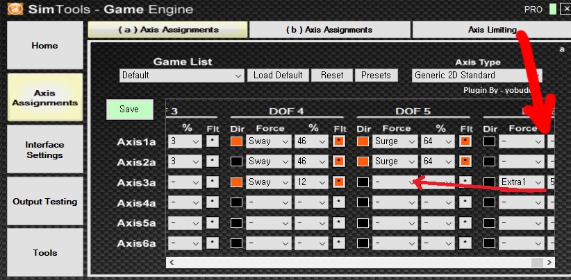

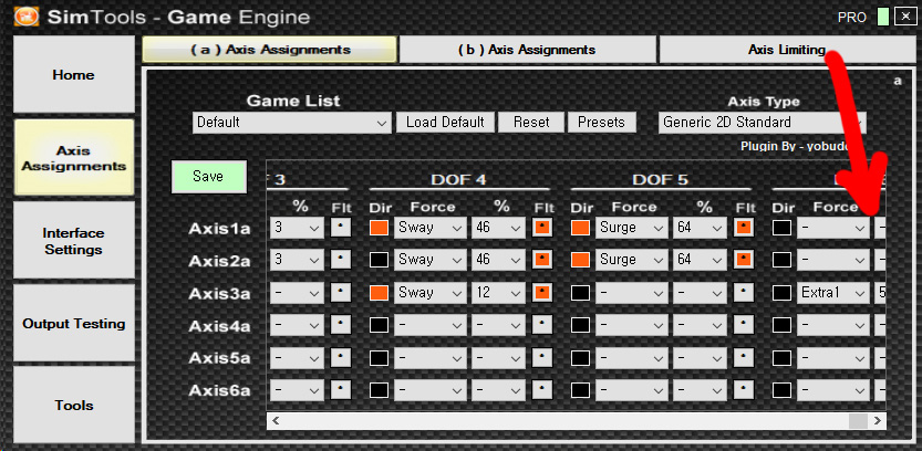

  13. Mu-KwangKim
    Mar 14, 2012
    124
    South, Korea
    - 689Coins
    +33 / 0 / -0
  14. yobuddy
    51,737Coins
    +5,205 / 19 / -0
    What screen resolution you on buddy?
    I can't get it to do that here.
    For now, you can move the assignment to DOF slot #5.
    We read these settings from left to right where they should equal a total of 100 to 130%
    Take care,
  15. Mu-KwangKim
    Mar 14, 2012
    124
    South, Korea
    - 689Coins
    +33 / 0 / -0
    @yobuddy
    I used 5760x1080
    If you set 6DOF, you can not use it as a method that you have noticed.
    Maybe korean windows problem...
    Simtools 1.3 was fixed with a separate Highres patch.

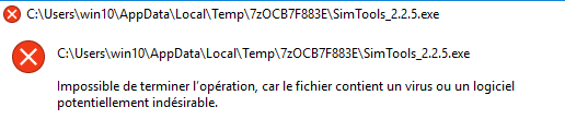

  18. vthinsel
    vthinsel Well-Known Member
    Feb 20, 2015
    439
    FRANCE
    6,059Coins
    +570 / 2 / -0
    Arduino, 4DOF
    My windows 10 is going nuts with the latest release :
    What have you put in ? :)
    Windows Defender is not happy about it...
  19. yobuddy
    51,737Coins
    +5,205 / 19 / -0
    Yes, the release probably needs to go thru a round of summiting the release to antivirus companies for exclusions from their virus detectors.
    I had to submit the last release with Windows Defender to get it to play nice.
    So it's just seeing this new release as 'different' or a problem.
    You can either wait for the false detection to update thru their system.
    Or install something better, like AVG free or Avast free.
    Both would do a much better job of protecting you online IMO.
    Take care,
