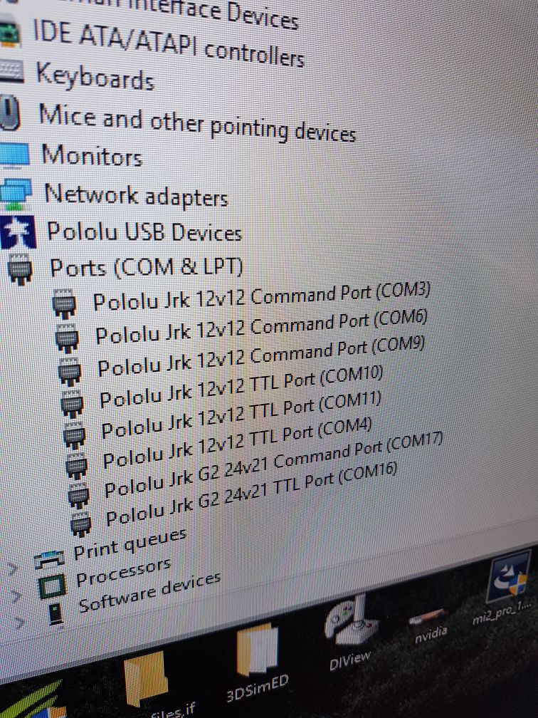

    Hey Milton,
    Ok there's something strange for sure going on, Your stuff appears to work in the Pololu utility fine but for some reason isn't displayed in the Device managed in the same way mine is.
    In regards to the Game Engine not seeing the G2, its being investigated. Bare with us.
    This is what you should see.
  2. Milton
    Nov 11, 2015
    345
    Dallas Texas
    1,989Coins
    +320 / 4 / -0
    3DOF, JRK
    I agreed with you Nick! i open a Techsupport Case with Pololu to find out if they have an updated Driver for windows 10 for the JRK G2.

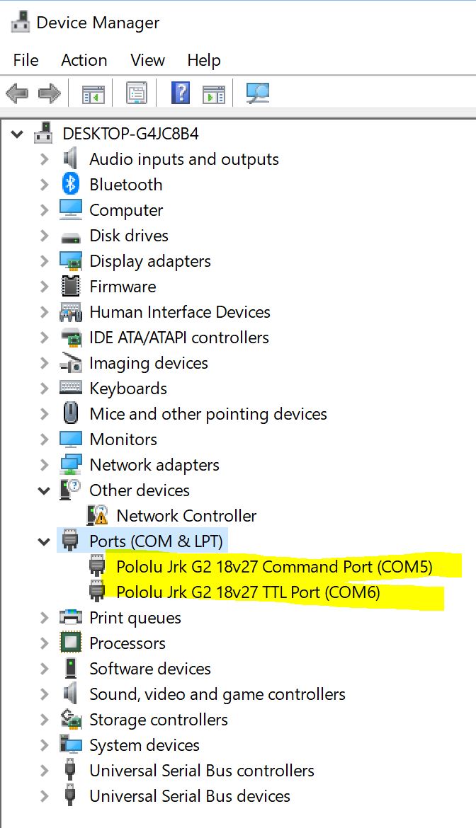

    Pololu reply with this instructions:
    right-clicking on each entry. selecting "Update Driver Software...", and then selecting "Search automatically for updated driver software"

    The Jrk's serial ports might be named "USB Serial Device" in the Device Manager if you plugged the Jrk into a Windows 10 computer before installing its drivers and software. This generally is not a problem, but there is information about how to fix the names in the "Installing Windows drivers and software" section of the user's guide:
    https://www.pololu.com/docs/0J73/3.1

    3DOF, JRK
    I Fix the Ports and now they are showing correctly i rebooted twice to get tested with SimTools but no luck still acting the same way as before, has anyone got it working with new JRK G2?

    @Milton,
    The GUID of the new devices have changed.
    It's the jrk.dll that needs updated with the GUID.
    Basically, it can't see the new devices yet.
    Nick and I are currently testing a new version now. :thumbs

    The new version is now seeing both the older and the new G2 Jrk's! :thumbs

    New Jrk G2 line now conformed working! :cheers
    Updated driver will be in the next release of SimTools.

    It works thank you so much yobuddy! :grin
