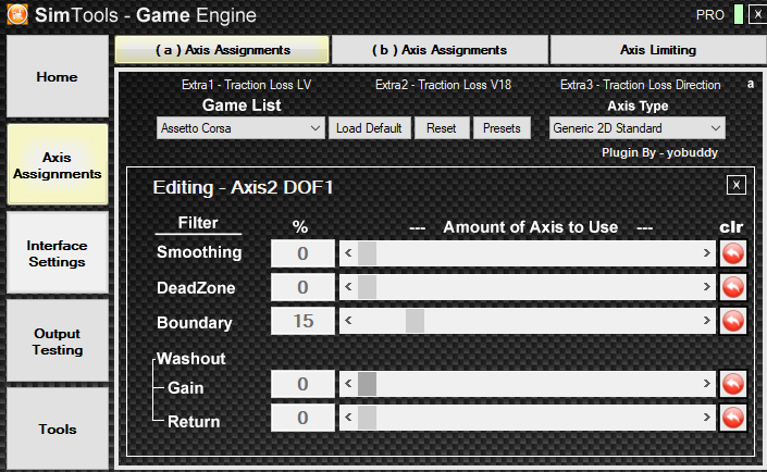

    I've got a ProSimu T1000 rig (SCN5 based, 3dof) - and after the latest update it feels as though there's some lag on my inputs. In particular I notice it with surge in Assetto Corsa - if I quickly tap the accelerator and let go, it seems like the motion doesn't catch up until almost a full second later.
    In the release notes I see these changes:
    - Smoothing per DOF now carries double the weight
    - Main Profiling % (Smoothing) now carries double the weight
    But I've tried cutting those values in half from what I used in the last version and am still experiencing this lag effect.
    @yobuddy - any suggestion on what I should try to troubleshoot this?

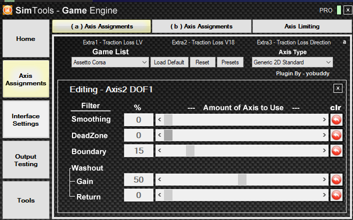

    @yobuddy - Thanks for the quick response. I think I isolated the issue. I rely pretty heavily on filters to do subtle tuning of my effects - so I turned those all off and experimented with each filter type.
    The problem doesn't appear to be Smoothing related - but actually Washout Gain?
    More Washout Gain seems to be more lag on 2.3, but had no lag effect on 2.2.5:
    However, removing Washout Gain entirely works perfectly well and restores the snappy speed of the effects:
    I hope this information is helpful, and helps anyone else who might have this problem.
    I'll tweak my axis setups for now and I should be all set :)

    Without washout gain on, washout simply is not used.
    But if washout gain is on, then return should be on also.
    In the picture, with Gain at 50% and return at 0%, it would "wipe out" at normal speed but return to center very, very slowly.
    Please try setting both Gain and Return to 50% and I bet it will work.
    (That is if you need washout.)

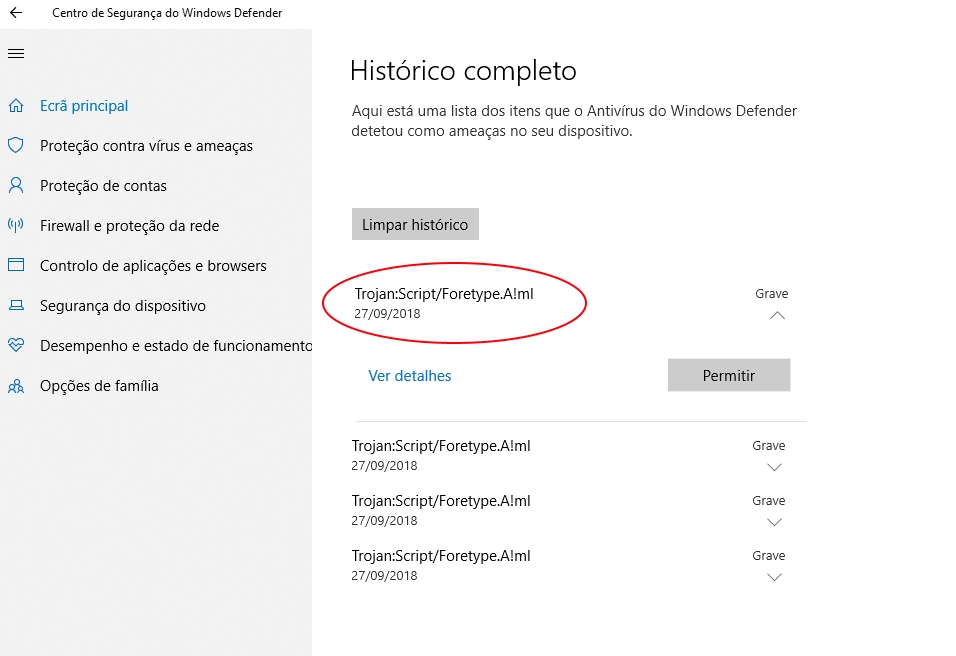

    When I try to download the new 2.3 version, Windows Defender detects this trojan:
