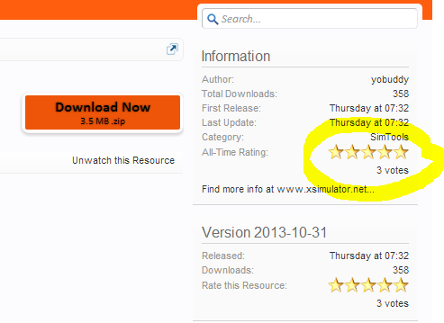

  4. RaceRay
    Nov 8, 2006
    4,658
    Hamburg, Germany
    23,892Coins
    +2,111 / 13 / -0
    Hey guys, dont be shy, the reviews and rating function is very easy to use and it does not bite you...hard:D
    Only 3 votes so far:(
