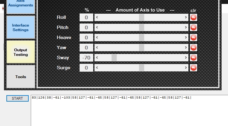

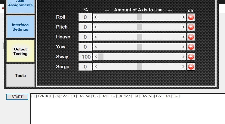

    It doesn't solve the 127 limit in the output.
    My settings for output are:
    And with a simple c# code to retrieve the bytes from the string:
    If value at maximum (sway):
    Medium:
    Minimum:
    When simtools writes the binary output to a string, it's using basic ASCII, only 7 bits, so we only get values up to 127.
    We need extended ASCII.
    I might be completely wrong...

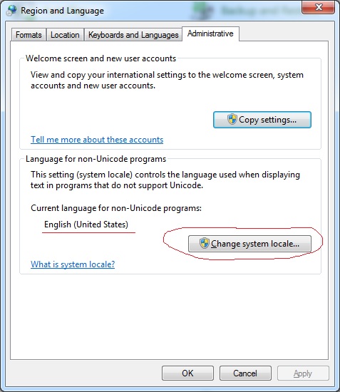

    Did you reboot after the change?
    This usually shows up only when a coma is used as a decimal point.

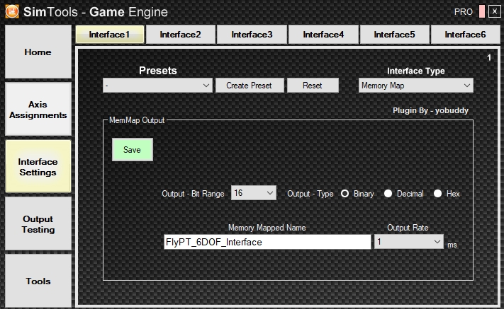

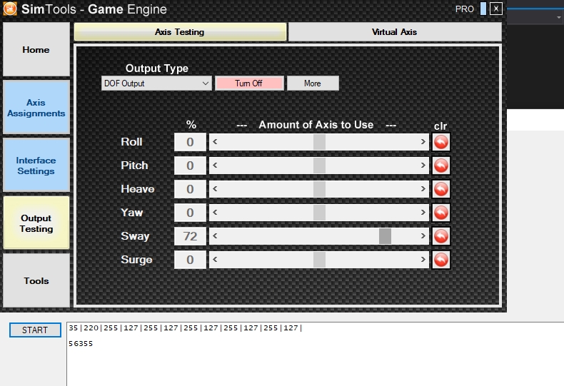

    I tried, but now with 16 bit and binary, I get from 2 to 4 bytes for the value.
    83 and 126 are the start of info.
    58 and 127 separators.
    You can see bellow, that we get up to 4 bytes:

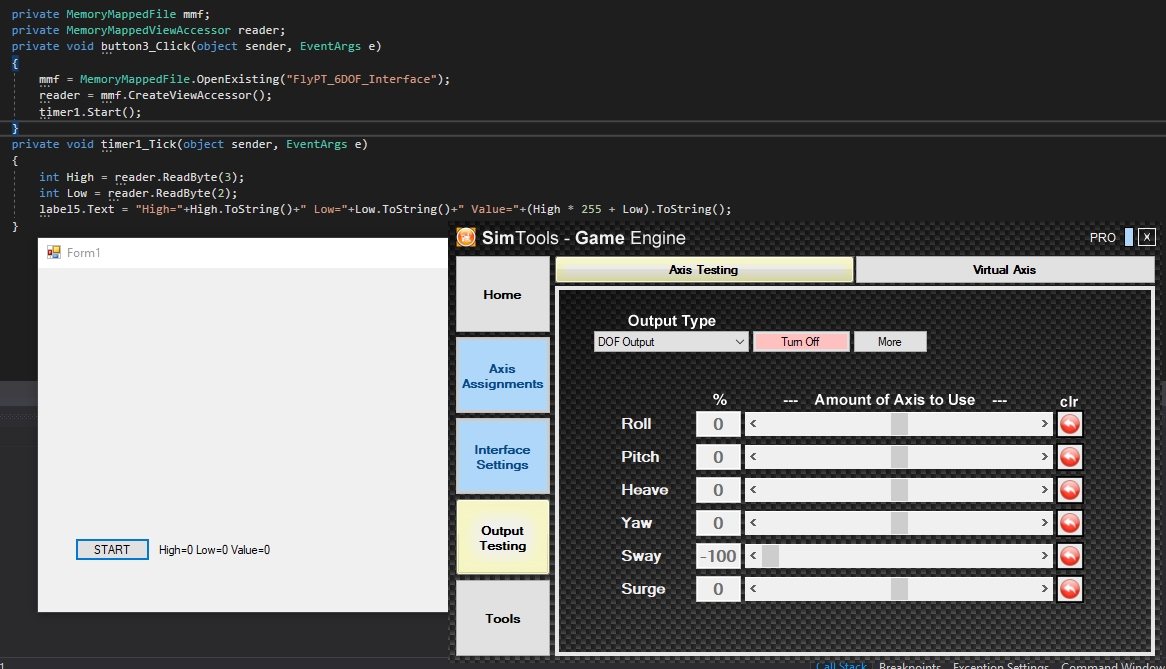

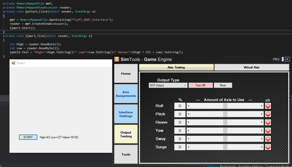

    OK,
    @yobuddy, I solved the problem.
    I didn't noticed that this was a plugin. :oops:
    So I modified the code to send UShort values and now it's working, but only for binary and 16 bits:
    The changed code for the plugin:

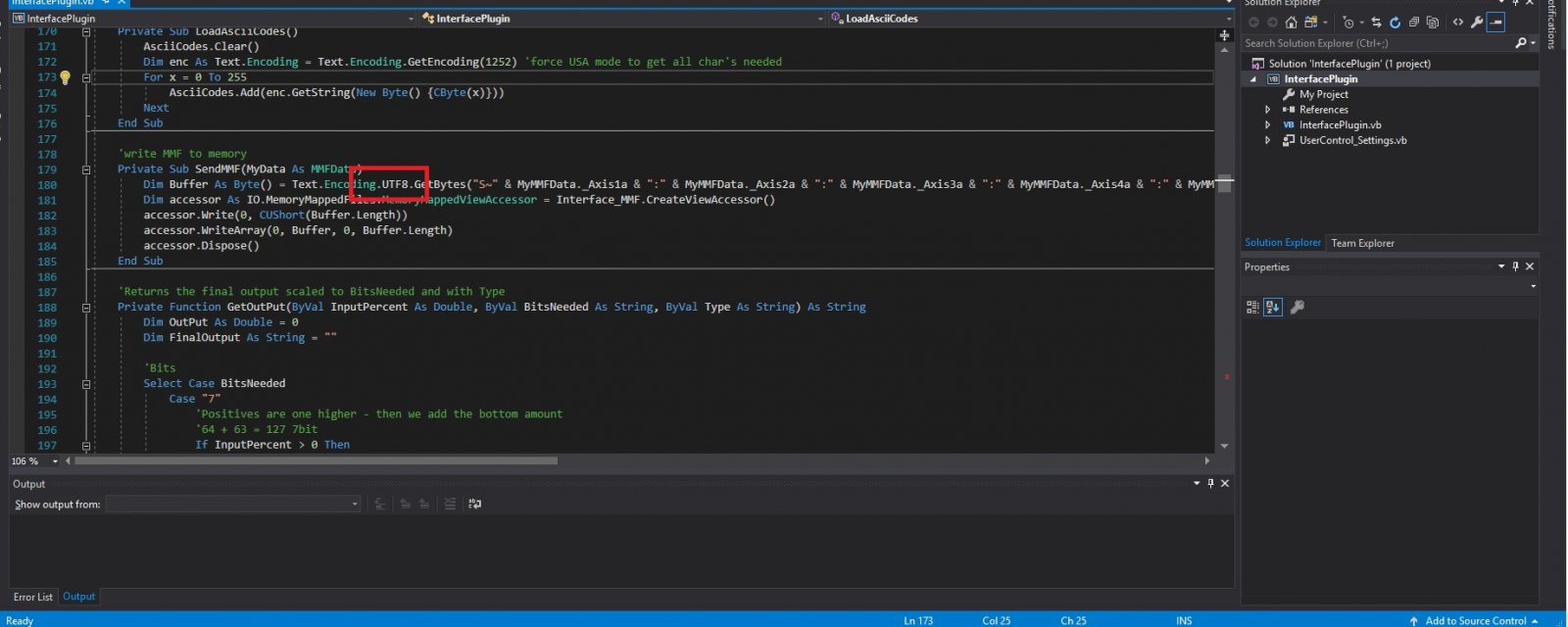

    In the plugin you are using ASCII encoding.
    From Microsoft @ https://docs.microsoft.com/en-us/dotnet/api/system.text.asciiencoding?view=netframework-4.7.2
    With the serial interface and binary output, I have no problems.
    The sample code for memory mapped file:
    Code:
        Private Sub SendMMF(MyData As MMFData)
            Dim Buffer As Byte() = System.Text.ASCIIEncoding.ASCII.GetBytes(MyMMFData._Axis1a & "," & MyMMFData._Axis2a & "," & MyMMFData._Axis3a & "," & MyMMFData._Axis4a & "," & MyMMFData._Axis5a & "," & MyMMFData._Axis6a & "," & MyMMFData._Axis1b & "," & MyMMFData._Axis2b & "," & MyMMFData._Axis3b & "," & MyMMFData._Axis4b & "," & MyMMFData._Axis5b & "," & MyMMFData._Axis6b & ",")
            Dim accessor As System.IO.MemoryMappedFiles.MemoryMappedViewAccessor = Interface_MMF.CreateViewAccessor()
            accessor.Write(0, CUShort(Buffer.Length))
            accessor.WriteArray(0, Buffer, 0, Buffer.Length)
            accessor.Dispose()
        End Sub
    Replaced with:
    Code:
            Dim x As String = MyMMFData._Axis1a & "," & MyMMFData._Axis2a & "," & MyMMFData._Axis3a & "," & MyMMFData._Axis4a & "," & MyMMFData._Axis5a & "," & MyMMFData._Axis6a & "," & MyMMFData._Axis1b & "," & MyMMFData._Axis2b & "," & MyMMFData._Axis3b & "," & MyMMFData._Axis4b & "," & MyMMFData._Axis5b & "," & MyMMFData._Axis6b & ","
            For n As Int32 = 0 To x.Length - 1
                accessor.Write(n, CByte(Asc(x(n))))
            Next
            accessor.Dispose()
        End Sub
    works.
