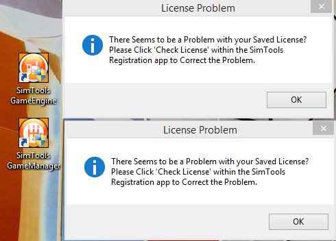

    Good morning, sir,
    I'm getting a weird reaction from SimTools V2.4 Pro.
    When loading Game Manager and Game Engine at Windows 8.1 startup, Game Manager and Game Engine do not recognize the license and the 2 applications are in Demo version after 2 Pop-Up windows are displayed.
    I close Game Manager Demo and Game Engine Demo.
    Then I launch Game Manager then Game Engine by shortcuts present on my desktop.
    By doing so, I have again the recognized license and I have Game Manager Pro and Game Engine Pro.

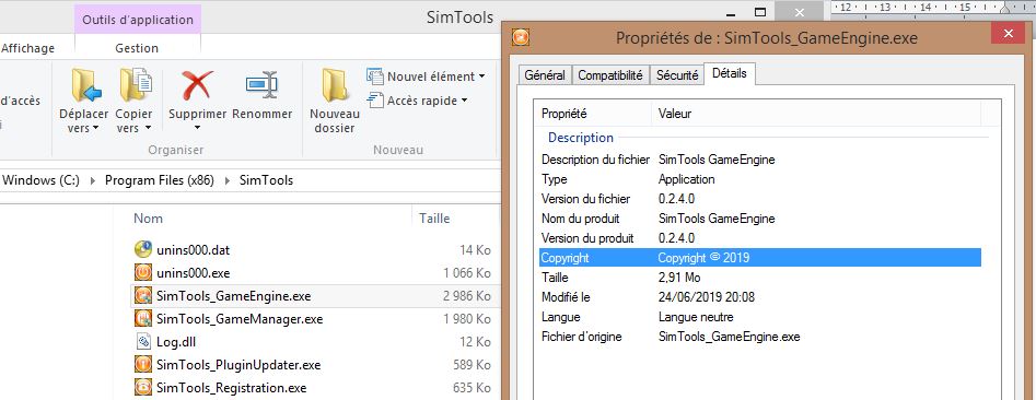

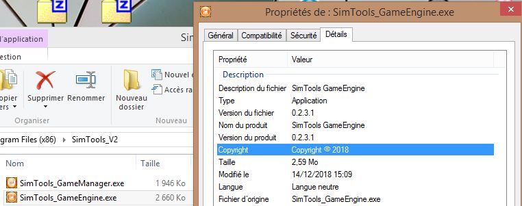

    Thank you for taking an interest in my license recognition problem when running Windows 8.1 at startup.
    A) In order to deal with the simplest problem to check, can you tell me if it's normal to have 2 SimTools directories?
    C:\Program Files (x86)\SimTools and C:\Program Files (x86)\SimTools V2
    I notice that in the 2 directories Game Manager and Game Enigine do not have the same size or the same version
    Product Version V2.4 for Game Manager and Game Engine in C:\Program Files (x86)\SimTools
    Product version V2.31 for Game Manager and Game Engine in C:\Program Files (x86)\SimTools V2
    If I launch Game Manager and then Game Engine through shortcuts on my desktop, SimTools recognizes my license and opens Game Manager Pro and Game Engine Pro.
    This means that the "Registration" has been done correctly.
    Game Manager and Game Engine desktop links are executed in "Administrator" mode

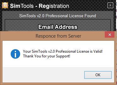

    Did you use the SimTools Registration tool and use the Check License button as directed?
  8. TFOU57
    TFOU57 Member
    Mar 30, 2009
    164
    Thionville - France
    5,723Coins
    +16 / 1 / -0
    2DOF, AC motor, Arduino
    Yes

    22,230
    154,849Coins
    +11,229 / 57 / -2
    No you should not have multiple SimTools installs.
    Totally uninstall SimTools, taking the option to remove all files, then reinstall.

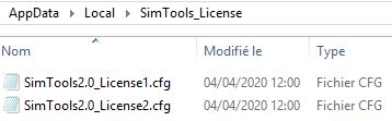

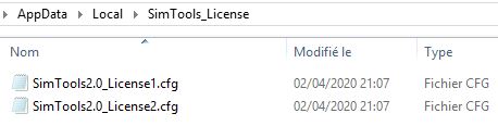

    Q2) Can you take a screenshot and address them as text of all directories and files that should no longer be present after uninstalling Windows 8.1?
    Q3) After uninstalling Windows, if there are any files left, can I manually remove them or do you recommend a freeware program to do this task?
    Q4) After uninstalling Windows and reinstalling SimTools V2.4 then use the same key that I received after installation ?
    Q5) This SimTools registration key allows how many Uninstall / Install operations ?
    Q6) Is it normal to have 2 license files in "C: \ Users \ Name \ AppData \ Local\SimTools_Licence"?
    One file for Game Manager and the second for Game Engine?

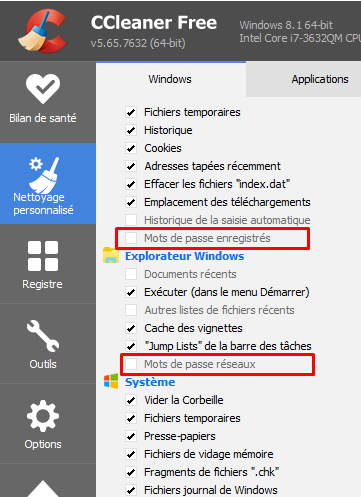

    2) I deleted the second directory C:\Program Files (x86)\SimTools. It must have been from when I tried SimTools V2 Demo with LFS.
    3) Cleaning of Internet Explorer, Windows Explorer, System and Registry
    Observation after these 3 actions :
    Strange reaction of SimTools V2.4, sometimes I have Game Manager and Game Engine in PRO, sometimes one or the other in PRO, sometimes and most often when the internet is cut, I have both in DEMO.

    Excuse me, can I have answers to my questions Q4, Q5 and especially Q6.

    I would nevertheless be interested in an answer to my questions 4, 5 and especially 6 (number of license files that must be present on the hard disk, at home, I have 2 license files, is this normal).
    Texte original en Français
    Sans réponse à mes question 4, 5 et 6 , j’ai toujours pas réinstallé SimTools 2.4
    En utilisant divers logiciel en version free pour nettoyer les fichiers indésirable et pour nettoyer le registre, je suis arrivé pour l’instant à un fonctionnement satisfaisant car Game Manager et Game Engine s’ouvre en version PRO avec ou sans liaison internet.
    Je serais néanmoins intéressé par une réponse à mes questions 4, 5 et surtout la 6 (nombre de fichiers licence devant être présent sur le disque dur, chez moi, j’ai 2 fichiers licence, est-ce normal ?)

    Good morning, sir,
    In order not to have password access stored on my PC, if I clean up the "Saved passwords" and "Network passwords" (the 2 areas framed in red), will this affect the Simtools v2.4 Pro license registered on the PC?
    Is it possible to use cleaning software without risk of losing the license registered on the PC?
    As a precaution, it is sufficient to save the 2 files as a backup.
    "C:\Users\Guy\AppData\Local\SimTools_License"?
    Texte original
    Bonjour,
    Afin de ne pas avoir des accès par mot de passe mémorisés sur mon PC, si je fais un nettoyage des « Mots de passe enregistrés » et des « Mots de passe réseaux » ( les 2 zones encadrées en rouge) , cela influera sur la licence Simtools v2.4 Pro enregistrée sur le PC ?
    Peut-on utiliser des logiciels de nettoyage sans risque de perdre la licence enregistrée sur le PC ?
    Par précaution, il suffit de sauvegarder au préalable les 2 fichiers sous
    « C:\Users\Guy\AppData\Local\SimTools_License » ?

    @TFUO57,
    I use CC Cleaner all the time, no problem!
    You can't move or edit the reg files v2, but it should not affect the registration with a cleanup anyway.
    Take care buddy,
