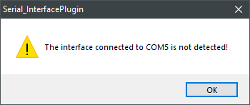

    Hey @yobuddy
    is there a way to disable this message box?
    Simtools starts with Windows but sometimes I just don't plug the rig
