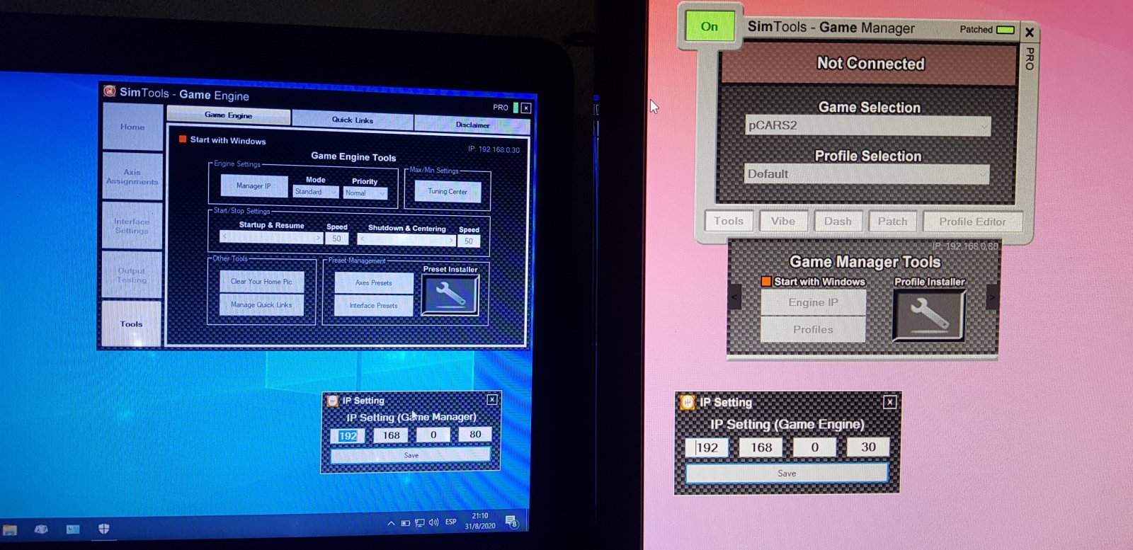

    Hello people on the forum I wanted to make a correction I was doing some tests and I want to clarify that the version of simtools 2.4.1 and 2.4 works perfectly with a single machine, I mean, installing the g.engine and the g.manager in a single pc what ami and all those who use two PCs are harmed.
    I was trying to configure it to send the telemetry data to the second pc but no case.
    The question is if anyone has any idea ... the error is in the IP number provided by both the program with the engine and the manager ... or the operating system is not providing us with the security of connecting with other PCs other than the one ip provided
    The version of windows that I am using is the win with the update 2004 and test until completely tiring the antivirus of windows.
    There are some photos of the 2.4.1 version connected on the same pc and another one wanting to connect two different ones

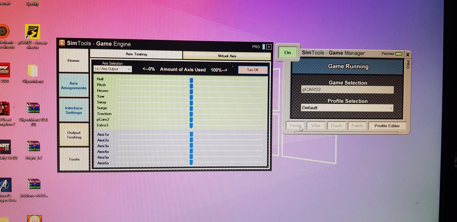

    Hello people on the forum, look at this other data that I discovered from the simtools 2.4.1 version.
    I just formatted the machine that I have installed the games and the game manager, the windows version that I have in this machine is 1909 and in the notebock I have the 2004 version, I still did not install any game that I could try with the simulator but I do not believe that does not save telemetry data. In the two pc I have the 2.4.1 version of simtools tomorrow when I install a game I show a couple of photos.
    time with all this I was disconcerted by the update of window 2004 because I believed that I had something that did not allow the simtools to connect normally, which is not when I install the latest update on the game machine. 20200902_215435.jpg

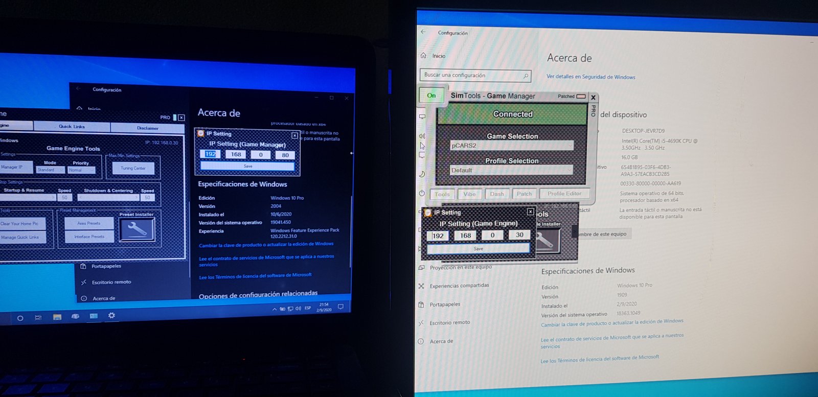

    I had installed on the S doS pc the update of windowS 10 2004 with the last update of SimtoolS 2.4.1 and between the game manager and the game engine and I did not connect
    and format the game pc with the game manager and leave it in the 1909 update.
    You must install the SimtoolS 2.4.1 in the doS pc but the game engine pc has the update of windowS 2004 and the game pc has the update 1909 and now I have a connection between the game engine and the game manager.
    So I wanted to comment ... thank you for answering igul .....
