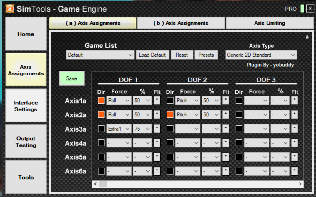

    I would like some help about output axis testing on simtools Game engine

    However when install with simtool ver 2.4, and version 2.5 and now with version 2.5.1
    Always the same problem with output axis testing very jerky motion, from 0 to 53% no movement then suddently
    move to 54% one shot and then continue up to 100%, samething when going back no movement from 53% to 0 then
    move back to middle one shot, then on negative side movement is smooth. It depends if direction is clicked,
    then the movement is jerky on the negative side.
    I change the Serial_InterfacePlugin.dll form various version 2, 2.2, 2.3 and 2.4 but just some small changes in movements,
    but still jerky moves.
    I change also to region English Us.
    Please I will appreciate any suggestion that could use my simulator smoother

    You should put a couple of photos of axis assignments to see your settings ... and interfaces settings

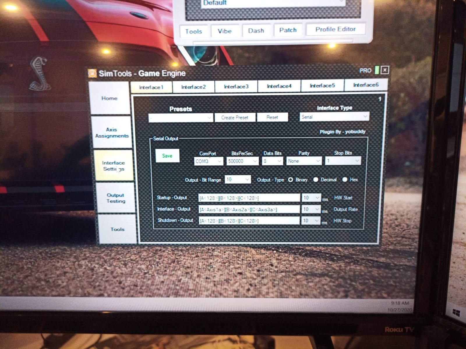

    Many thanks for reply, please see attached files for your information sorry for low quality (compression): My video file are zipped

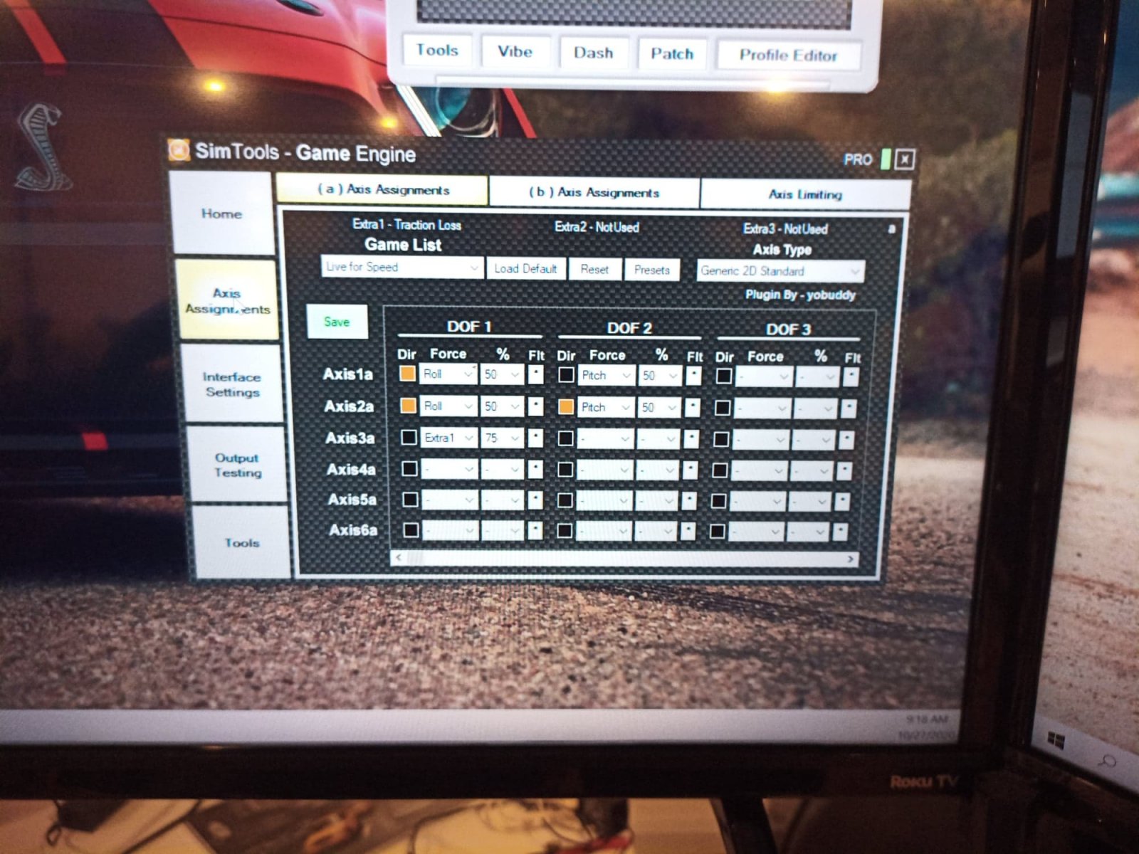

    Could you show me the configuration scheme you chose for three engines. you have the arduino and 2 monster ... you need to configure the third motor .... assign a movement I do not remember what would be the loss of traction.
  8. dedenico
    dedenico New Member Gold Contributor
    Jul 4, 2020
    - 124Coins
    I have 3 motors configured with 3 moto Monster sheild, the traction loss is equivalent to sway, have a look at my video included in previous message, traction loss is sent thru axis 3a, as seen in next pic, you will also see config of my three motors...

    You know that using the connection scheme of a single arduino with more than one monster makes everything more complicated to configure the forces that you want to give to each motor, the recommended thing would be to use an arduino for each monster and there are uses in interface settings / interface 1 interface 2 and interface 3 and you have to specify the force and filter that you want to give to each motor.

    Even if I try only one axis and remove the others on axis configuration, the mouvement is the same on output testing. Are I am the only one using one Arduino with 3motomonster?
    I just want to be sure its not a bug with simtools game engine and Windows 10 2004, before I change my hardware with 3 Arduino. I just follow instructions as per your forum and my setup is working perfectly with smc3utils. Any others suggestions

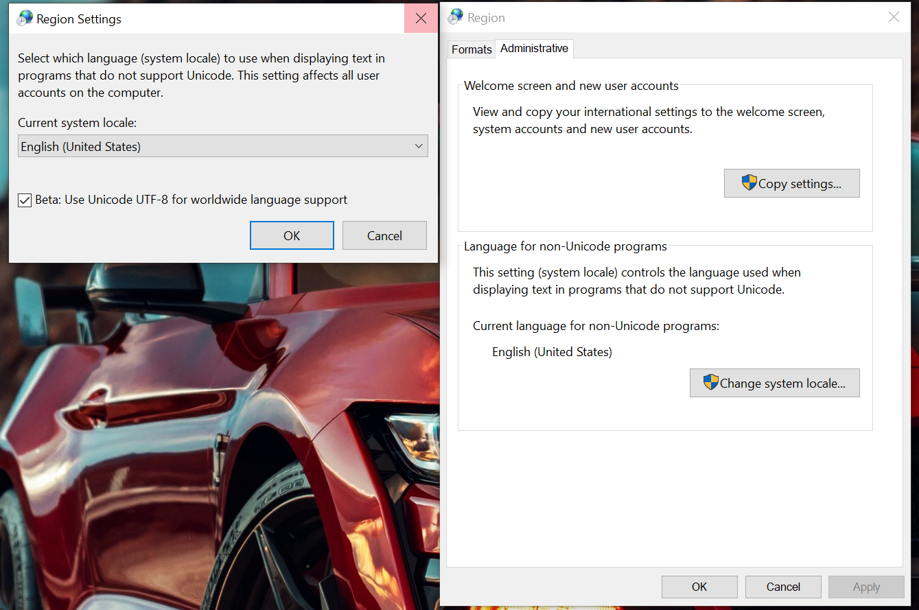

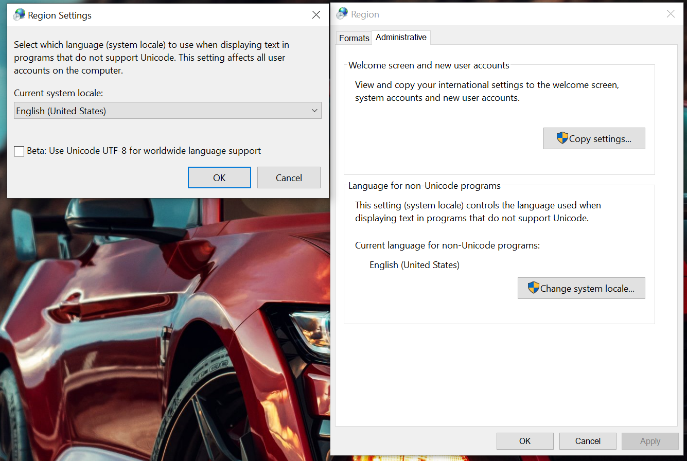

  12. dedenico
    Jul 4, 2020
    - 124Coins
    I finally solve the problem, in region settings, english us, I had checked the (Beta: Use Unicode UTF-8 for worlwide language support), I unchecked it and everything worked as intended, hoping this will helped others with same problems...
