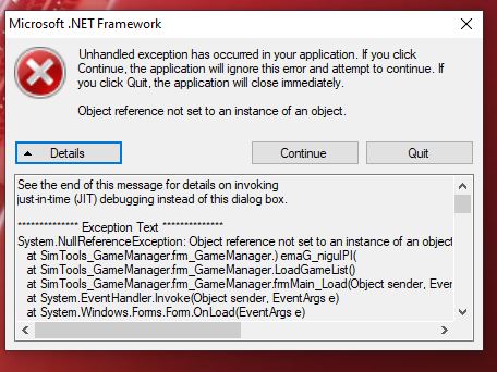

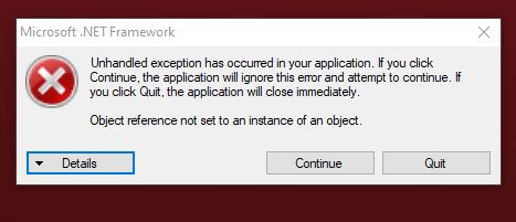

    Hi all i have a problem when i launch game manager : a message with net framework
    I instal simstool v2.6 and i have the same problem
    Net framework 4.8 is on my pc
    Thanks for your help
    22,230
    154,849Coins
    +11,229 / 57 / -2
    Please expand the Details of the error then copy and past the full error message here.

    with more information
    22,230
    154,849Coins
    +11,229 / 57 / -2
    Please expand the Details of the error then copy and past the content of the full error message here.

    System.NullReferenceException: Object reference not set to an instance of an object.
    at SimTools_GameManager.frm_GameManager.cb_GameSelection_Click(Object sender, EventArgs e)
    at System.Windows.Forms.Control.OnClick(EventArgs e)
    at System.Windows.Forms.ComboBox.WndProc(Message& m)
    at System.Windows.Forms.Control.ControlNativeWindow.OnMessage(Message& m)
    at System.Windows.Forms.Control.ControlNativeWindow.WndProc(Message& m)
    mscorlib
    Assembly Version: 4.0.0.0
    Win32 Version: 4.8.9181.0 built by: NET481REL1LAST_C
    Assembly Version: 0.2.6.0
    Win32 Version: 0.2.6.0
    CodeBase: file:///C:/Program%20Files%20(x86)/SimTools/SimTools_GameManager.exe
    UneaZPaLWHjtjGfIyYsbFPWNzDcv
    Assembly Version: 0.0.0.0
    Microsoft.VisualBasic
    Assembly Version: 10.0.0.0
    Win32 Version: 14.8.9037.0 built by: NET481REL1
    CodeBase: file:///C:/Windows/Microsoft.Net/assembly/GAC_MSIL/Microsoft.VisualBasic/v4.0_10.0.0.0__b03f5f7f11d50a3a/Microsoft.VisualBasic.dll
    CodeBase: file:///C:/Windows/Microsoft.Net/assembly/GAC_MSIL/System.Windows.Forms/v4.0_4.0.0.0__b77a5c561934e089/System.Windows.Forms.dll
    System
    Win32 Version: 4.8.9172.0 built by: NET481REL1LAST_C
    CodeBase: file:///C:/Windows/Microsoft.Net/assembly/GAC_MSIL/System/v4.0_4.0.0.0__b77a5c561934e089/System.dll
    System.Drawing
    Win32 Version: 4.8.9037.0 built by: NET481REL1
    CodeBase: file:///C:/Windows/Microsoft.Net/assembly/GAC_MSIL/System.Drawing/v4.0_4.0.0.0__b03f5f7f11d50a3a/System.Drawing.dll
    System.Configuration
    CodeBase: file:///C:/Windows/Microsoft.Net/assembly/GAC_MSIL/System.Configuration/v4.0_4.0.0.0__b03f5f7f11d50a3a/System.Configuration.dll
    System.Core
    Win32 Version: 4.8.9200.0 built by: NET481REL1LAST_C
    CodeBase: file:///C:/Windows/Microsoft.Net/assembly/GAC_MSIL/System.Core/v4.0_4.0.0.0__b77a5c561934e089/System.Core.dll
    System.Xml
    CodeBase: file:///C:/Windows/Microsoft.Net/assembly/GAC_MSIL/System.Xml/v4.0_4.0.0.0__b77a5c561934e089/System.Xml.dll
    Accessibility
    CodeBase: file:///C:/Windows/Microsoft.Net/assembly/GAC_MSIL/Accessibility/v4.0_4.0.0.0__b03f5f7f11d50a3a/Accessibility.dll
    System.Runtime.Remoting
    CodeBase: file:///C:/Windows/Microsoft.Net/assembly/GAC_MSIL/System.Runtime.Remoting/v4.0_4.0.0.0__b77a5c561934e089/System.Runtime.Remoting.dll
    Game_PluginAPI
    Assembly Version: 1.0.0.0
    Win32 Version: 1.0.0.0
    CodeBase: file:///C:/Program%20Files%20(x86)/SimTools/Game_PluginAPI.DLL
    System.Management
    CodeBase: file:///C:/Windows/Microsoft.Net/assembly/GAC_MSIL/System.Management/v4.0_4.0.0.0__b03f5f7f11d50a3a/System.Management.dll
    WRC2023_GamePlugin
    Assembly Version: 3.0.0.0
    Win32 Version: 3.0.0.0
    CodeBase: file:///C:/Users/leon/AppData/Local/SimTools/GamePlugins/872_GamePlugin.dll
    enabled.
    For example:
    <configuration>
    </configuration>

    This is the message when i launch game manager and if select continue i can launch game manager but i have this message when i try to select the game
    Note im not connected with game engine but the ip are good
    i work simstoool with 2 pc
    im sorry for my poor english

    @noorbeast i found the problem : i have use the wrc23 plugin with Simstools Plugin Updater on the second pc and i have the same problem
    I try to unistall completly simstool
