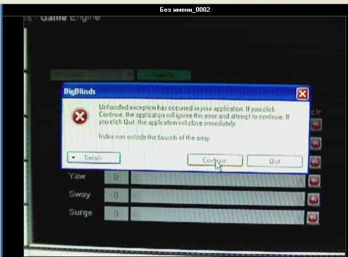

  10. CraCk
    CraCk Member Gold Contributor
    Aug 1, 2010
    56
    Made in Ukraine
    670Coins
    +17 / 0 / -0
    If you go to the tools menu in GameManager. Manifested message. Within 1 sec.
    OS Windows XP
  11. RaceRay
    Nov 8, 2006
    4,658
    Hamburg, Germany
    23,892Coins
    +2,110 / 13 / -0
    Please click on Details and copy and paste the error log here.
  12. CraCk
    Aug 1, 2010
    56
    Made in Ukraine
    670Coins
    +17 / 0 / -0
    Sorry but I can not. Windows closes automatically after 1 second.
