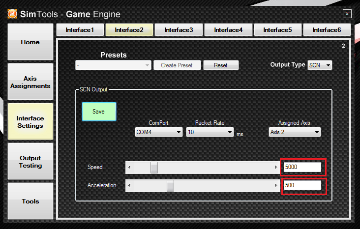

    Just a small bug I've found when setting up SCN's, maybe it's already reported, maybe not..
    In Game Engine at Interface settings, when writing custom numbers for Speed and Acceleration in the text boxes near the sliders - it doesn't take any effect, nor the sliders move. You write the numbers, press Enter, press Save, restart Game Engine and it will be still the old numbers. It only works if using sliders or small arrows, but sometimes you need to fiddle with the mouse and clicking to get an even number, it's faster just writing it. But it's not a big deal anyway, just an 'heads up'. :)
