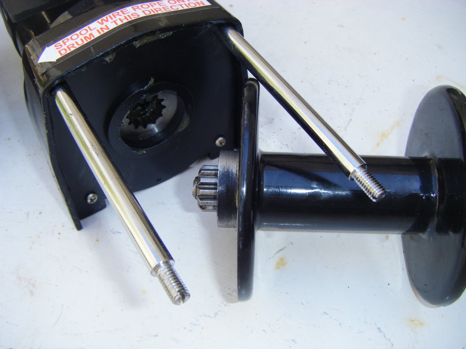

    @Pit : was your winch like this one? I'd like to have your advice

    @Pit
    Wow, I didn't know winches can move that fast :think
    I was always under impression that they are slow but powerful, this setup of yours moves really good.
    What RPM is that?
  4. Pit
    3,012
    30,455Coins
    +3,094 / 31 / -0
    Oh sorry mate for the lack of response, in fact I am using this kind of winhces but as far as I konw there are different samples on the market (meaning the quality of the planetary gear) and power output. My winches draw 750W and 120A at max load.
  5. Pit
    3,012
    30,455Coins
    +3,094 / 31 / -0
    ~23 RPM only, but the lever (in this case the crank) is 15cm long, I am not able to calculate the effective speed :)
