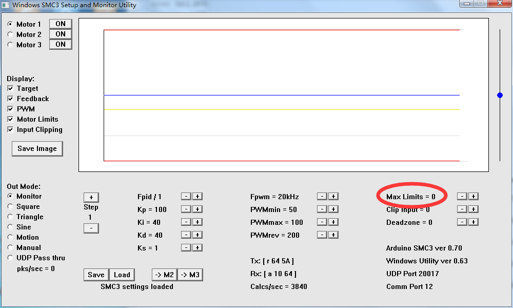

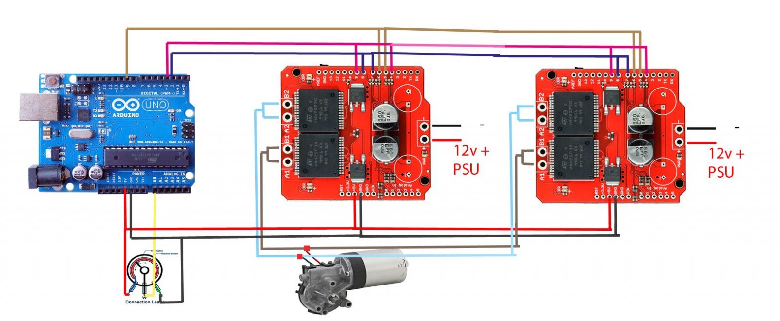

    I test this wiring, and also test this wiring
    http://www.xsimulator.net/community...cts-as-a-single-motor-driver-more-power.5482/,
    but when turn the potentiometer to the extreme position, the motor will stop, restart the arduino ,the motor work agian!
    My motor is 400w, and my arduino code is SMC3.
    when I use 350w motors, they work perfect!
    Is it code‘s problems?

    how many MM's you are using for each motor?
  4. AlexinChina
    AlexinChina Member
    Sep 2, 2015
    71
    China
    371Coins
    +8 / 1 / -0
    two Monster Moto for each motor.

    i test one motomonster for each motor and test two motomonster for each motor both, but when use 400w motor, and turn the potentiometer to the extreme position, the motor will stop!....

    ok, before I'll give an answer please upload your SMC3 settings.

    My code is SMC3V0.7, they are all in the initial state.

    When the motor stops,
    also the SMC3 button is off?

    Check your POT wiring.
    If you mix up the signal and +5v it can do this as it shorts when all the way to one side

    Hi @AlexinChina
    I had a similar problem. When my engine reached the end of its travel (but only as a side) he stopped.
    - With SMC3utls in manual mode, when you go to the end, is that the clipping limit works (it should curb) ?
    - If it occurs at high speed, maybe the limit of clipping is too close to the maximum limit ?
    - For me, it was the pot that gave me the puzzle at the end of its travel (but only one side!)

    You test turn your Max Limits into 0, maybe it can solve your problem~

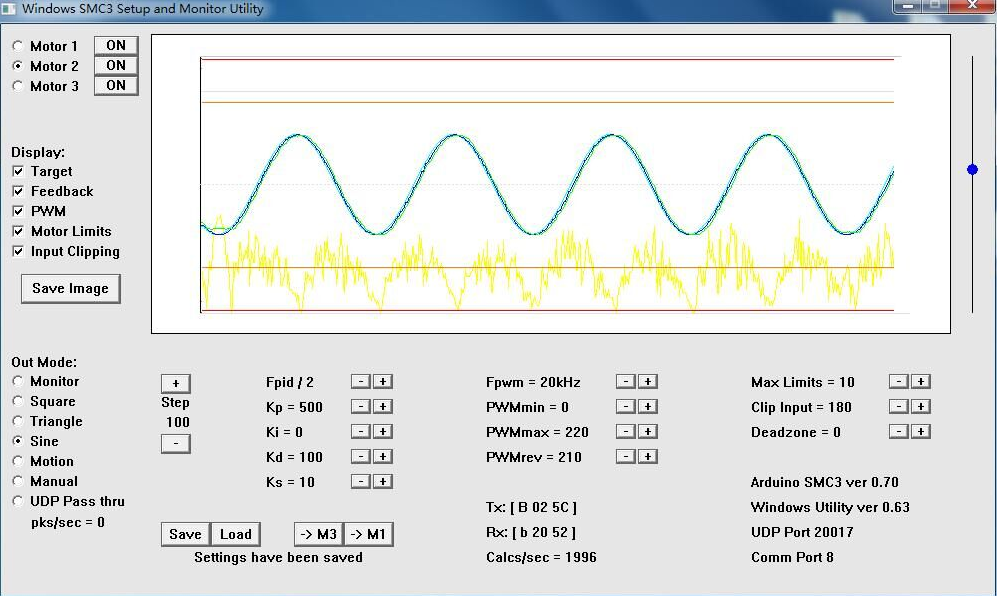

    Hi @AlexinChina sorry to hear that you have some issues, but I do not understand really what's your problem.
    First I have a winch (750W) and it works fine using two MMs. So the 2 MMS should handle the high current.
    Second if there is one problem - e.g. one motor does not work - some of the MMs could be dead on arrival. If so, you can't do anything only to buy some more units.
    I suggest to check out each single MM if they are working. BTW your Motor 2 works fine (while the screenshot of Motor 1 shows no motion, because you have no motion enabled...)
