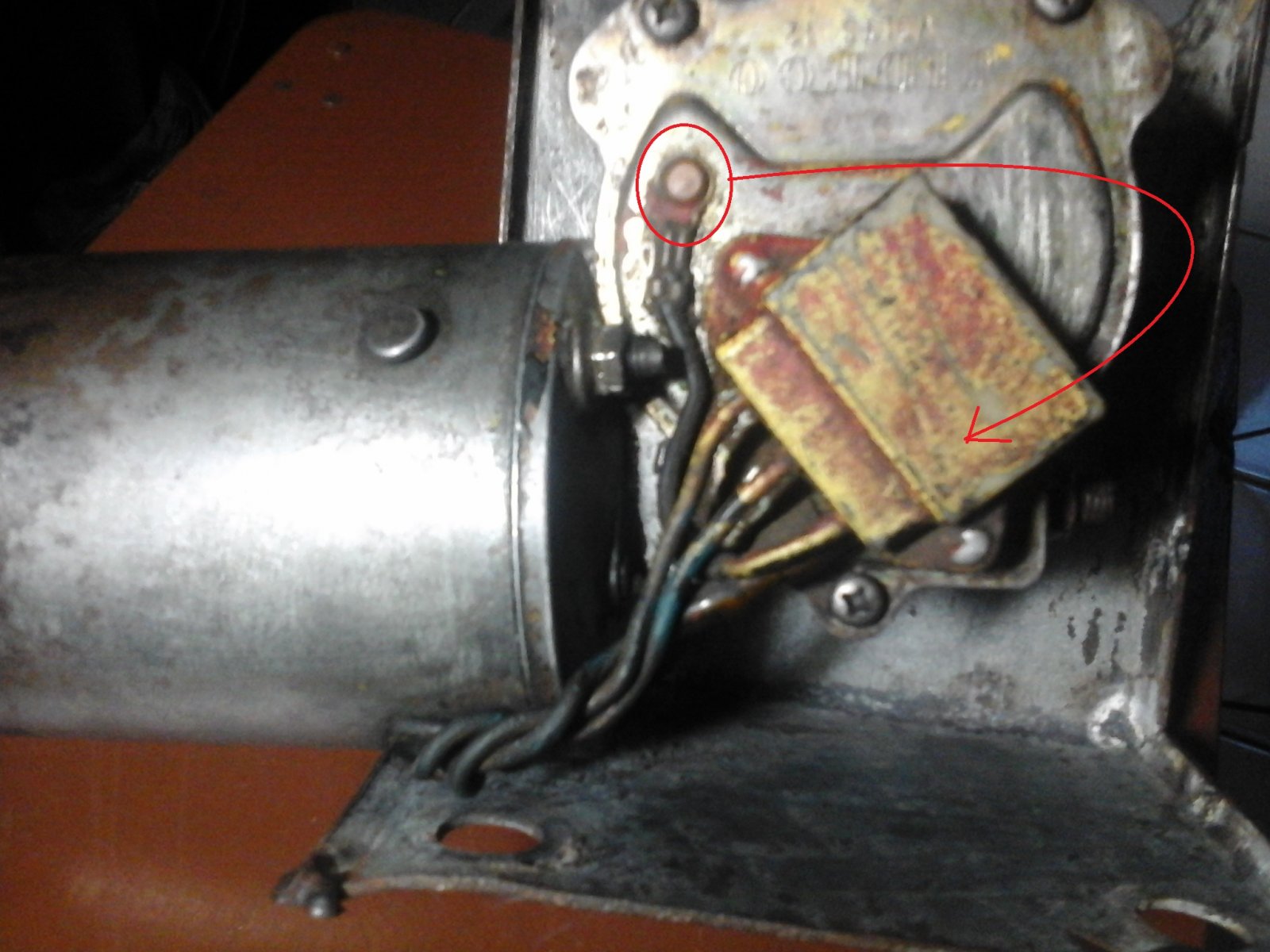

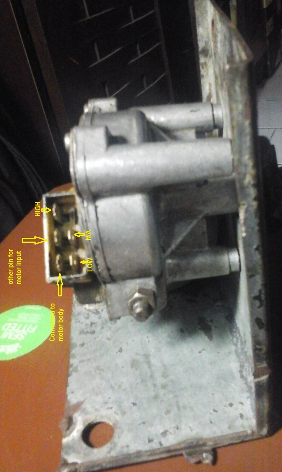

    I already checked the motor I'm using. Here are some pictures.
    There are 5 pins in the motor, and one pin is connected to the motor body. Do I have to cut it off. even it is not connected to the PSU?

    yep , not only that you need to check manually that there is no power or gnd leaks to the body of the wiper , for this problem is why I don't recommend people to use them , specially newbies to electronics, the mistake can be costly.

    I've tested and checked manually using multimeter and there is no power or leak to the body of the motor. Maybe the problem is the MM.

    Hi! I already conduct test on the other chip of VNH but the output are the same.
    I already cut the wire connected to the body of the motor. Please help.
