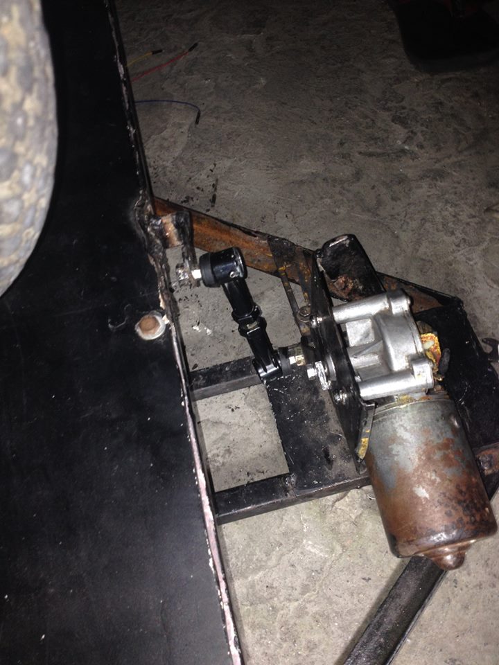

    Hi! Need some help from you guys.
    All is working fine except the fact that when I'm riding the platform, the motor has difficulty in turning.

    when there's no load in the platform(no one is riding), the motor can move well. But when I ride the platform, the motor can't turn.

    The angle of the view is not perfect but so far as what I can see the lever mechanism is one thing but at least the motors are too weak, IMO.
  10. bsft
    looks that way like the motor is stuffed. Have you got better pictures of your sim and the motor placement?
    That whole setup looks wrong

    stuffed? Tried to translate but didn't make any sense to me :) NTL you are right the setup is wrong and not only the motors which are a big issue.

    Yes, design of motor placement and motors a problem

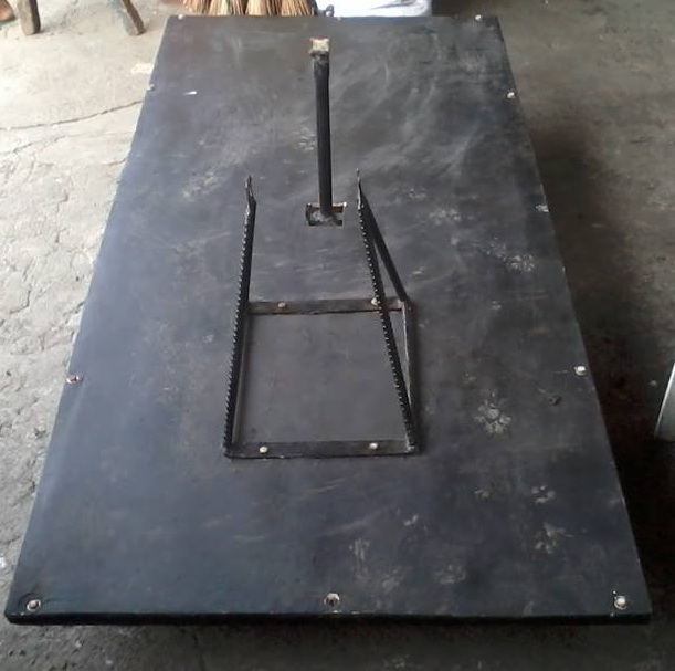

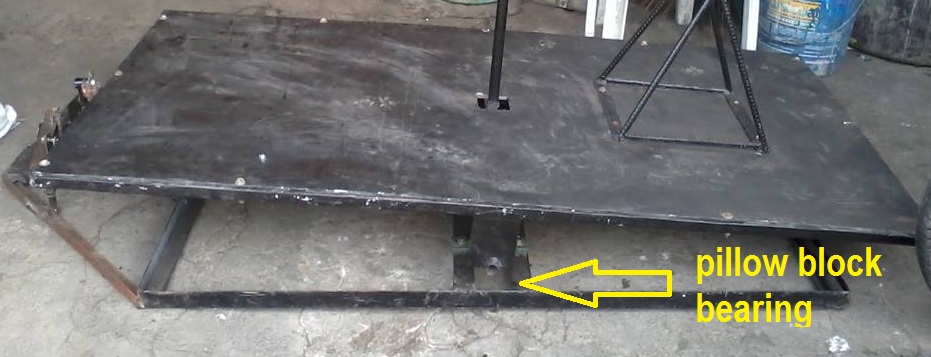

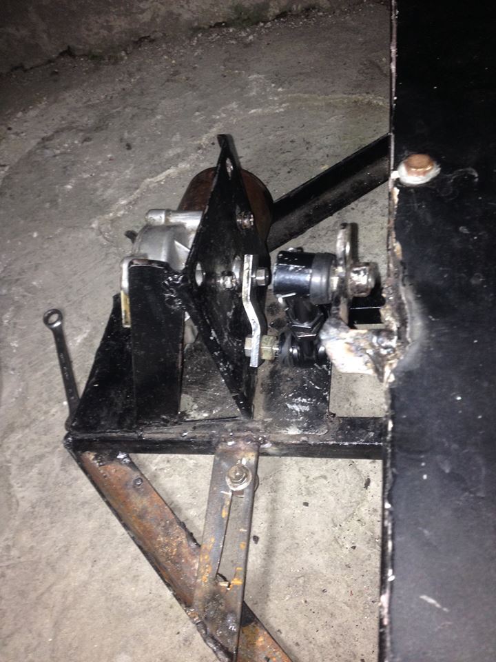

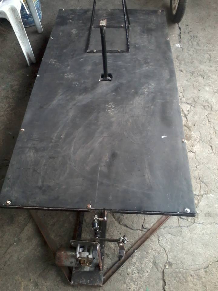

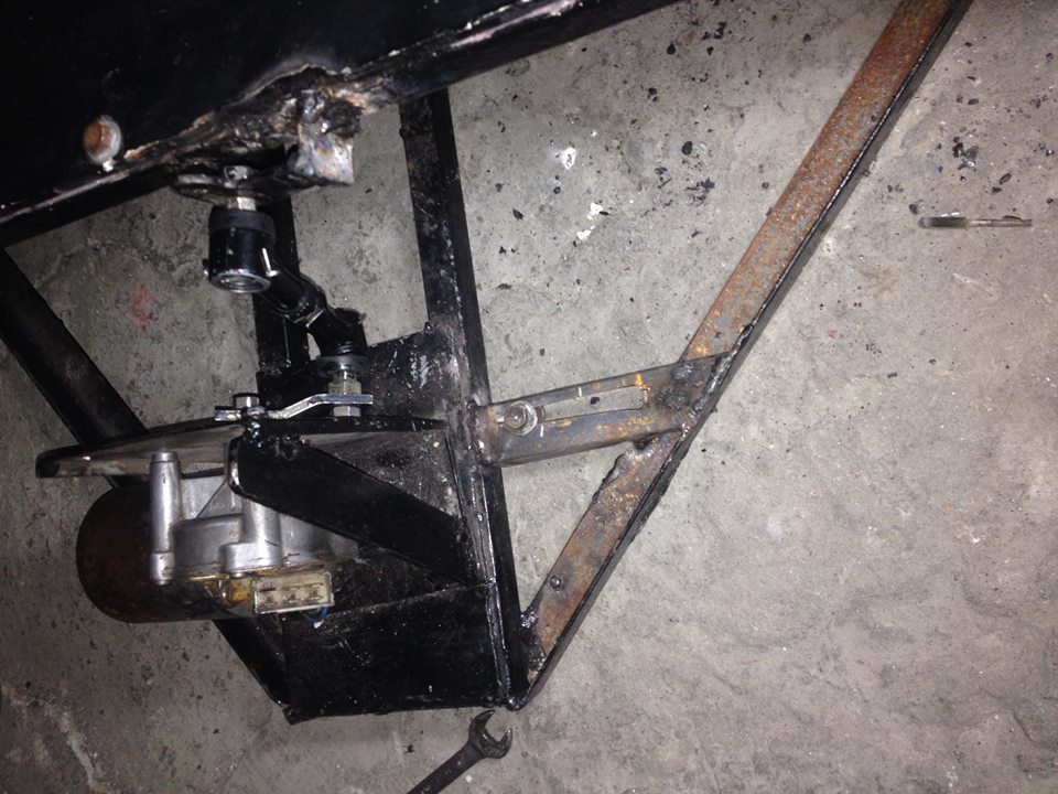

    Hi here's some pic.
    hmm what can you suggest about where is the best position and place for the motor. Pls.

    @Ralph Manuel I can't see all, BTW I see only one motor!! And I see a big steel plate, it weighs a lot! I see a very weak motor, very old and perhaps "stuffed" as @bsft has been said.
    Where are you coming from? Perhaps you have no good possibilities due to restricted resources, anyway if you want to ride this rig you have to redesign and/or you have to look for stronger motors and better levers (or rods).

    Hi Pit, I will only use one motor, that's all I need, because its 1 dof like a seesaw.
    BTW, the platform has a frame and a thin plywood, so it doesn't weight that much.
    Yes, the wiper motor seems quite old. Don't have good resources of materials that's why this is happening.
    Now, I'm looking for stronger motor, but all I saw is old big wiper motor.

    Yes, we need to see photos of the whole sim.What you posted does not help us help you

    back view of my platform.
    front view of the platform. (disregard the pot near the motor, I've already remove it)
