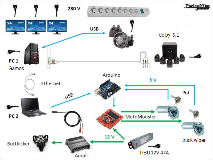

    I have a highend gaming pc... Do I have to use 2 pcs to obtain this setup ?
    22,228
    154,837Coins
    +11,227 / 57 / -2
    No, you can run SimTools and your games on the same PC.

    ok. cool. jrk or arduino ? ? ? ? any benefit to one or the other ? and should I be looking for a Power supply with 40 amps or better ?
    22,228
    154,837Coins
    +11,227 / 57 / -2
    The JRKs provide high fidelity control and are easy to set up, but are more expensive.
    The Arduino/Motor Monsters are cheaper and flexible but take more effort to set up. Of late a number of members have reported faulty MMs from cheaper suppliers so a list is being added to where members report good MM suppliers: http://www.xsimulator.net/community/faq/reputable-monster-moto-suppliers-testing-before-use.158/
    With PSUs go 40A 500W or better, you can use cheap LED power supplies or modify server PSUs: http://www.xsimulator.net/community...ver-power-supplies-as-cheap-powerful-psus.54/

    Save yourself the overall hassle and use JRKs.
    Easy way to see how good they are.
    Look up the JRK threads and see how many have been resolved,
    then look up arduino threads to see how many are STILL open.
    @Nick Moxley , can you please provide a link of the motors you use and the gearboxes for 50:1 or 60:1 please.
    LED psu for sure, allow at least 500 w per motor

    Note my comments here, the NM specs of the Bodine are a bit lower than wormdrive motors commonly used by members and the shaft speed is fairly slow, so you would have to compensate with a larger CTC and careful design: http://www.xsimulator.net/community...gear-motor-12v-23a-gearmotor.6932/#post-79068
    Personally I think the Canadian 50:1s are a better way to go, even though a little more expensive, as they are similar in power but have significantly higher shaft speed: http://www.ebay.com/itm/GEAR-MOTOR-...483?pt=LH_DefaultDomain_0&hash=item51bed470a3
    And use one PSU per motor.
