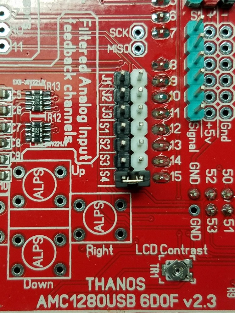

    No need to change the dip switches now. But if you like to keep LCD menu ON, you just place a jumper on S4
    The latest firmware file is here:
    https://www.dropbox.com/sh/muf1yn18fs2aqpa/AADi0hOnFfZlP2UAQYURqBFKa?dl=0
    And the video with the instructions to flash the firmware is here:
