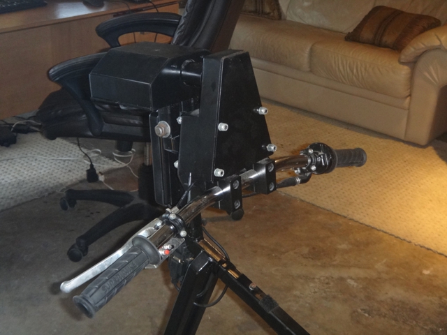

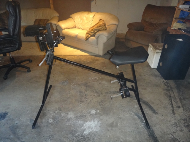

    Allen from Double Dragon Custom Cycles has a nice set of controls that can be custom made with whatever real life motorbike handle bar, grips ect that you want. he also has a range of 3D printed foot pedals.
    I spoke to him about converting his system to motion and he really wants to get involved.
    https://plus.google.com/ IASystemsComputerControls
    Contact Allan here Double Dragon Custom Cycles Phone 01322 402668 Online Contact Info doubledragoncc Website http://double-dragon-custom-cycles.8m.com

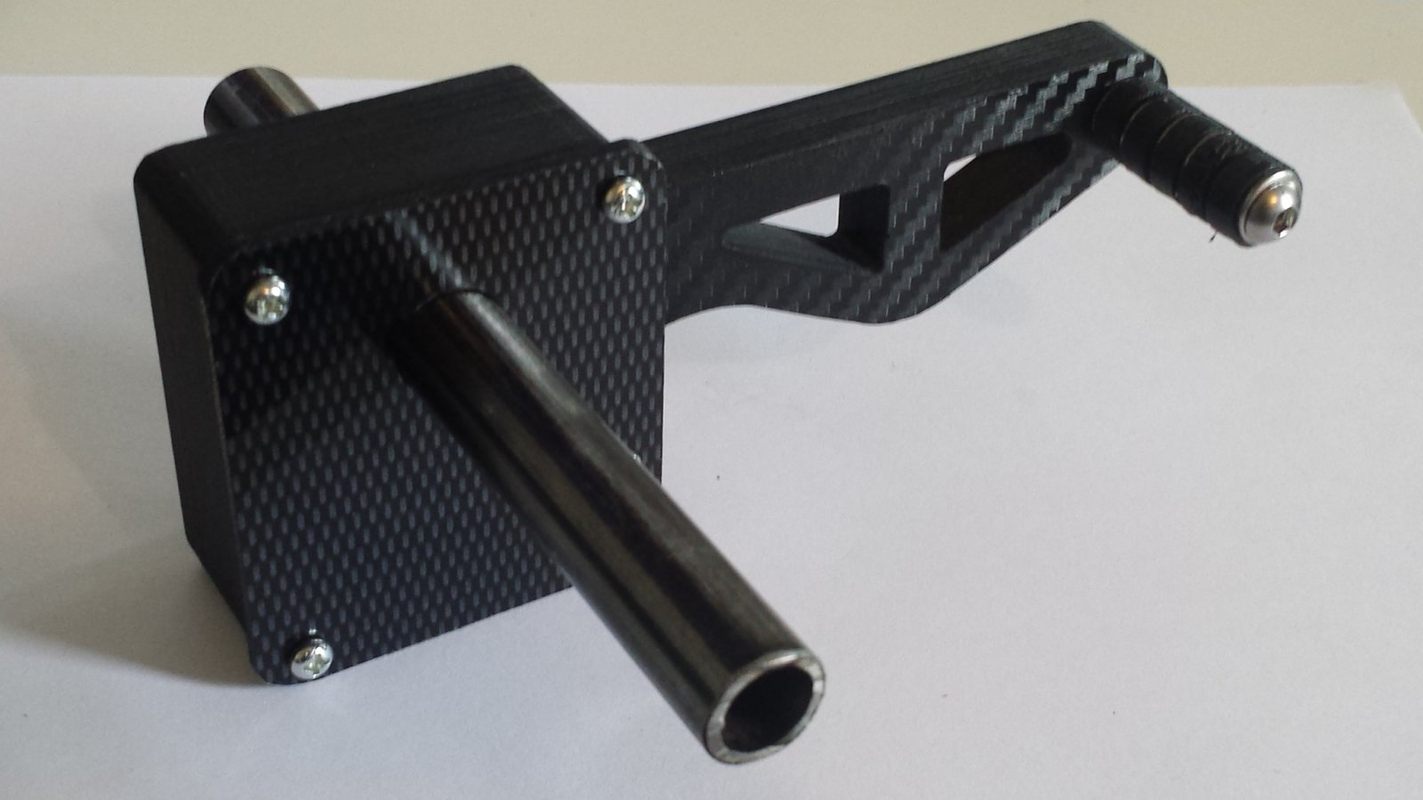

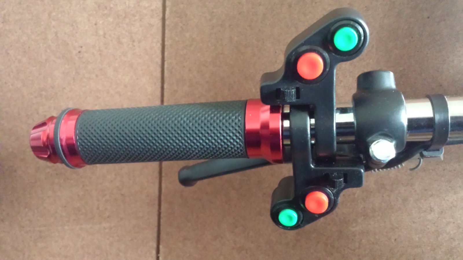

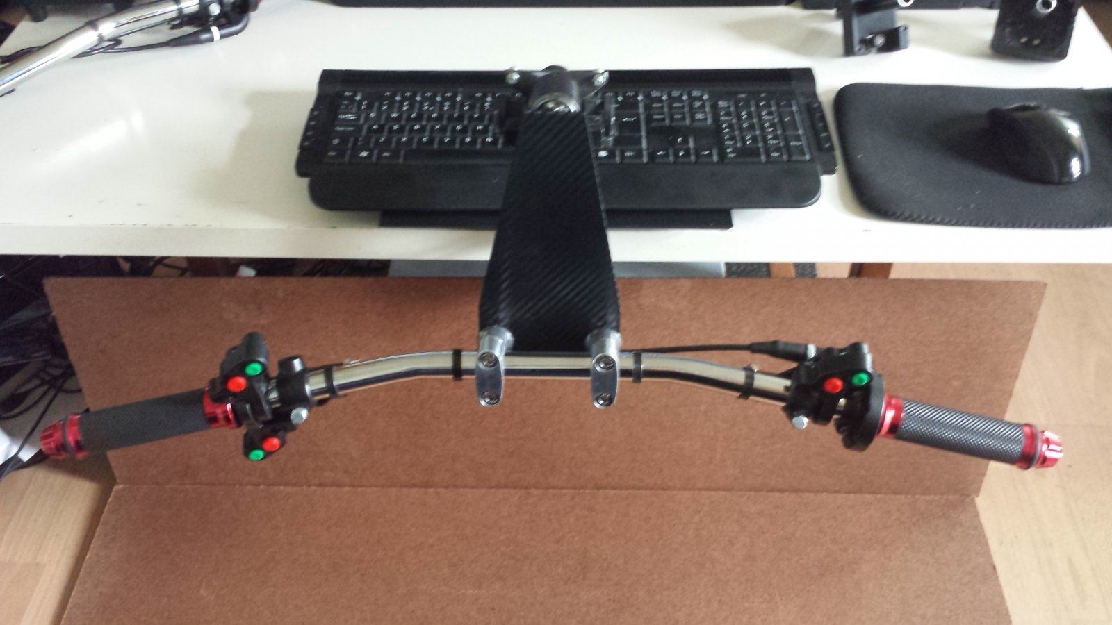

    More Pictures
