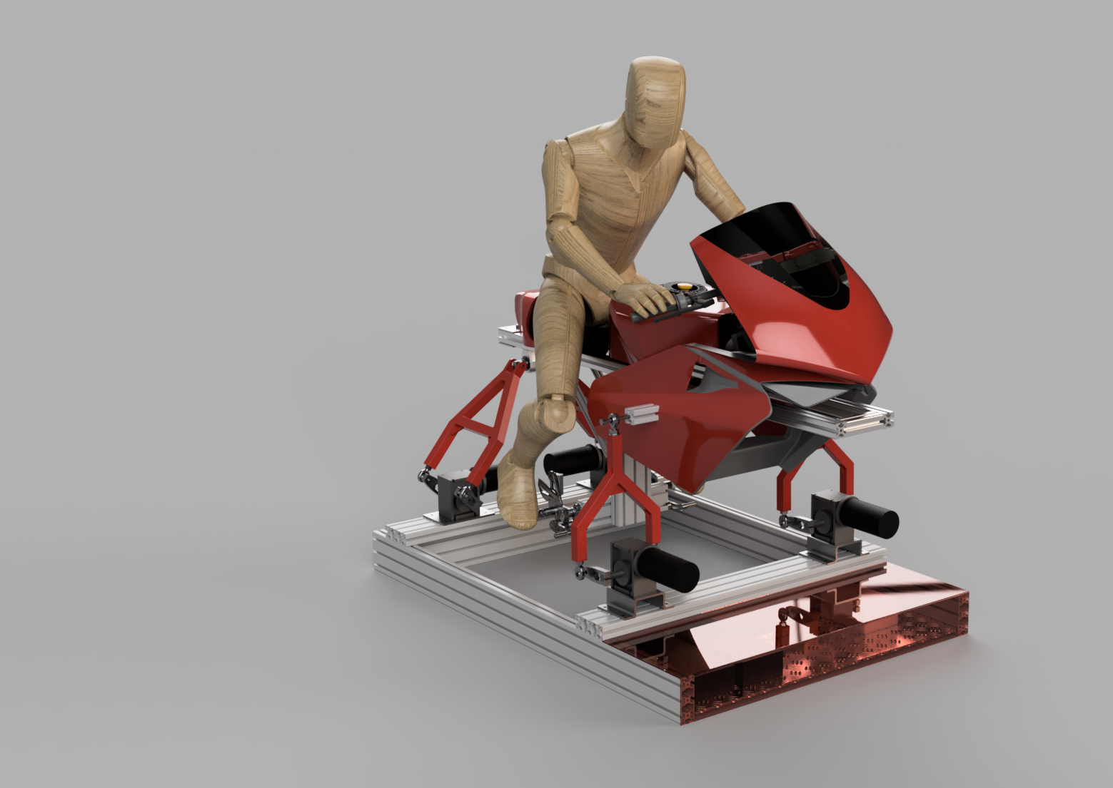

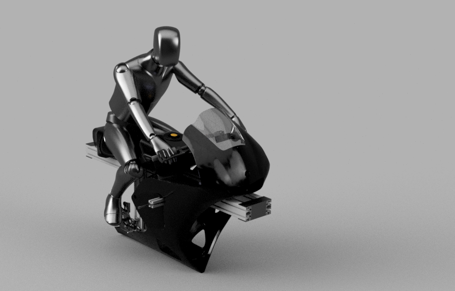

    Update 19/2-2022
    Design work started in January and it looks like we will be going for a aluminum extrusion based rig. Mainly for the adjustability it will give us.
    We are currently running FEM simulations on all the platform parts to make sure we optimize the weight of all moving parts.
    We will probably not have space in the bottom part for a full fairing, but this is what the concept looks like at the moment:

    This is how the CAD looks right now:

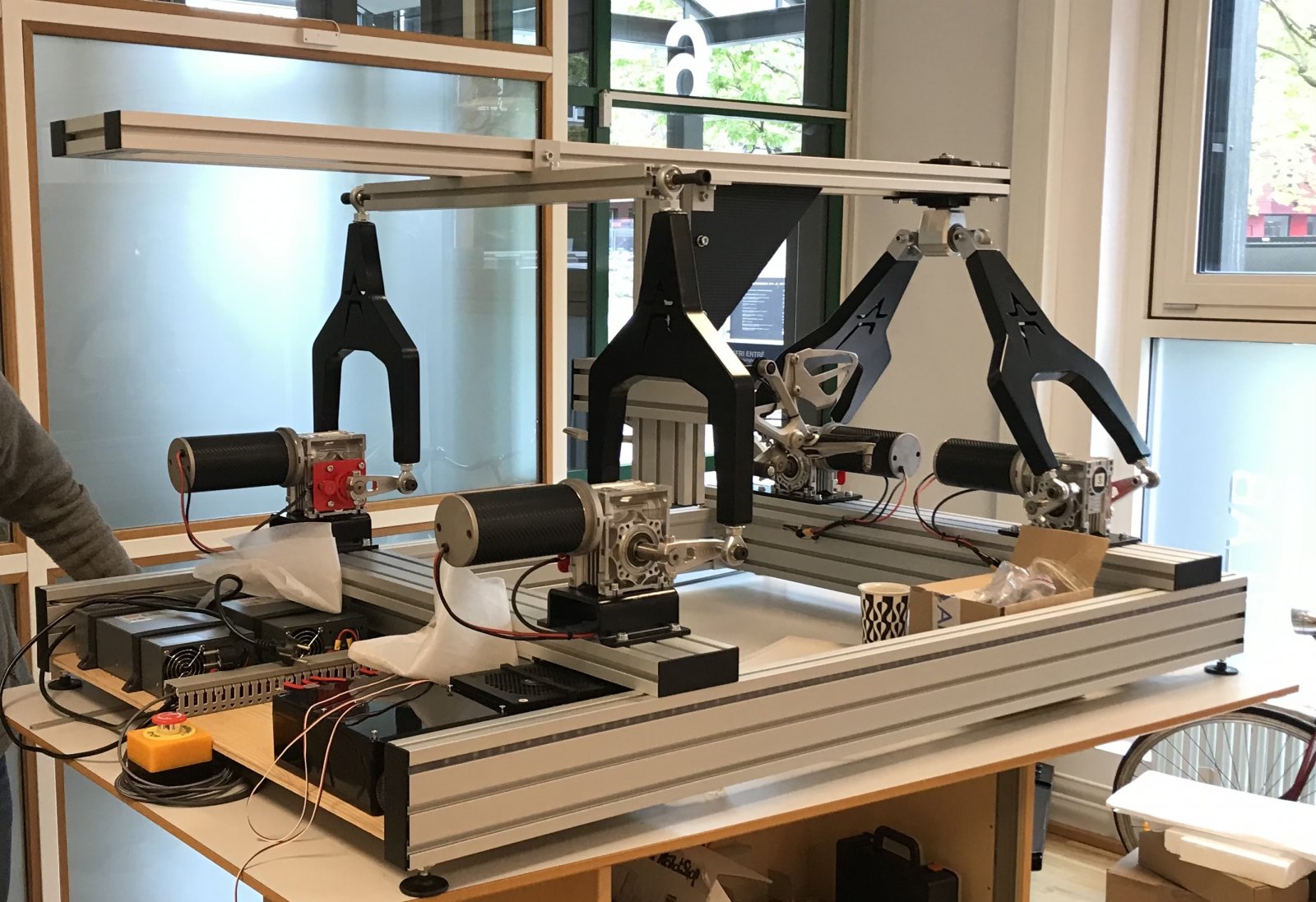

    Parts are showing up every week now! Assembly has begun.
    Update 25/4-2022

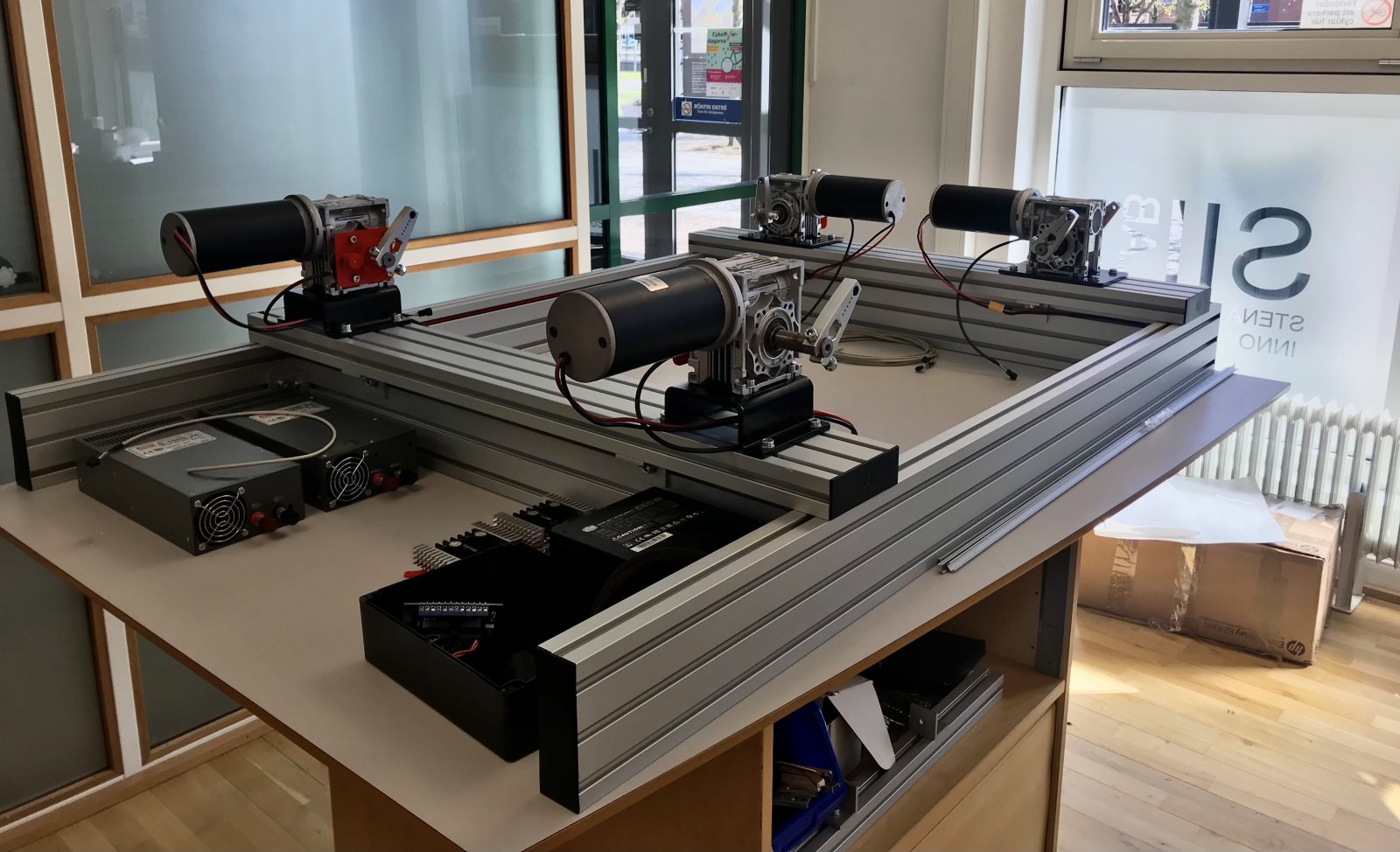

    Starting making the electronics plate and wiring so we can test the motors before mounting too much stuff on them they could break ;)
    Update 29/4-2022
    Got everything wired up! Still have some cable management to do, but everything is connected for testing and moves like expected!
    Exciting times! :D

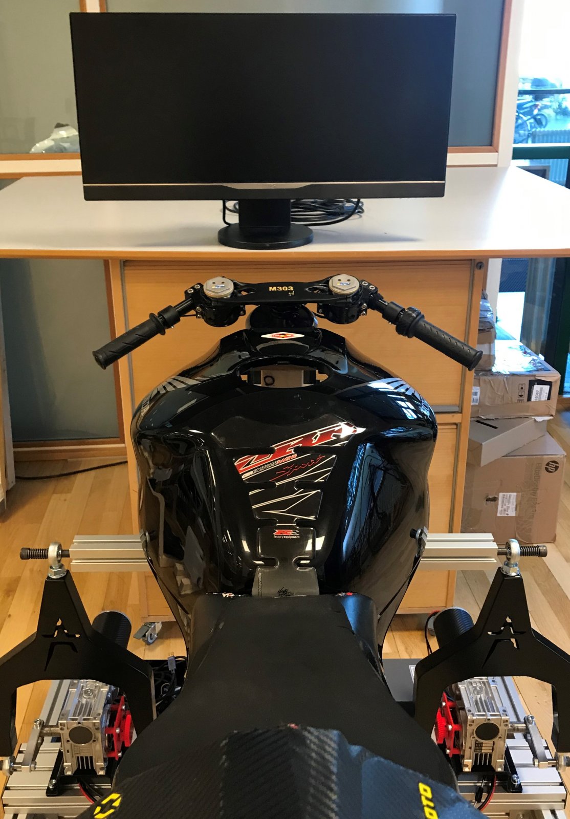

    Update 11/5-2022
    One step closer!

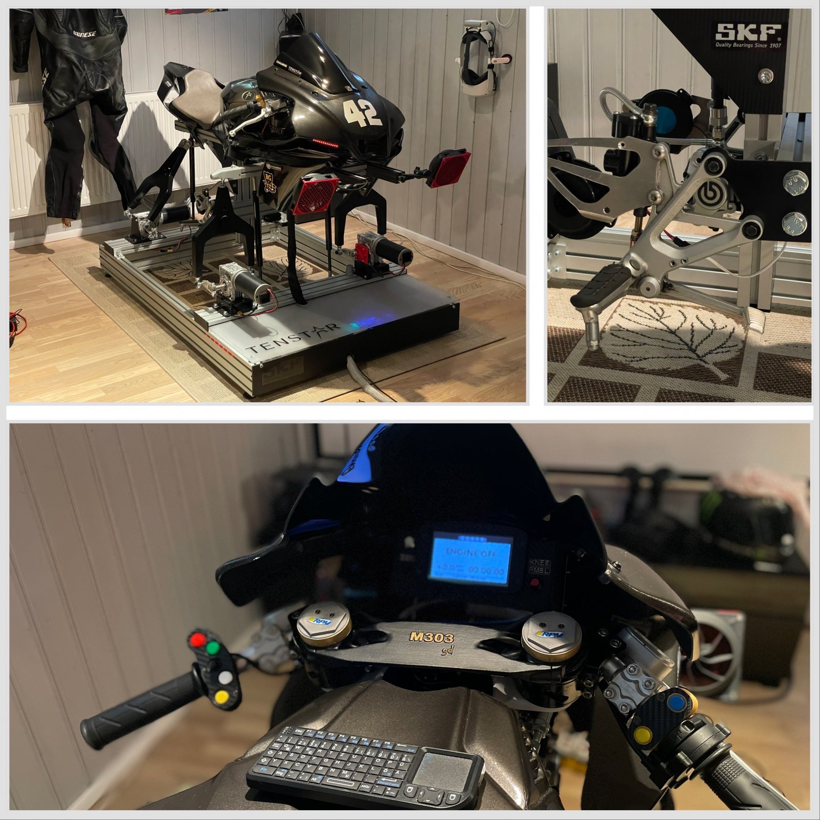

    Soooo, the thesis presentation went well and everything worked as intended (pretty much ;) )!
    The fairings seemed to never turn up, but an hour after the presentation I got a text saying they were ready to be picked up. Ironic.
    The last few days I have spent with brackets and paint fumes. Now coming somewhat close to what I wanted to achieve. There are a few steps left, but I am super happy with it so far!
