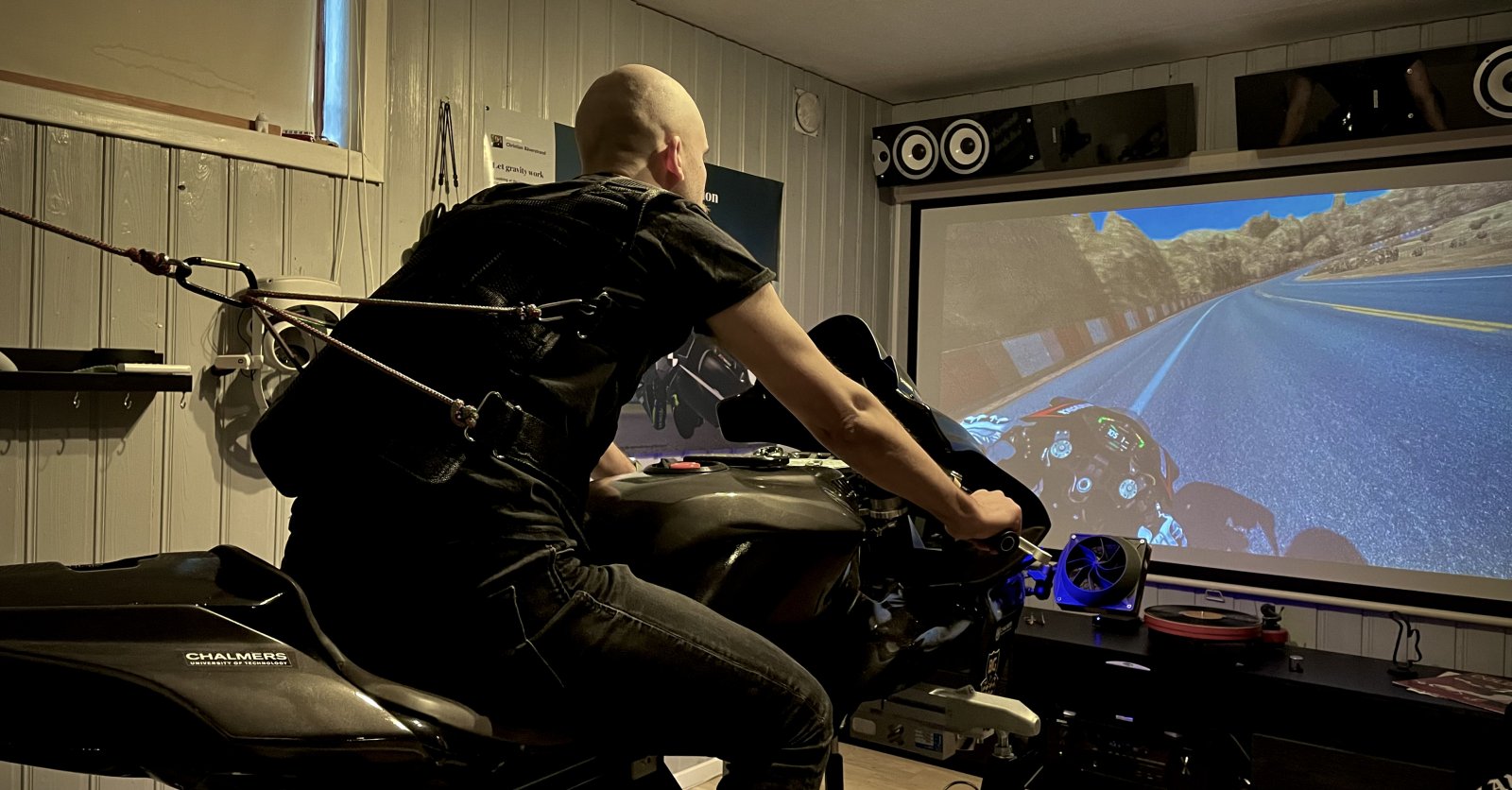

    Had a few friends over trying out the rig the other day. They liked the G-vest!
    None of them had ridden a motorcycle before and had some trouble adapting to the countersteering but got the hang of it quite quickly.

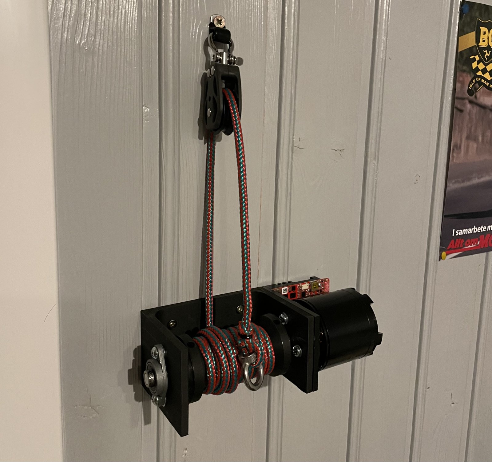

    I read a few scientific reports on motorcycle steering lately and while torque input during regular driving is usually in the 10Nm area, in racing it is often measured up to 120Nm momentarily.
    The direct drive motor I had before was about 12Nm and you could quite easily overpower it with the leverage of the handlebars. It does the job on a desktop controller but for the rig it was not strong enough.
    The current steering produces something like 180Nm peak which sounds kind of crazy but gives the simulation the chance to mimic the brutal forces experienced in real racing. nice.. and scary..
    Things need to be properly bolted down :thumbs

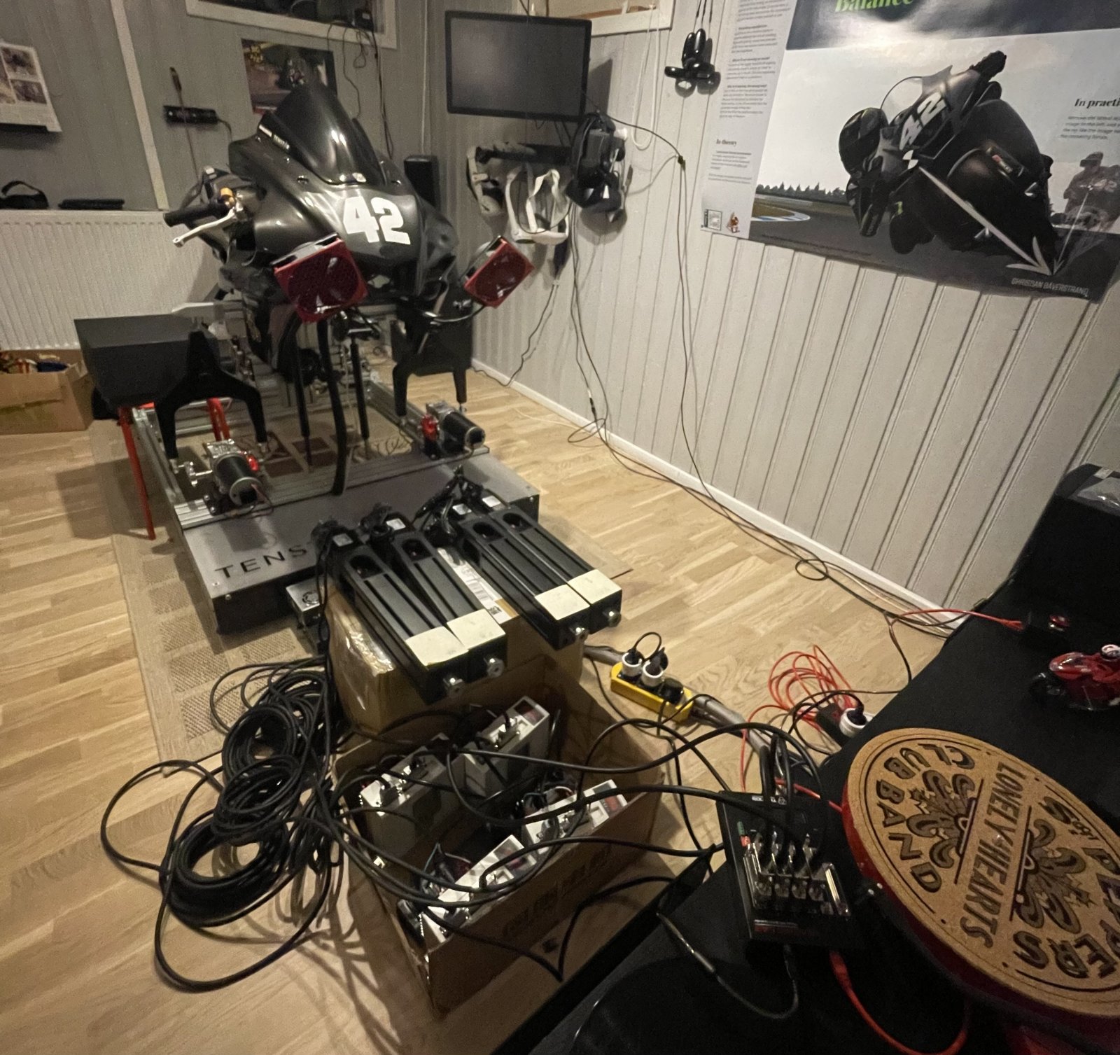

    The rig is finally getting a linear actuator transplant! The servos and controllers just arrived and more parts will be coming soon.
    Starting to work on the mounts, noticing that this will be substatially taller than with the worm gear motors..
    I'll make it work somehow :D
  15. Chris_Beeves
    May 31, 2019
    380
    2,196Coins
    +259 / 4 / -0
    Dry swimming the actuators before the parts from the water cutting guys arrive
    They are soooo fast and silent compared to the worm gear motors. Can’t wait to try this out!

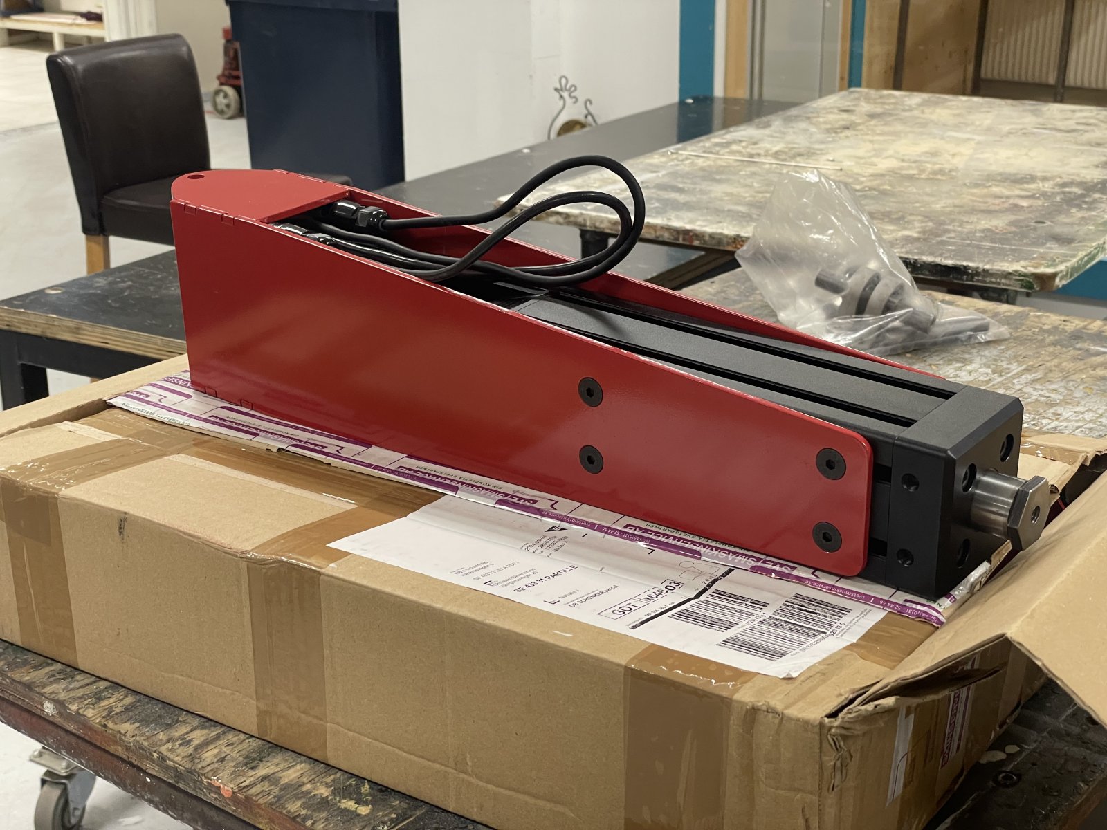

  16. Chris_Beeves
    May 31, 2019
    380
    2,196Coins
    +259 / 4 / -0
    The water cuts are here!
    figured red would cut a few hundreds off the PB. Powder coated them today, so now I just need to mount it all. Fingers crossed the design works
