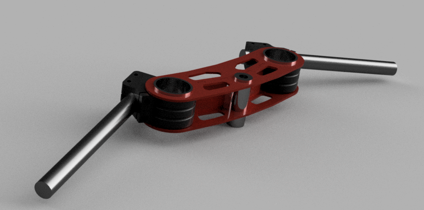

    I’m currently working on replacing the servos I use for steering feedback with a bigger geared brushless servo. It became quite a large project with a few bits to fabricate before I can properly test it out. Looking forward to having sturdier handlebars.
    The new brushless servo reads the input torque too, so maybe I can ditch the whole load cell setup! That would be neat..

    The contruction of the new top clamp turned crazy, so now I'm aiming at a CNC solution. I will need to cool down and do something out of wood or similar to evaluate the servo before getting too excited.

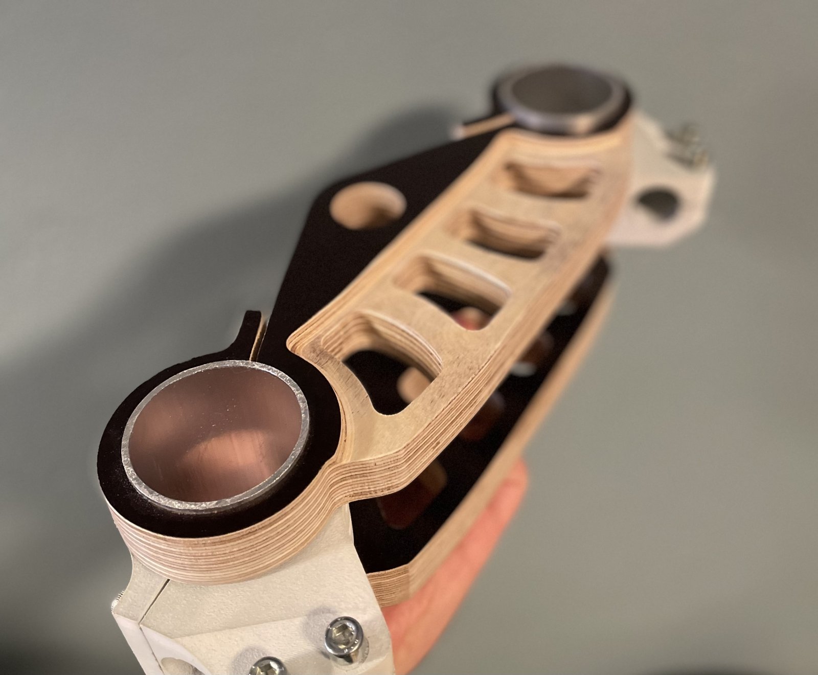

    Finally took the time to figure out the wood CNC mill and managed to make this:
    As a proof of concept I’m super happy with it! Remains to be seen if it holds up mounted to the rig.
    Next tool to figure out it the lathe for making the axle.. The current one has a 3d printed axle with a threaded 8mm rod inside.

    Wow.. That blur effect on the mobile camera was a bit much now that I see it on the computer o_O

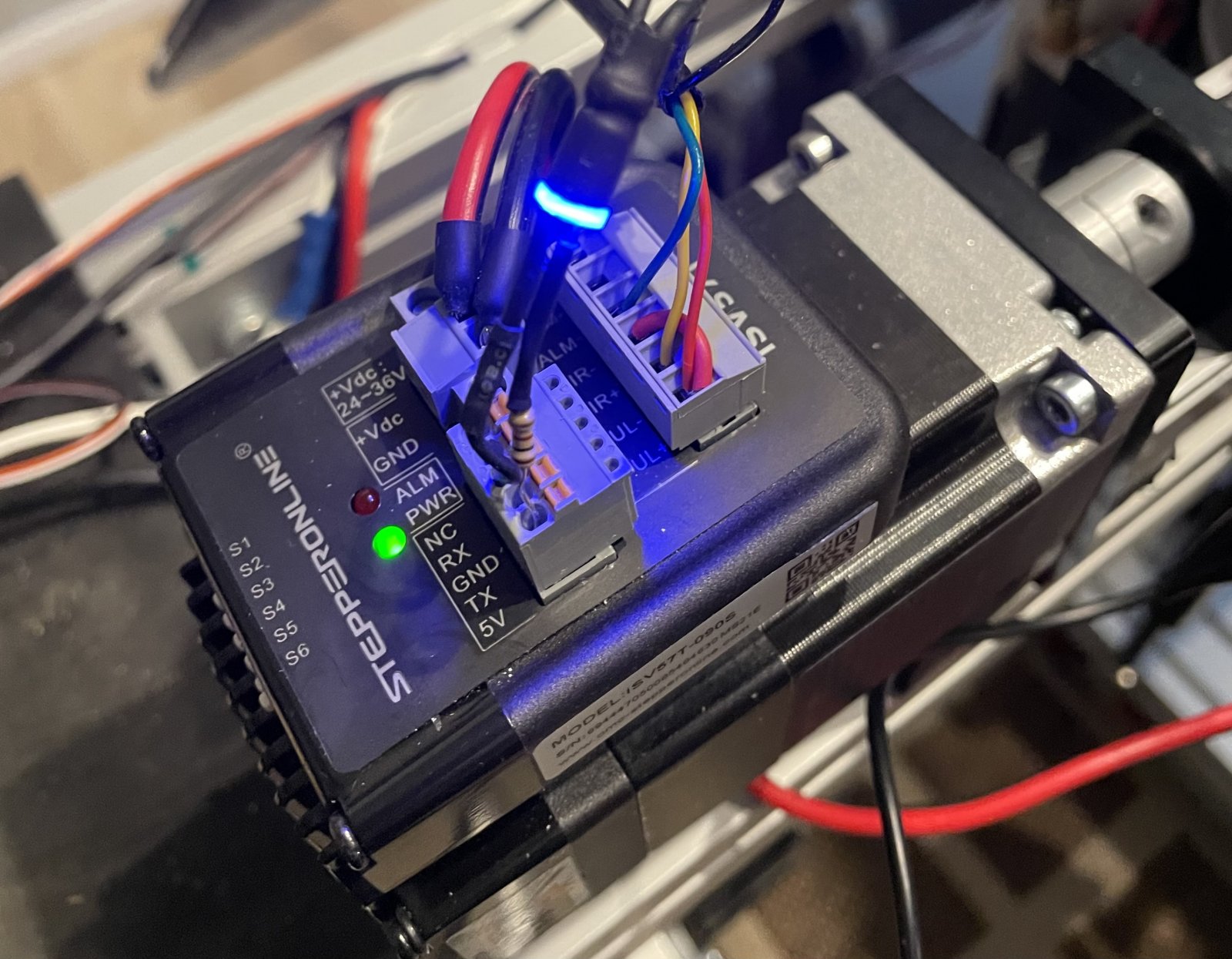

    Finally after many obscure obstacles I have the new steering hardware in a working state!
    Still waiting for the billet clamps, but the plywood prototype is feeling solid!
    I use an isv57 servo for force feedback now instead of the 1:5 RC servos. Code is more difficult, but the performance is a step up for sure.
