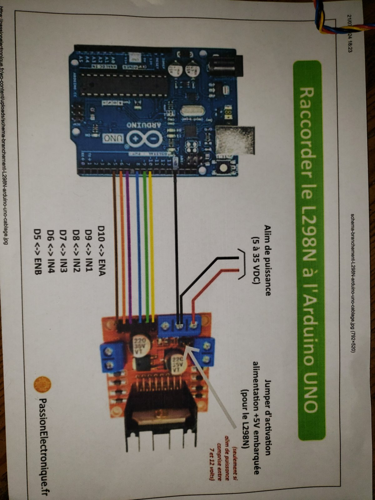

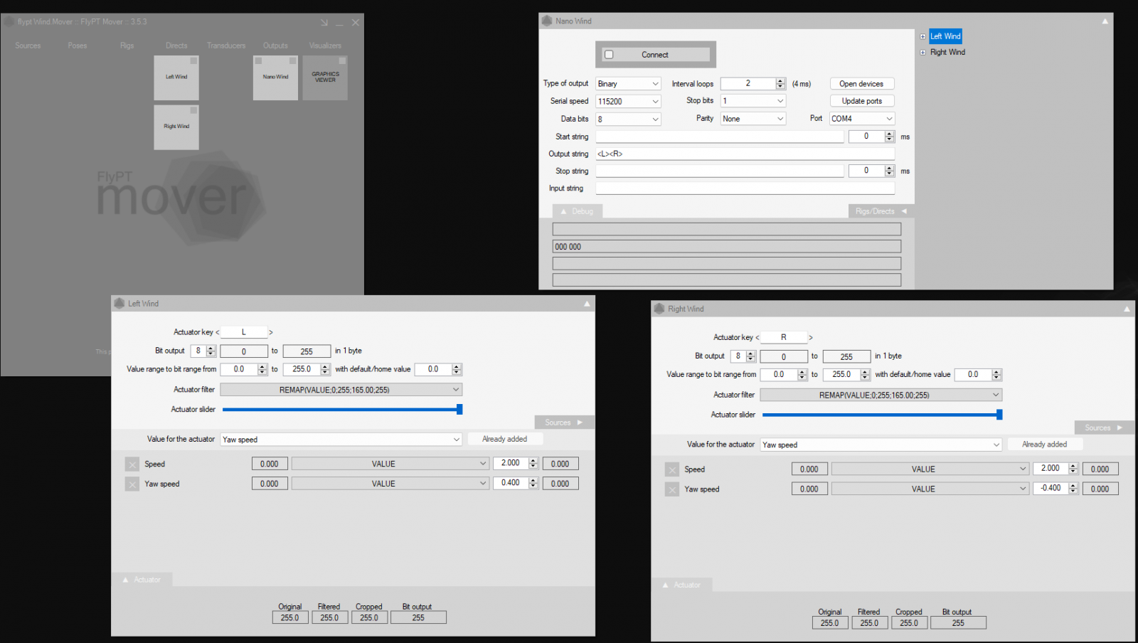

    Issue :
    I have 2 fans that I would like to control individually, with this code only 1 fan works and I am clearly not good at finding the cause!!!
    I use flypt mover, and I can run a single fan with...
    If someone could explain it to me, here is my code and what I have under flyPT mover (the rempa works very well for the fan which turns...)...

    Another code that works when I send the data to the arduino monitor: 000 255, motor 2 is running, 255 000, the right motor is running and if I put 255 255 both are working.
    Problem I put <L> and <R> with an output which gives me 000 000 under flyPT mover nothing seems to come out, as if arduino did not understand the sending of FlyPT ???? ?
    Help ! I don't see what is wrong, the code works very well under arduino with the monitor, why does it not work with FlyPT???
