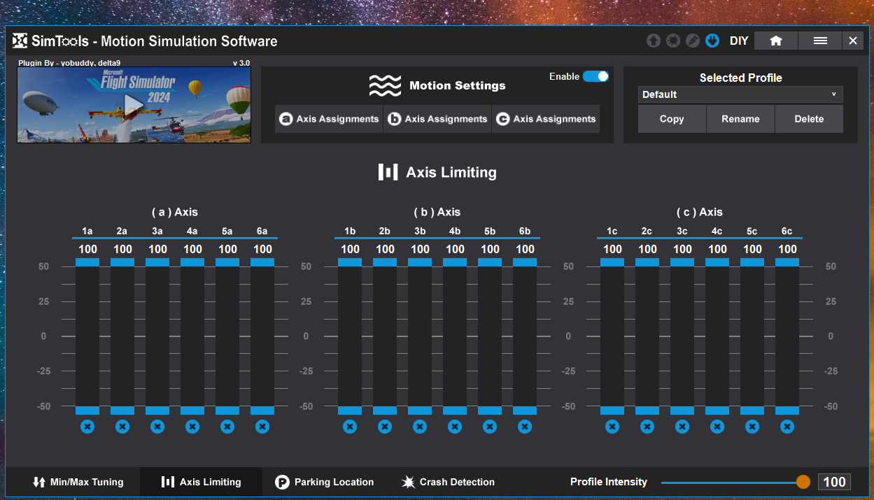

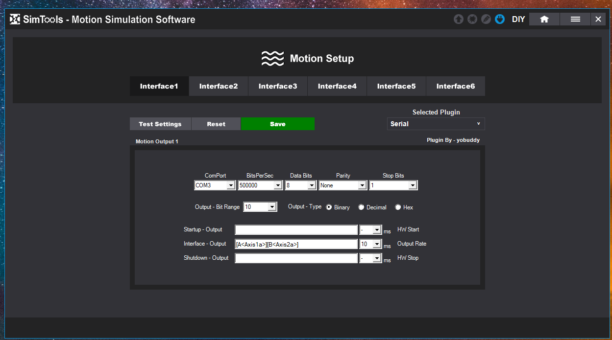

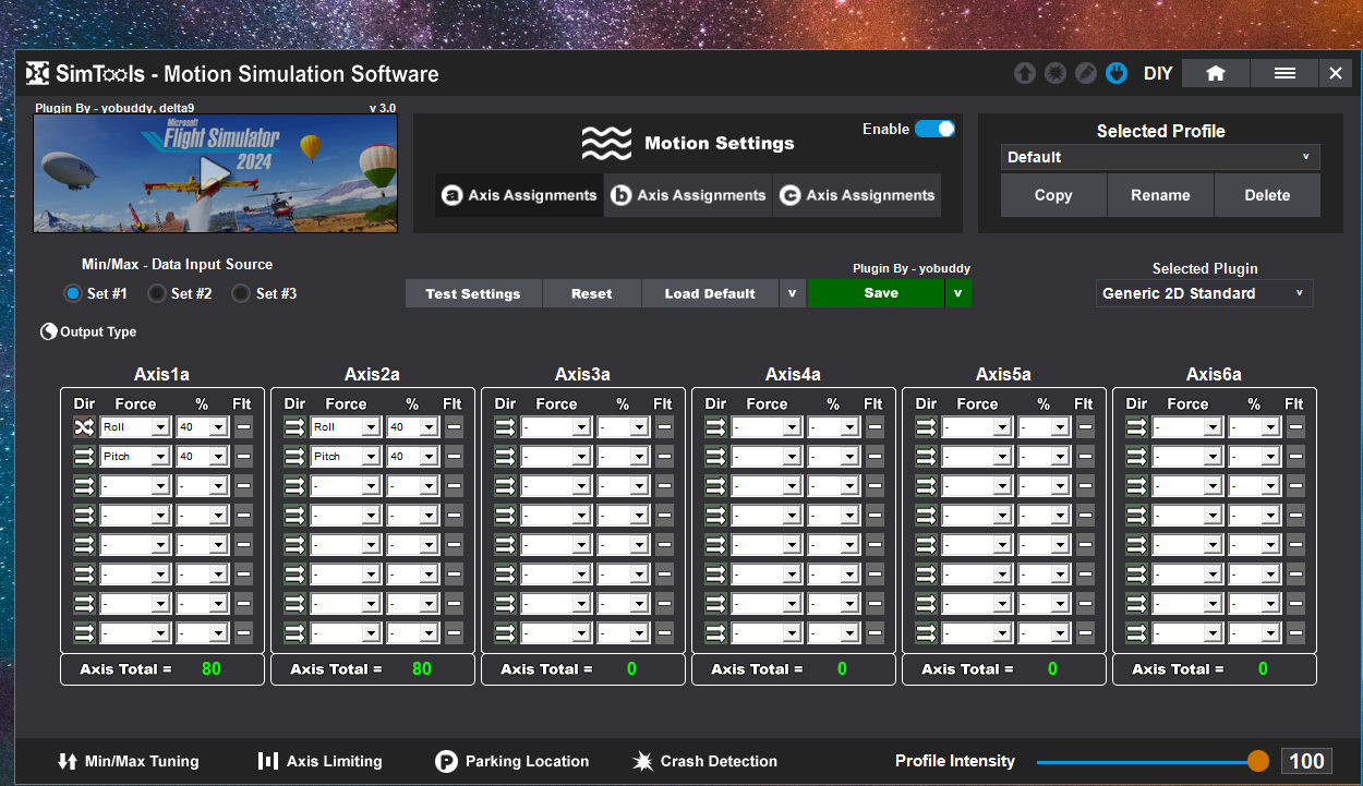

    I eventually got my rig (2DOF) going on LFS as designed, although I still have trouble saving max min settings and have them available for next time I play. However that can wait as the reason I built my rig in the first place was for MSFS2024.
    I have downloaded the plugging and configured it as for LSF except using pitch and roll. But although the platform sets up (moves to start position) when I start a free flight, none of the controls (pitch and roll) get any response even though I can see the yoke on MSFS airplane move as required. I have done a number of flights before trying it on the rig.
    Anyone else have this issue? Should I try the MSFS 2020 plugin?
  13. noorbeast
    22,225
    154,819Coins
    +11,226 / 57 / -2
    Can you please post pictures of all of your settings, including the Tuning Center while the game is running.

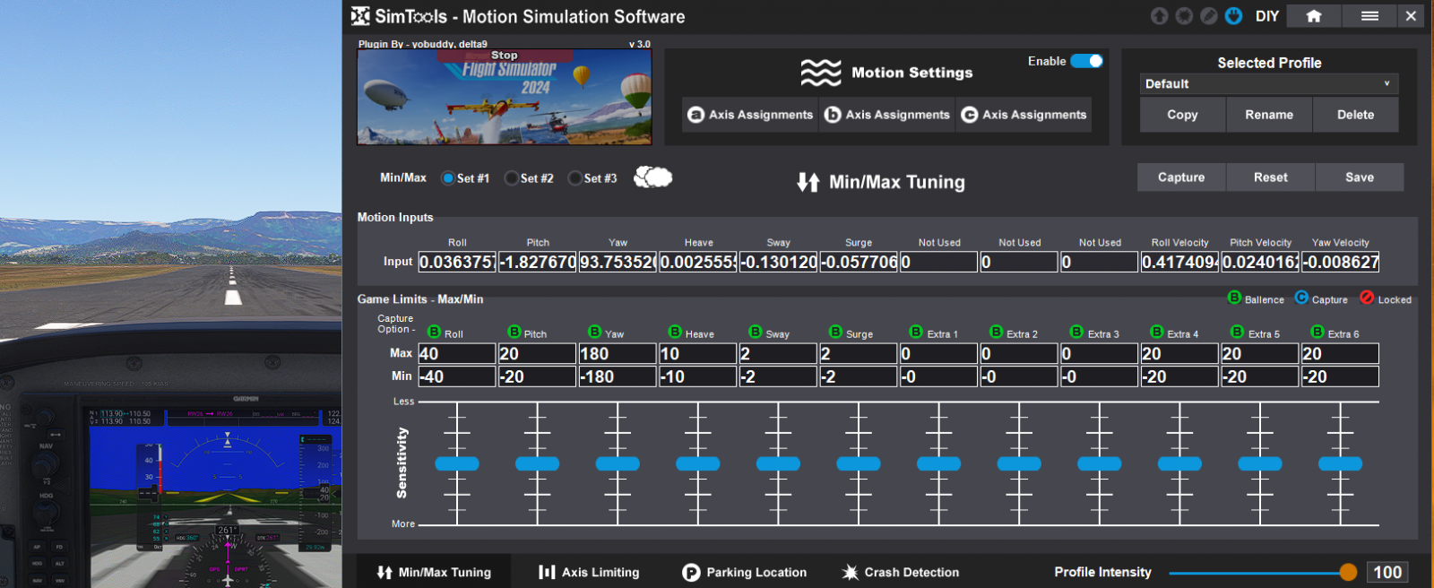

    Thanks Noorbeast for quick response,
    I have screen shot everything I can find re settings and I ran the game and screenshot the results. The numbers in the input boxes move up and down randomly and do not seem to be linked to the yoke movements.

    The plugin looks to be working, given it provides data in the top Inputs row of the Tuning Center, suggesting further configuration is required. Try Capture, fly around normally, then Save in the Tuning Center.

    OK I have tried capture and flying around and I can see the figures changing in the input lines and the Max Min lines when I save, but when I go back in the next time the figures are back to default. I also note that simtools does not close down when I use the x in the top right corner and I have to use task manger to shut it down. Have I got the installation right?

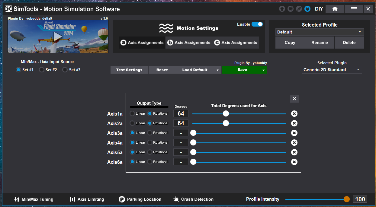

  18. airpix
    airpix AA -Altitude n Attitude
    Jan 11, 2025
    Northern NJ
    27Coins
    2DOF, AC motor
    Hello, I have a 2DOF simulator. I see from your pics your output types is directional not linear. Is this correct. I have mine set to linear. Should I change it to directional? It is a little rough in pitch and roll. Feels like it is choppy.

    48Coins
    Hi airpix,
    My setting is "Rotational" as opposed to Linear as I have motors not actuators. Your roughness sounds to me like tuning is required.
