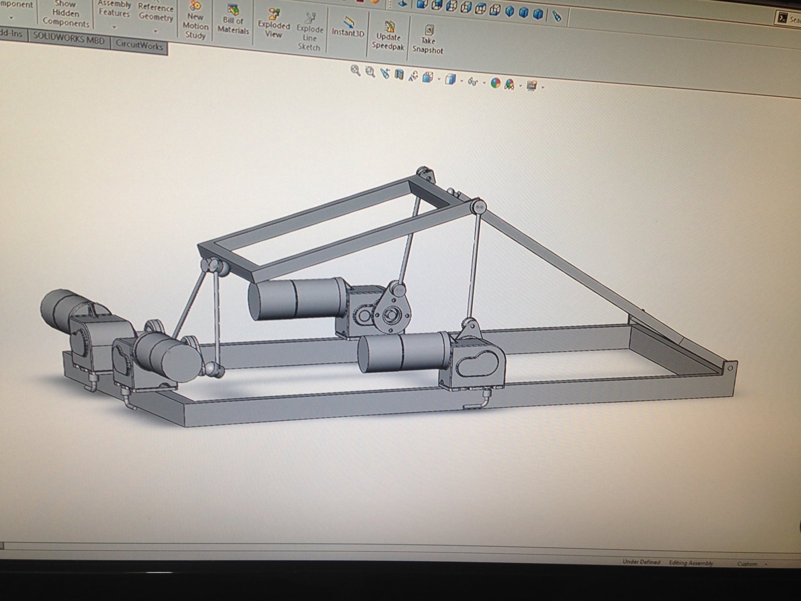

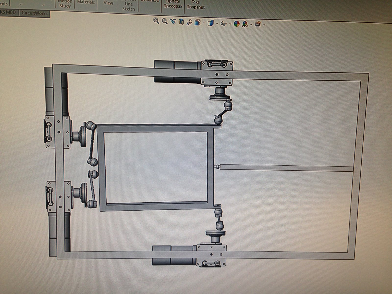

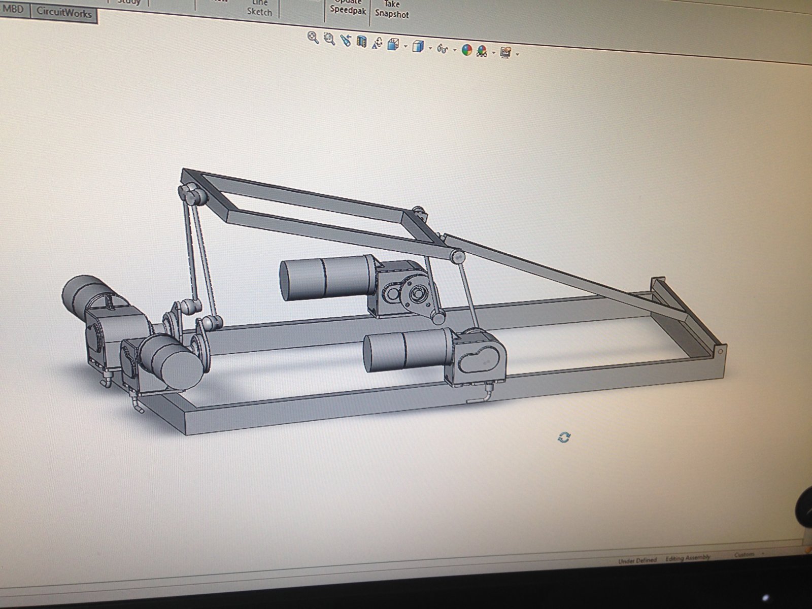

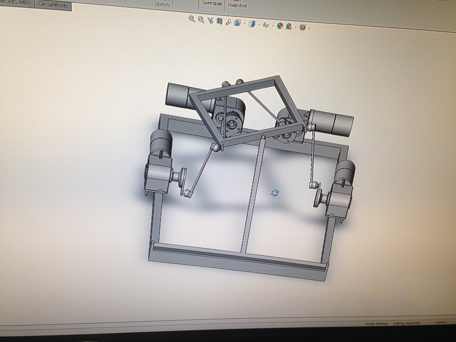

    Using Solid Works I started designing my rig.

    @MWB,
    Have you tested your design in solidworks to see if it will fall down?
    lt doesn't look constrained in all positions.

    Hi @OZHEAT, yes I tested it in SW, took a bit of mucking around to get everything positioned correctly, but it seems stable now. Fingers crossed.

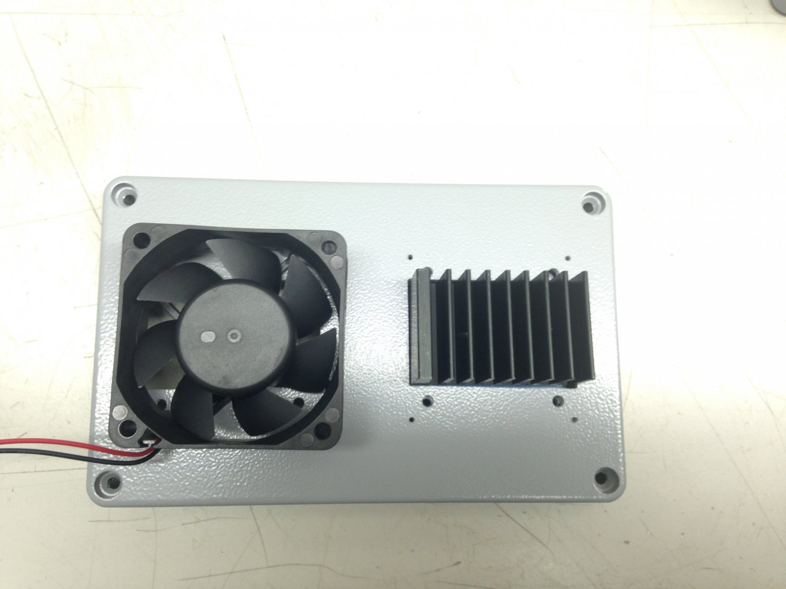

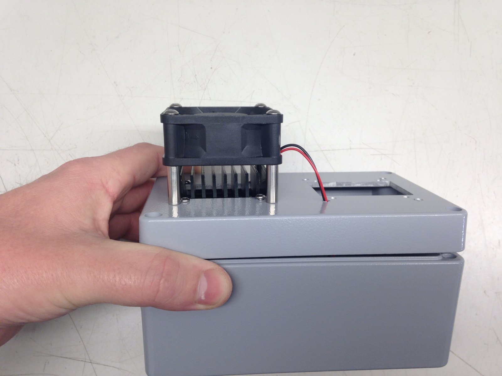

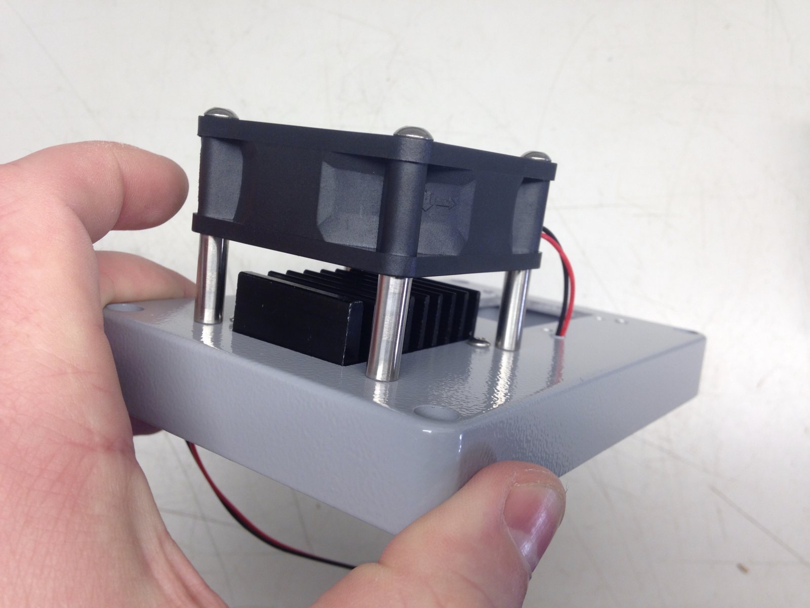

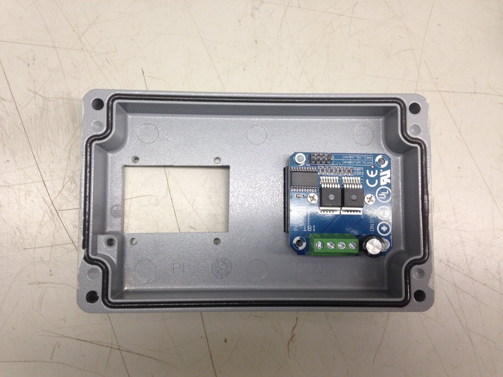

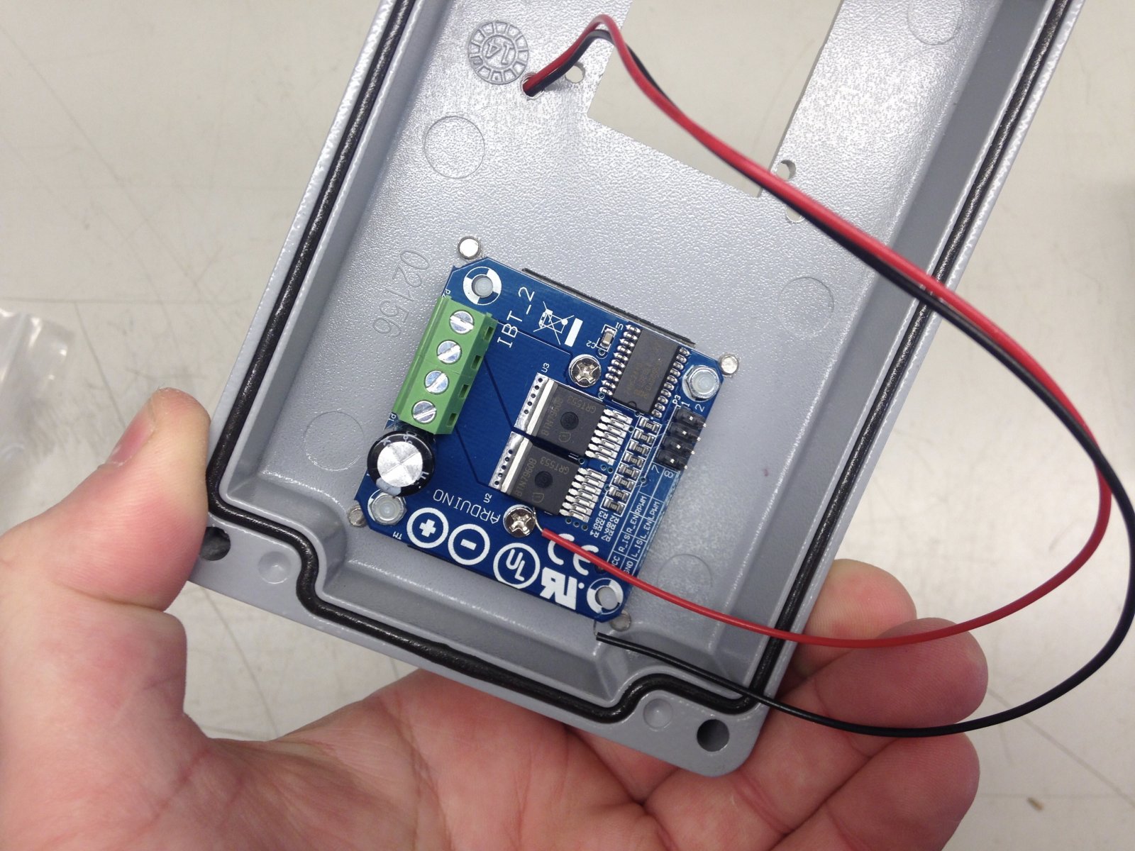

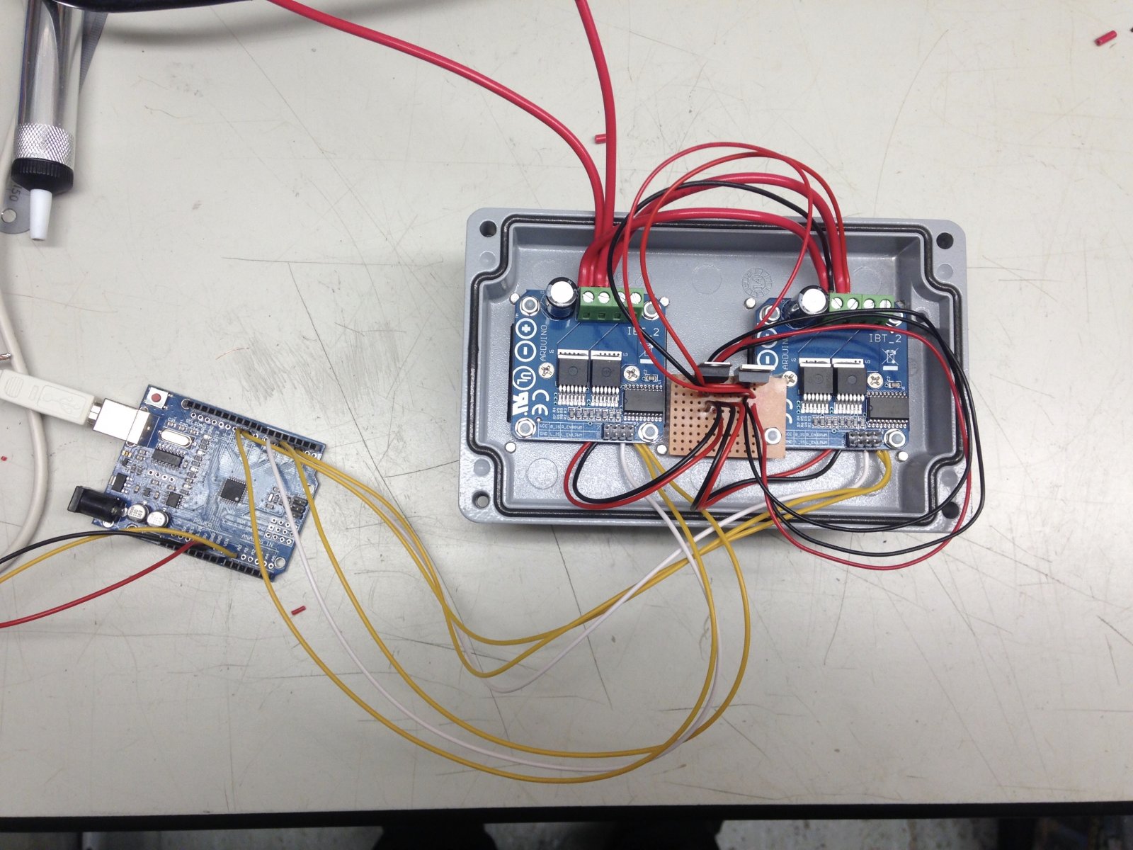

    Started mounting at couple IBT-2 in a box so that I could also mount fan's on the heatsinks

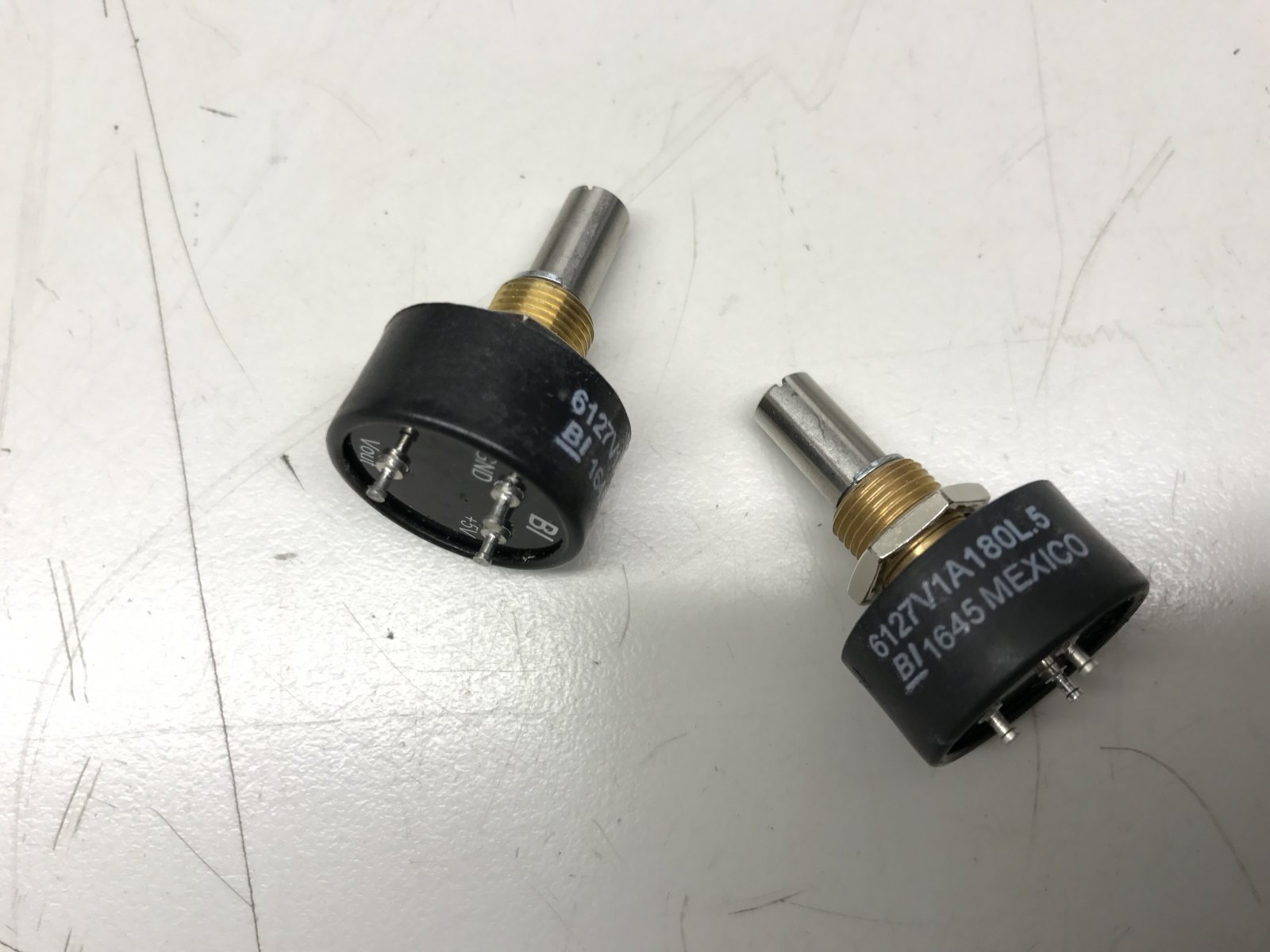

    Hall affects pots turned up from Farnell today! :thumbs

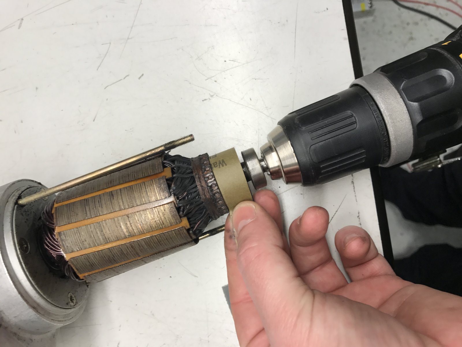

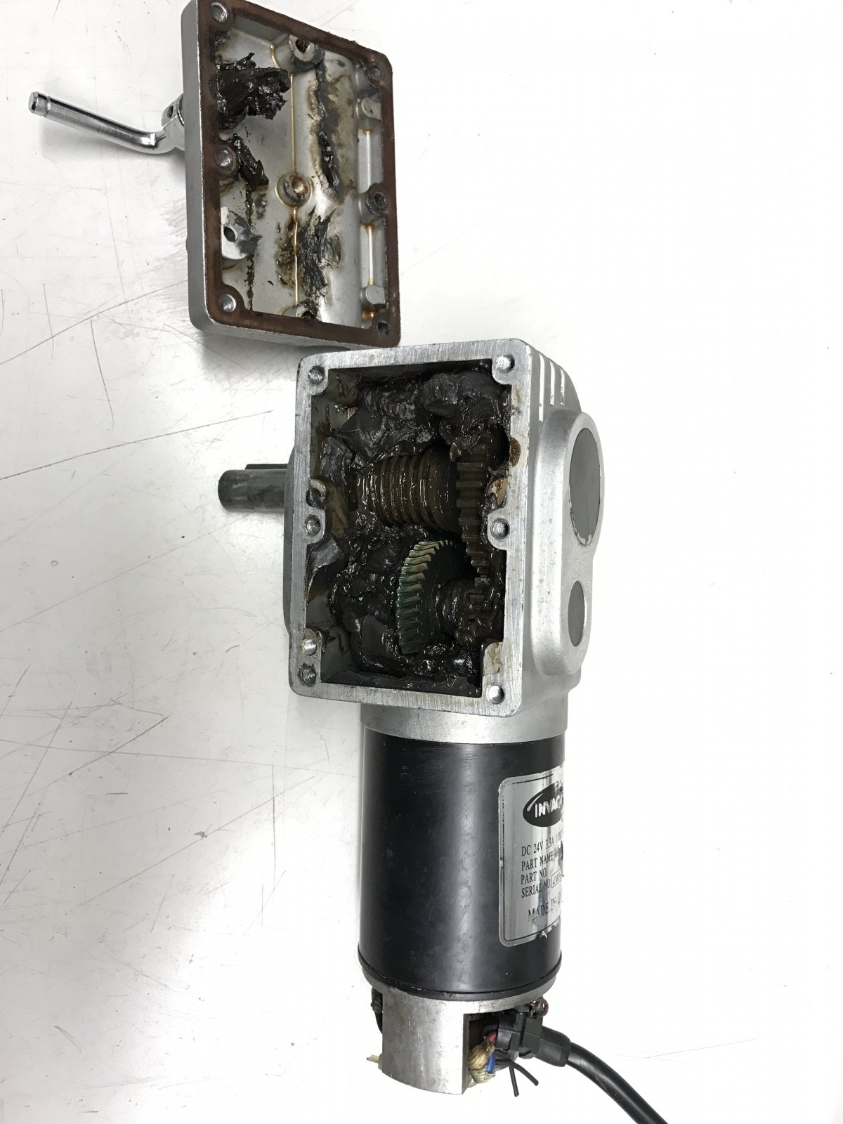

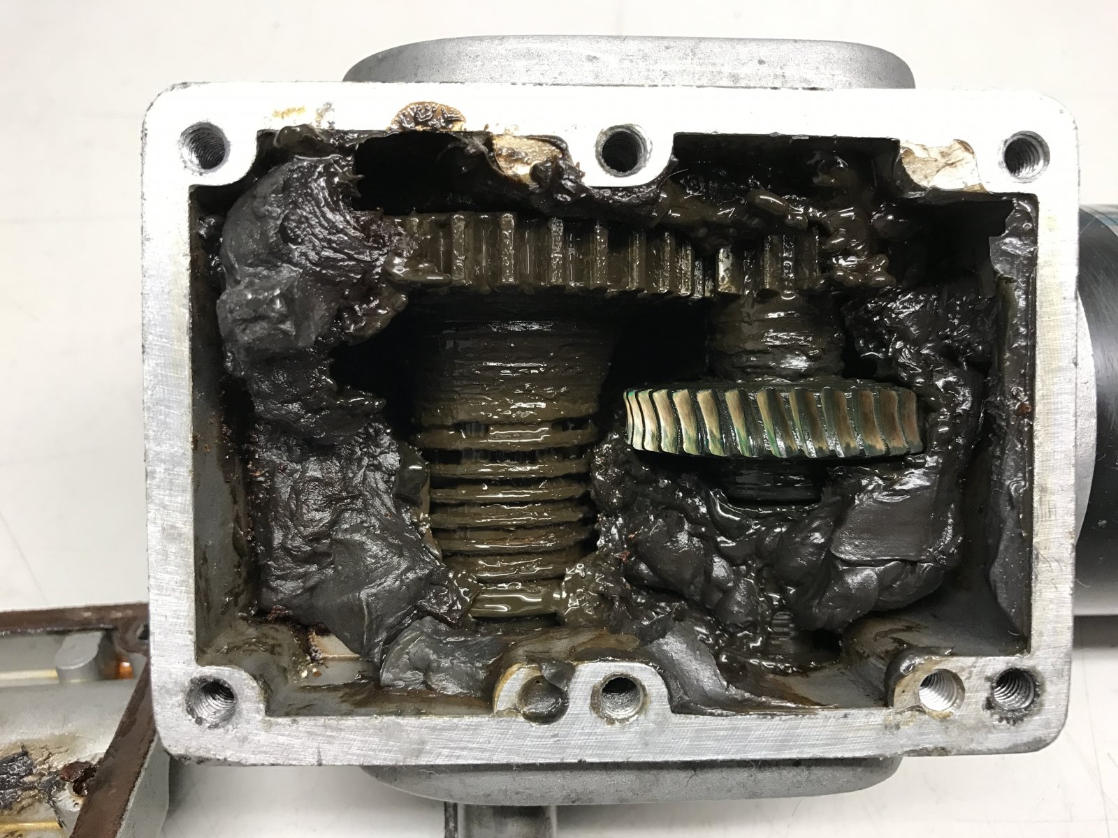

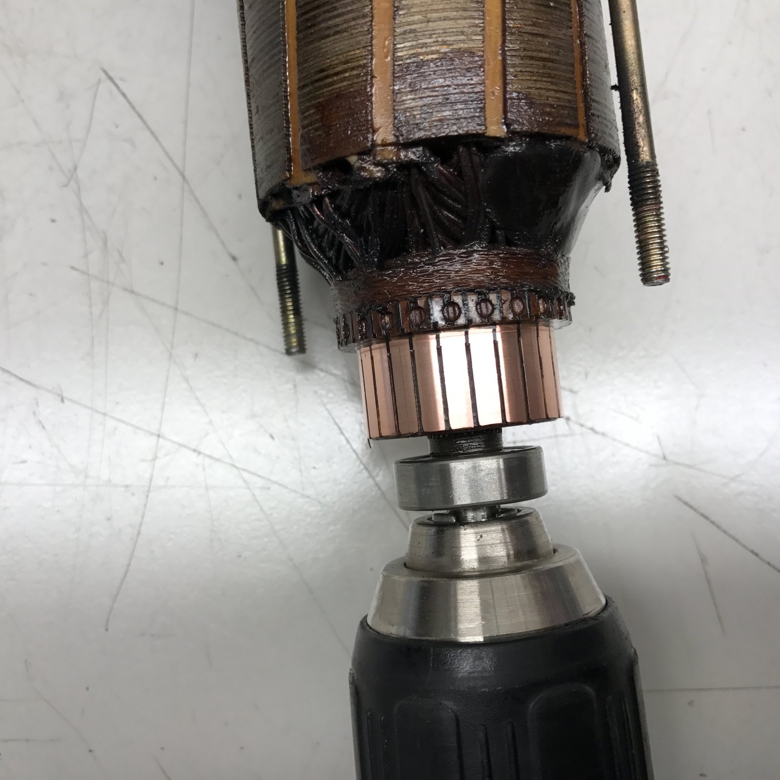

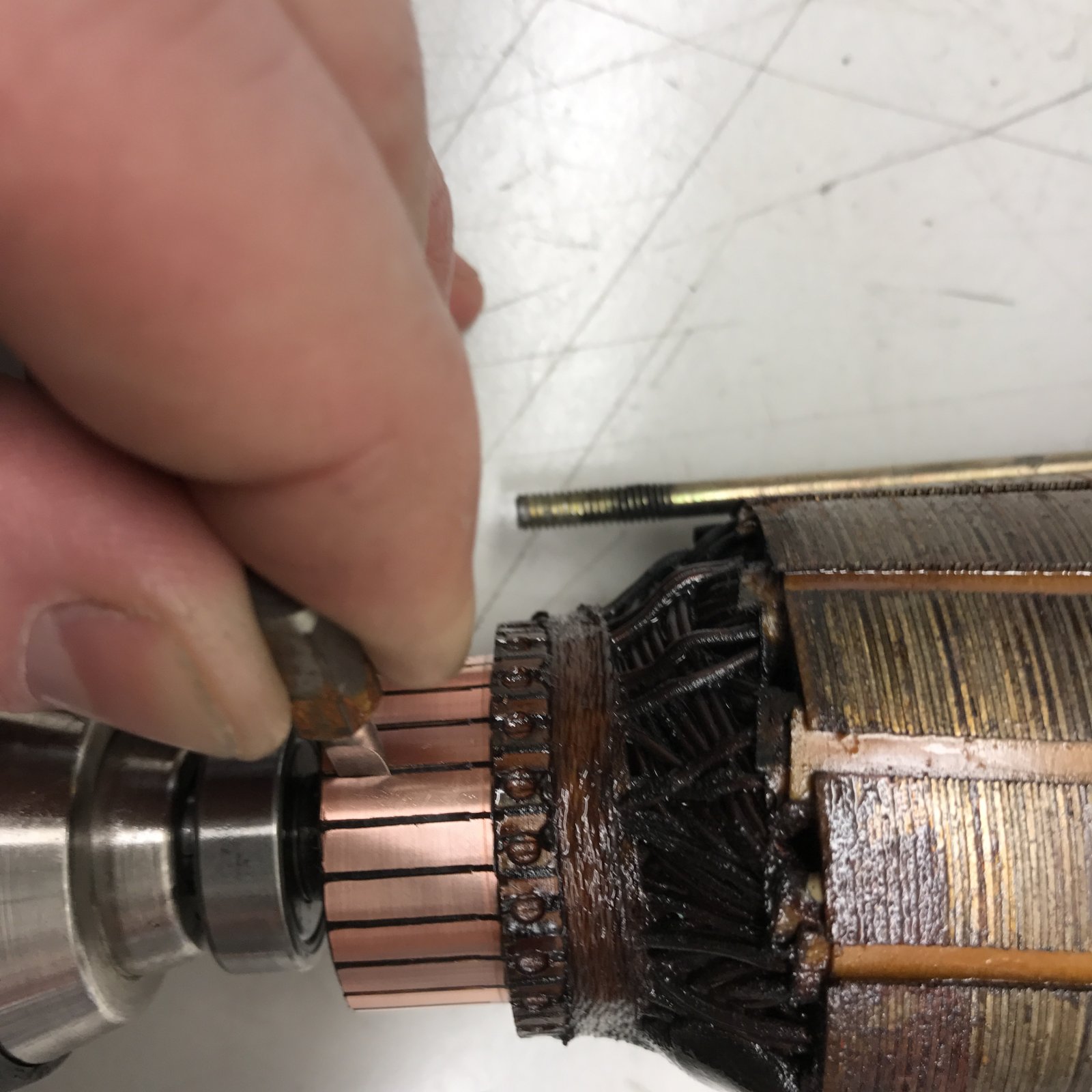

    Struggling with one of my motors so I decided to clean up the commutator. IMG_3941.JPG
    Gear box grease is pretty grim!!

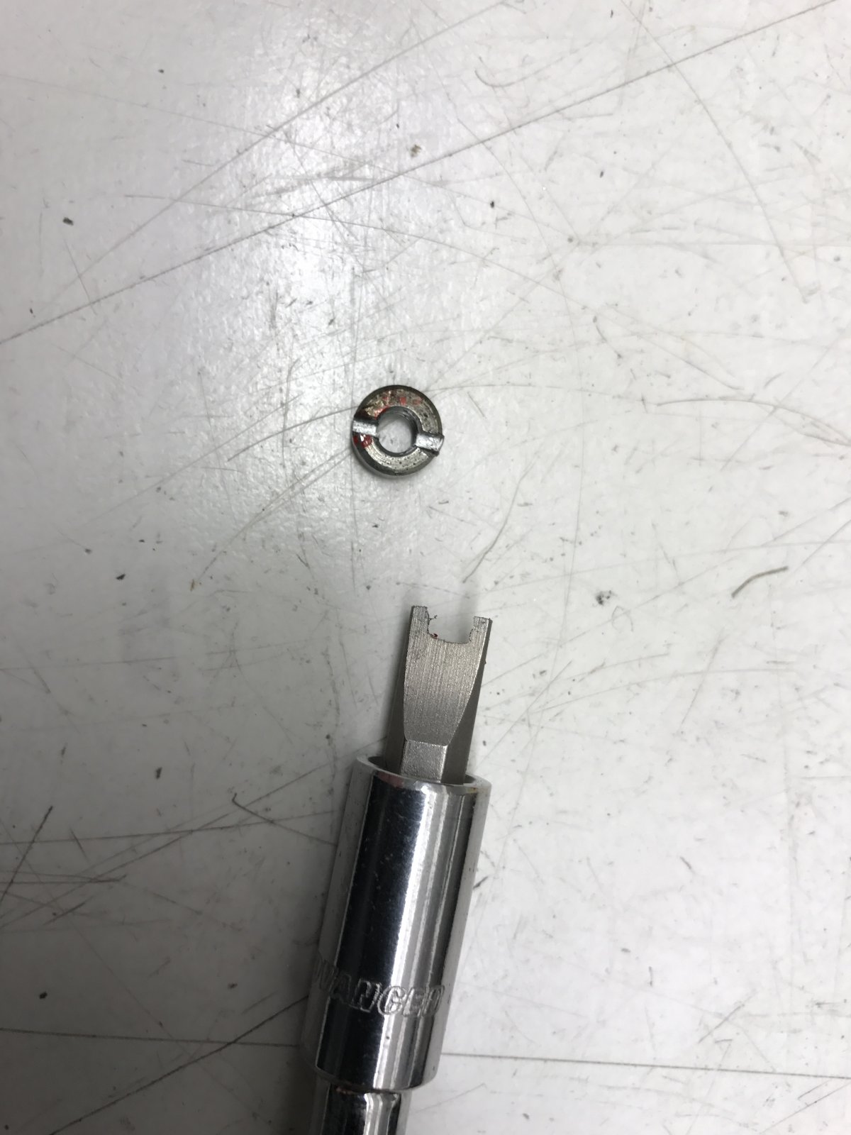

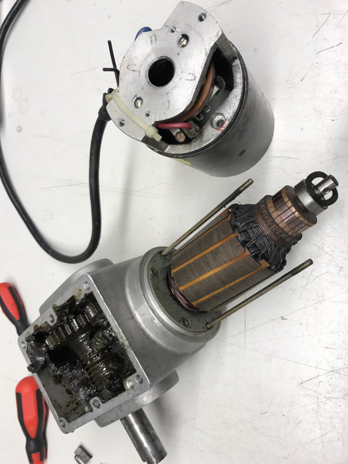

    In order to get to the commutator, I needed to remove both brushes and modify a flat blade to get the two nuts off.

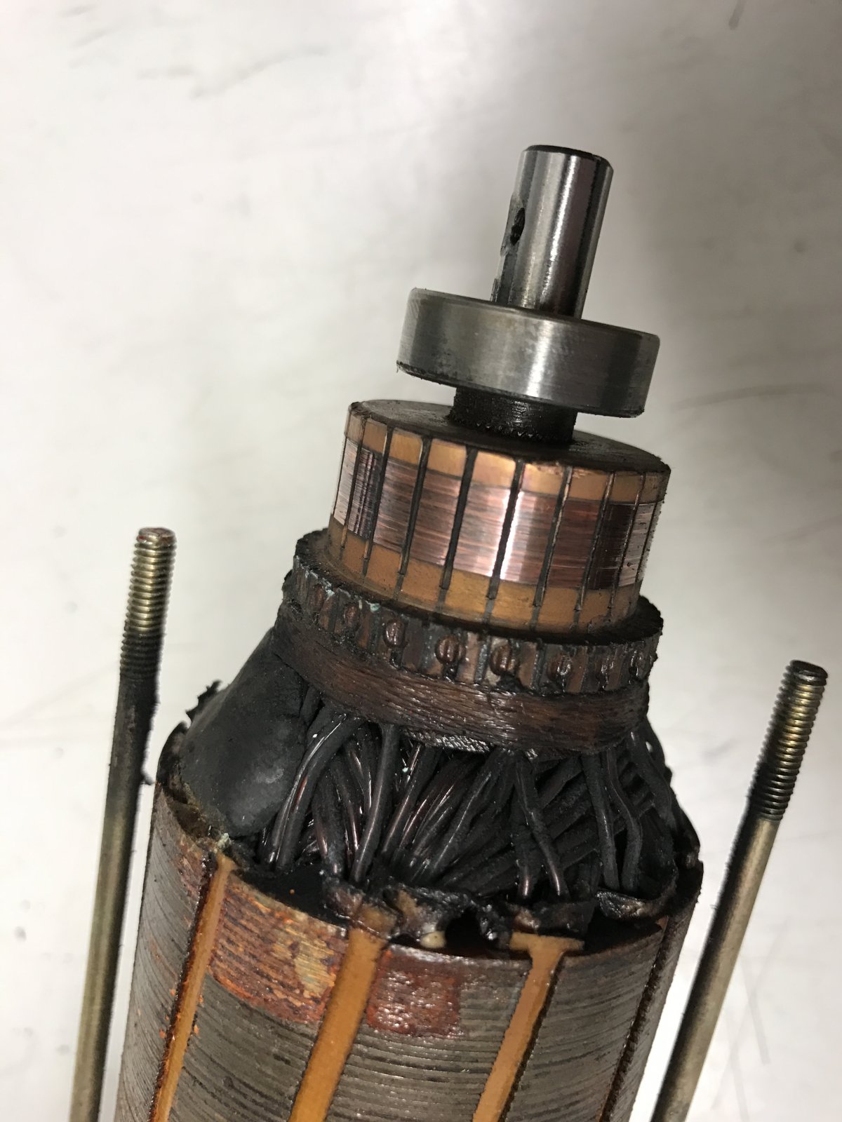

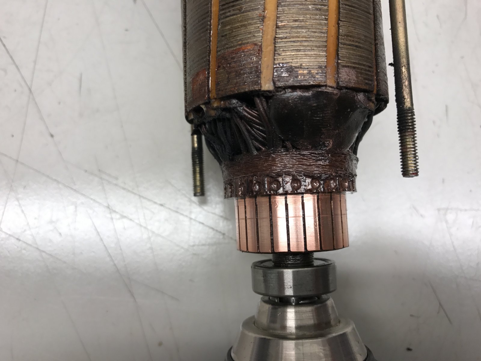

    The commutator doesn't look to bad.
    But I cleaned it up anyway, using my drill and 1200 grit, then 2500 grit.
    Had one stubborn score! Little more to come off.
    All done!
    Just needed to scrape out and crap between the commutator tracks.
    Then just a good clean up to get rid of any carbon from the brushes and sand paper. I had buzzed everything out before and after with a ohm meter. Hope this works a little better now! I'll let you know how I get on.
