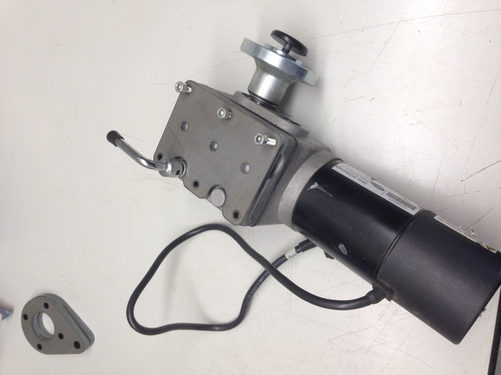

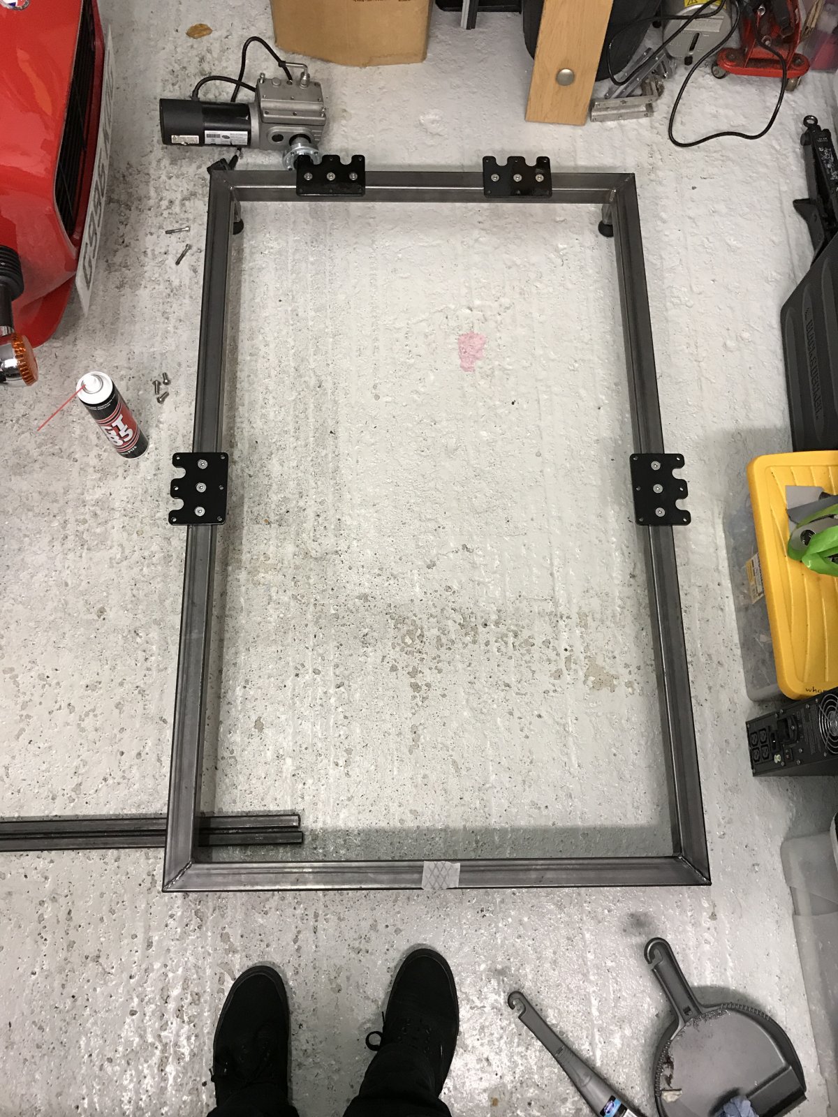

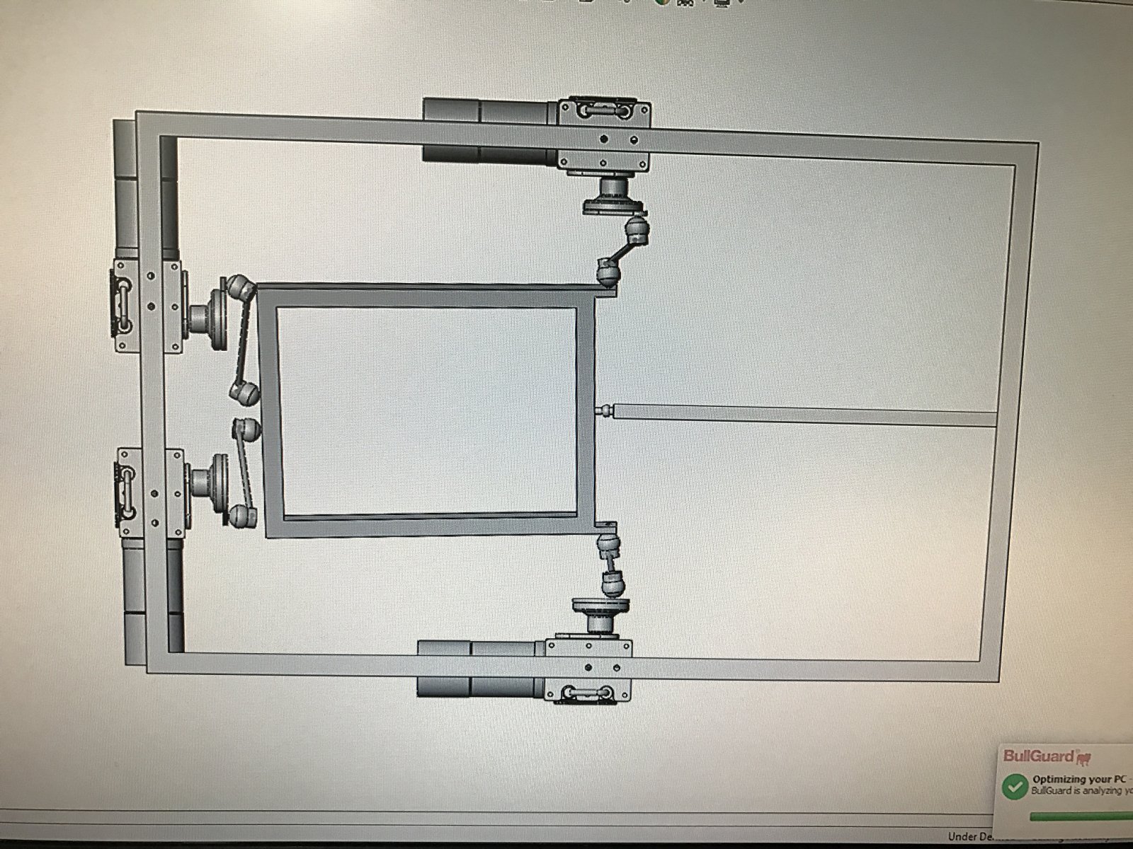

    Got a little catch up to do with my build, I've been quite busy. Getting my frame together over this holiday break.

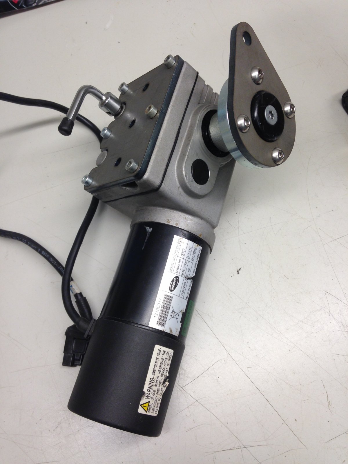

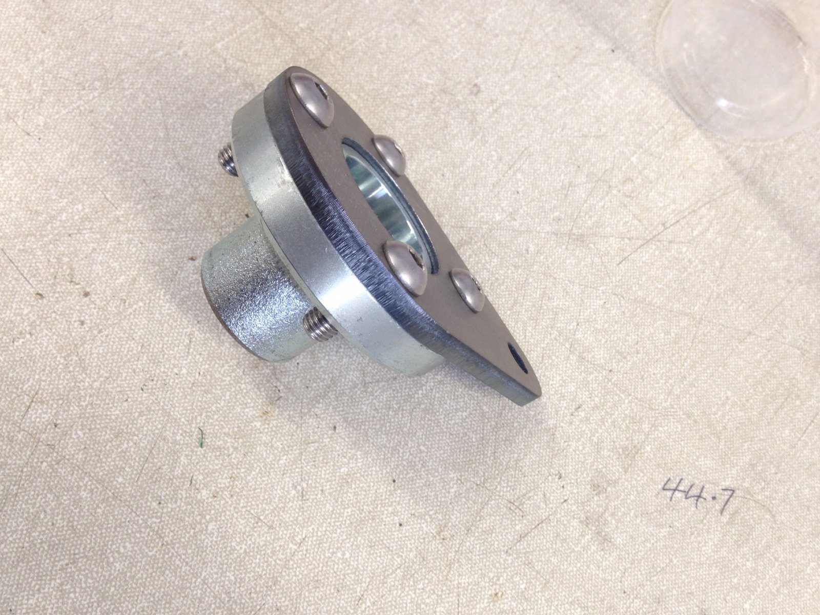

    Have two brackets laser cut first one is my arm, decided to use the wheel hub of the wheelchair wheel.

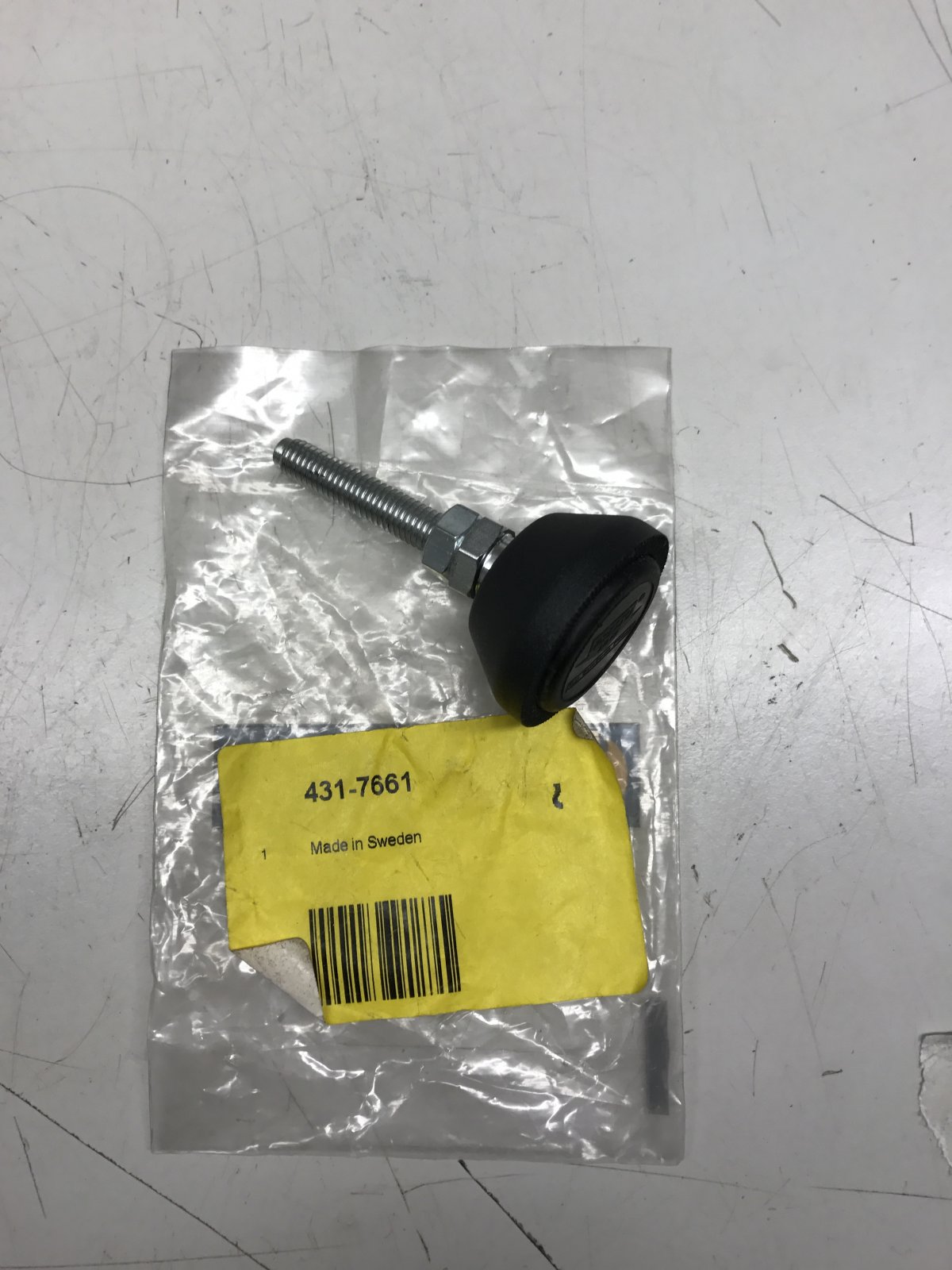

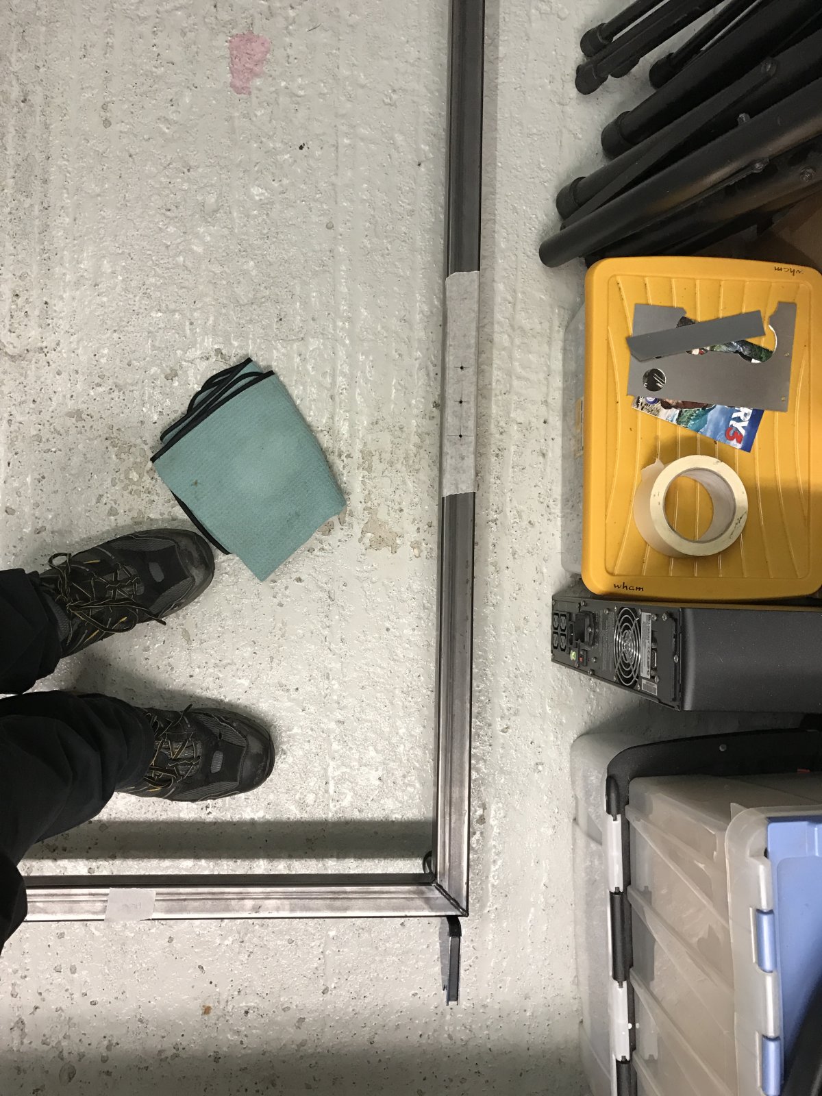

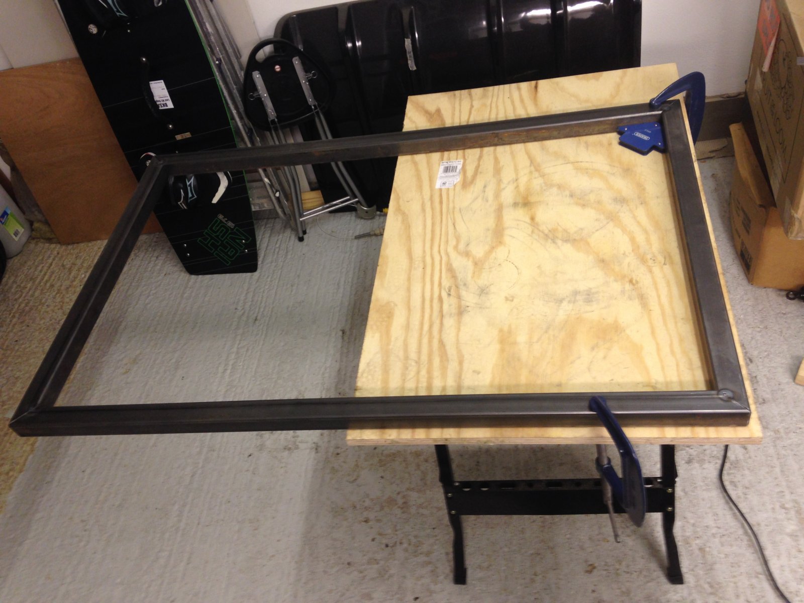

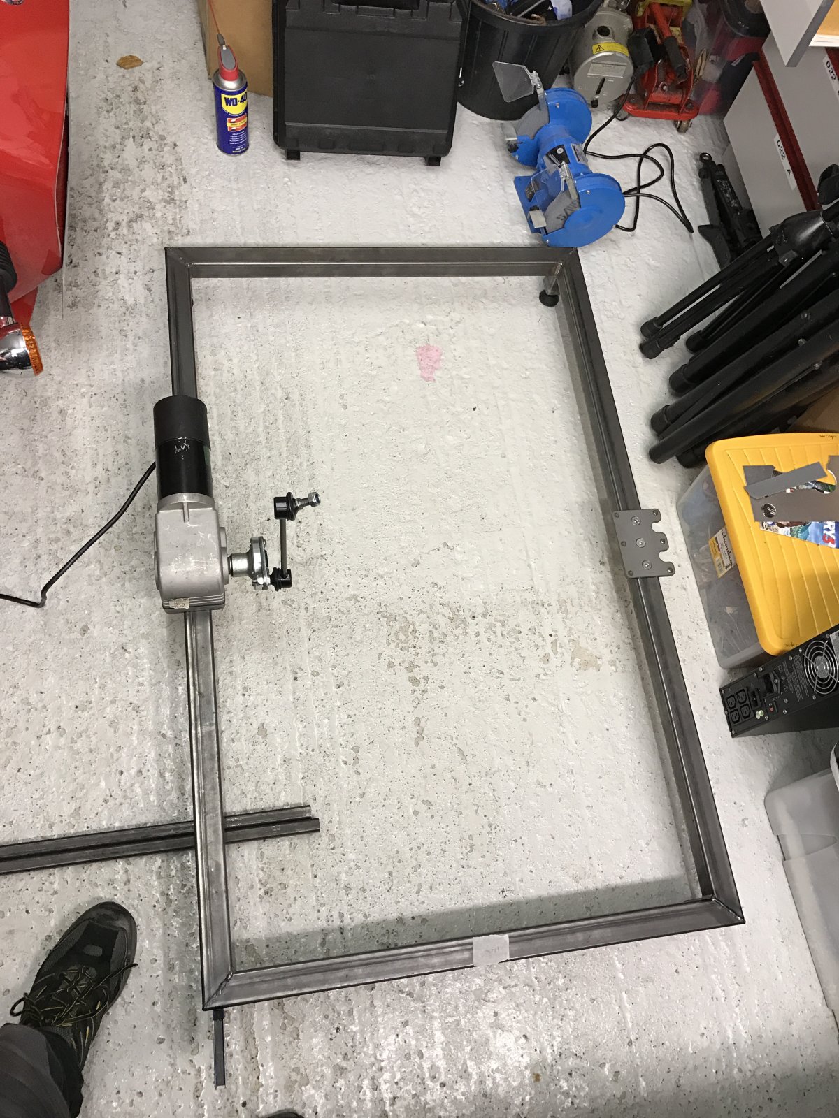

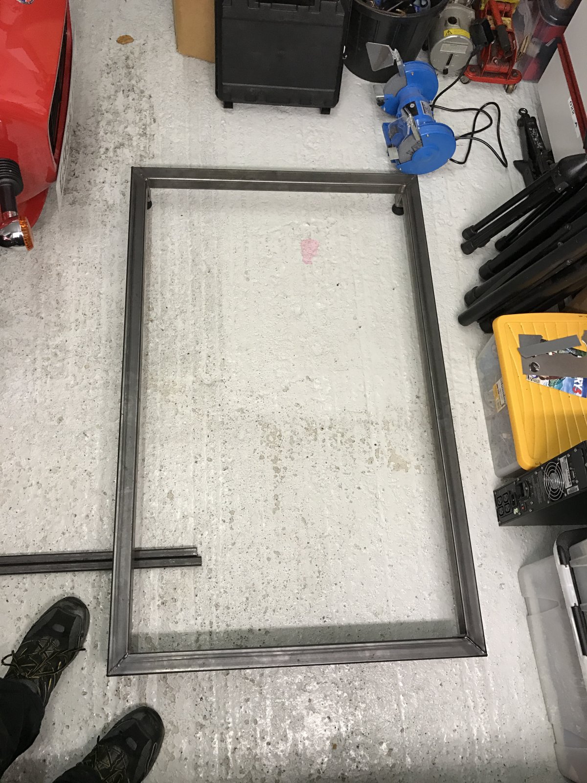

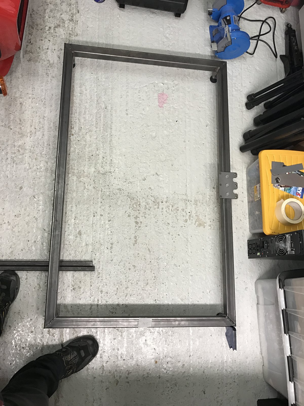

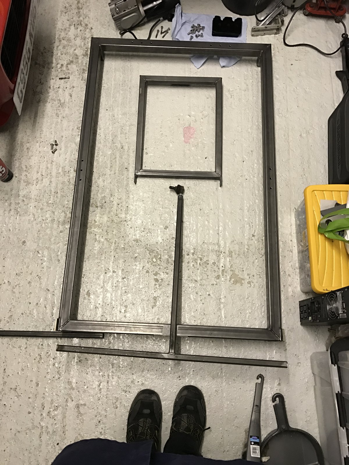

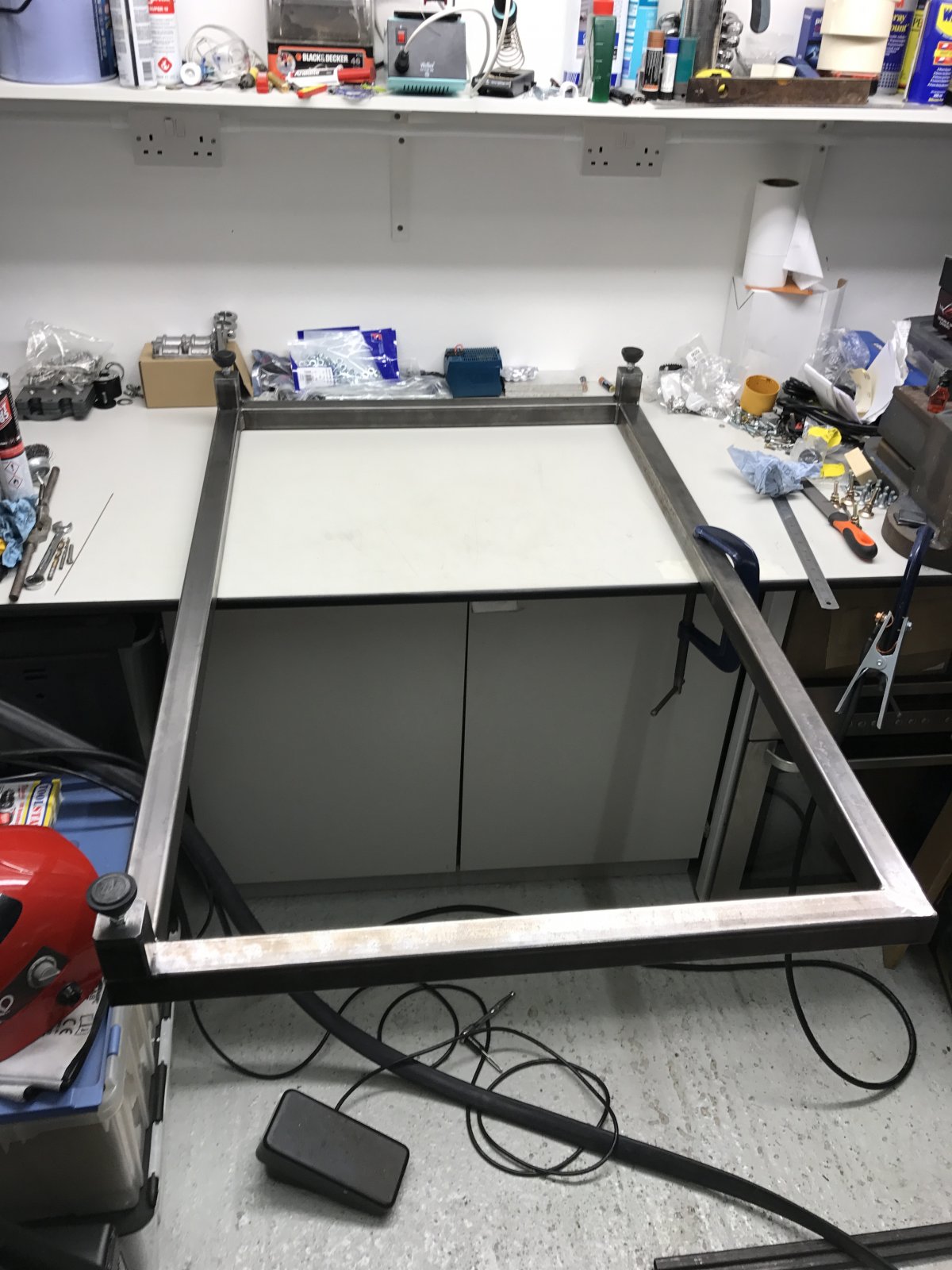

    Started fabricating the frame
    This was the adjustable feet I decided to use.

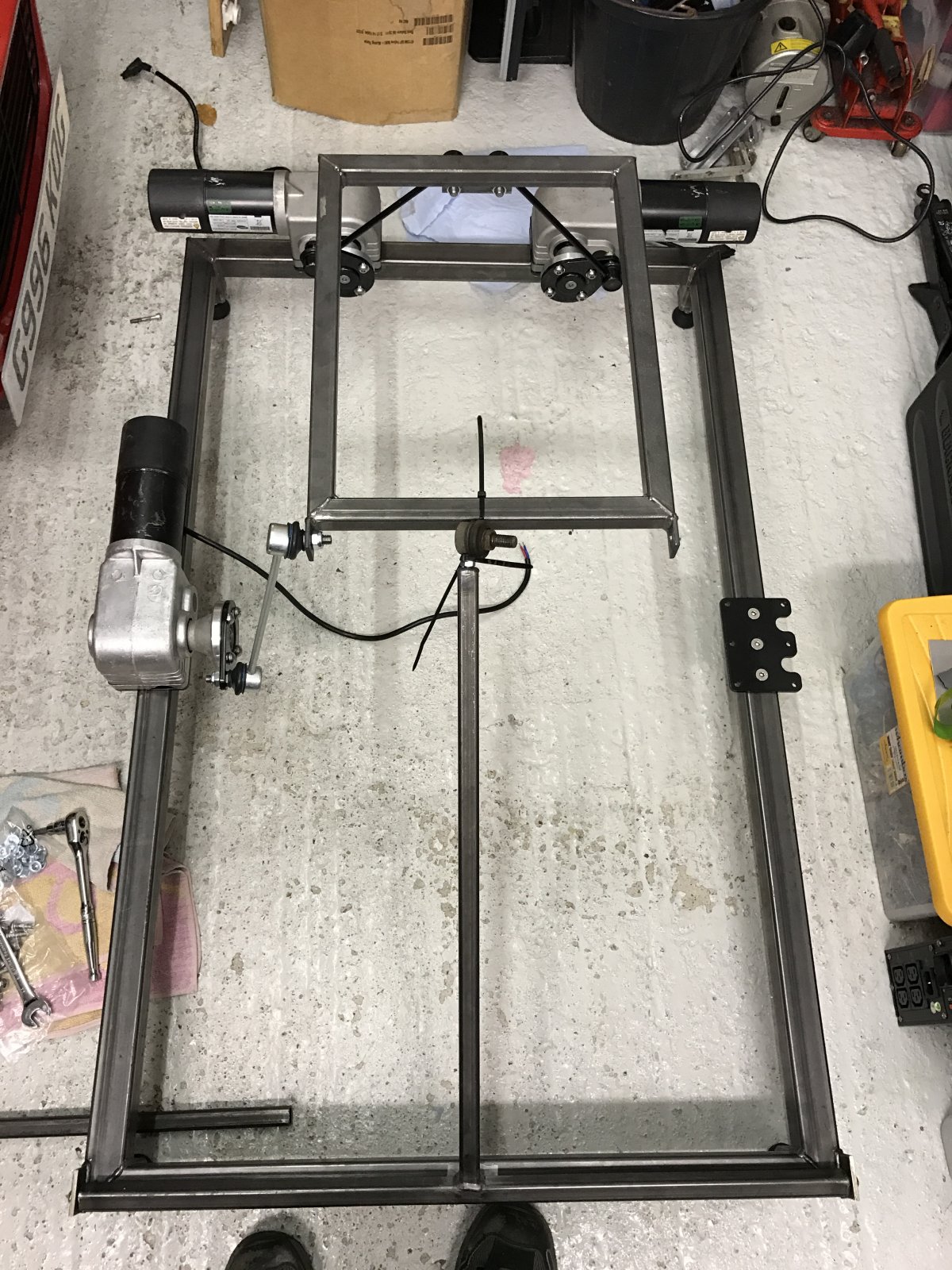

    2DOF, DC motor, Arduino, Motion platform, 4DOF, 6DOF

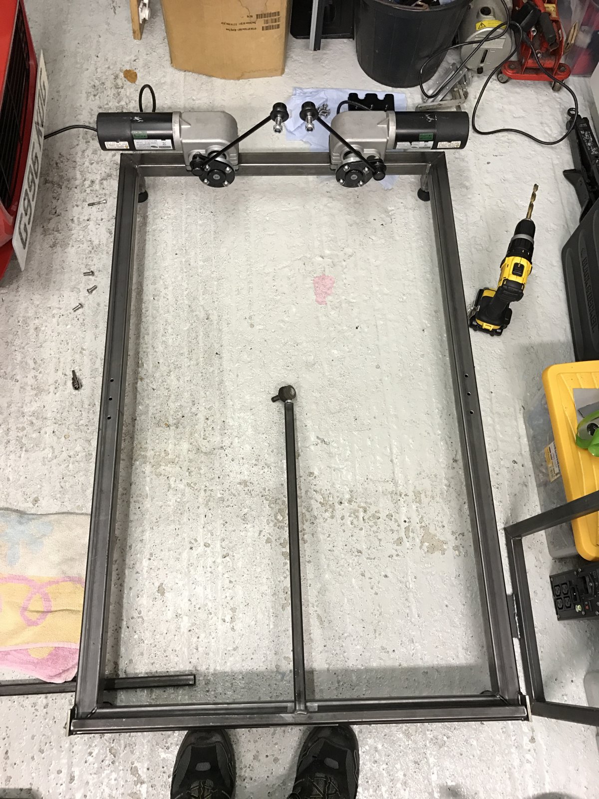

    More frame building
    Then I fitted the motor brackets

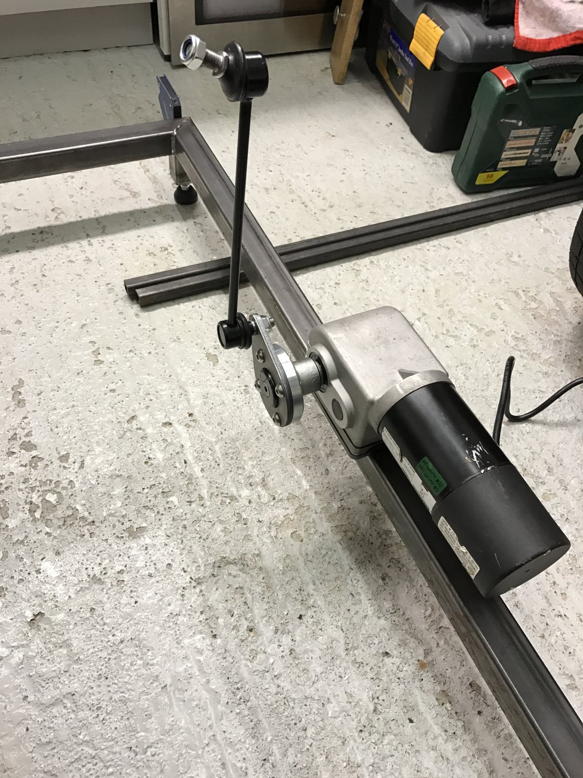

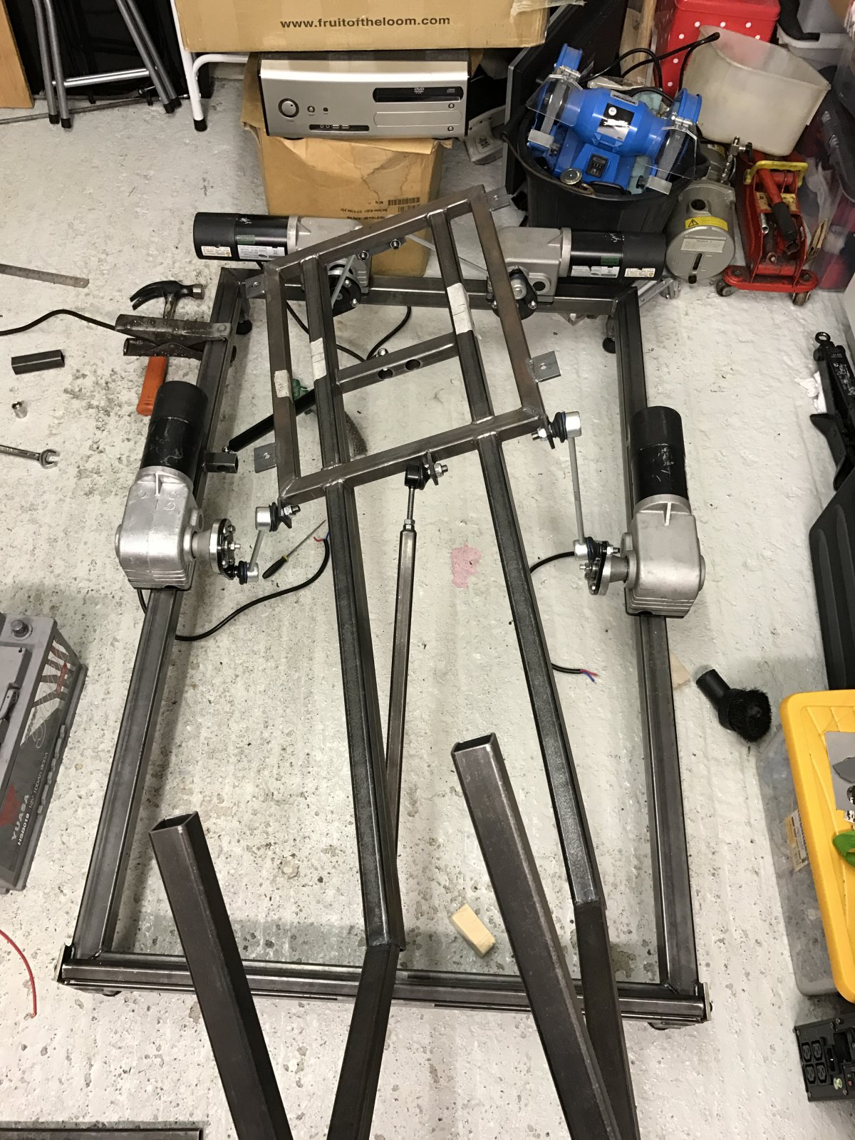

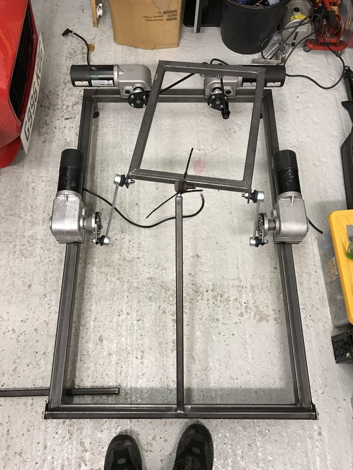

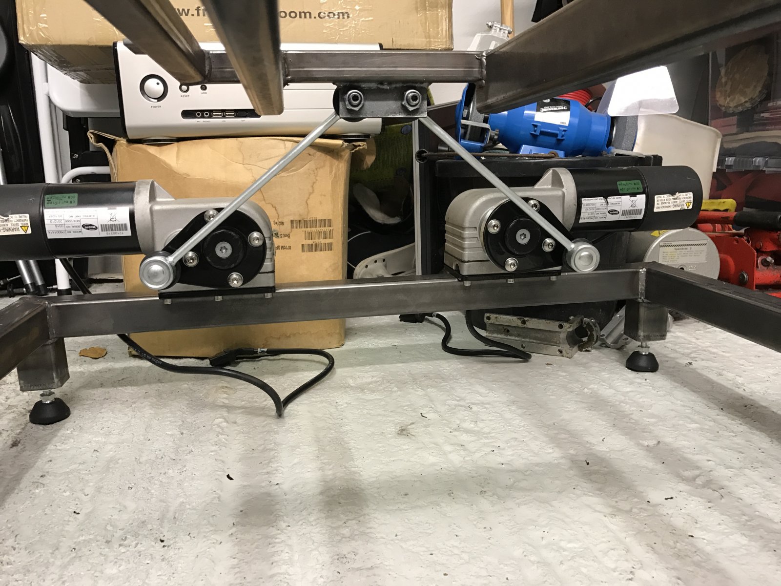

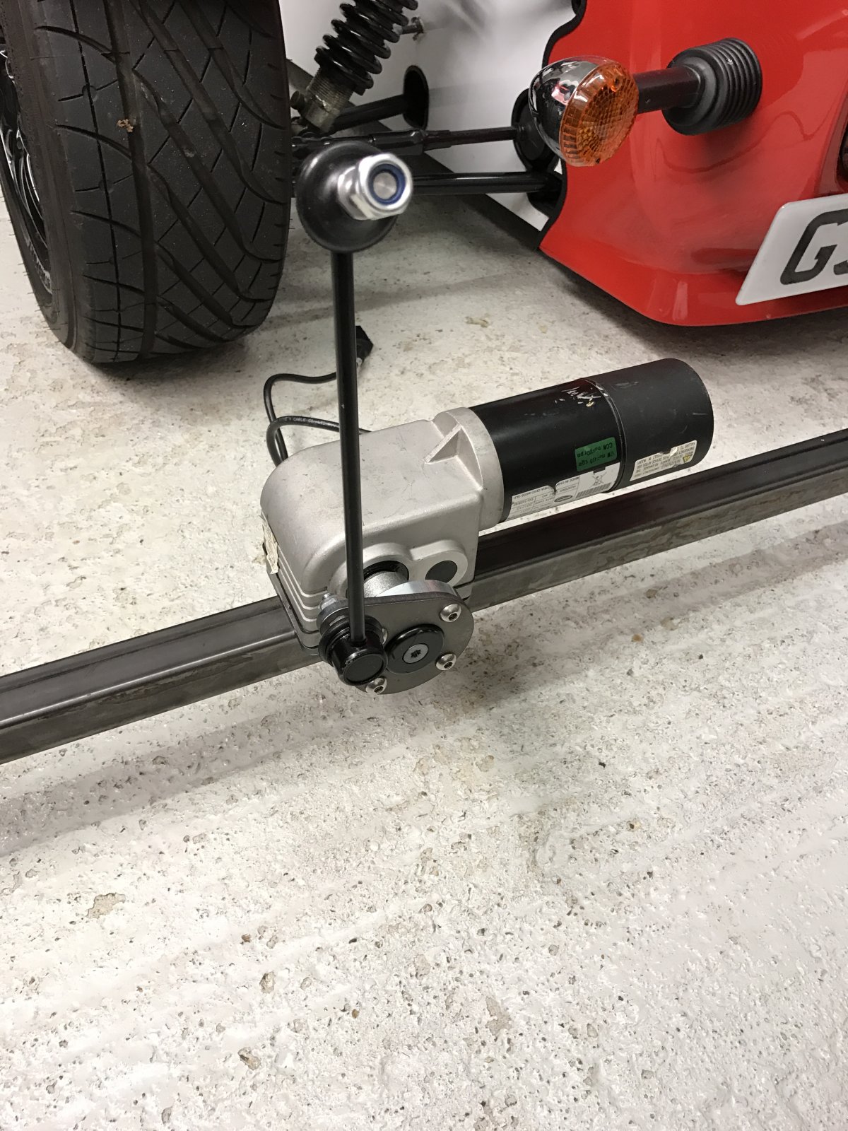

    Fitting the motors to the base frame

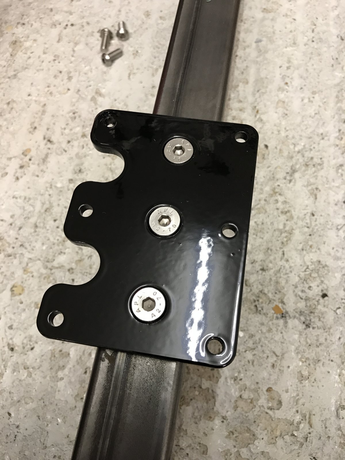

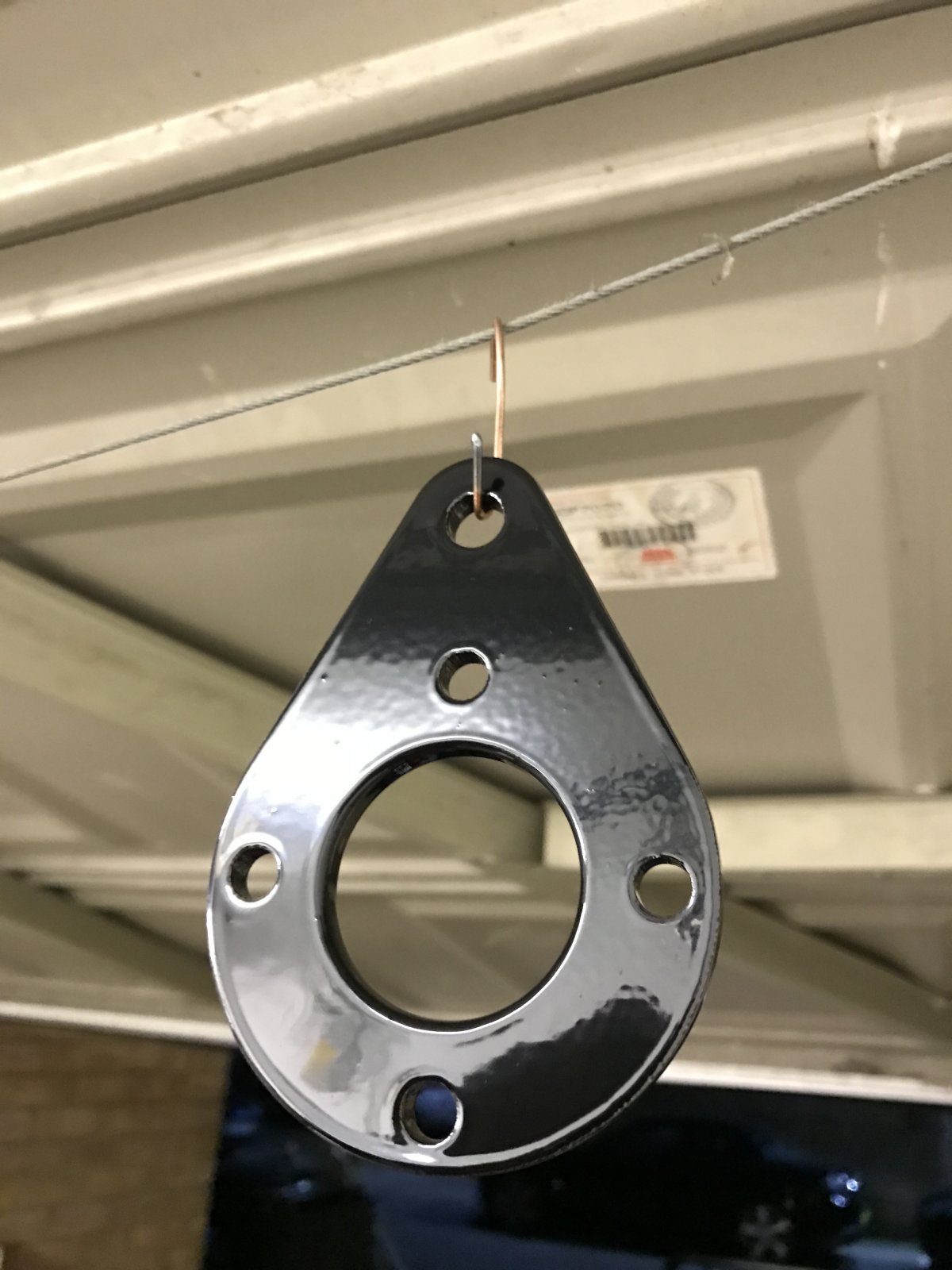

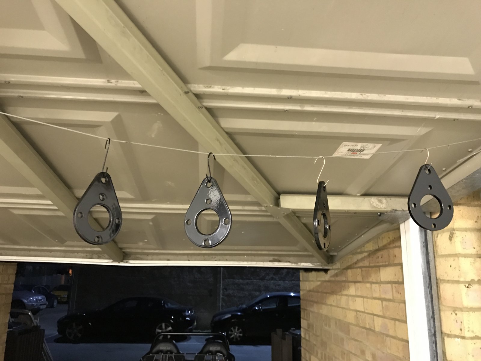

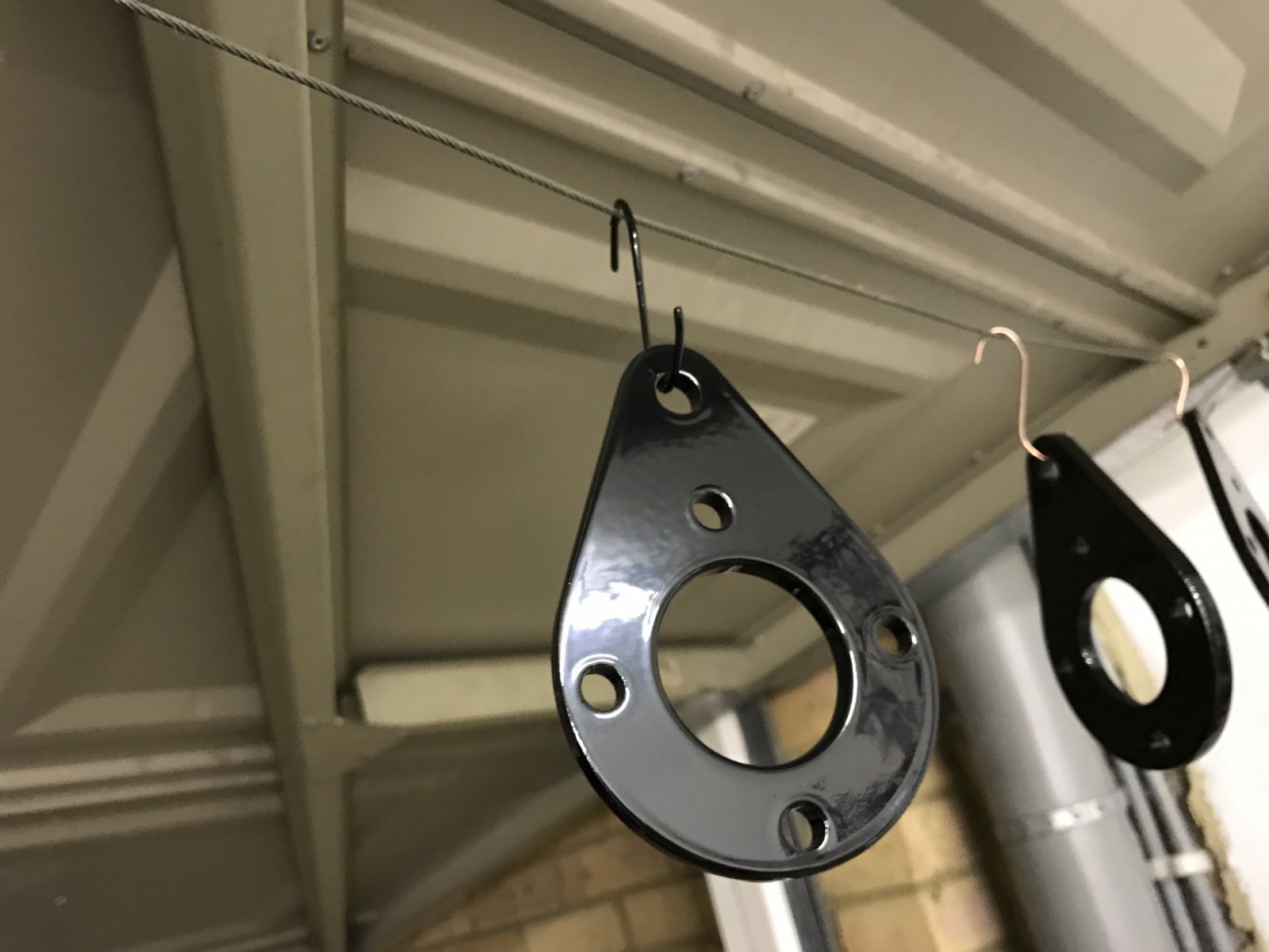

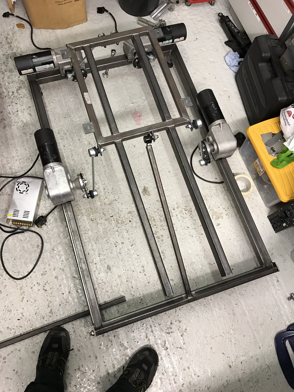

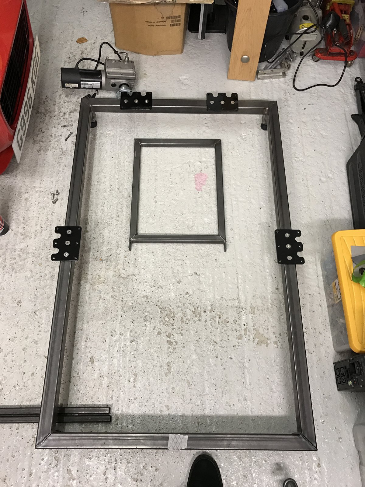

    May have been getting ahead of myself but decided to power coat my brackets.
  7. MWB
    MWB Drive it like you stole it!!
    Jan 2, 2016
    131
    Commissioning Engineer
    U.K.
    424Coins
    +148 / 0 / -0

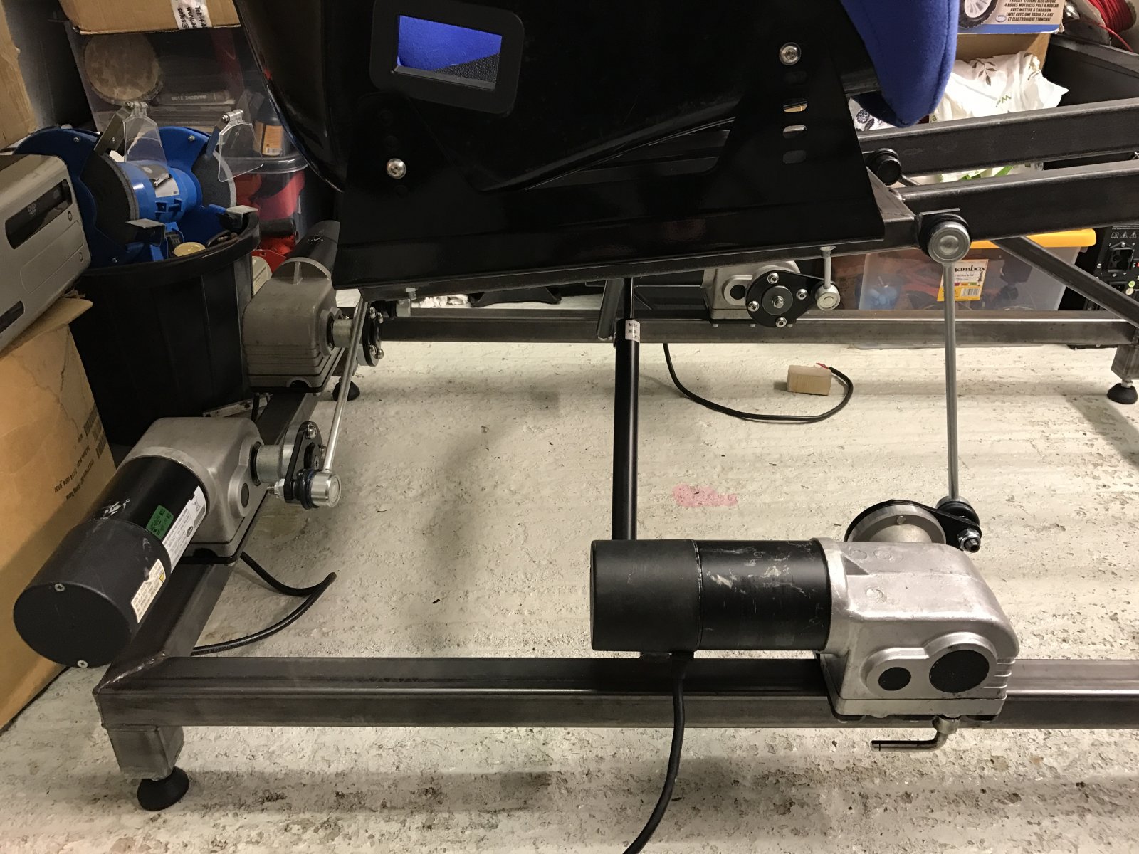

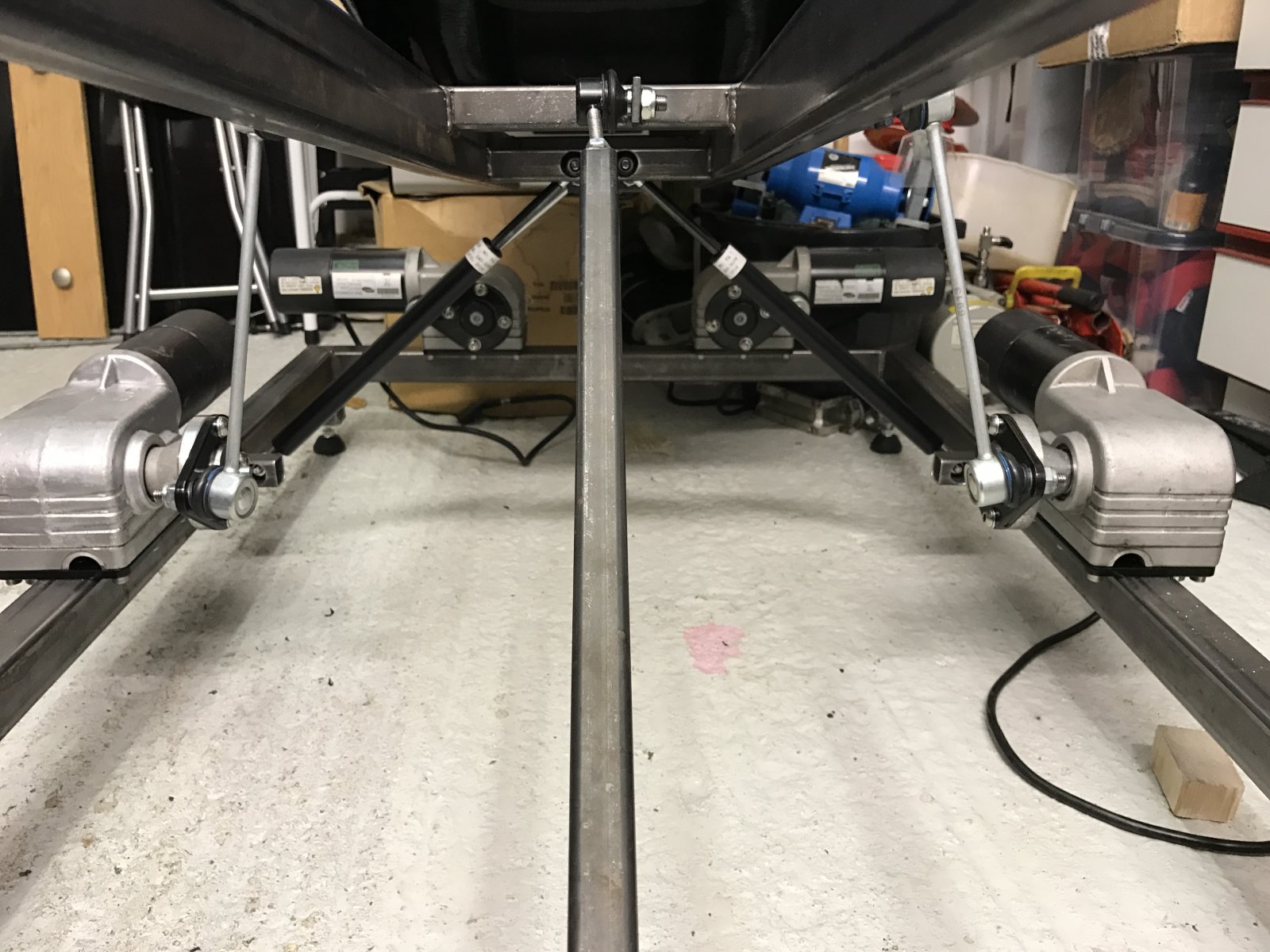

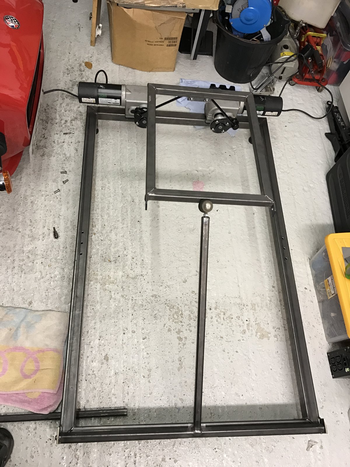

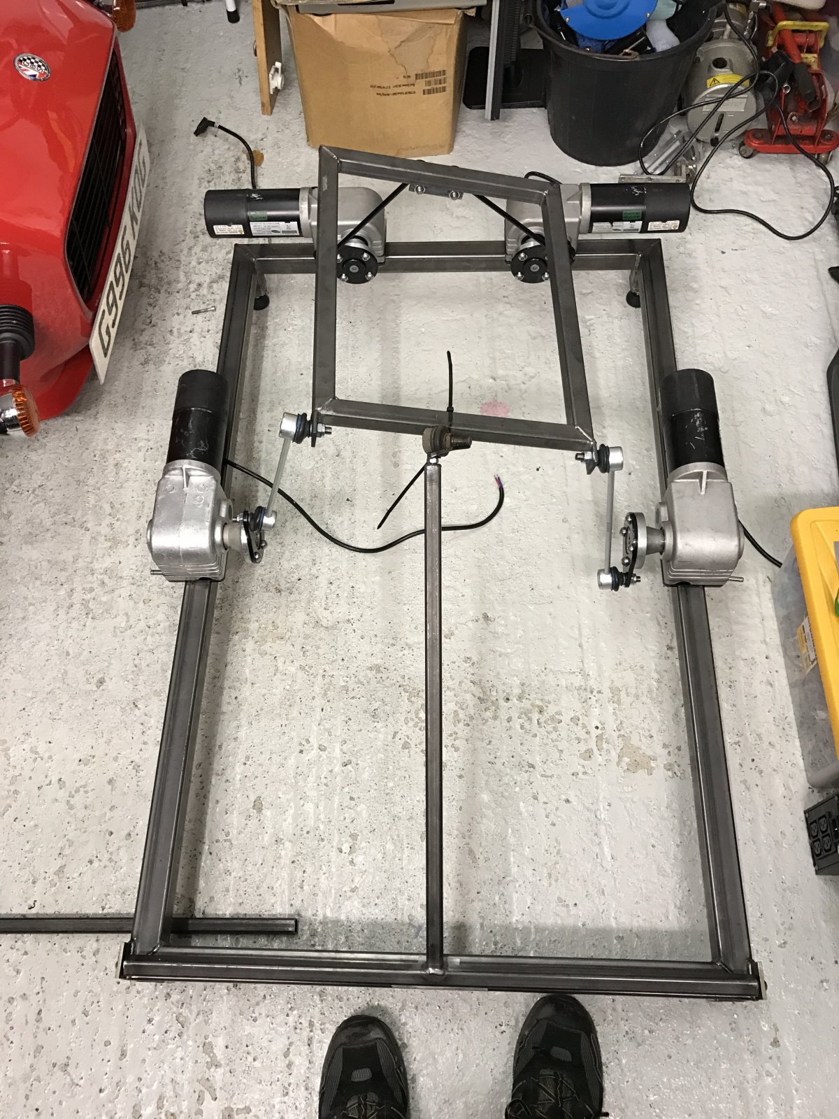

    Assembly of the motors and inner frame
    Quick test, still need to weld the front lug on to the inner frame, it's only cable tied hence why it's a bit clunky!

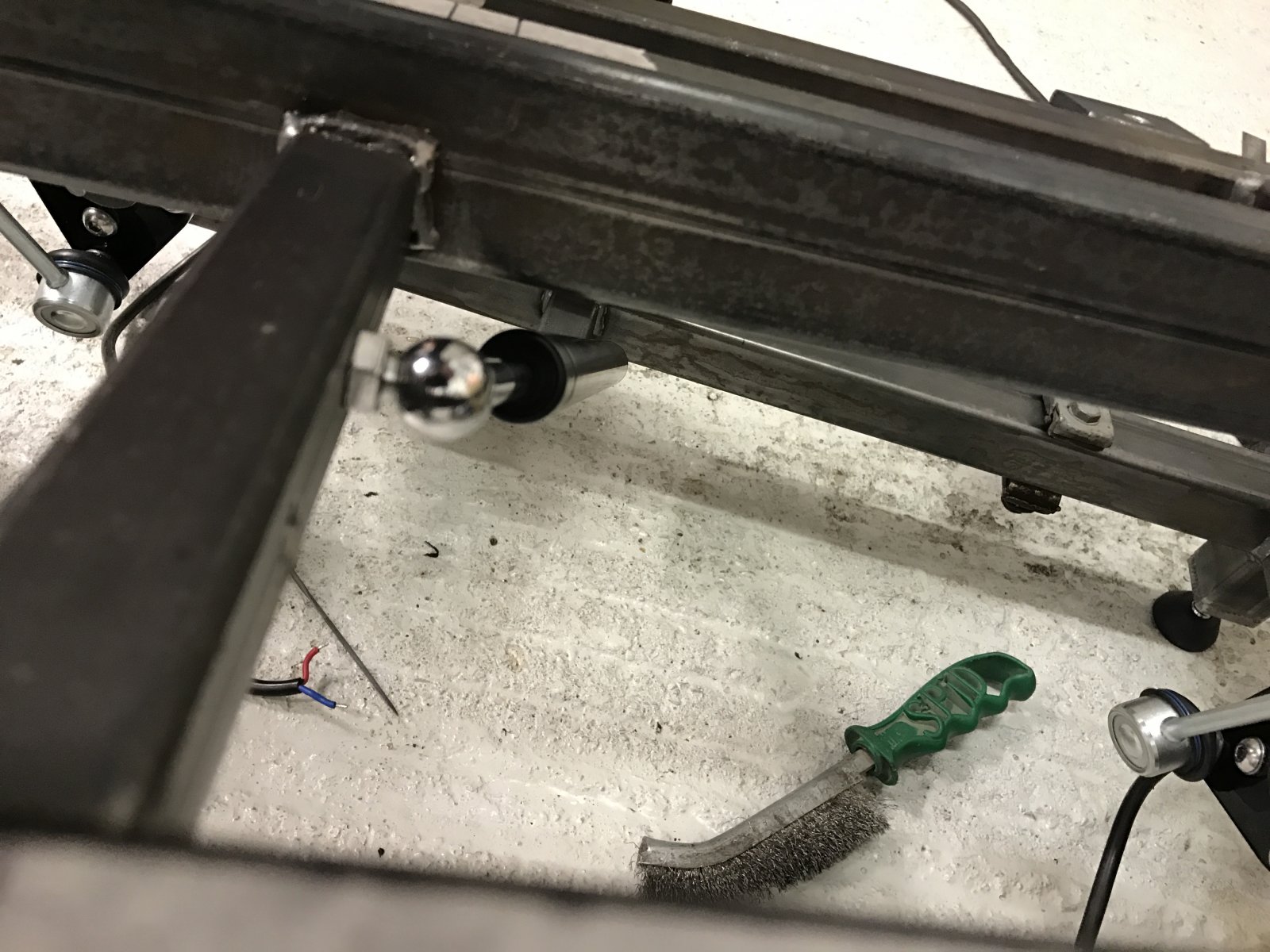

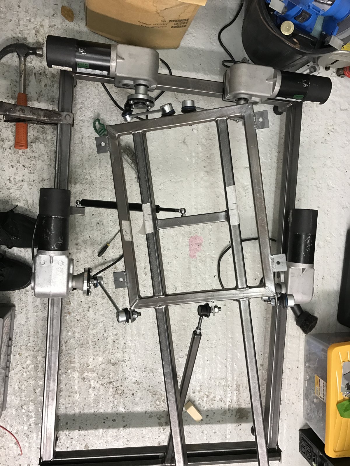

    More progress on the frame, in particular the feet platform, @Pit ;)
    Also added a couple of gas struts. :grin
    Spot the wonky bit!! :rolleyes: I'm hopping I haven't gone overboard with the gas struts! 2x 300Nm (30Kg each).
