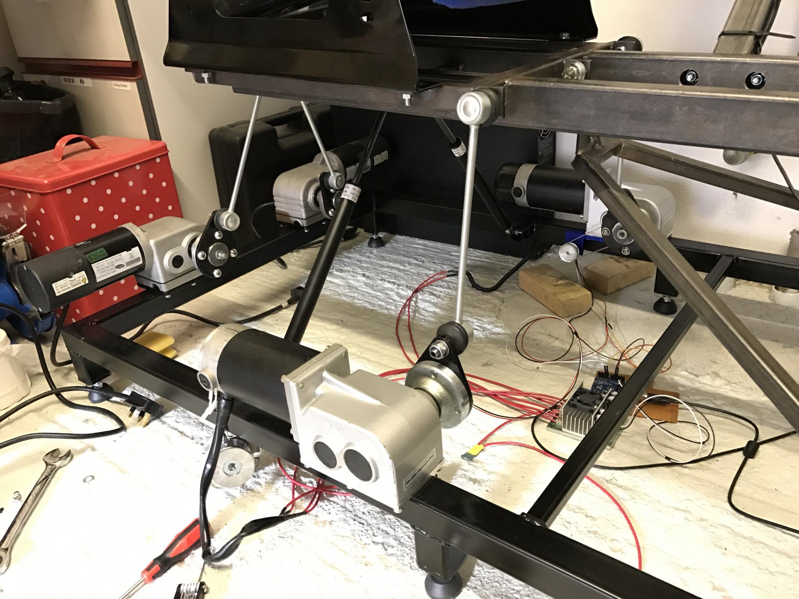

    Well its bin a little wile since my last update, Works been getting in the way, but I'm happy to say that I've managed to find some time to work on my rig!:thumbs
    So the main upgrades are two new front motors that are 200 watt and I've got the rear motors now working.

    So I'm very happy with my progress, the traction loss is incredable!!! :grin

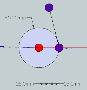

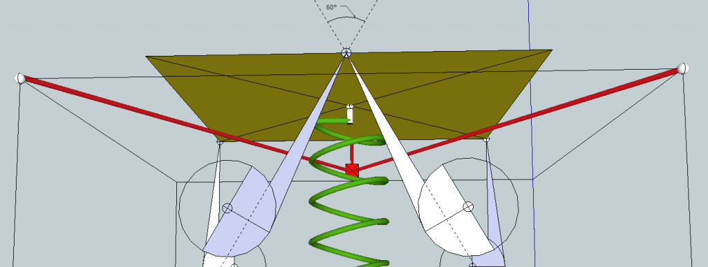

    But I have a question about Simtools @yobuddy, because my motion is coming from a cam, the motion is not linear.
    The mid range of motion is faster than the top or bottom, is there a way of tuning this out in Simtools? :cheers
  8. Tim McGuire
    Jul 26, 2015
    261
    Canada
    2,229Coins
    +317 / 2 / -0
    3DOF, DC motor
    I'm not Yobuddy but from what I know there's not a way to tune it out. Instead we generally limit the rotation of our motors to around +/-45 degrees or so, so that it's "approximately linear", at least enough such that we don't notice.

  10. momoclic
    momoclic Active Member
    Sep 23, 2014
    217
    Retraité
    Nantes - France
    2,773Coins
    +117 / 1 / -0
    DC motor, Arduino
    La solution pour assurer une symétrie de mouvement est ce type de montage quand la manivelle est à la position moyenne :
    The solution to ensure a symmetry of movement is this type of assembly when the crank is in the average position:
    De plus on à tout intérêt à n'utiliser que 120° de rotation pour la manivelle, on gane 1/3 de réactivité en ne perdant que 14% de la course totale.
    Moreover, it is of interest to use only 120 ° of rotation for the crank, one gan 1/3 of reactivity while losing only 14% of the total stroke.
    Voici l'image d'un montage optimal pour un 4DOF de ce type, bielle à l'intérieur et montage assurant la symétrie de monuvement :
    Here is the image of an optimal mounting for a 4DOF of this type, Connecting rod inside and mounting ensuring the symmetry of movement:
    Notez le triangle rouge orienté vers l'arrière qui rend le simulateur plus compact.
    Note the red triangle oriented rearwardly making it more compact simulator.

    Thanks @momoclic,
    I've got some tweaking to do!!! :thumbs

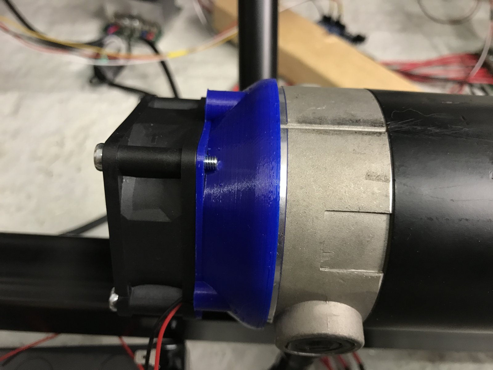

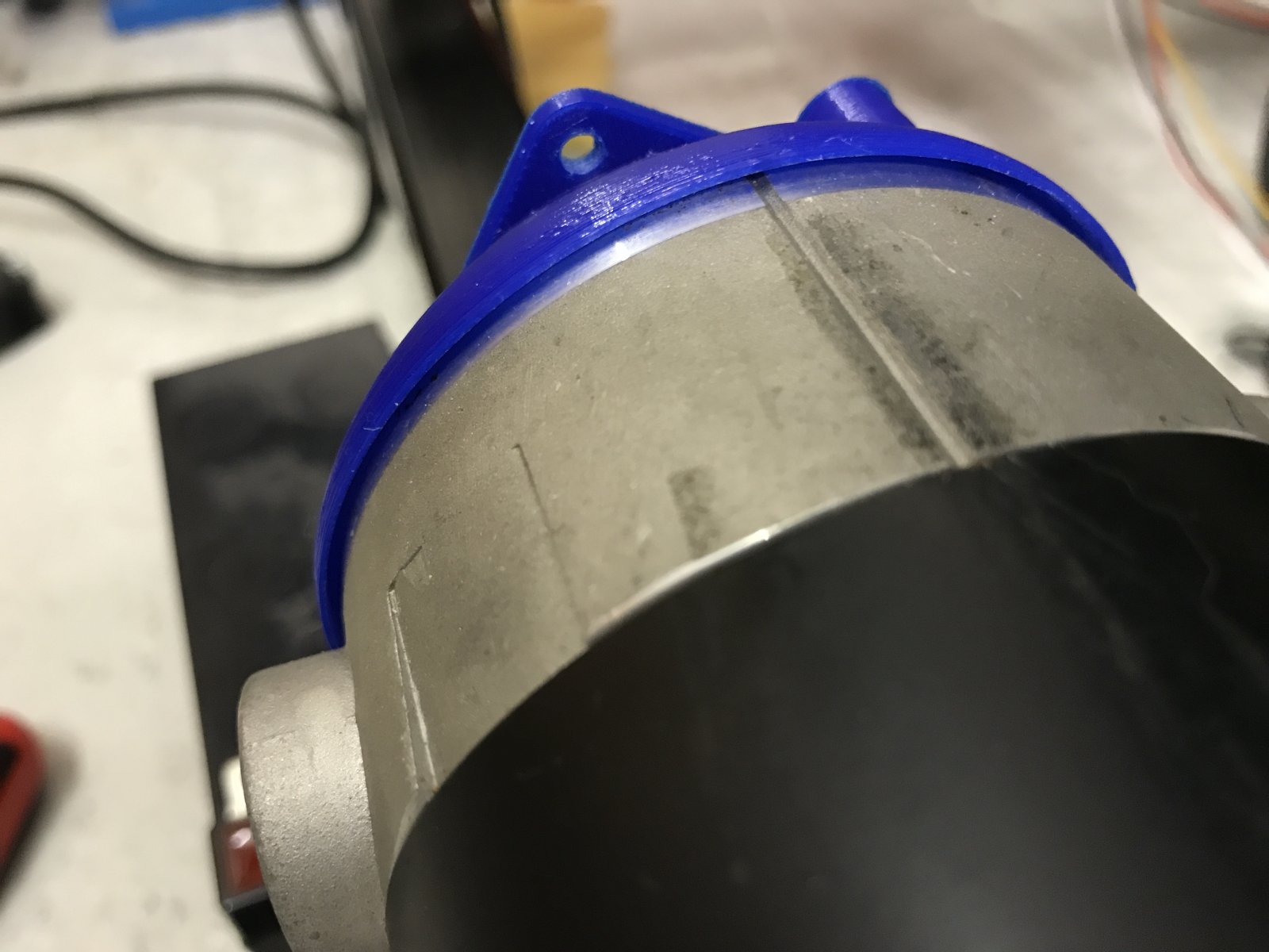

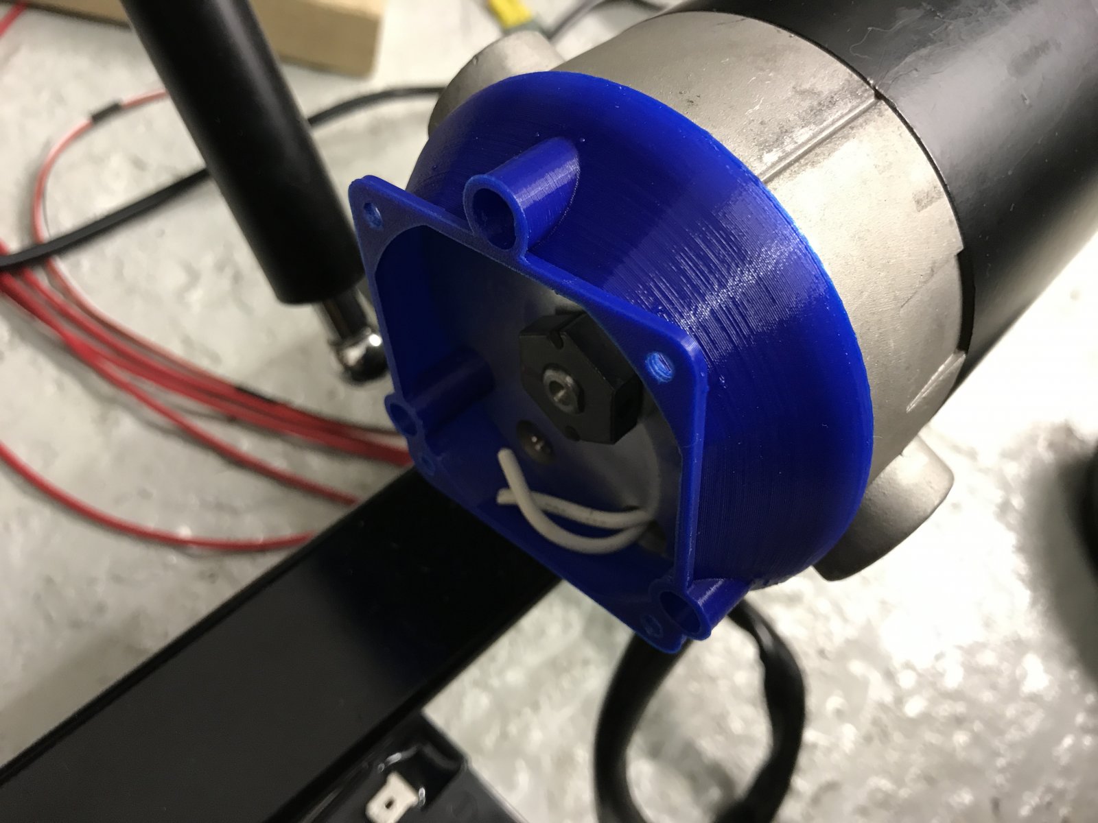

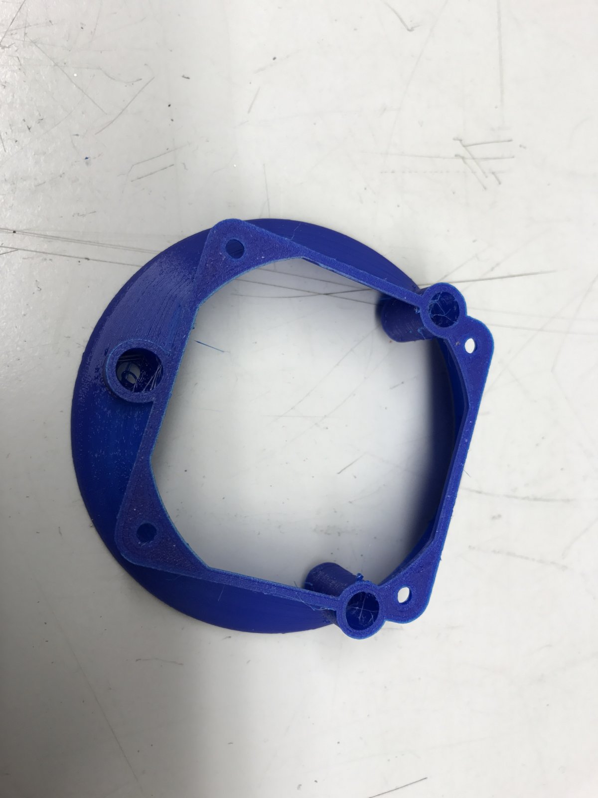

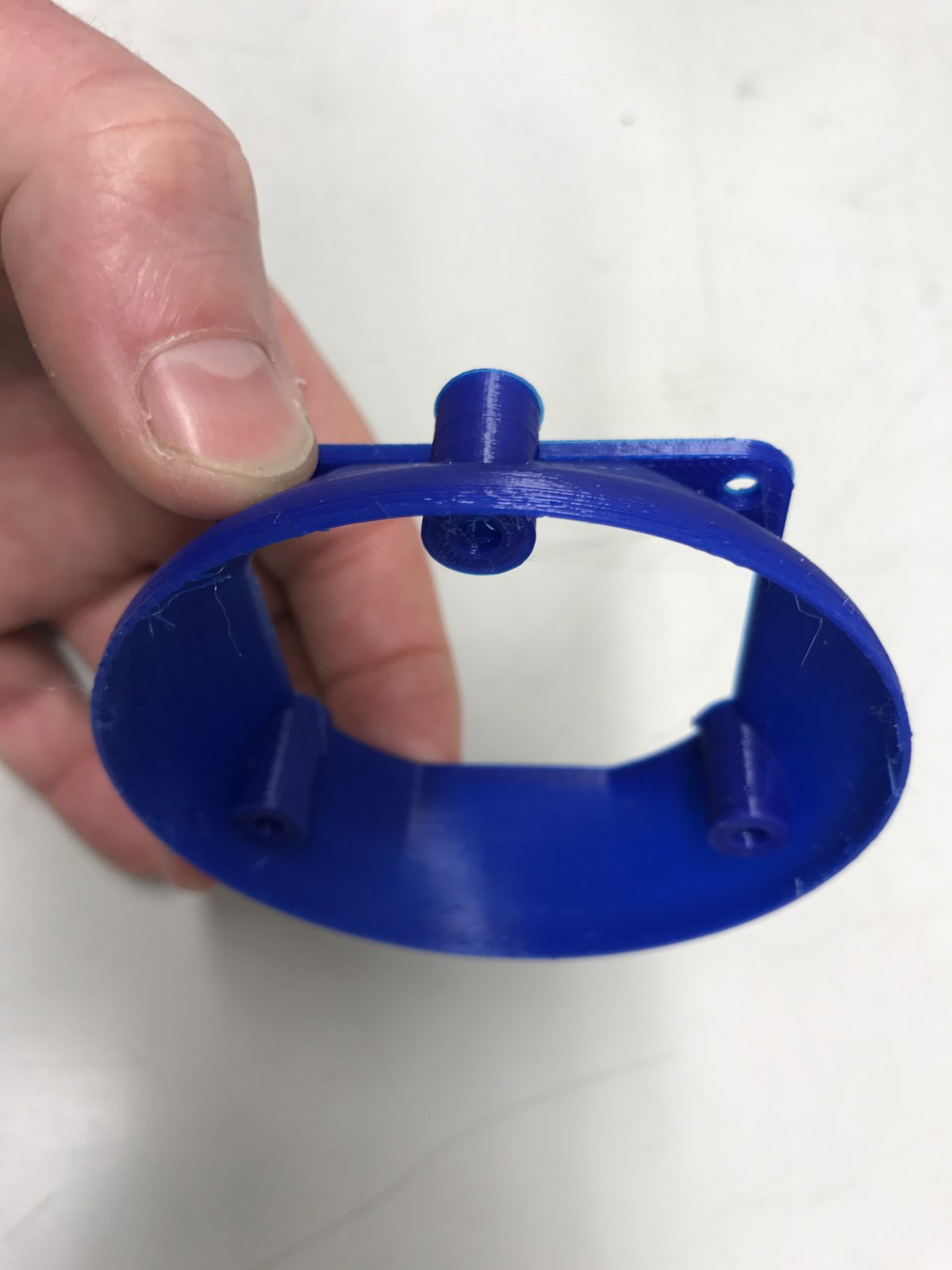

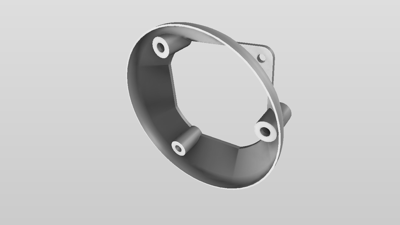

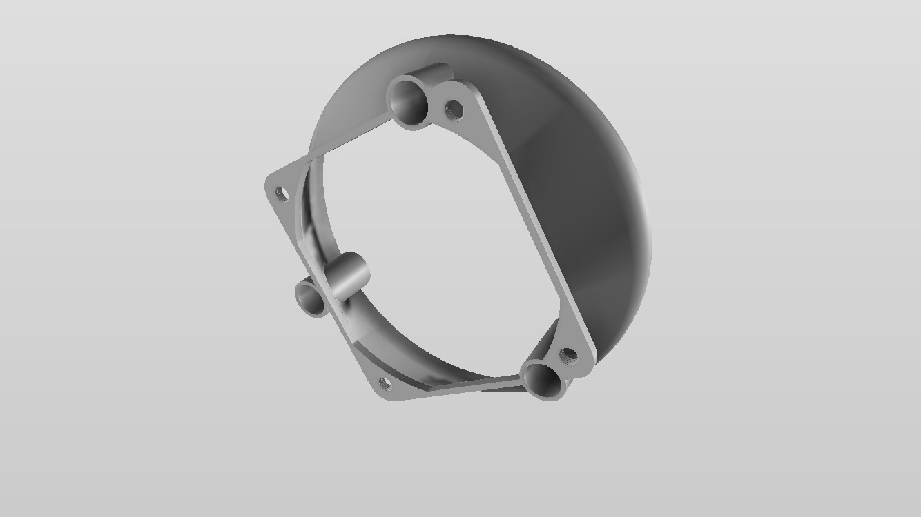

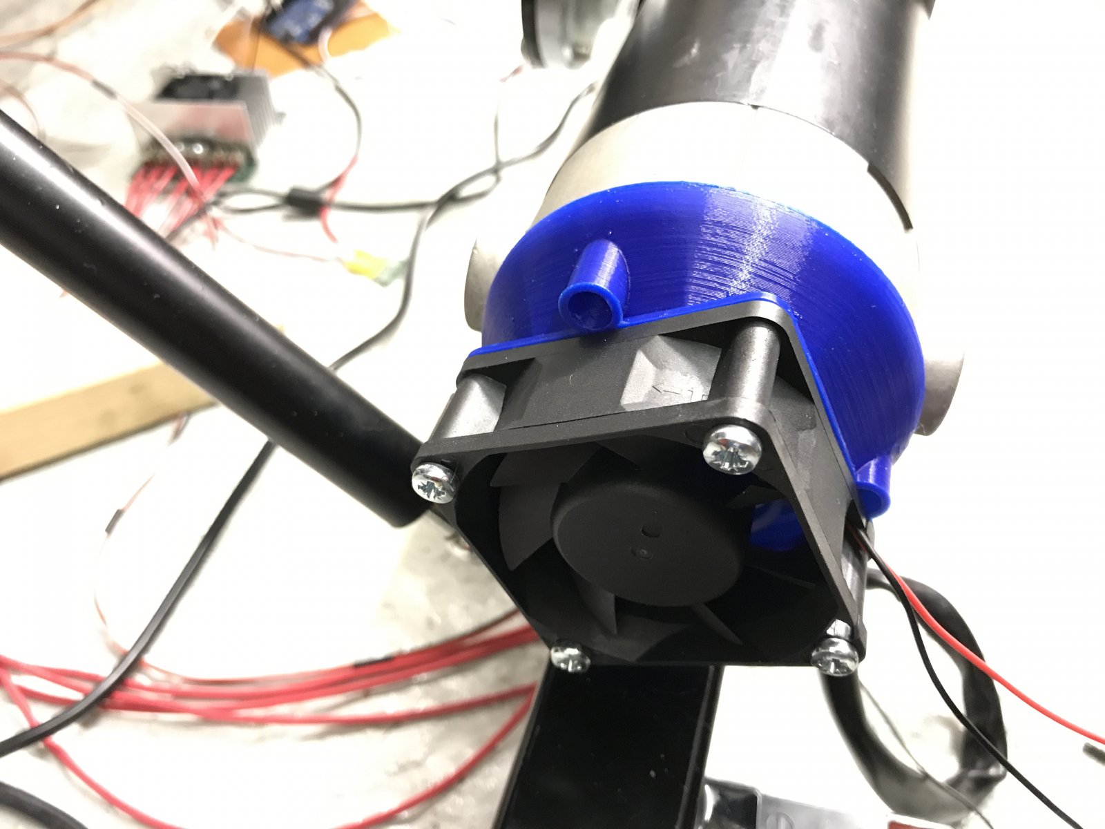

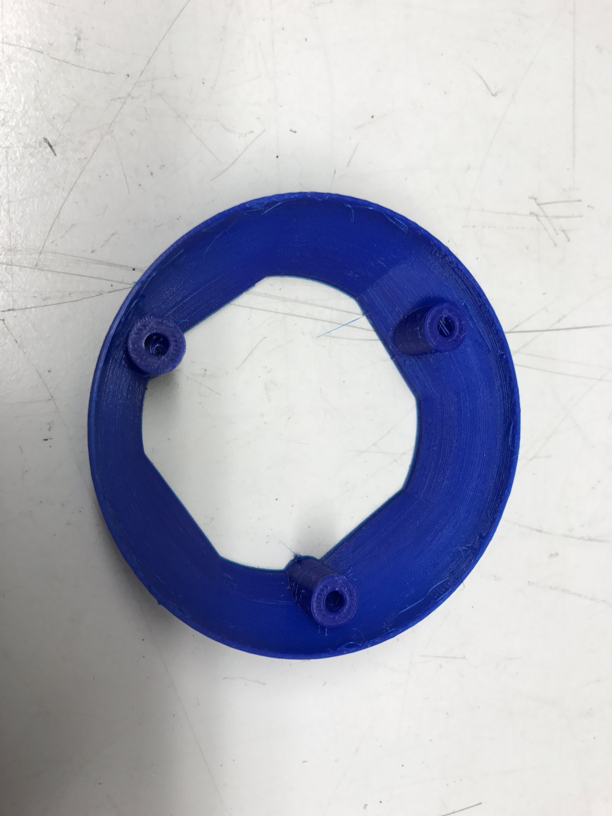

    So even though I've uprated my front motors, there still getting a little hot, and in an effort to try not over-engineer a fix, I decided to use my 3D printer to make a fan cowling that bots onto the back of the motor and produces a high speed micro blanket of air across the body of the motor, trial and error no math!!!

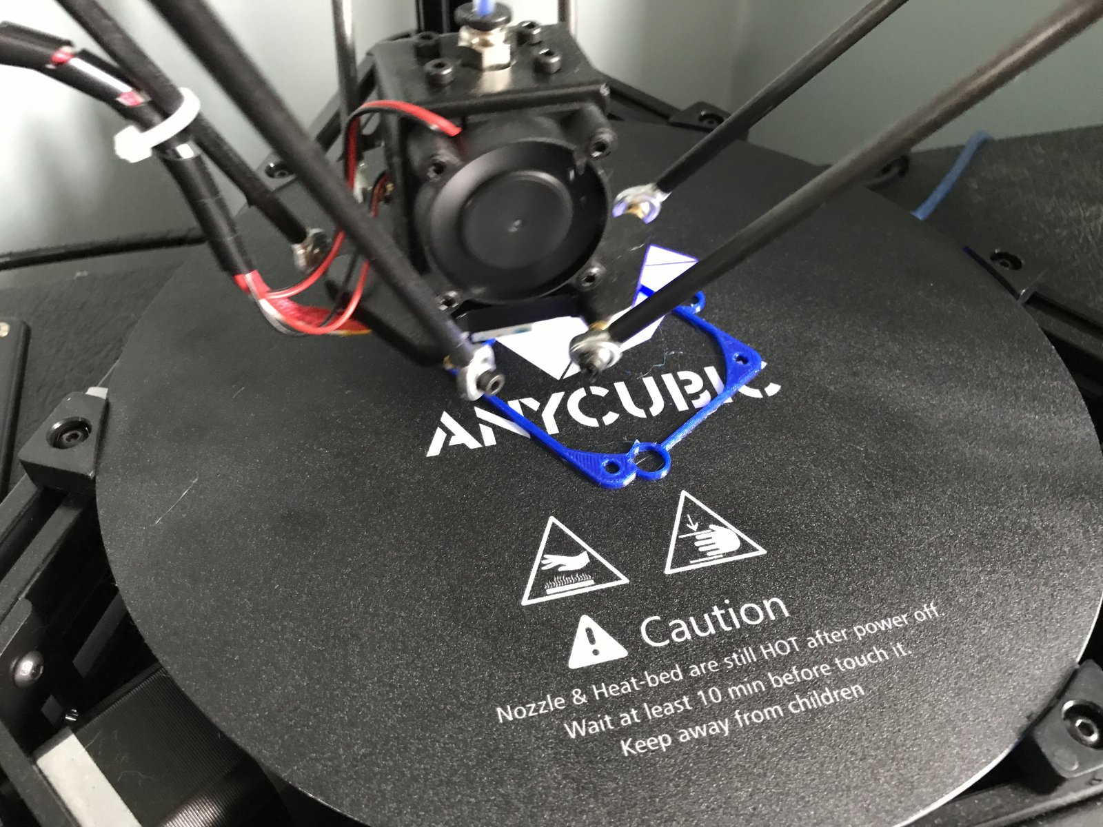

    So I put my 3D printer to work.
  19. MWB
    MWB Drive it like you stole it!!
    Jan 2, 2016
    131
    Commissioning Engineer
    U.K.
    424Coins
    +148 / 0 / -0
    2DOF, DC motor, Arduino, Motion platform, 4DOF, 6DOF
    I ended up increasing the outer diameter by 2mm to increase the flow across the motor body, but all in all I'm very happy with the results, the front motor that is seeing a little bit more weight than the other was getting very hot, but now after two hours of Dirt Rally the body of the motor was only at 38C. May need to drill some holes into one end of the motor, in order to get some air to the internals because I get the impression that it's still very hot internally. IMG_4993.JPG
  20. SilentChill
    2,645
    20,604Coins
    +3,570 / 34 / -0
    As soon as you still a couple of exhaust holes in you will be amazaded how much cooler they will run.
