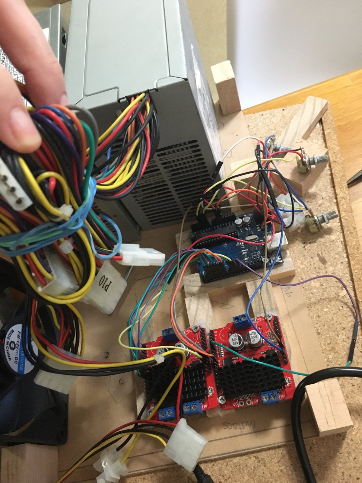

    Hey Guys @bruce stephen @insanegr @RufusDufus
    Hope you are all well :)

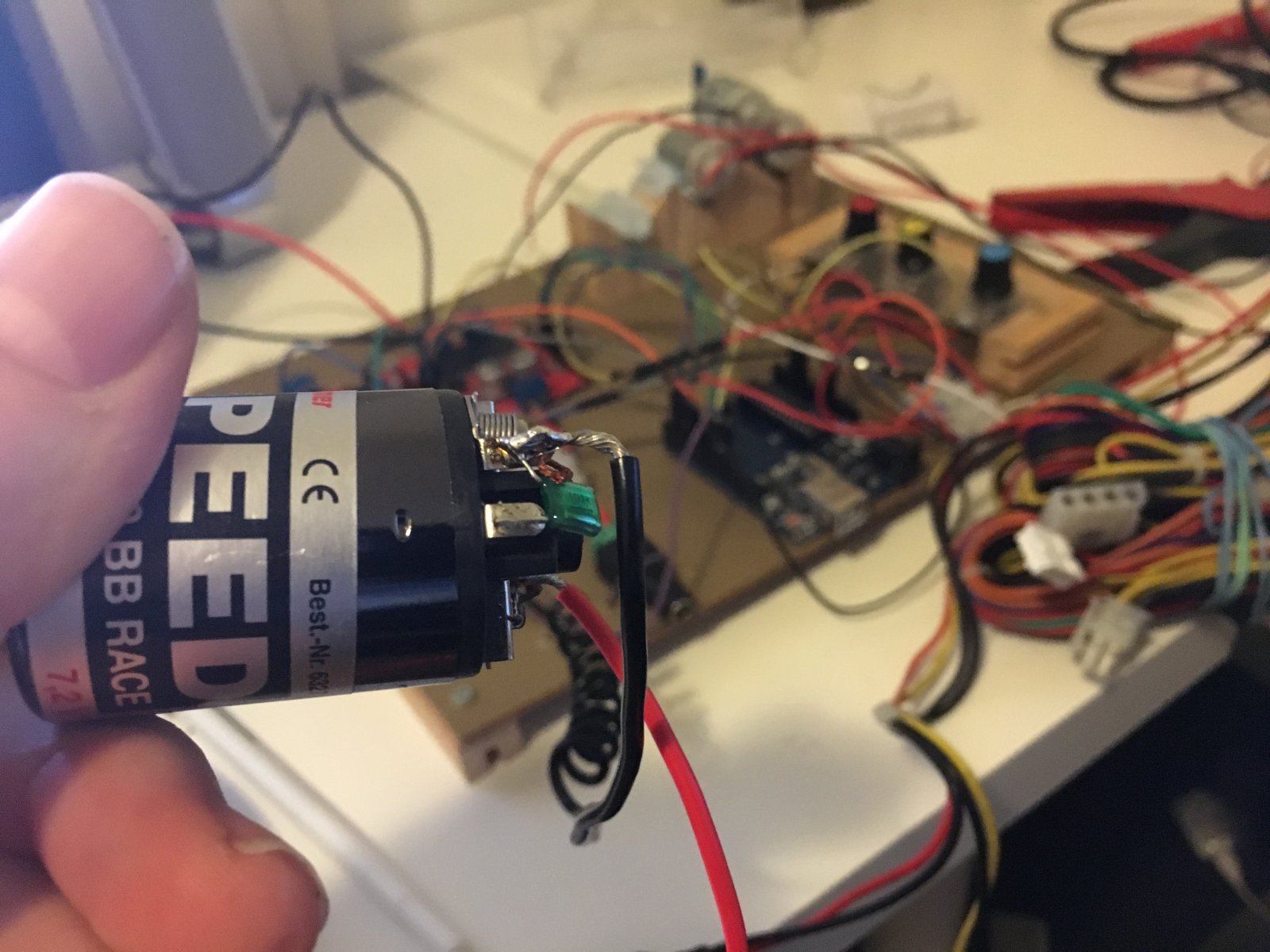

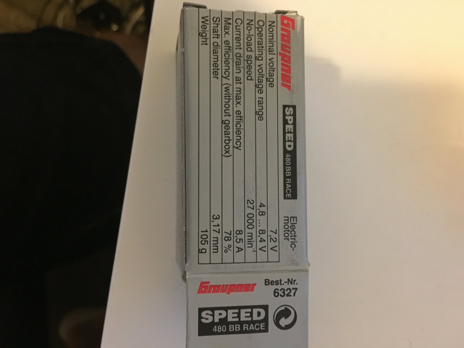

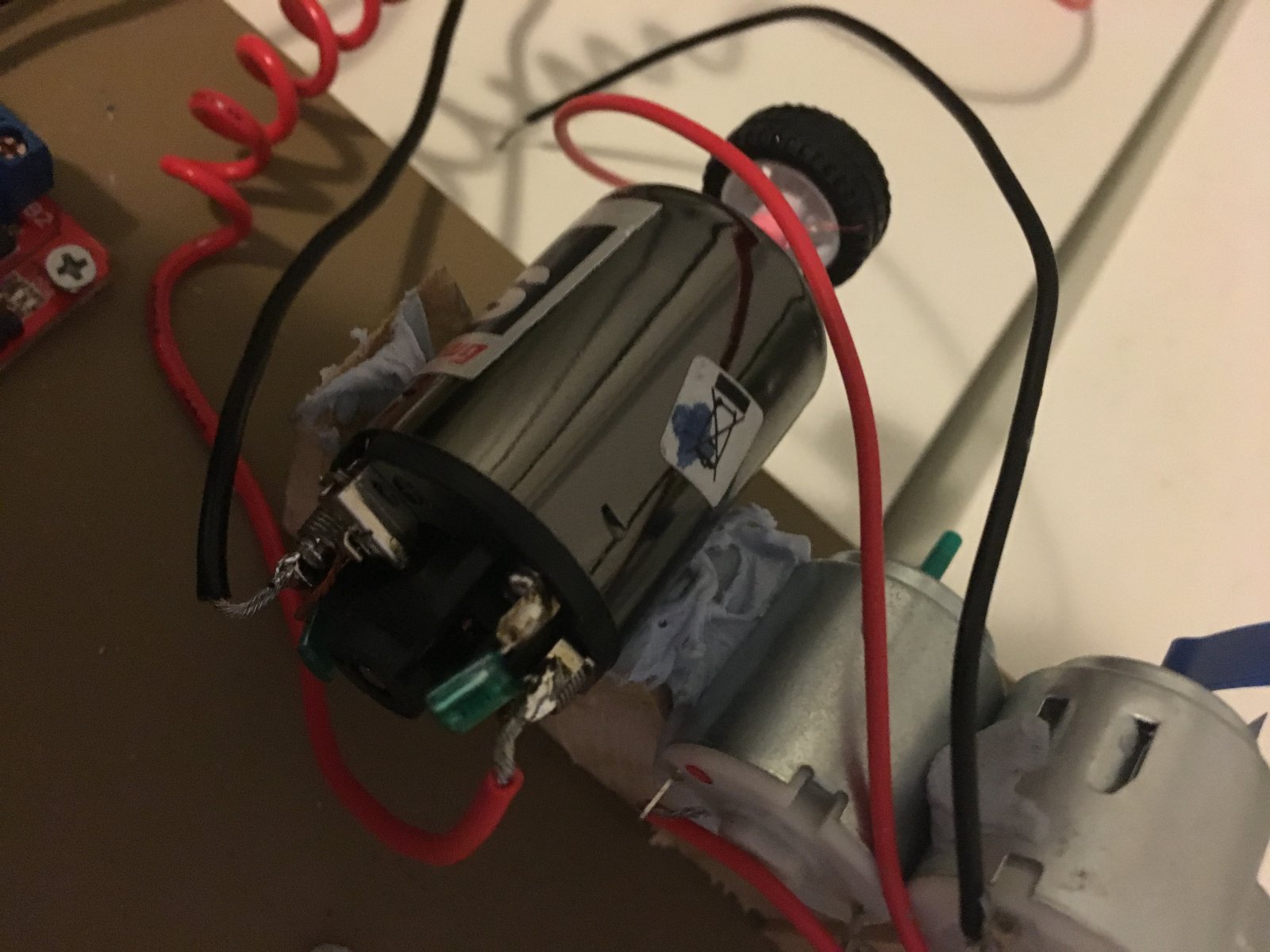

    Thanks so much for your help thus far, I have been experimenting with the next phase which is building the scale model and getting the motors or servos to move it. I decided I need to stick to the dc motor route as that would be easier for me. I looked into the code for the servo /rc model, but there doesn't seem to be a SMC utility for it, or maybe there is and I am doing something wrong... so doing adjustments in code is well beyond me. I brought a DC motor the Graupner 480 BB race hobby motor for more torque and RPM (27,000 to be exact) i know thats way to much but I am going to try and adjust it using the SMC Utility and if that fails ill get a gearbox for it.. its got plenty of torque thou.
    Now the power requirements of this motor is quite a bit more than the little hobby motors I was testing with (see pic below) it is 4.8 to 8.4V at 8,5 A. So the little 9 volt power supply I got isn't going to cut it.

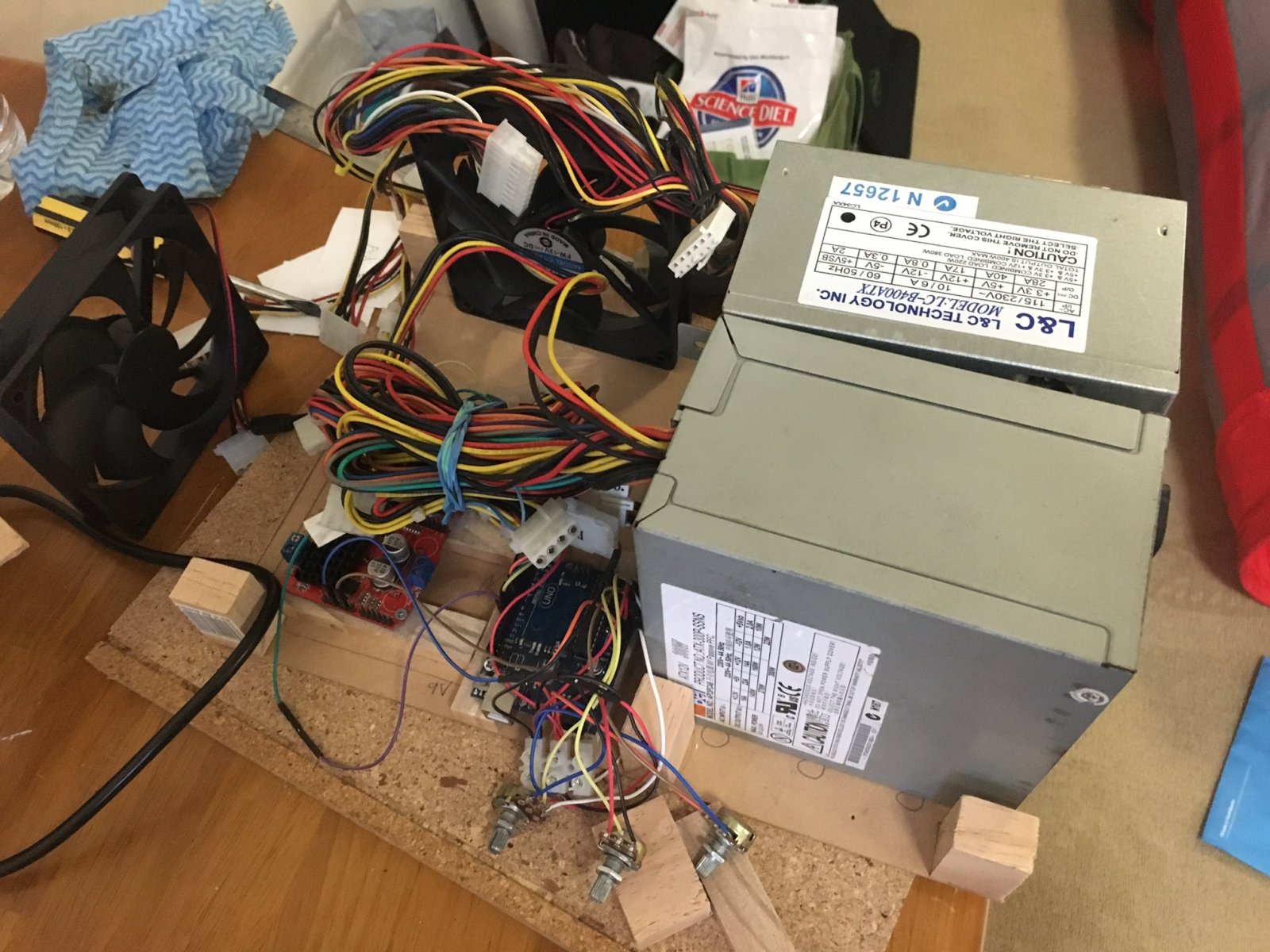

    I then went online and found this awesome link
    http://www.instructables.com/id/Power-Supply-For-Arduino-power-and-breadboard/
    and brought a second hand computer power supply for $10 and proceeded to mod that. it has at 5v 22A which should be plenty to run the motor (see pics)
    So I tested the whole setup as before with all 3 hobby motors working with the 9v 500ma power supply etc with no problems.

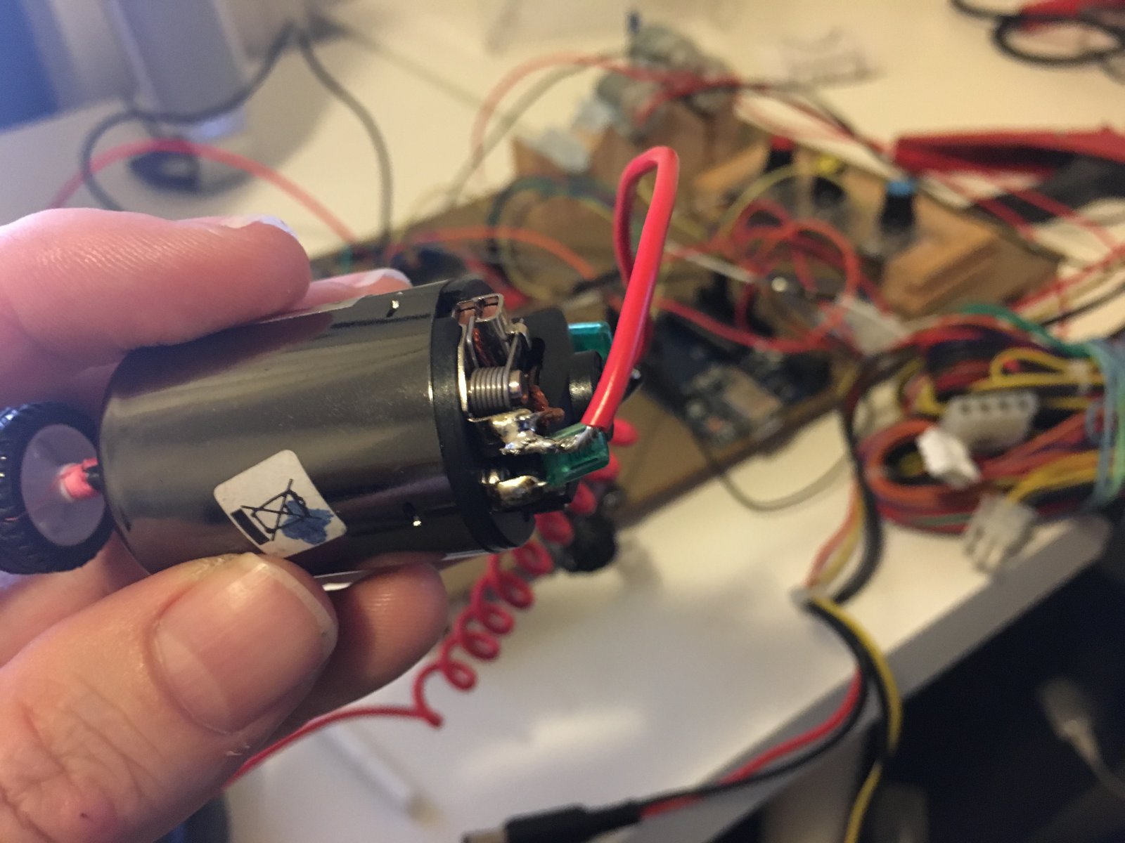

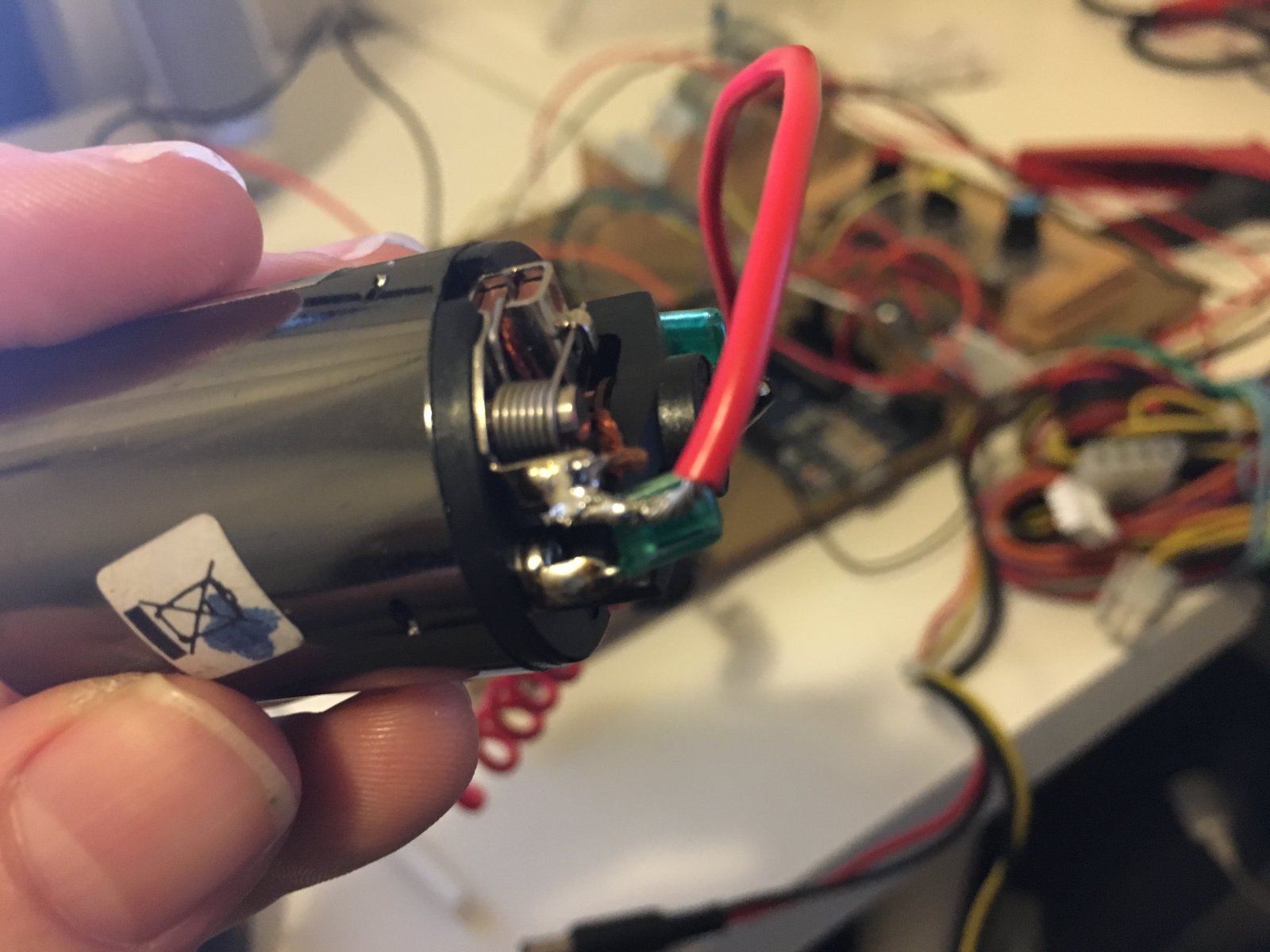

    All I did from there was wire up the motor (hope i did that right) followed the instructions from the hobby shop guy on where to solder the wires (see pics) and attach it to the motor 1 output on moto shield 1.
    tested the computer power supply with the super expensive multimeter, it gave me a steady reading of 5 v and a lot of Amps. plugged in the power supply and the mottos have power, then nothing happens.... no movement on the motor... and no switching lights going on and off.... so thats where I am...
    going well with the little hobby motors but now I have ramped the power and motor up a bit nothing is happening (see video) I have tried increasing the PWMax and everything else on the utility etc as well but no go.
    Any help would be greatly appreciated... things I could test etc.

    are you using smc3 or @eaorobbie's rc code? If you are using robbie's sketch he could probably point you in the correct direction as to which parameters to change. also the logic level side is 5v but you need a minimum 5.5v on the line in. The monster moto is rated 5.5v to 16v.
    use the 12v leg from the psu 5v is not enough power. you should find motors rated to 12v also. that one is rated to 8.4v. running 12v through it may shorten its life and or create a fire hazard.
    edit: i see its smc3 in video

    Hi Bruce,
    Thanks for your reply, I am using SMC3 so I think you have nailed it, the 5v is to little. So back to finding a new motor :) cheers mate

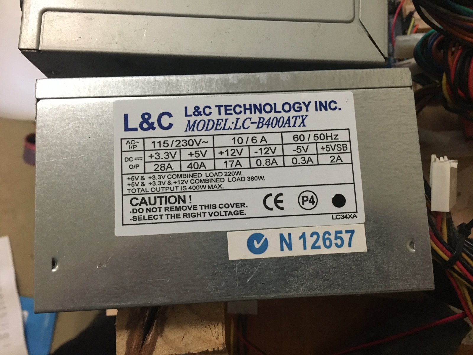

    Hey everyone,
    Looking for some power help.
    Well its been a while... busy with work etc and then got an Oculus DK2 to play around with and that took care of the rest of my time!...still moving forward on my project thou.. looking for some help on the next few steps.
    Im trying to build the power supply for my 3dof system.
    So I am going to be getting 3 of these motors
    https://www.motiondynamics.com.au/worm-drive-motor-12v-24v-200w-180-rpm-20nm-torque.html
    but I'm trying to work out how much power I will need to run these 3 motors successfully...

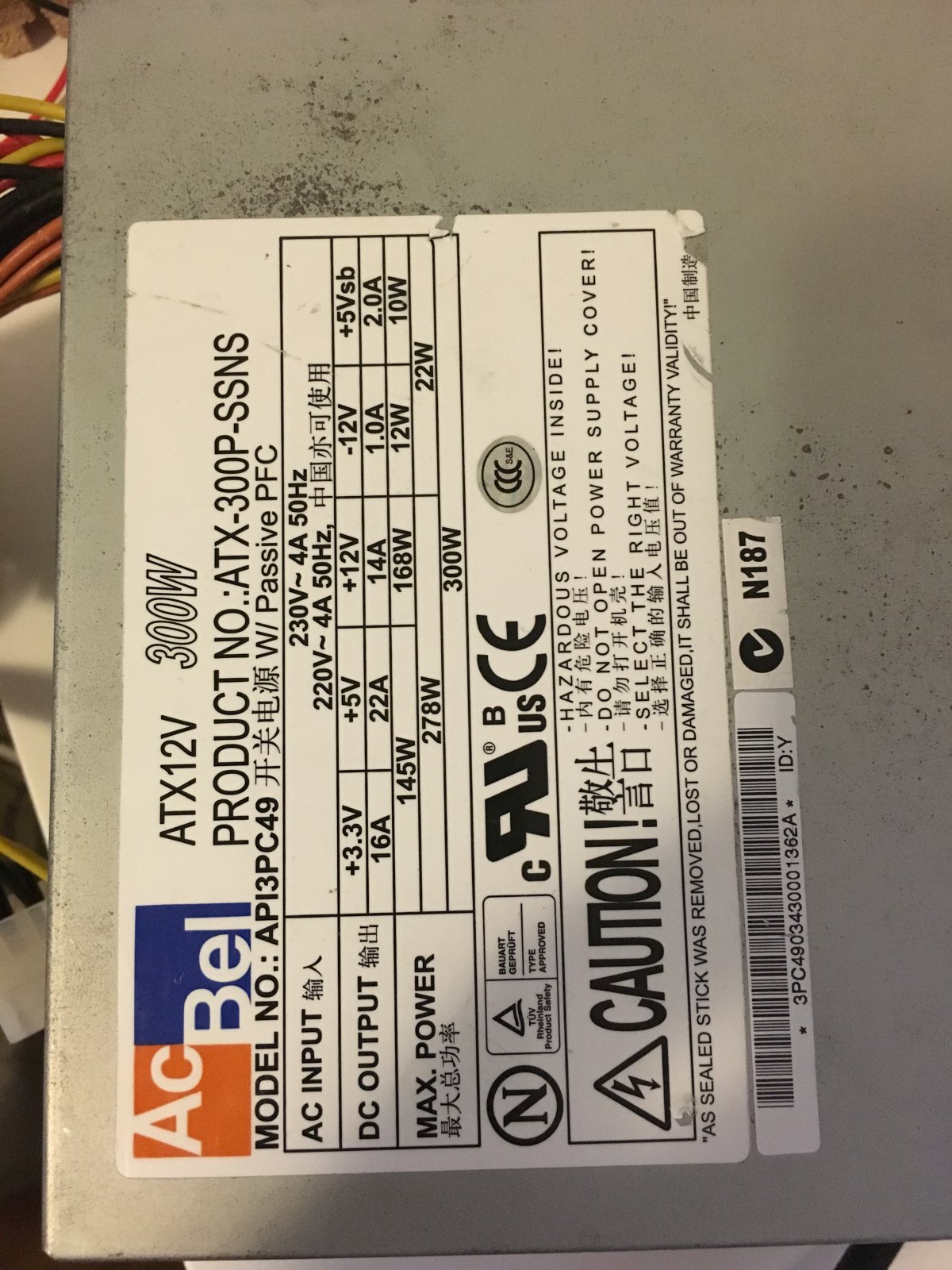

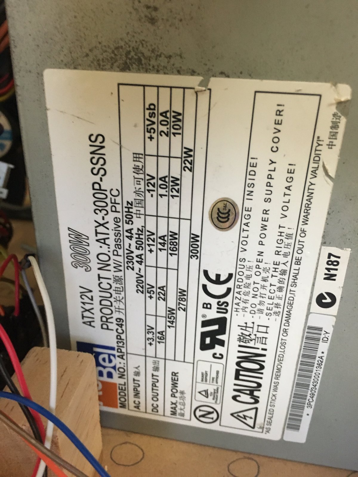

    I have brought some second hand computer power supplies to power them I have attached photos of their outputs...
    1. rated current is from what I have found, the highest current draw which at 12v's would be 16 Amps (per above)
    so based on that would I need a computer supply for each motor.

    @John458 just my 2 cents on the PSUs: the standard PC PSUs are very nervous if too much currrent (peak) from the motors is needed because of protection routines, mostly they are shutting down when peak is incoming ;) server PSUs are more aggressive, not all for sure, but mostly. They spend more than 50A on the 12V line and are almost cheap and worth every penny.
    PD:
    200 Watt motors should be powered by ONE MotoMonster, so you need 3 of them. BTW for all eventualities we have manuals, so don't worry. ;)

    @Pit quick question on the server PSU's. I got the current PSU's second hand from a local computer shop, $10 each :) However can you point me in the right direction on what sort of server PSU I should be looking for and what I should be paying etc, correct me if I'm wrong but your comment of "They spend more than 50A on the 12V line and are almost cheap and worth every penny." does this mean that one Server PSU could run all 3 motors?

    Prices fluctuate, I bought second hand at about $30 but then got brand new at $50 so upgrade my PSUs.
    Check the PSU section to ensure whatever you consider has mod info. I am away at work on my mobile so can't do that at the moment.

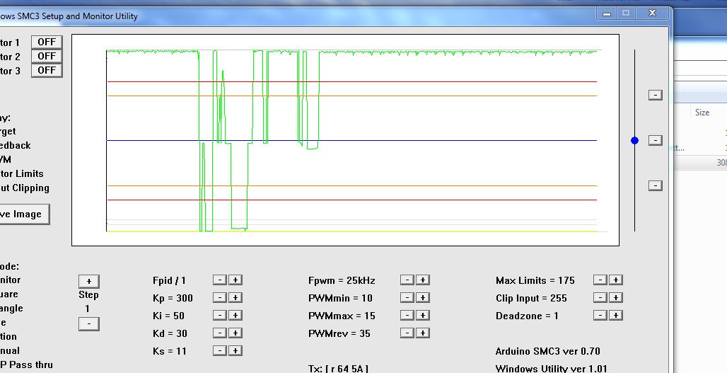

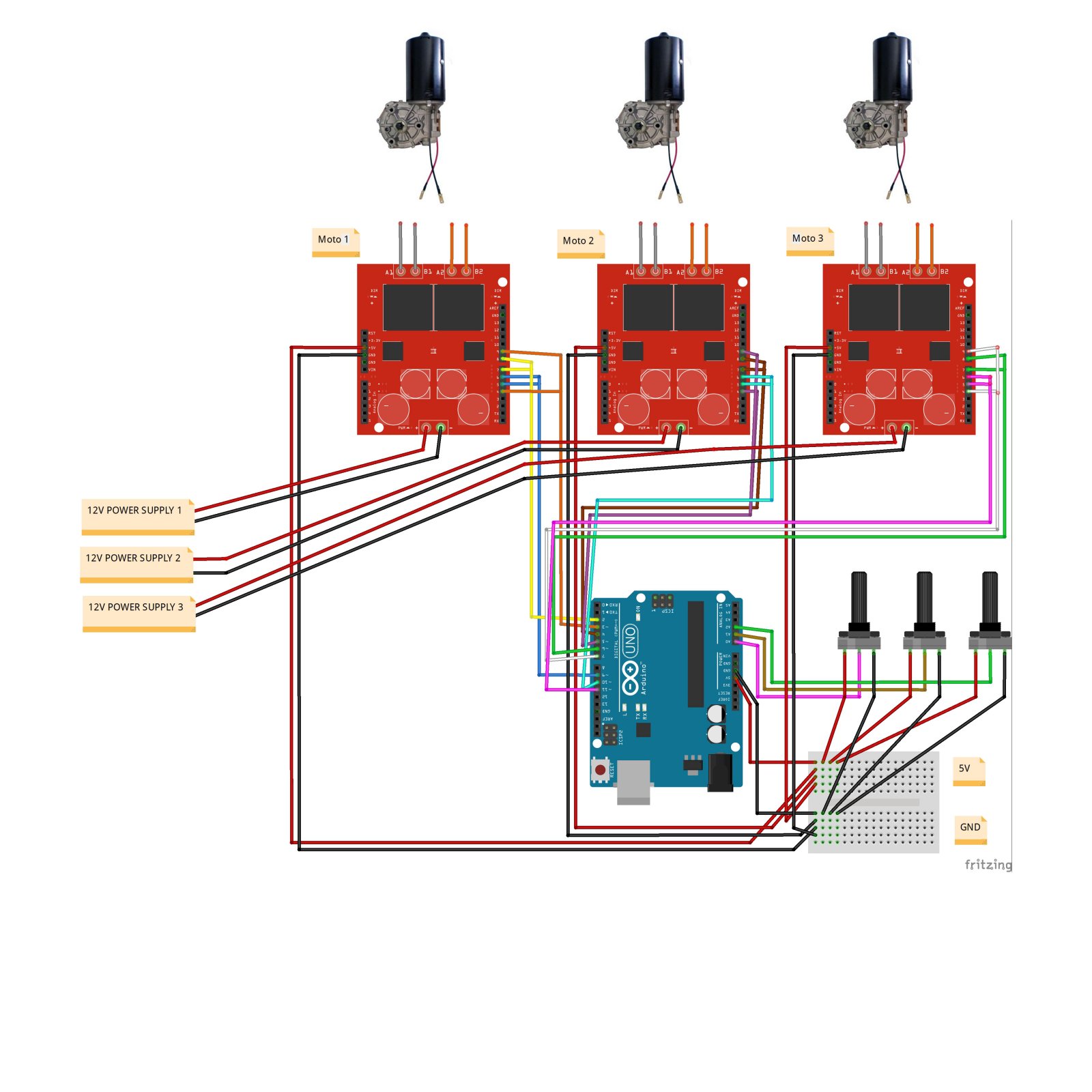

    I now have the 3 power supplies, and just finished wiring up the half bridge configuration as mentioned in
    https://www.xsimulator.net/communit...cts-as-a-single-motor-driver-more-power.5482/
    however on first test on running the SMCUtils 1.01 I am getting all the motors going to off and then max readings all over the place (see picture)
    Just want to post my wiring template I made to see if it is correct and maybe what I might need to check?
    Cheers, much appreciated
  13. Pit
    3,007
    30,516Coins
    +3,098 / 31 / -0
    Hi John, please check the range of your potentiometer, if the feedback signal passes the max limits line SMC goes in offline mode.

    Are you sure you are using the solderless breadboard correctly? Usually the connections are only in the vertical columns not the horizontal rows. Hard to see but in the picture they seem to be wrong?

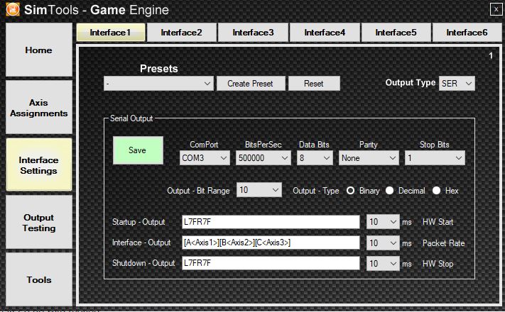

    Hi @noorbeast and @Pit
    just getting back in the game to finish my project and seem to have the arduino and motos sorted :), just couldnt quite remember how to setup the axis interface for arduino in the game engine.. is this correct for 3DOF? interface 4.JPG
  17. noorbeast
    22,185
    154,750Coins
    +11,196 / 57 / -2
    That should work for SimTools 1.3 @John458. The difference from SimTools 1.3 to SimTools 2.0 in setup is that instead of axis defined like this <Axis1> it is now like this to designate grouping for a or b <Axis1a>

    +25 / 0 / -0
    Cheers @noorbeast , worked a treat :)
