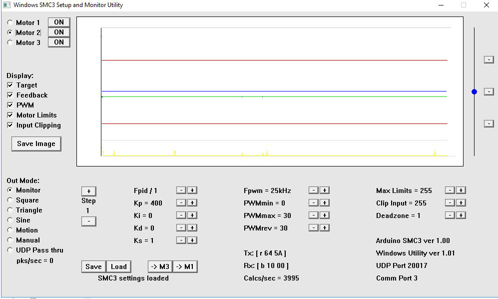

    Hi @RufusDufus @noorbeast @Pit and all the other awesome people out there.

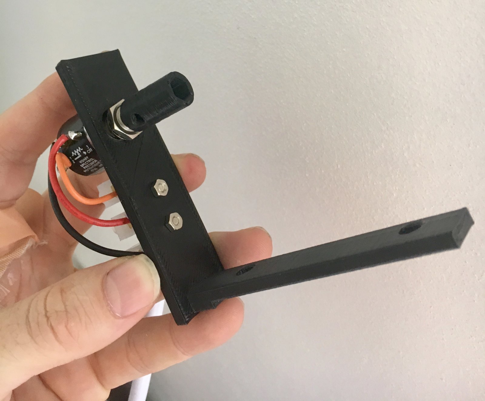

    I have finally created a feedback pot system that attaches to my worm gear motor, however I think its flawed in some way.
    I set the feedback pot to 0 on the SMC3 config tool so the feedback line is in line with the blue target recv line. (turn the power on and nothing moves which is great)
    Then I use the tool to test for motion and getting some mixed results, but eventually the feedback and blue line separate (see pic)
    which leads me to believe there is some slipping going on with the connection. at the moment I have a m4 hex head bolt tapped into the end of my motor shaft. then i 3d printed a connecting shaft with a hex shape on one end and a round one on the other end for the pot shaft. Once its attached i then have a screw that goes through the round end and should pin the pot shaft to the connecting shaft.
    Can anyone recommend a better way to do this?
    Cheers and thanks for your help.

    Check PWMmax which is very low, increase the power and look at the green line. Does it change anything?

    Hi @Pit
    Ill give it a go with higher PWMmax, although I have pulled it apart for some closer inspection then ill definitely try that :)
    Cheers mate

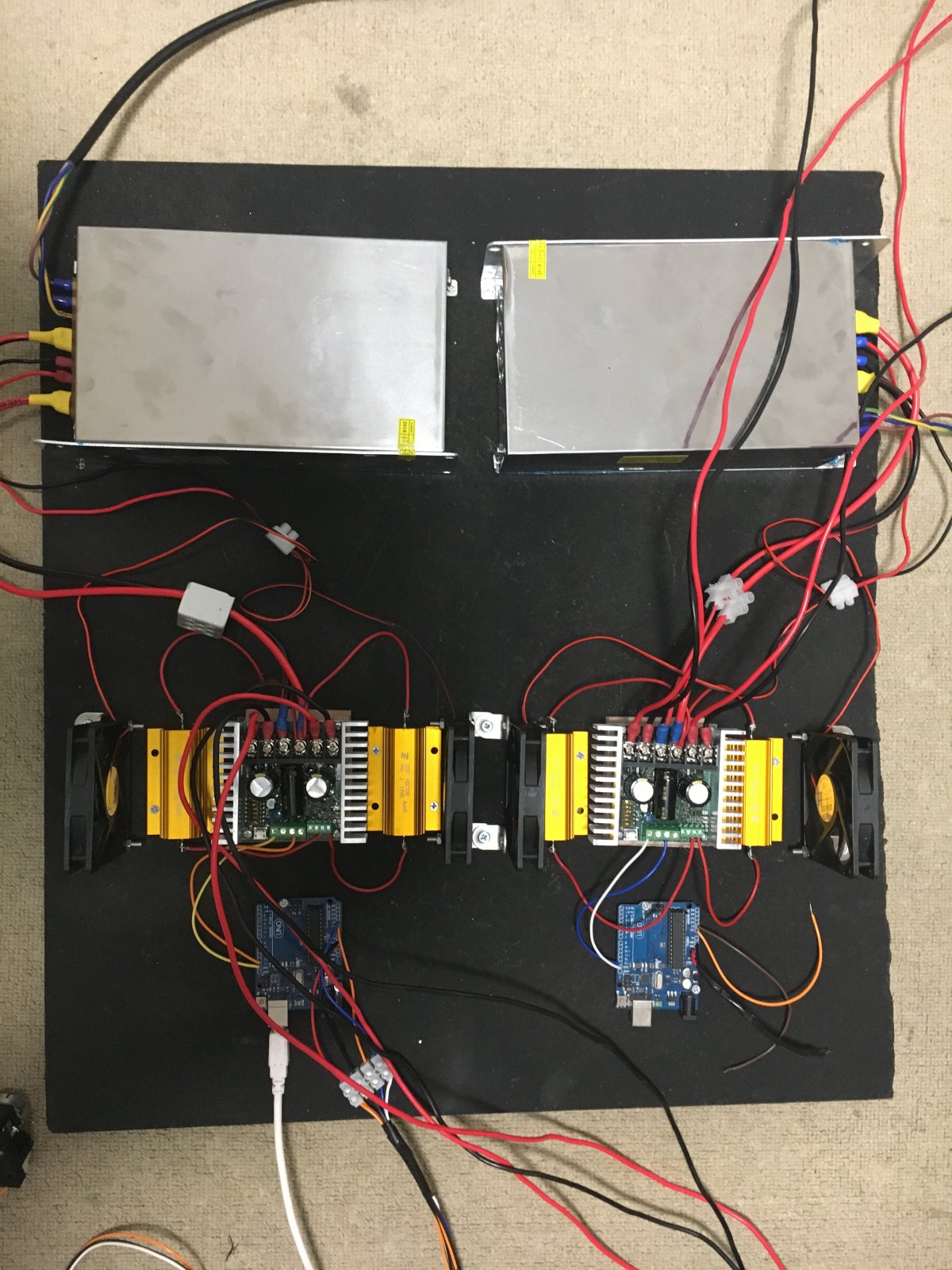

    Just looking for some help on voltage clamp resistors. As mentioned I have gone the sabertooth 2x32 route , ordered my new power supplies (wasn't comfortable paralleling the supplies ) now just trying to figure out the regenerative resistor config.
    Been learning some basic electronic equations (back to ohms law and such) and spoke to dimension engineering about the most suitable resistor.
    There response is as follows ( i am using a 50amp 12v supply and running the motors above.)
    so 12v/8Amps = Result 1.5 Ohms dissipates 96 Watts at 8 Amps
    or Alternative 2 Ohms dissipates 72 Watts at 6 Amp
    "You'll need to use 8A because it's the max the power outputs can handle.
    The ohms are too low on that resistor. Here's the calculation you want: https://www.dimensionengineering.co...or?batteryvoltage=12&current=8&calc=Calculate
    Here is a list of possible: https://www.digikey.com/products/en...35&quantity=0&ColumnSort=0&page=1&pageSize=25
    You can always parallel them to get the resistance and wattage you need.
    and
    "When calculating, for amps you need to use your motor current draw (actual draw under load- not what the motor is rated at) or 8A- whichever is lower.
    So, you always use 8A unless your motor is drawing something less. This is because the power outputs on the 2x32 cannot sink more than 8A."
    So i think that a 1.5 Ohms resistor at 96 Watts should do the trick, to protect the power supplies.
    however because they said "always use 8 amps unless the draw is less" I'm not quite sure this is still correct because the motor will be moving back and forth a lot and drawing all sorts of current levels to make it move.
    Would the 1.5 Ohms resistor at 96 Watt be suitable?
    Many thanks :)
  13. noorbeast
    21,664
    151,638Coins
    +11,043 / 56 / -2
    That is what the Dimension Engineering calculator indicates.

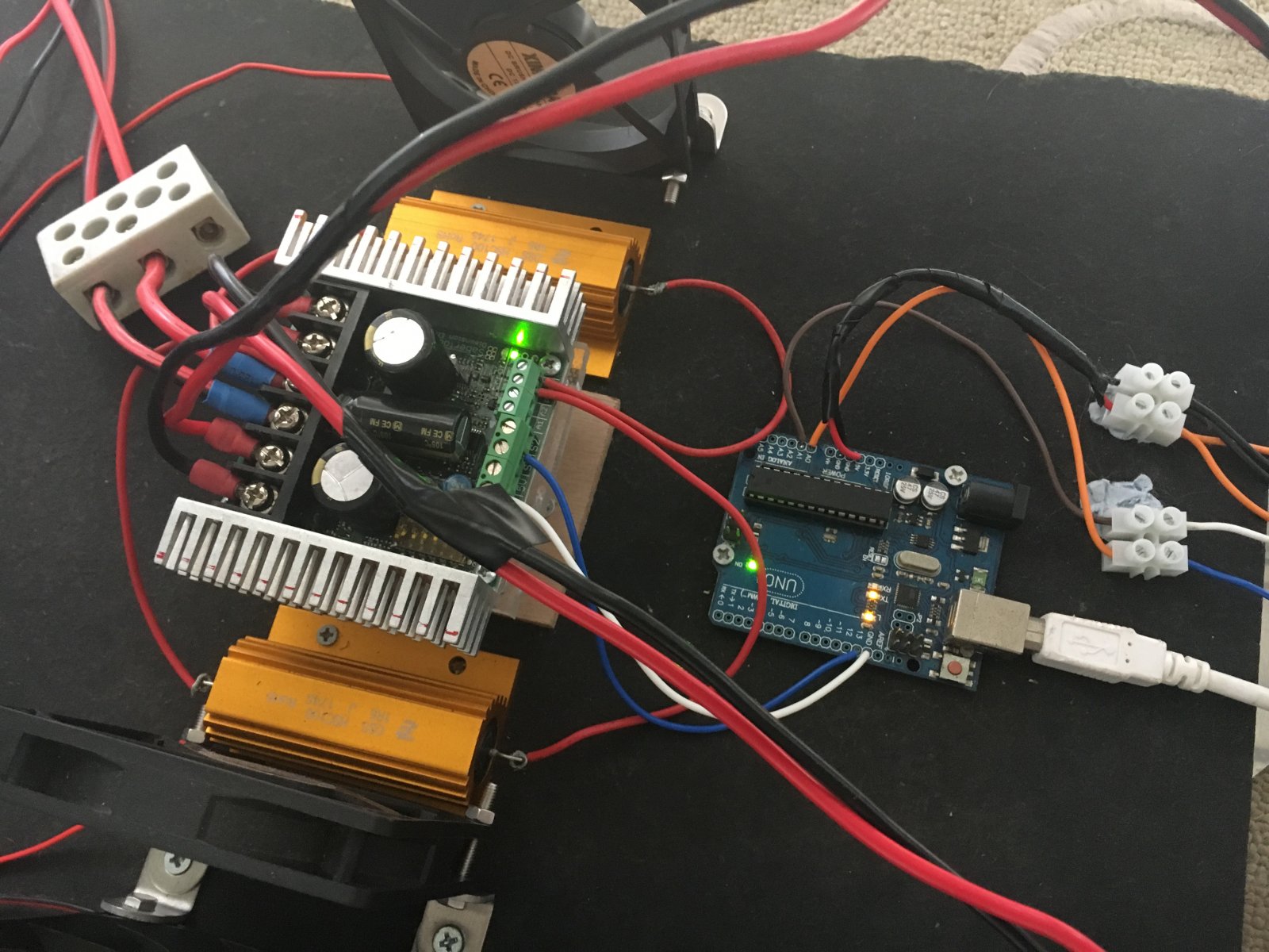

    I am making some good progress on the build and have just received my new power supplies and resistors for the voltage clamps.
    So moving to the sabertooth instead of the motos has been really easy in terms of setup and wiring so happy about that and I have followed this awesome thread to the letter
    https://www.xsimulator.net/communit...ket-serial-pid-motor-driver-w-softstart.9277/
    the issue I am having now is very strange, did not encounter this with the motos, just curious if you may be able to help or point me in a fault finding direction.

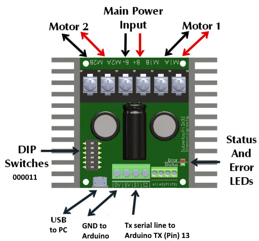

    1. I have my feedback pots (vishay) connected to the shaft of my motor and they seem to work great. I know this because when I launch the SMC Utils it finds both motors and when i manually turn the shaft with my hand the green feedback line moves away from the blue line and vice versa the other way. So i have manually turned the shaft until the green feedback line meets the blue line so everything should be centered.
    With the sabaertooths I have used the describe software to set the baud rate and set the dip switches as shown. Pots are connected to A0 and A1 and 5v and GND
    I then read from Six degrees of Flight that with the softstart SMC version he powers up the sabertooth first and then the arduino, beacuse it caused trouble for him...so i did that.
    So here goes ...
    1. Open SMC Utils to get Both feedback pots on motor 1 and two moved to match the center blue line by hand - so fully centered..close SMC Utlis
    2. I then power the sabertooth Open and Open SMCUtlis and select motor 1 and select square(or motion) on the outmode monitor function... then slowly move the PWMax up till the motor starts moving..
    3. This works the motor starts moving back and forth as expected but the green feedback line is dead straight (it doesn;t move at all. just the blue line going up and down through the green line( see video)
    4. so then i go to monitor manual mode (still on motor 1) and click the middle minus button on the right to get it back to center to stop moving. (this doesnt mean the physical feedback pot is back to its center thou)
    5. Ok then i switch to motor 2 and and the feedback line has moved below the blue line So strange as this was centered just before).. and this motor wasn't moving at all. I have only been moving motor 1
    6. So seems like there is some confusion with the pots?
    7. then when I apply power to the second motor anyway... both motors move...strange..
    Hope fully the video helps and look forward to any help.
    Cheers
    John

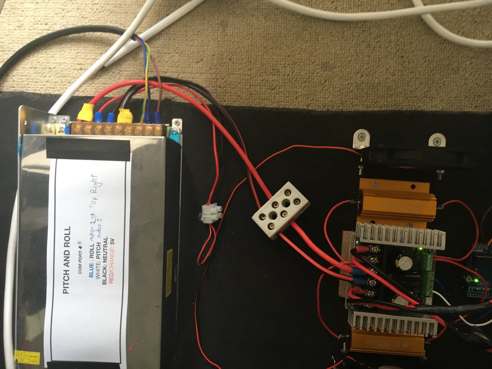

    Well found the problem, one slightly loose wire with the pot connection system.. and then the motor connectors to the saber need to be mirrors of each other not opposites, so right to left motor connectors on the saber 2x32 . Motor 1 (BLACK RED) motor 2 (RED BLACK)..things seem to be working now...just got to finish the back motor mounts and then back to testing with Simtools. See pic below for current power and electrics..(taken before I changed the motor connections) also missing the emergency shut off button and pot noise suppressors.
