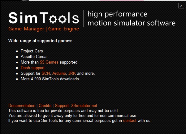

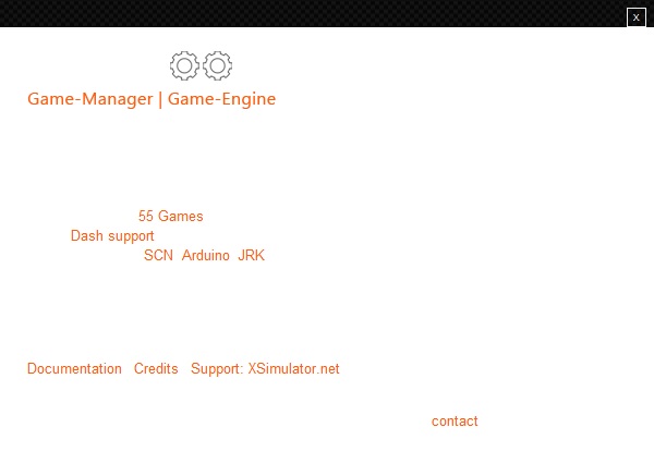

    ok, next problem. i got simtools game engine configured and running and i can control pitch and roll ok with the mouse. all looking good
    now i start simtools gamemanager an the app looks like this
    i'm guessing that's not right because i read the docs and it should look totally different. i did the plugin thing already and installed a joystick thing for testing and DCS
    i tried clicking everything on that app and all i get is a bunch of webpages
    when i right click in this in the systray, the only option is exit
    i know that the plugins install because in game engine, i look at the game list and i see joystick, DCS and Live for Speed
    any ideas pls? thx

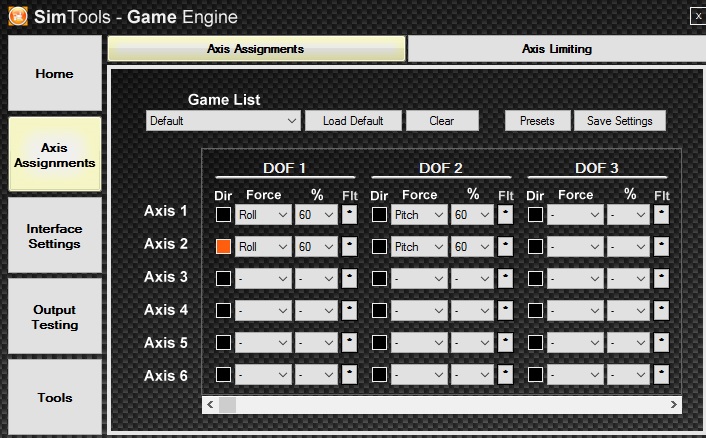

    FYI, here's my simtool game engine settings
  17. noorbeast
    22,185
    154,750Coins
    +11,196 / 57 / -2
    That is just the splash screen, you can just close it, Game Engine and Game Manager both start minimised in the system tray.
