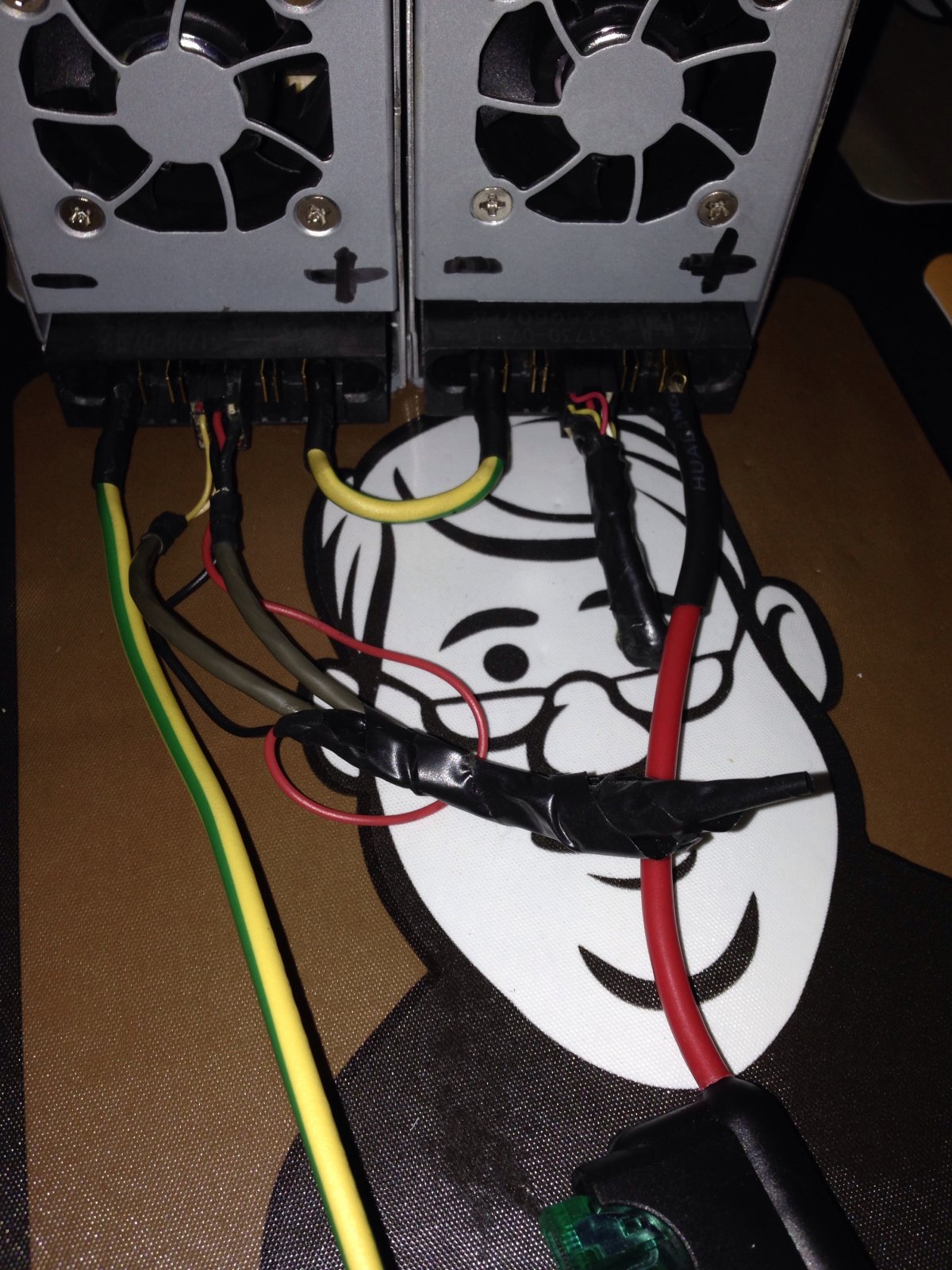

  7. Nick Moxley
    17,057Coins
    +2,507 / 30 / -2
    Hey Petar, I would hope those motor mounts are only for testing. As they Do not look any where near robust enough for the task at hand.
    Also can i request a close picture of the wiring on your PSU's.
  8. Petar2
    Petar2 Member
    May 23, 2014
    59
    Valencia
    715Coins
    +42 / 0 / -0
    You are absolutely right, these brackets are for testing only, like the wood used.
    The cable is 2.5 mm section, I would hold, but I think I can put double for each engine if necessary.
    What do you think?

  12. Petar2
    Petar2 Member
    May 23, 2014
    59
    Valencia
    715Coins
    +42 / 0 / -0

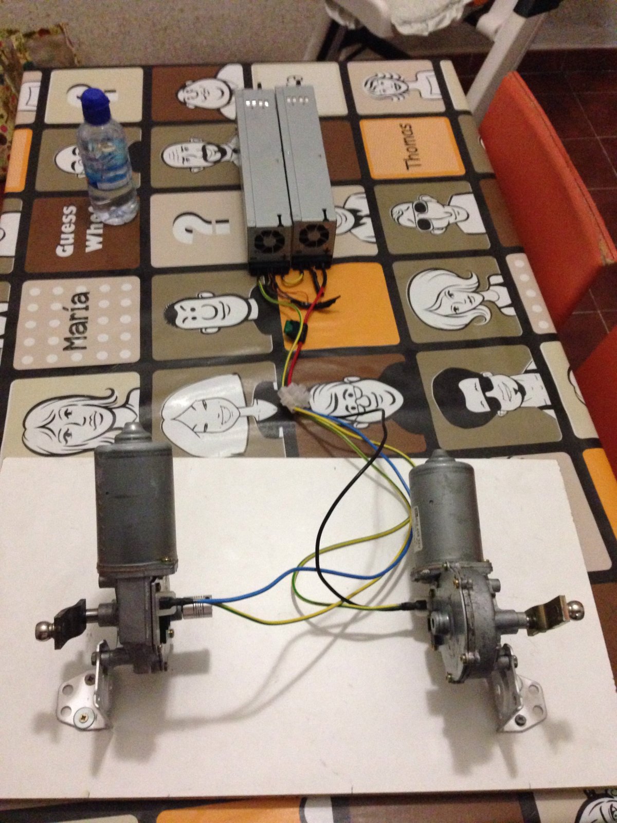

    I'm using two sources of server HP dps-600pb.
    For two? For by these sources deliver 12V 47A 575W.se a mod that makes them work is serial, so we get 24V 47A 1150W.
    More than enough to move my engines.

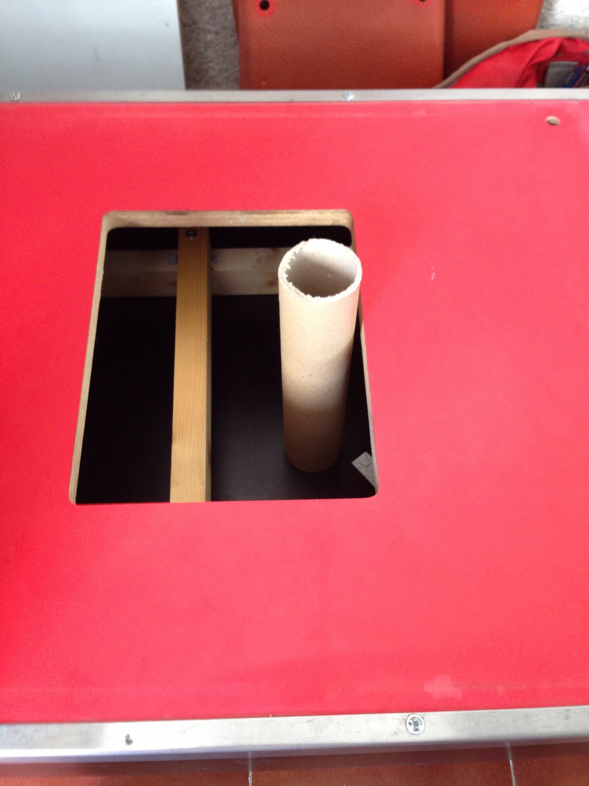

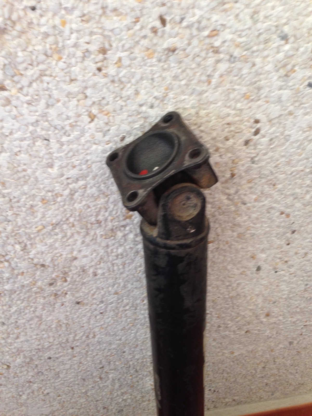

  14. Petar2
    Petar2 Member
    May 23, 2014
    59
    Valencia
    715Coins
    +42 / 0 / -0

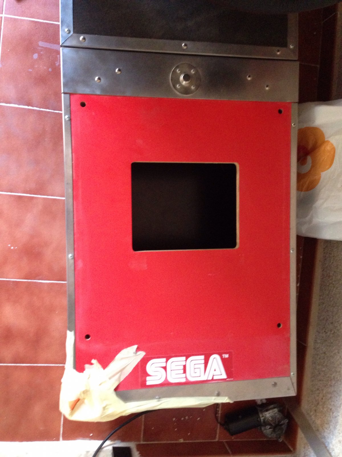

    To separate the seat from the base, will withdraw the timber supports, the metal base of the seat rails with square seat.me remnant metal base are attached to the seat.
    this seat subwoofer incorporates down.estructure metal at the base of the machine, and a universal joint, will join the seat.
    Once done this, again wood and if we have to cut something ..... cut and maintain the aesthetics of recreational as possible, but we must assume that is no longer the same as it ever was.
  15. Petar2
    Petar2 Member
    May 23, 2014
    59
    Valencia
    715Coins
    +42 / 0 / -0

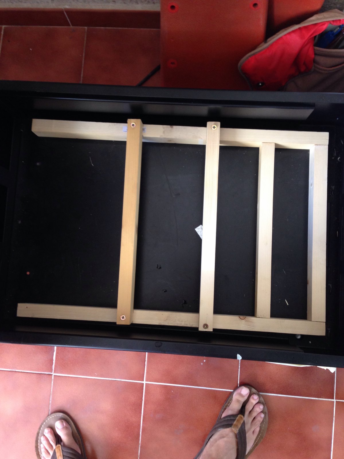

    Here the collected pieces, securing and preparing the potentiometers electronics.
    I've removed the seat and today I'll make a prototype of the structure with wooden slats.
    After setting the prototype, you switched to a metal construction.
  16. Petar2
    Petar2 Member
    May 23, 2014
    59
    Valencia
    715Coins
    +42 / 0 / -0

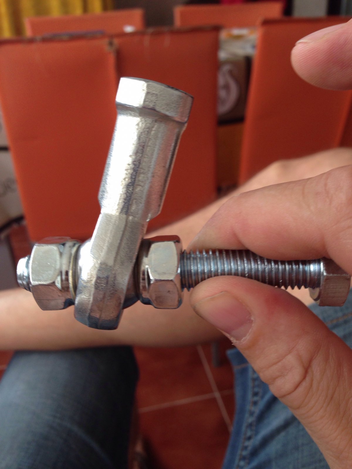

    More or less this is the idea, the two rear brackets as a bar be welded and the two central metal plate that is attached to the drive shaft.
    Even I have to find the center of gravity of the seat with my weight including block and see if the hole is in the red wood, or if you have to cut to fit.

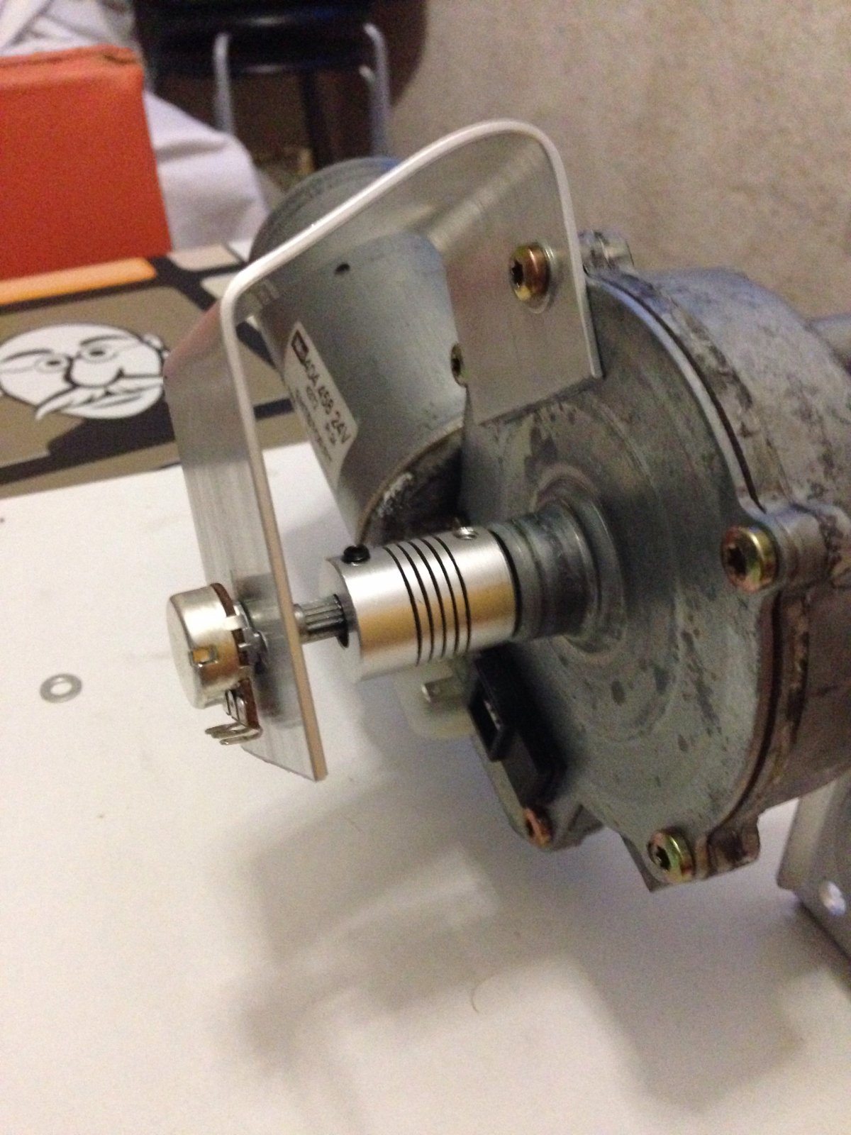

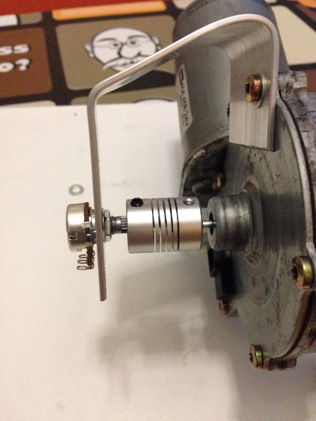

    Hi Petar2,
    what kind of potentiometer have you used?
  18. Petar2

    this model of potentiometer has the end or can turn 360 degrees?
    Some people told me that i need to buy potentiometer whit no end (360 degrees) because if the motor do a 360 degrees it doesn't break the potenziometer.
    @bsft what do you think about?
  20. bsft
    you dont need a 360 deg pot. I use them for safety of not breaking, but if you are careful on setup, a 270 deg pot like the one listed is fine.
